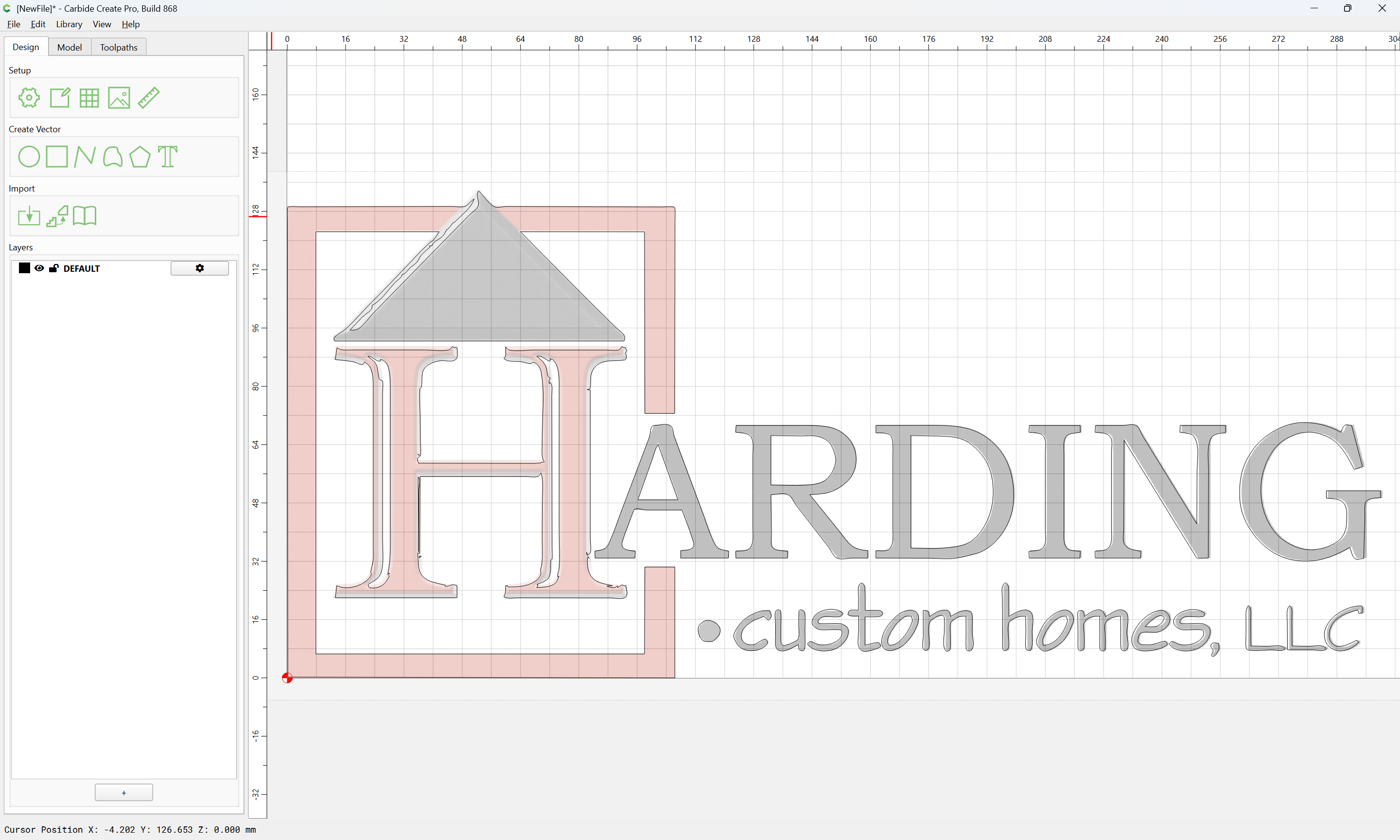

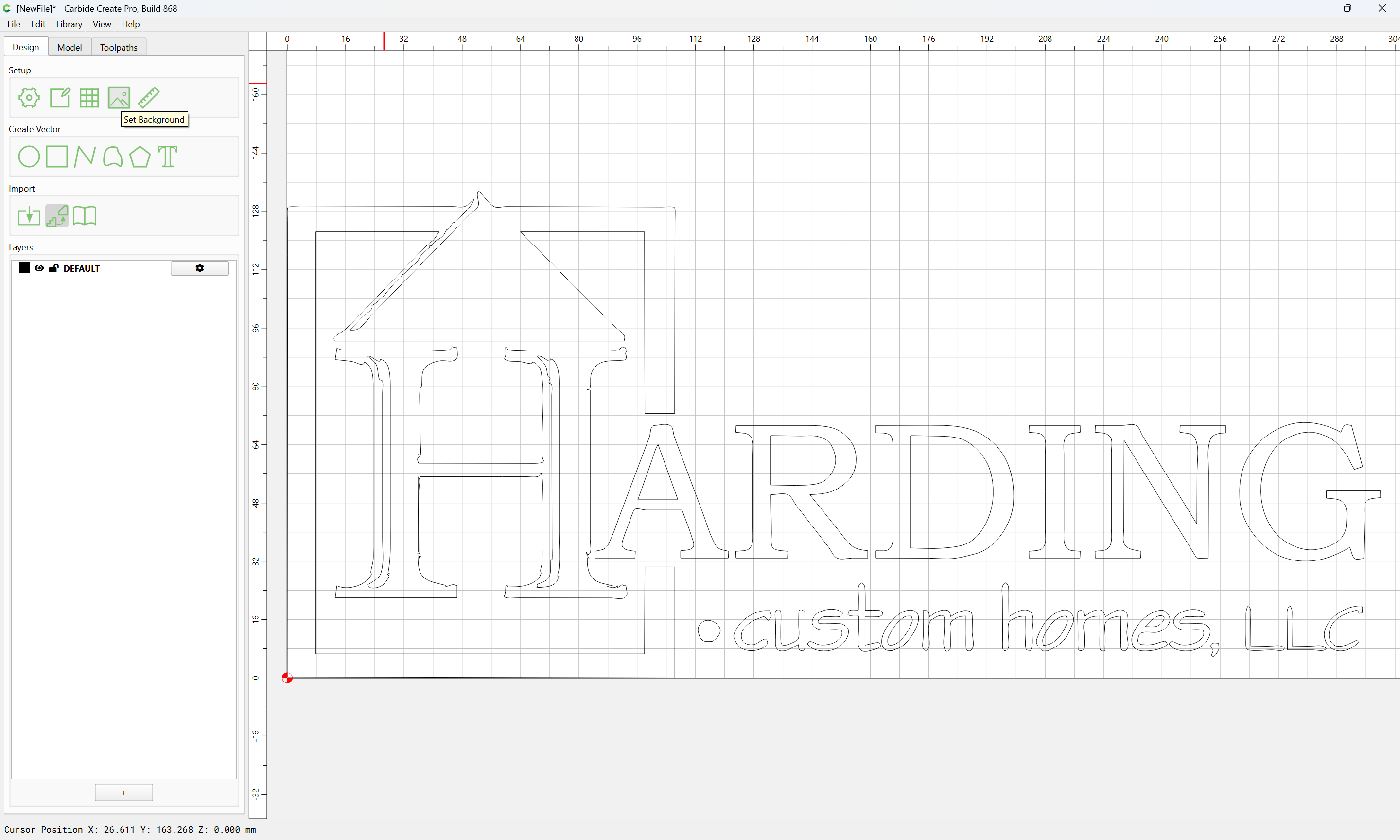

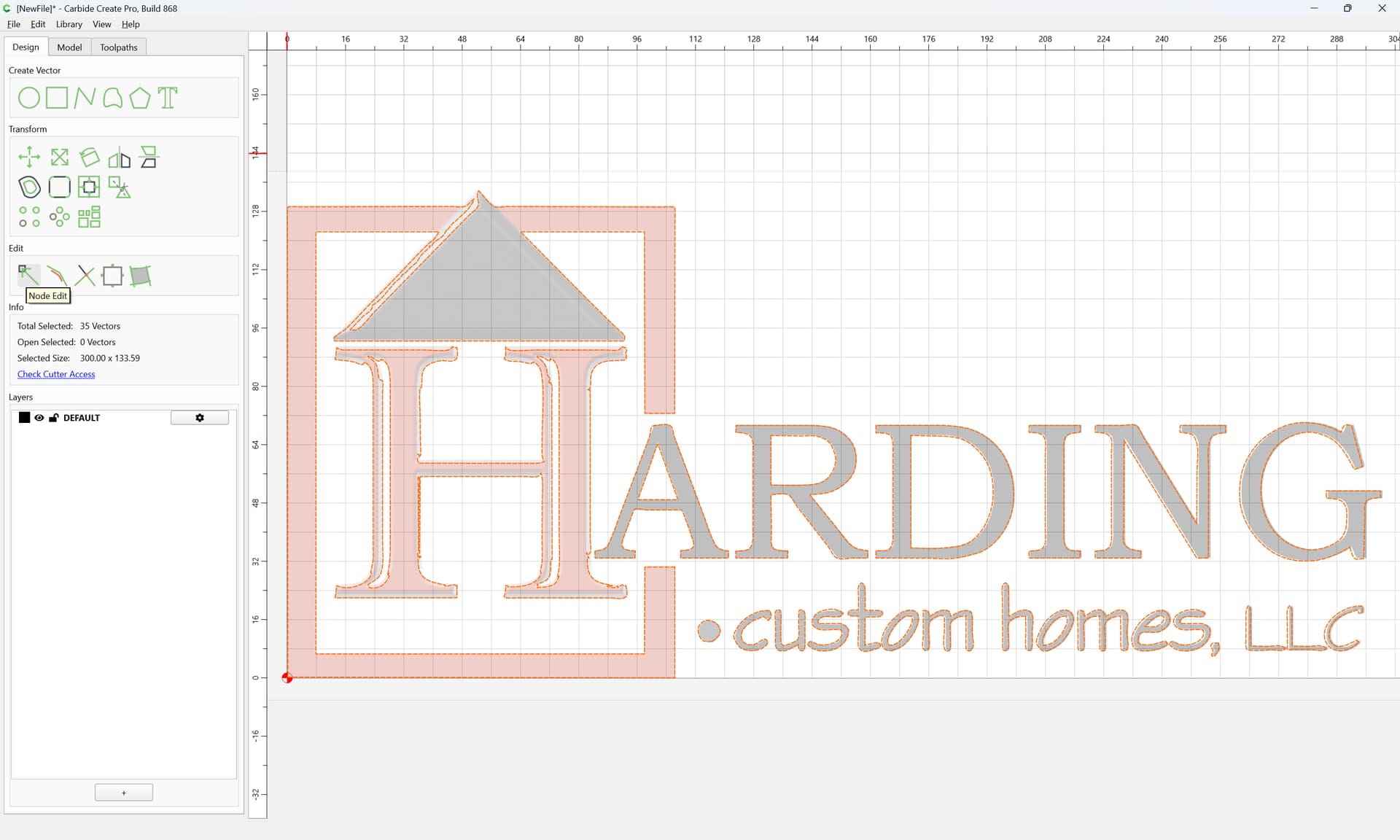

I need help. How to convert the attached file so it can be carved
Hi all and whomever can help. I don’t know how to take the attached file and convert it to a SVG file so it can be sent to CC and I can carve it. I imported it to inkscape and saved it as a SVG file, but when I try to load it, nothing happens, no image nothing. I’m fairly new to this so any help would be greatly appreciated. Explain it to me like I am a small child. Thanks in advance. Clint

If you trace it as I did in the attached file you will have some clean up to do. Personally I believe you need to spend the time to become familiar with your machine and software. This place is inundated with knowledge so take advantage of it. I hope this helps.

I’m open to all suggestions Sir. I’ve used my cnc for about a year. Mainly cutting custom vent hoods. A builder asked me to make a new sign for his office. I am on the struggle bus on how to take the pdf he sent and make it usable. I just don’t know how to do any of these things. I want to learn. I need a Yoda to guide me.
Ideally, you would get a vector original of the file.
Another consideration is that that image is made more complex by the 3D effect — if you’re not planning on re-creating or incorporating that into the 3D version, then it will add unwanted complexity.

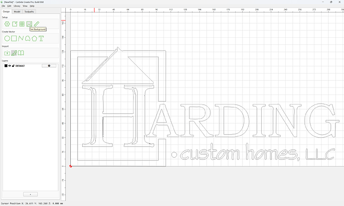

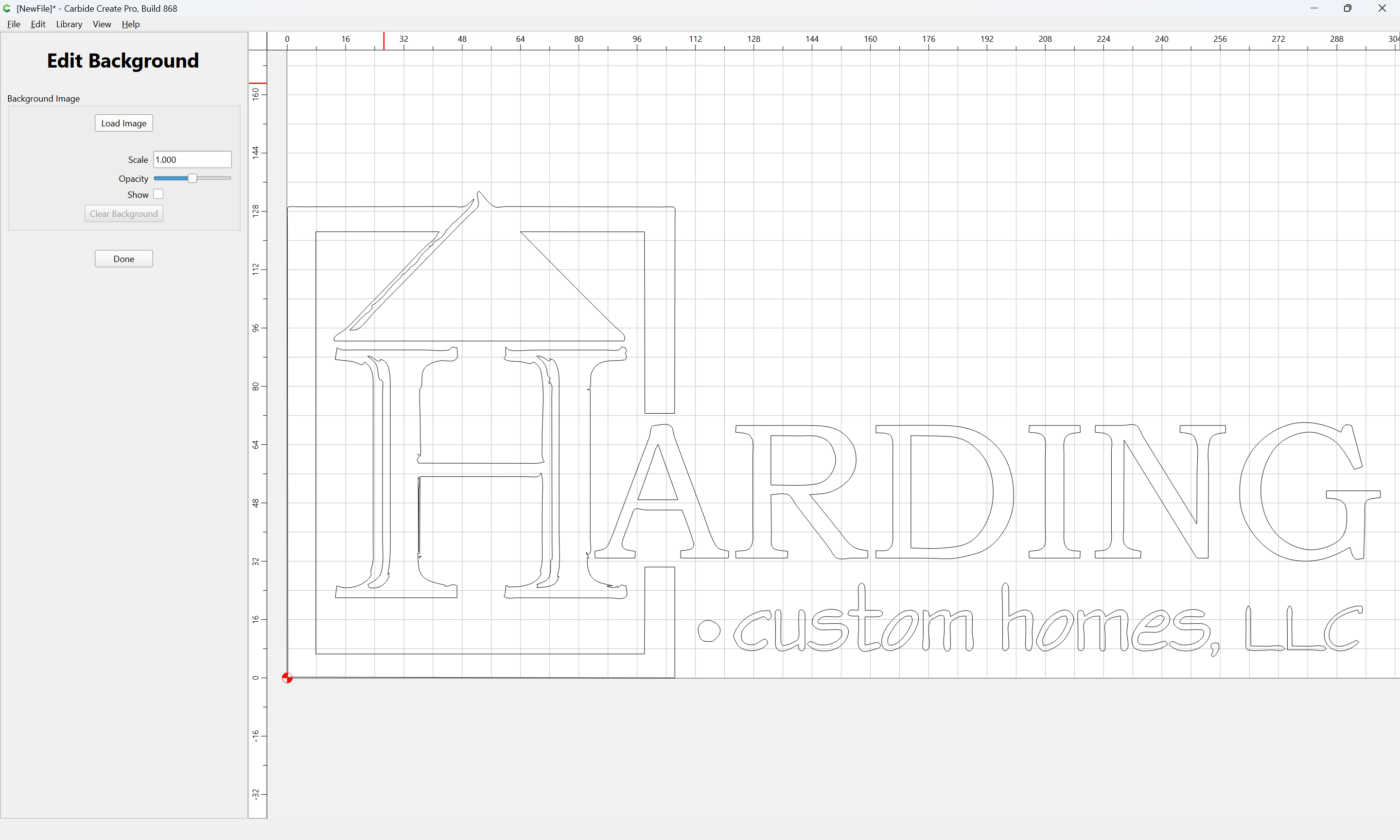

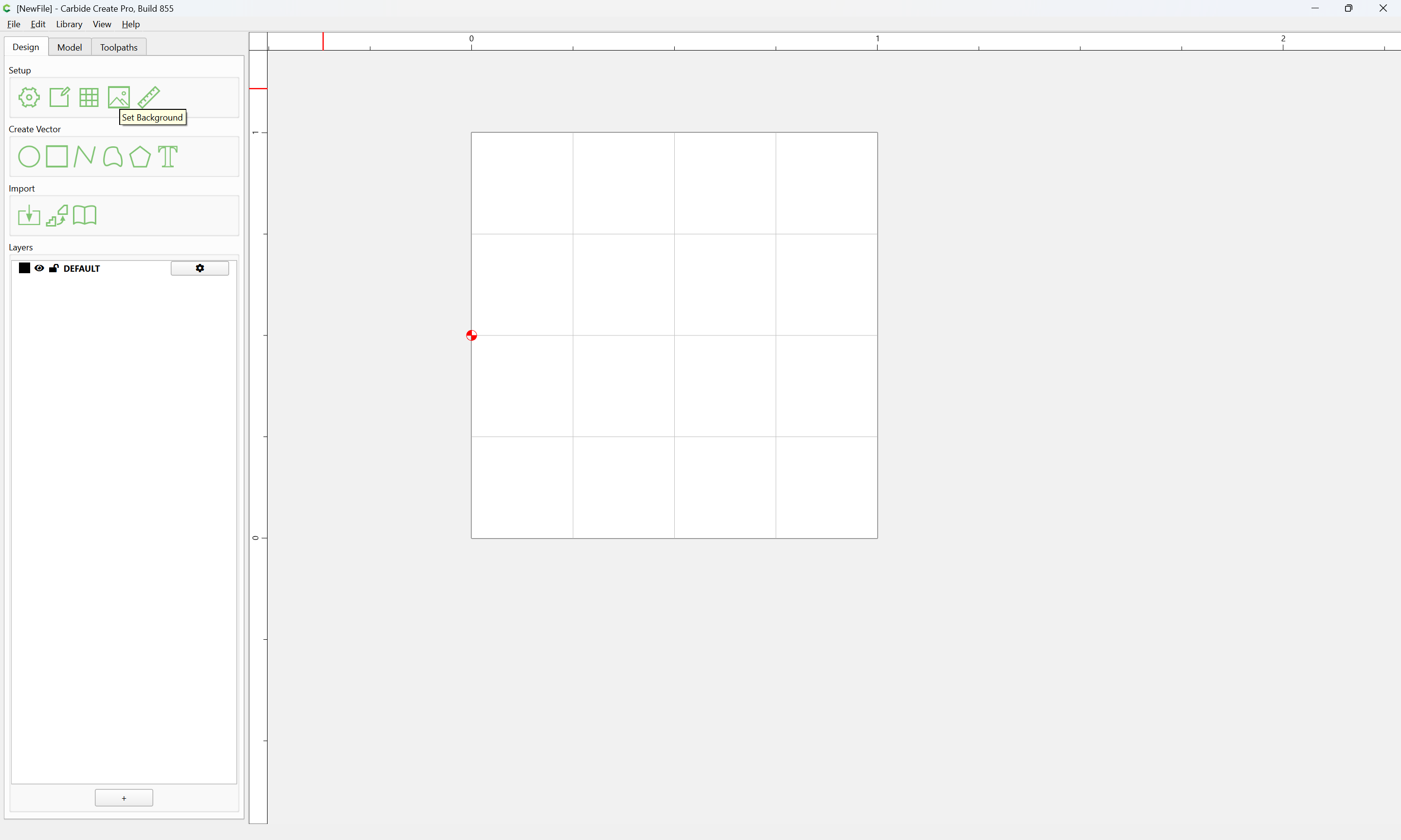

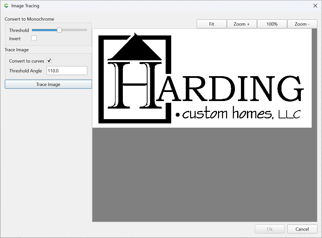

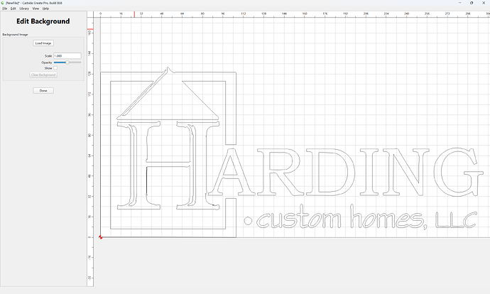

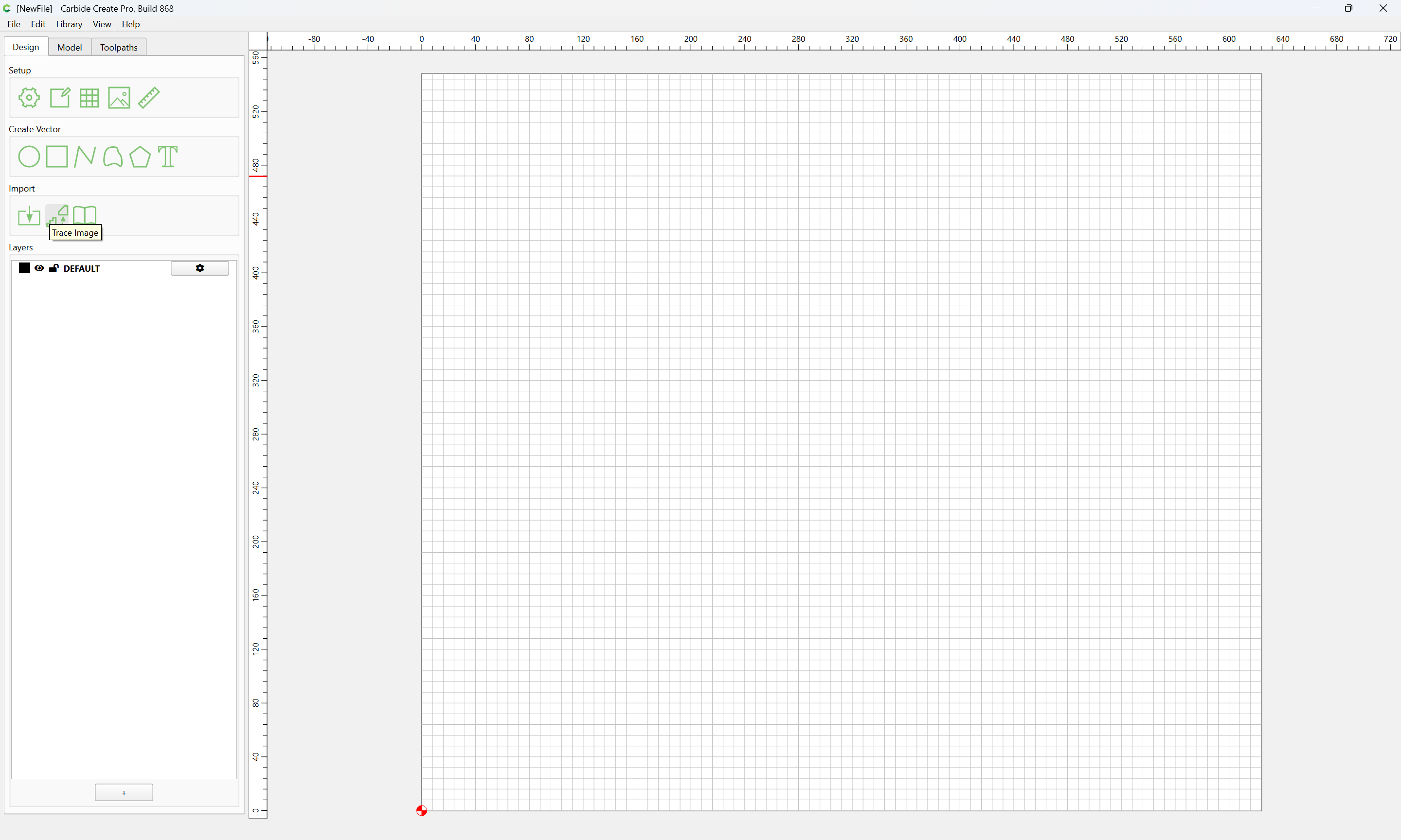

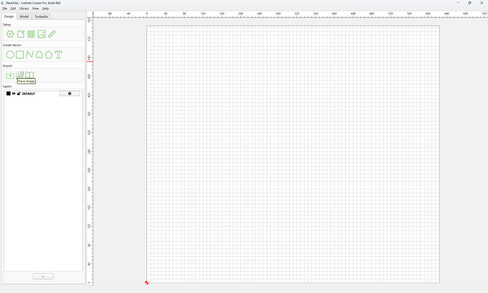

Working with the file you have, you would want to trace it — Carbide Create has a feature for that:
and the provided file is decently high-resolution, so should trace well:

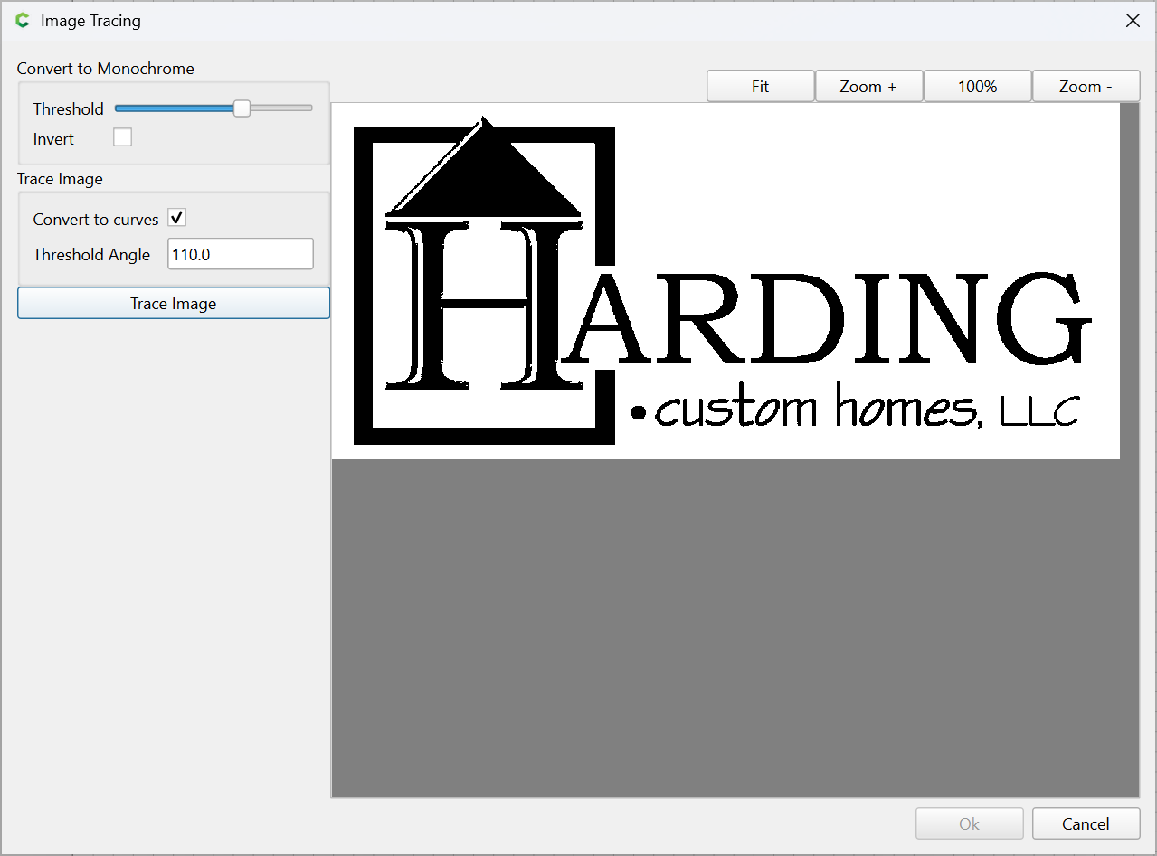

Trace Image (and select the file in question)
Adjust the threshold as desired:
click “Trace Image”
Ok

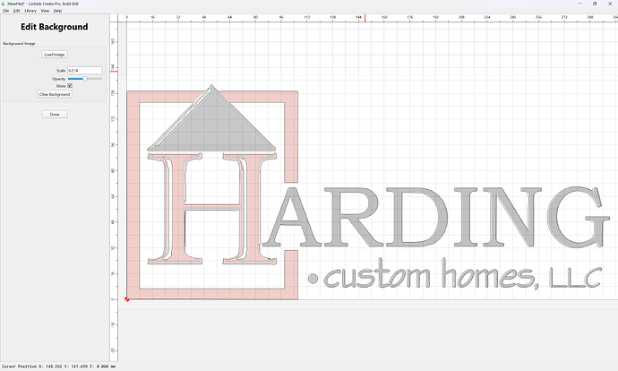

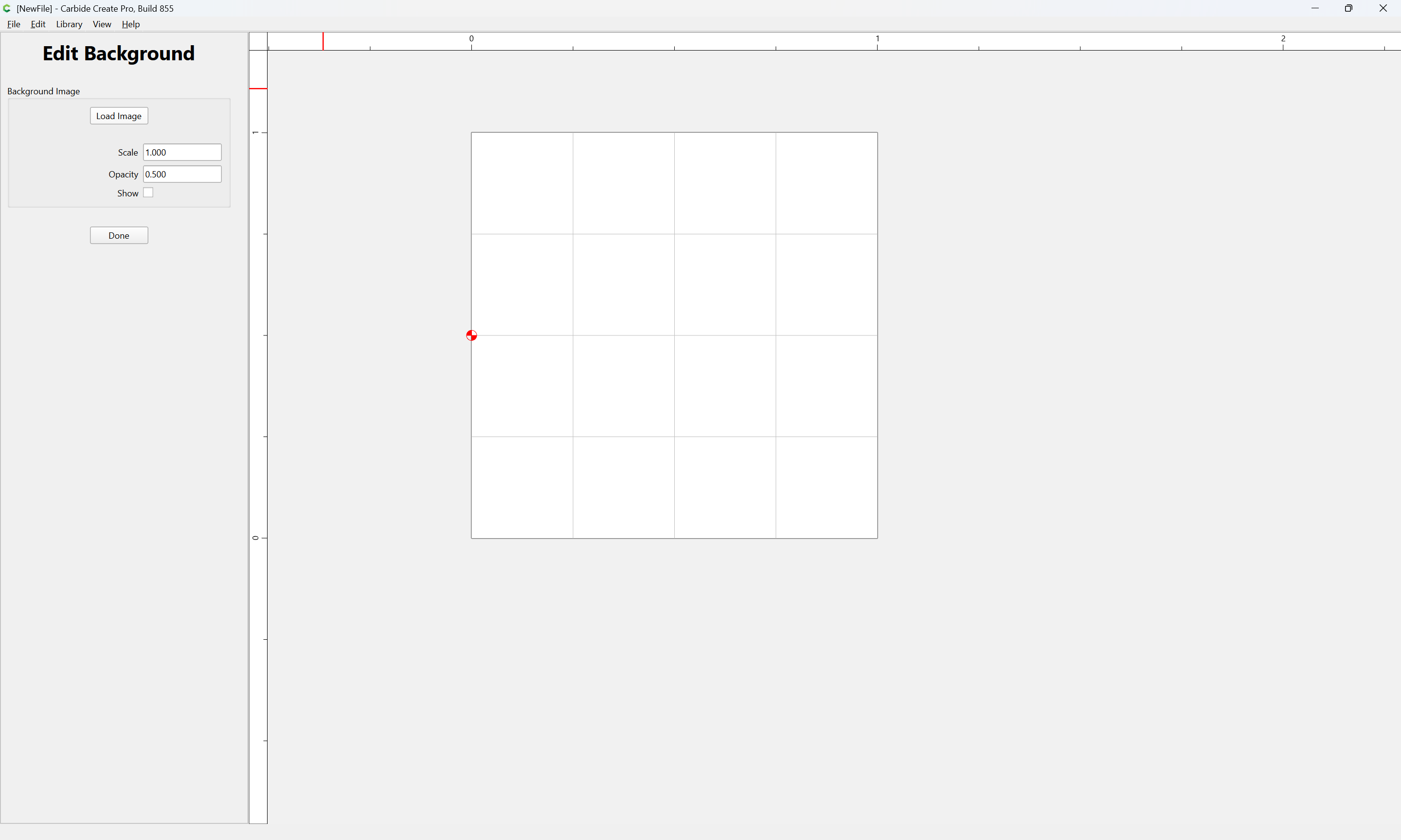

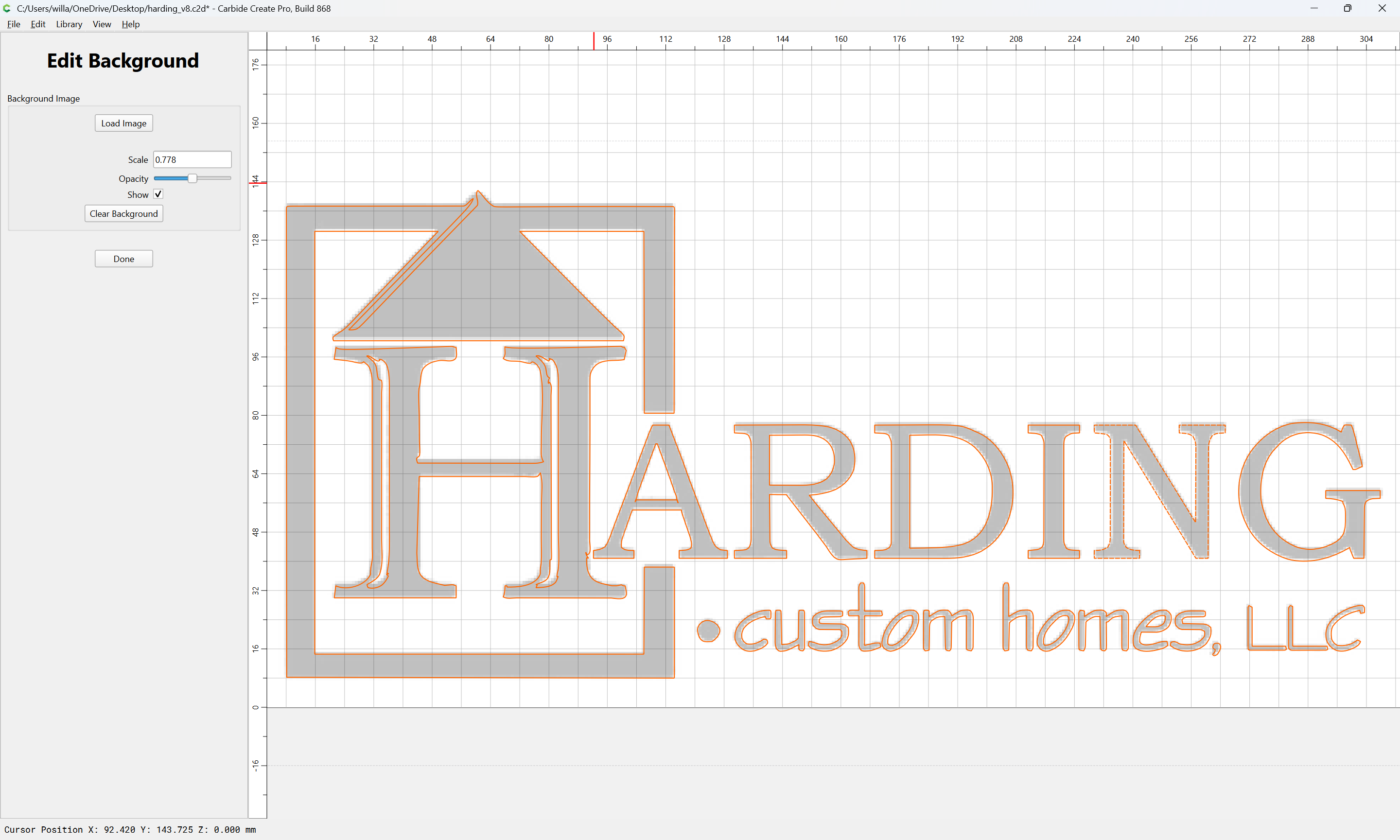

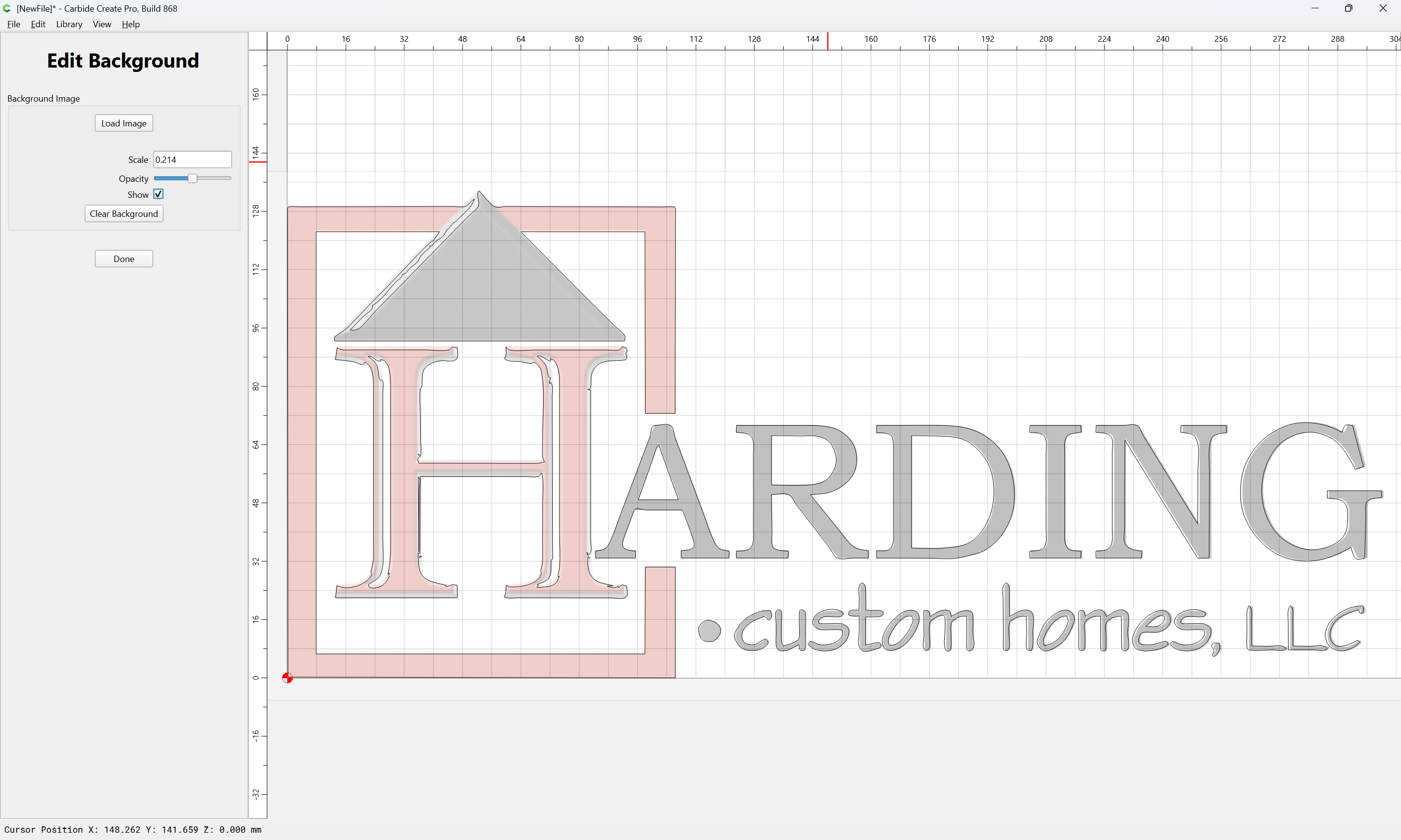

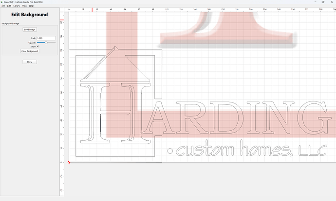

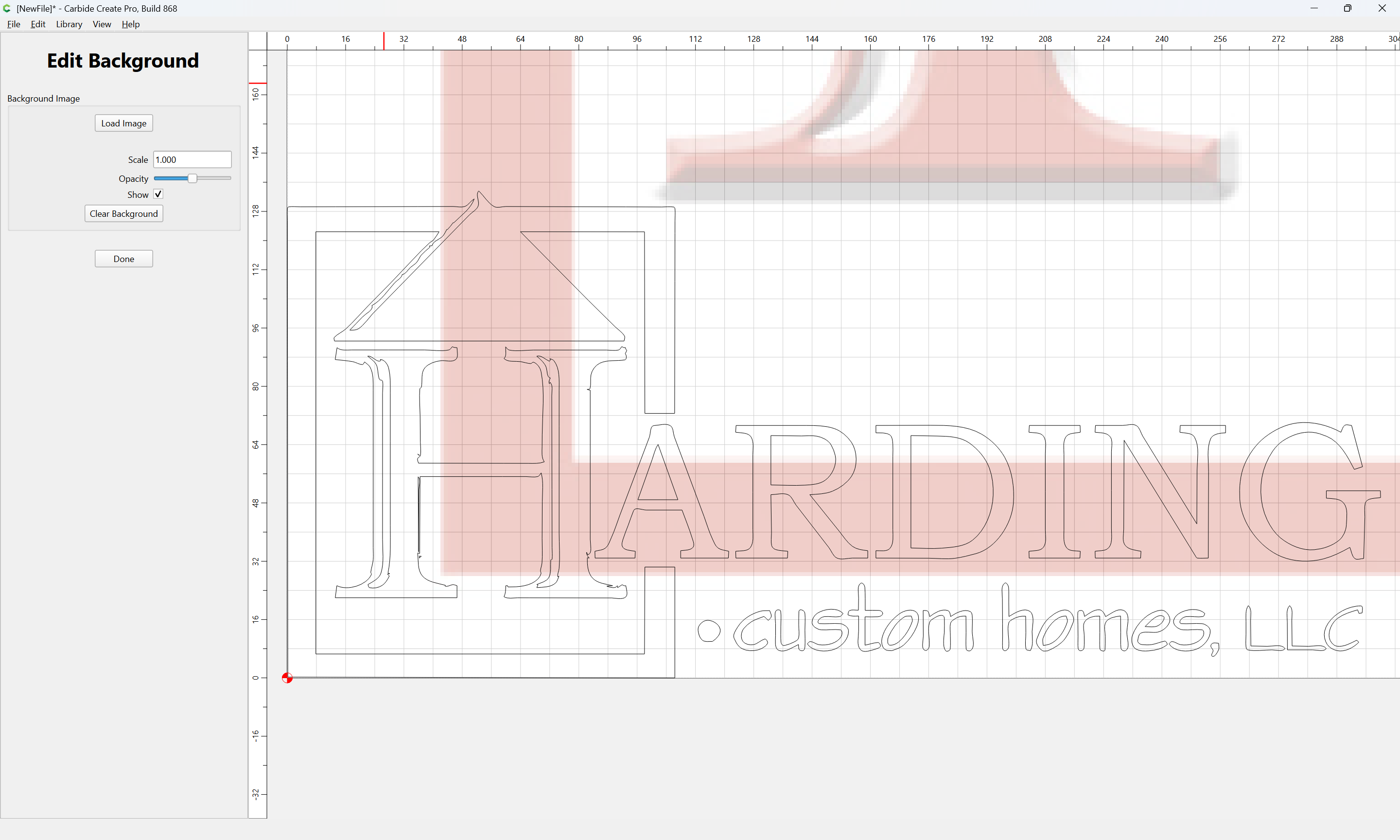

Then, import the original image:
Set Background
Load Image
(selecting the original)
and adjust until things line up:
Done

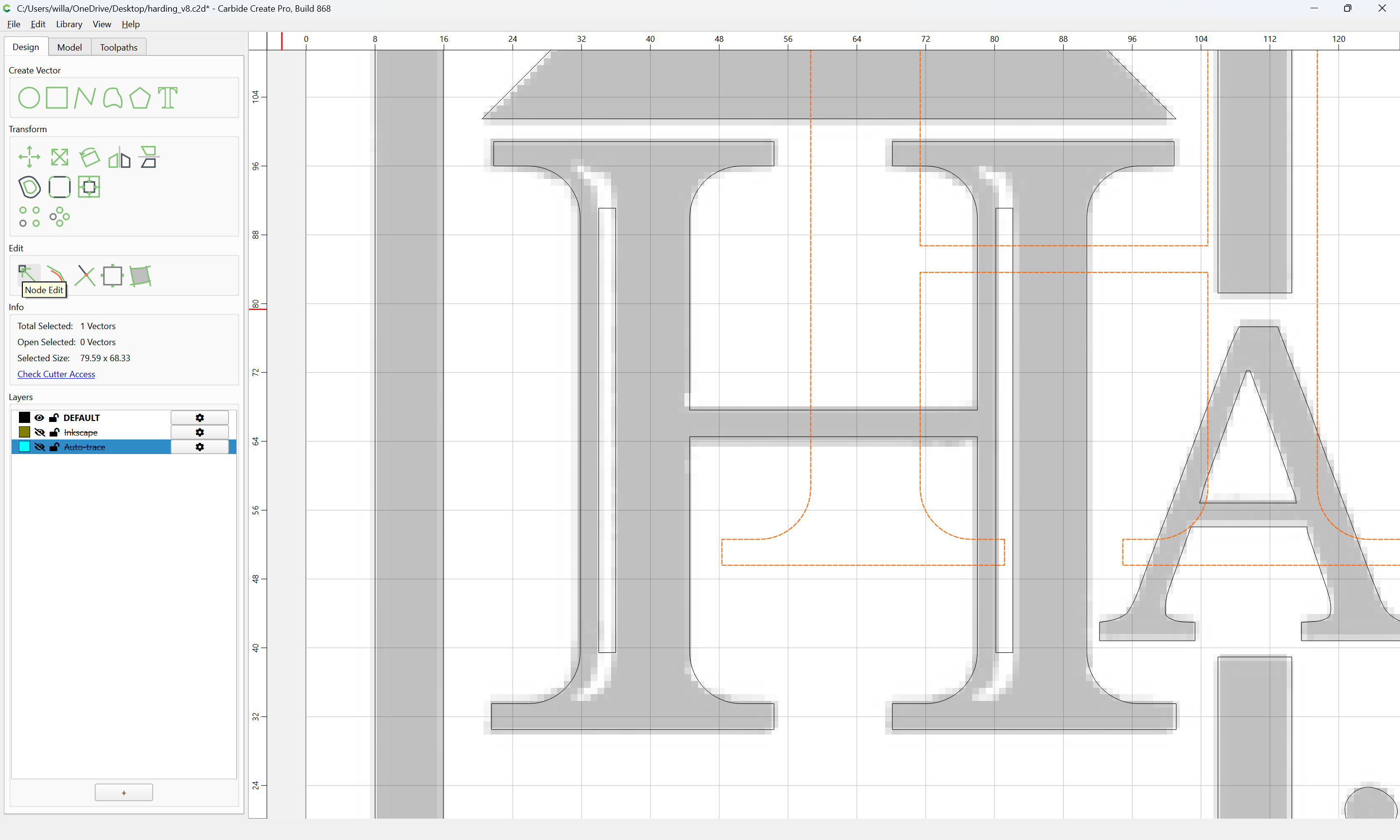

Then, use Node Editing to adjust things as desired:

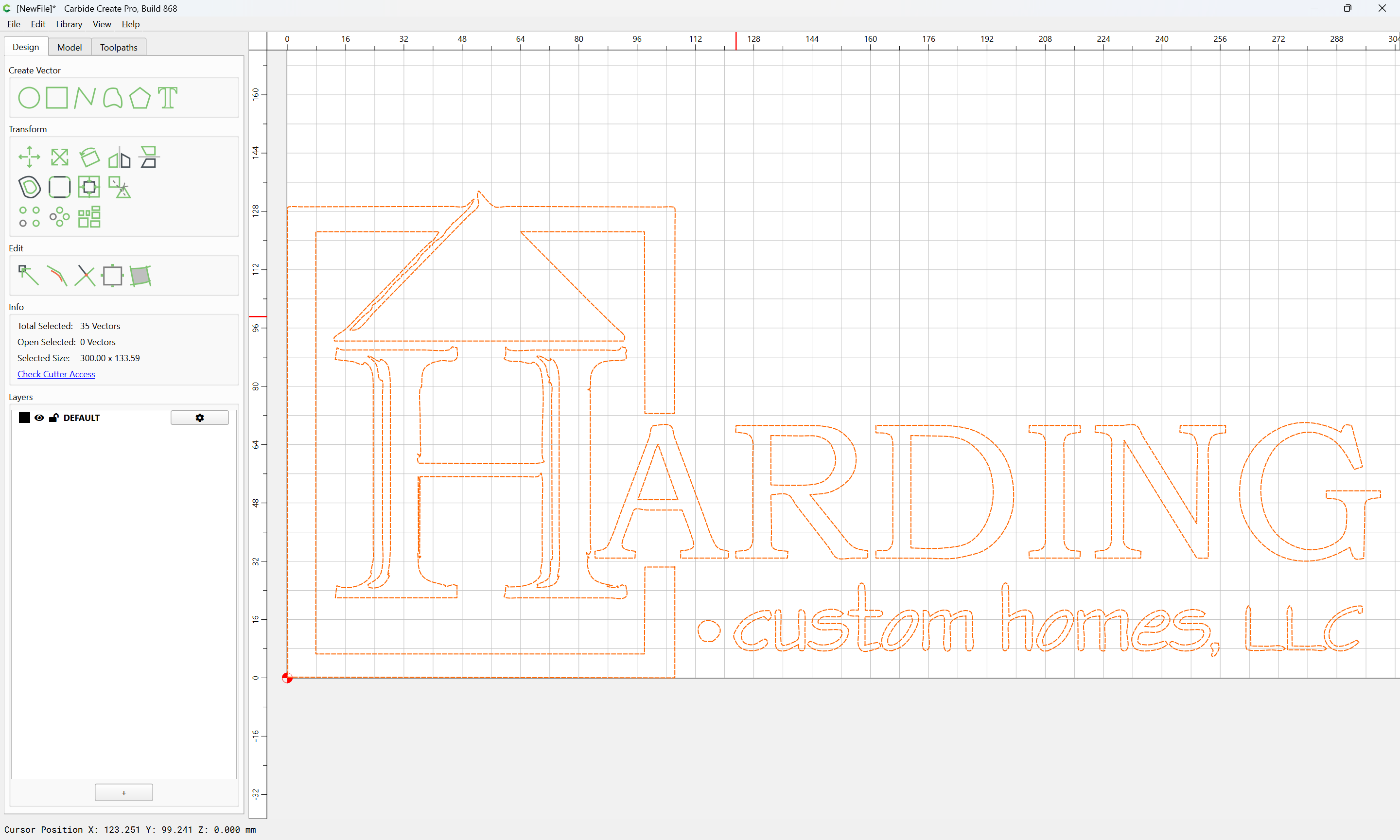

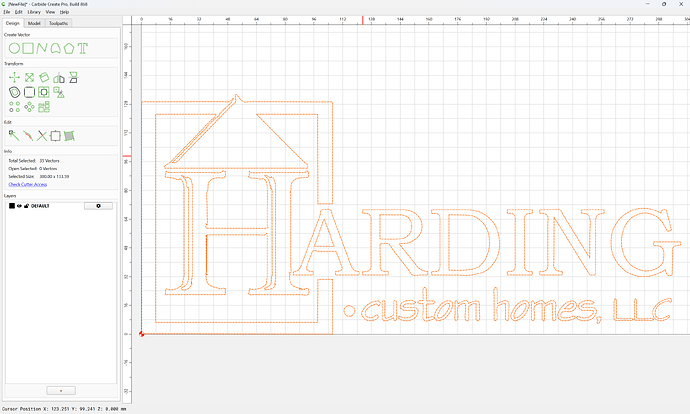

Here is your image made into an SVG. I used Inkscape to convert the jpg to an SVG.
harding
You will need to likely clean up some parts.
WOW! Thank you so very much. I don’t think ppl realized I needed it explained to me like i am a small child. This helps so much. I’ve watched about 50 youtube videos trying to figure this out. You Sir, are a rockstar.

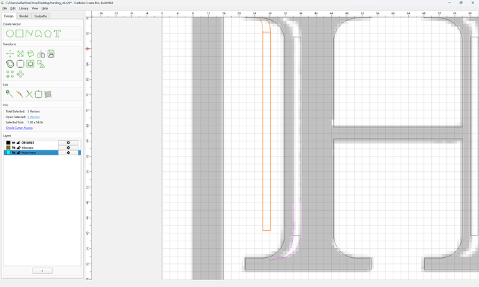

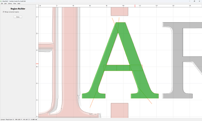

One interesting thought on cleaning up is that one can draw additional geometry, then use the Region Builder to avail one’s self of it to clean up the scanned image:
Also see:

I would encourage people to use the tracing built into Create. We’ve seen a lot of files from online converters and they don’t necessarily output the best files for CNC use. Some of them are pathologically bad.
Create uses an algorithm similar to Inkscape, but we tweaked it to be better for CNC use, so you’ll typically get better results from Carbide Create using “normal-sized” images. Inkscape is better at taking very low resolution image (think icon-sized) and creating a vector, but those are rarely useful when scaled up to a usable dimension. (This is not a fault of the algorithm in Inkscape; it’s actually pretty neat, but it’s not what most people are looking for).

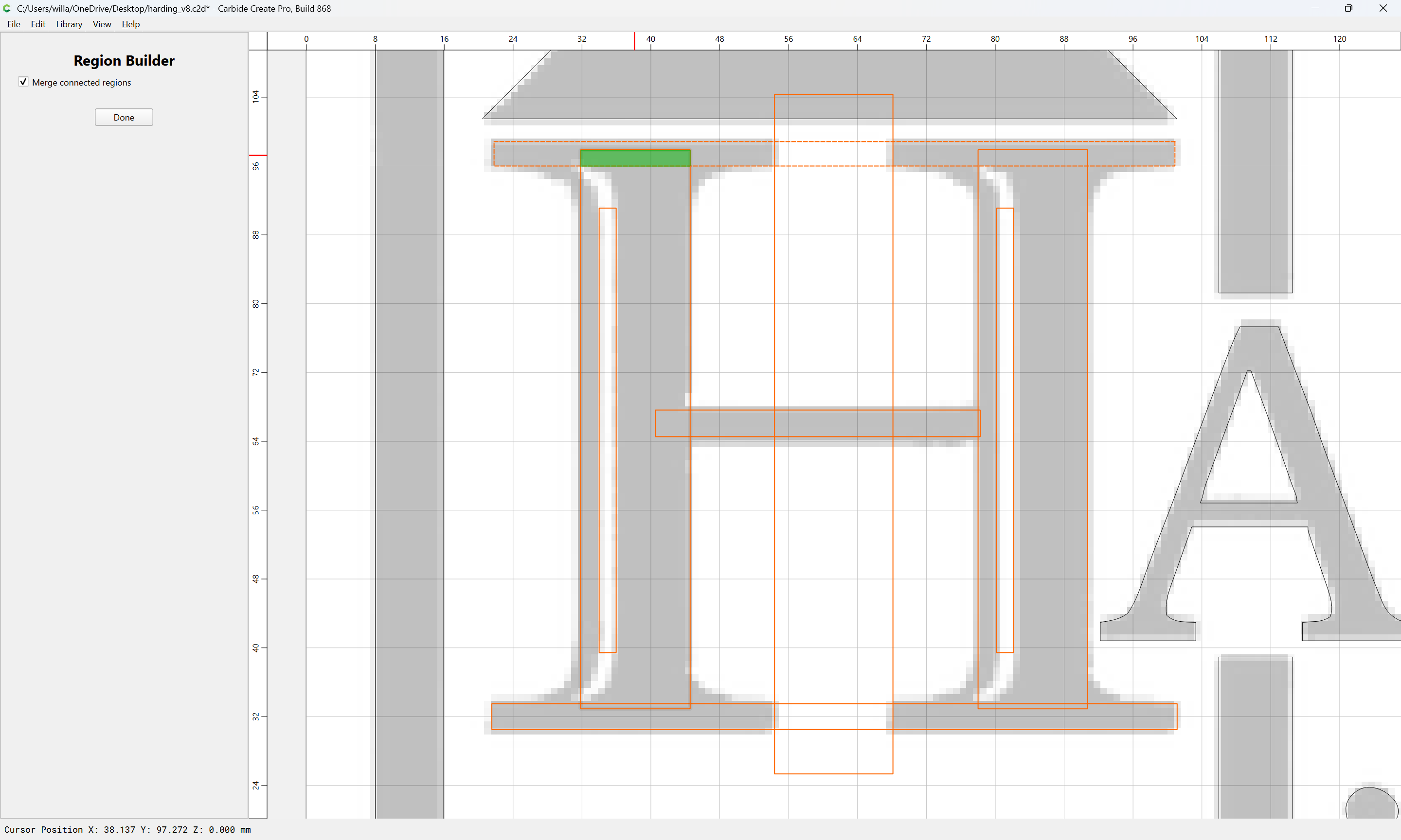

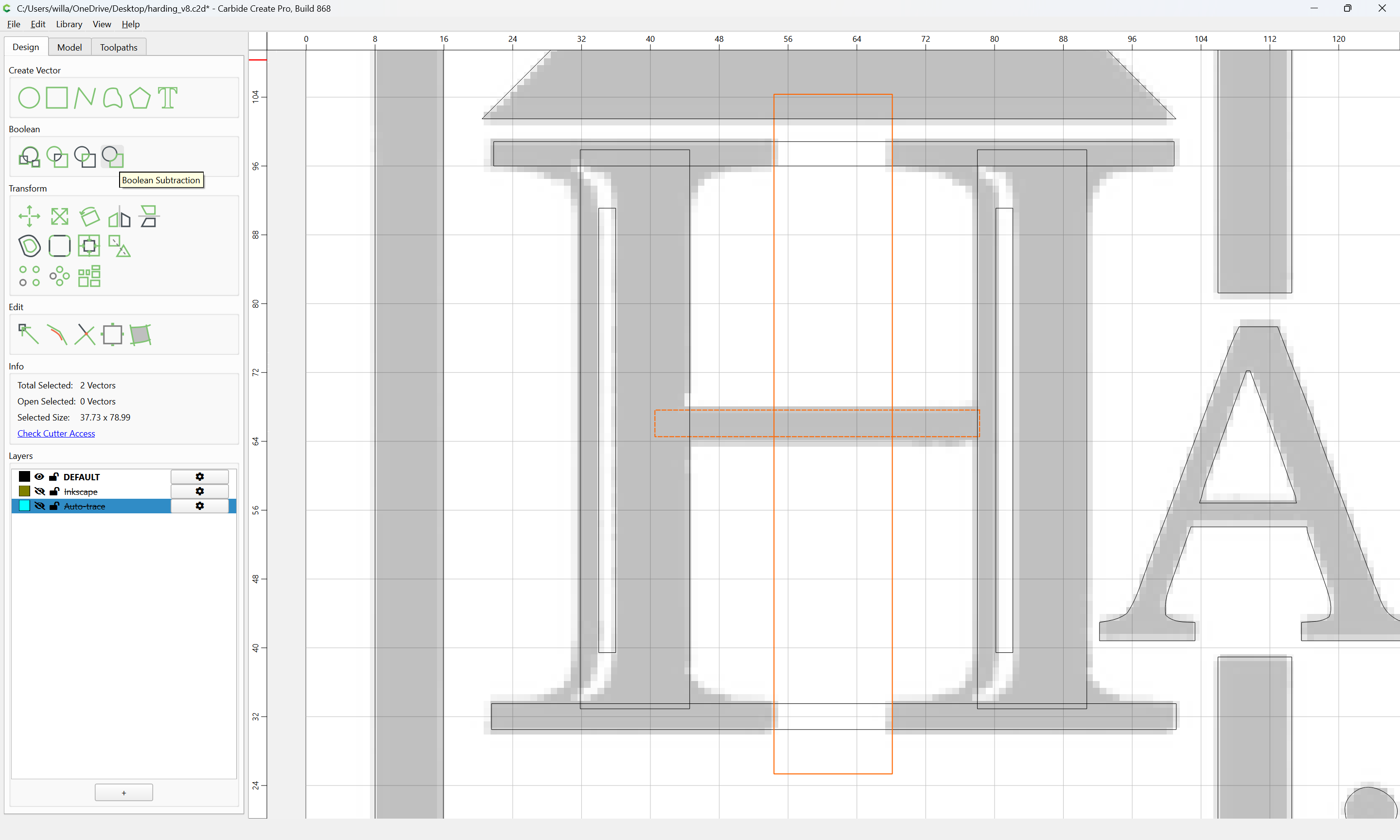

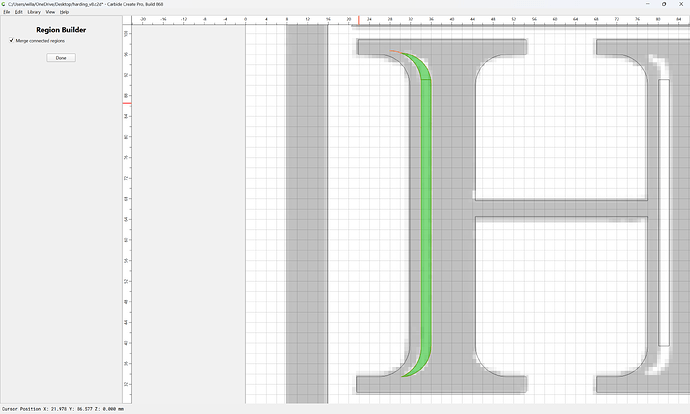

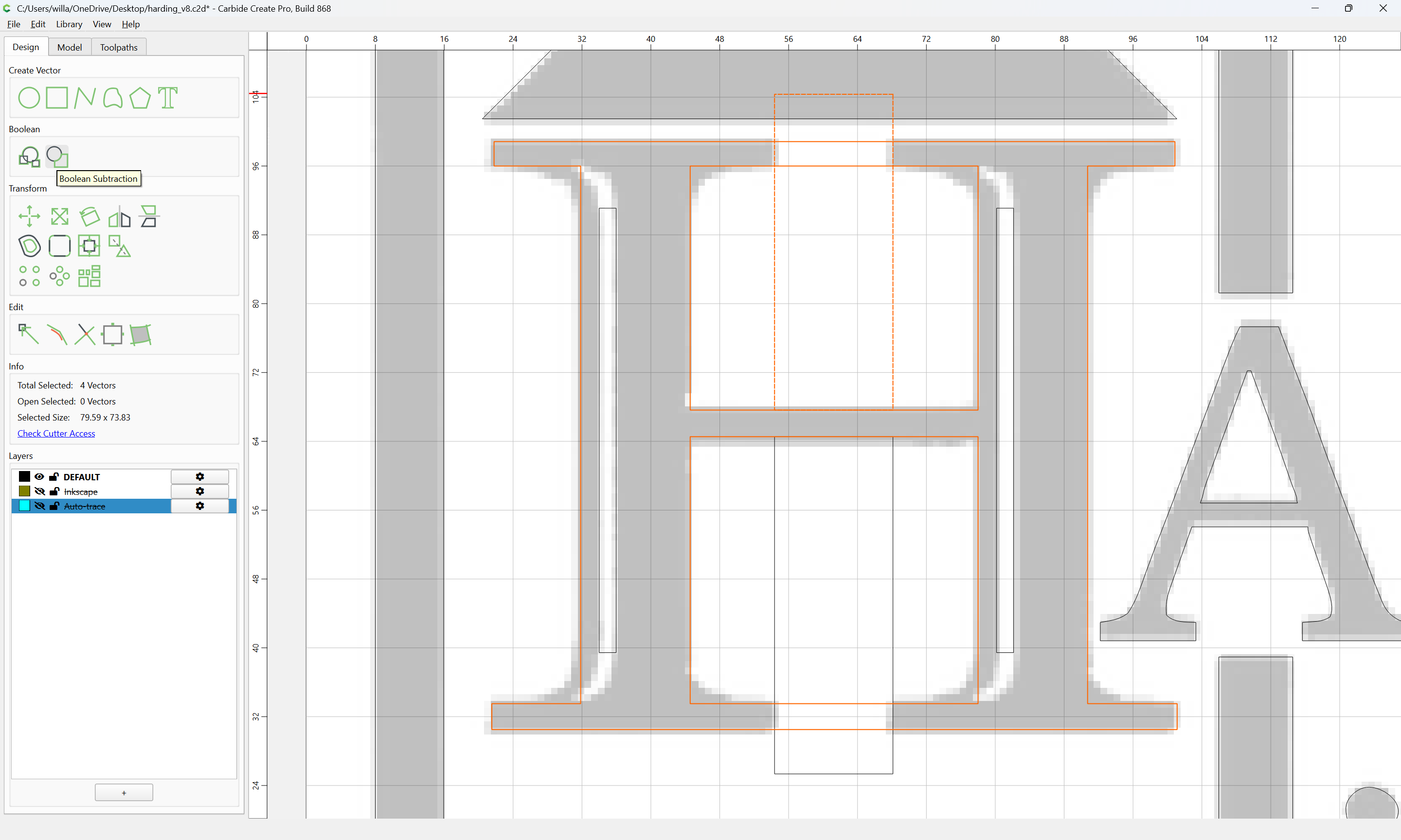

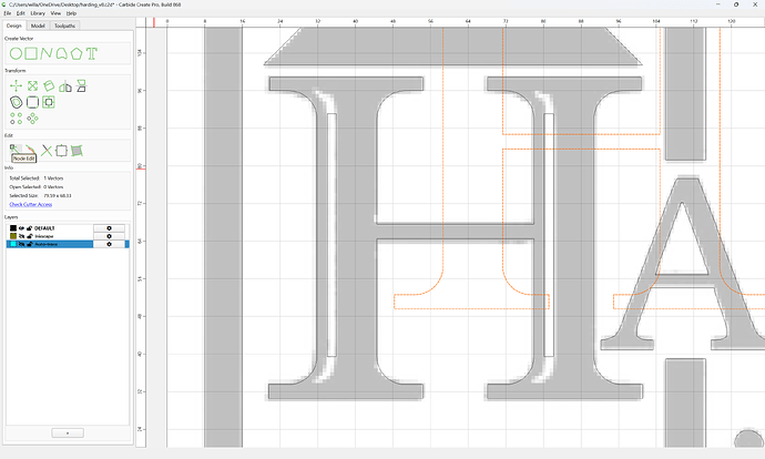

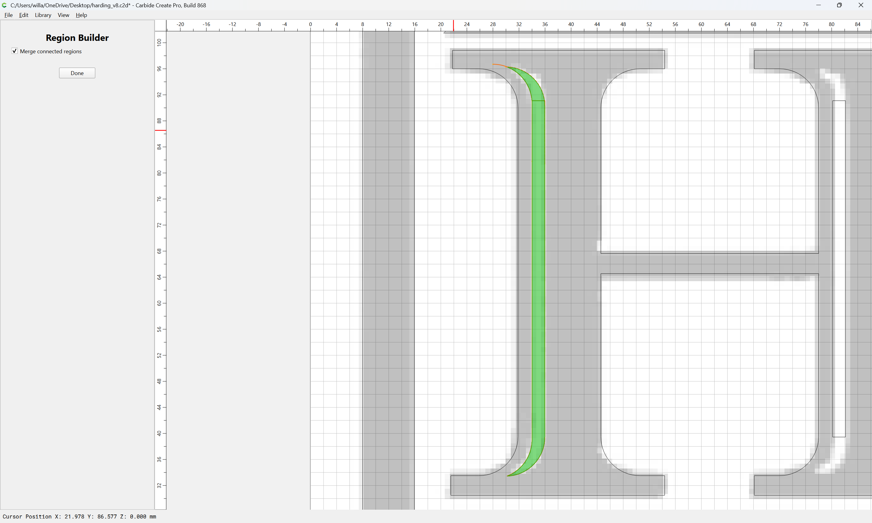

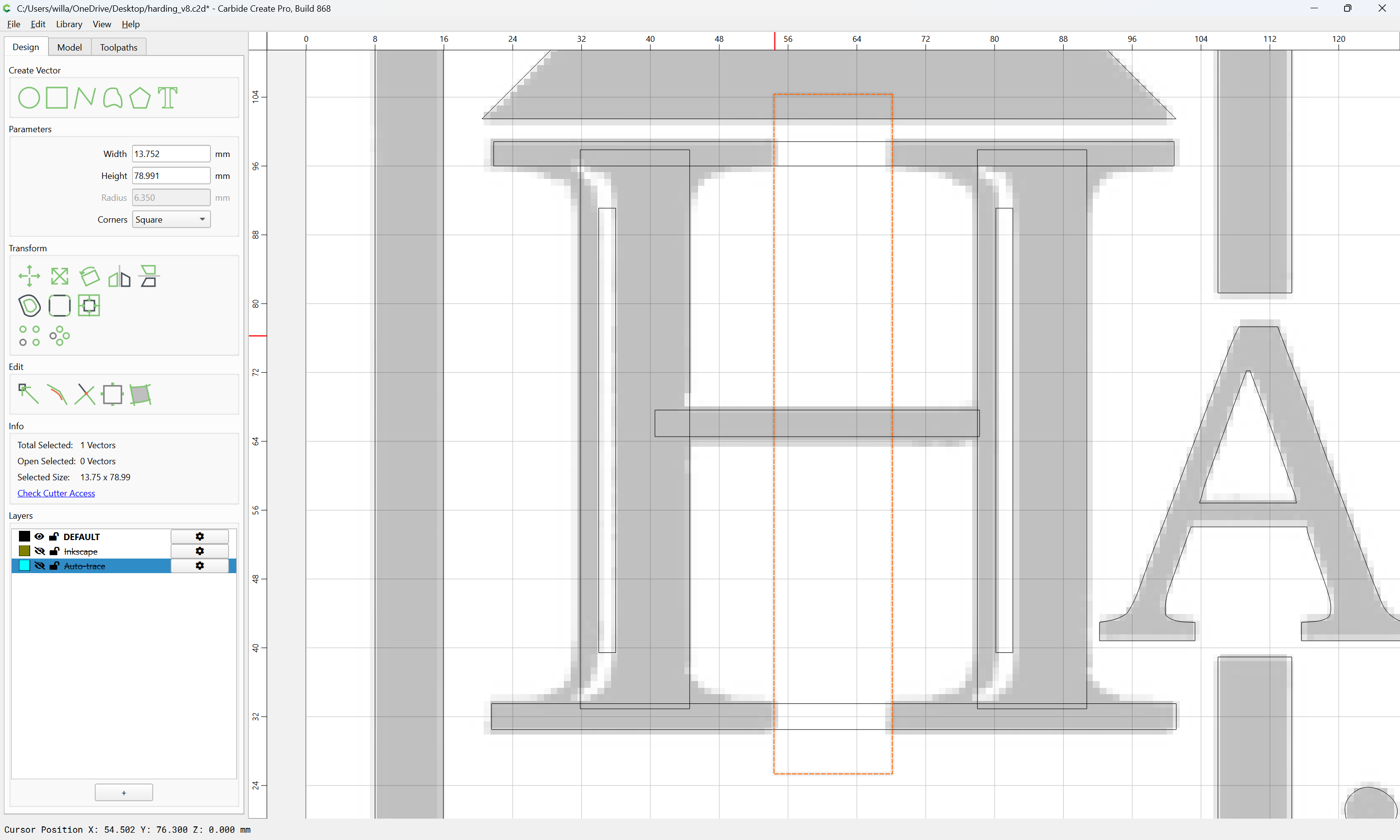

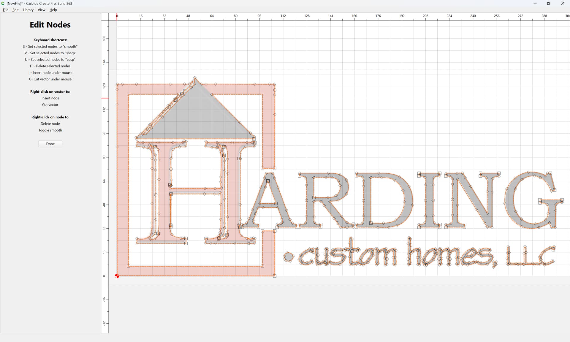

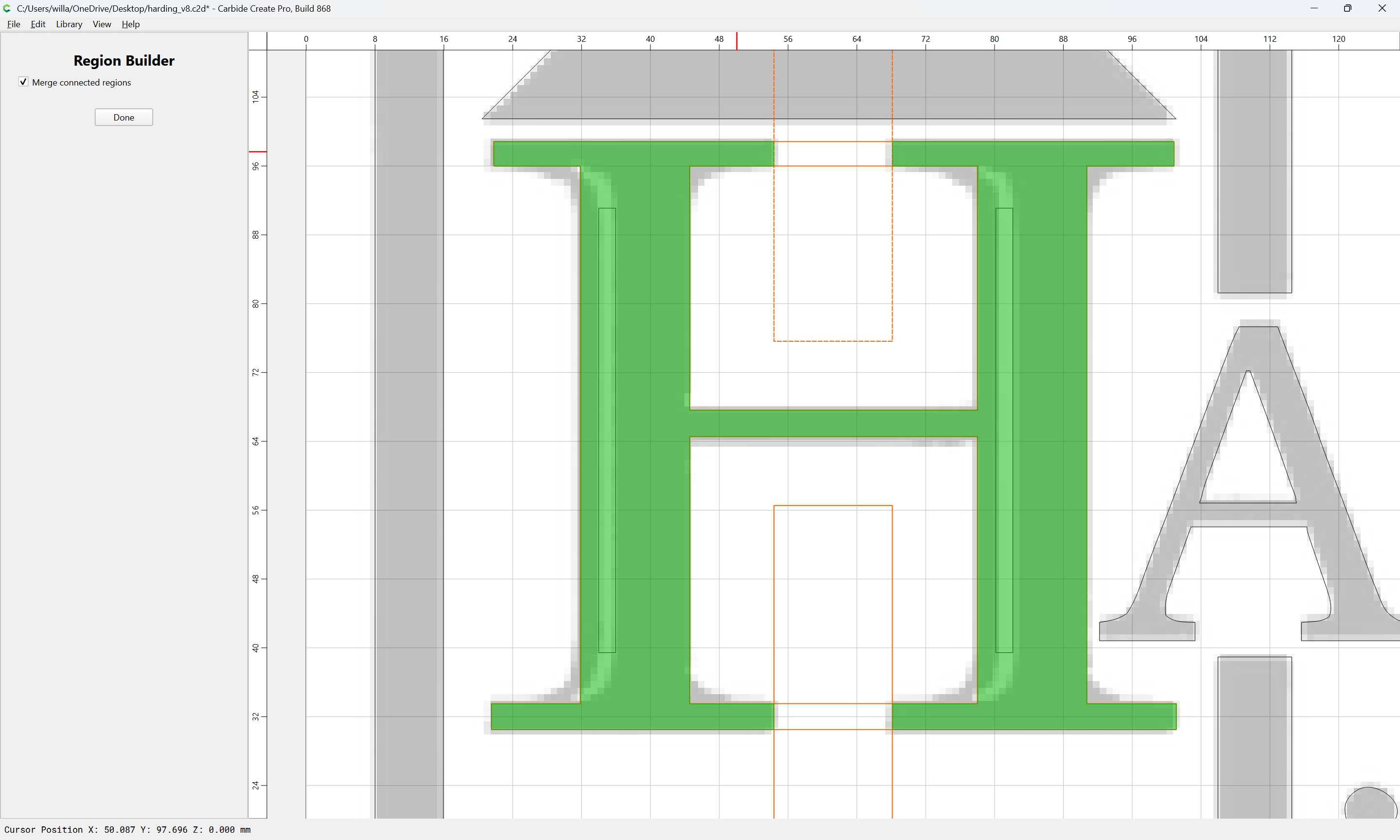

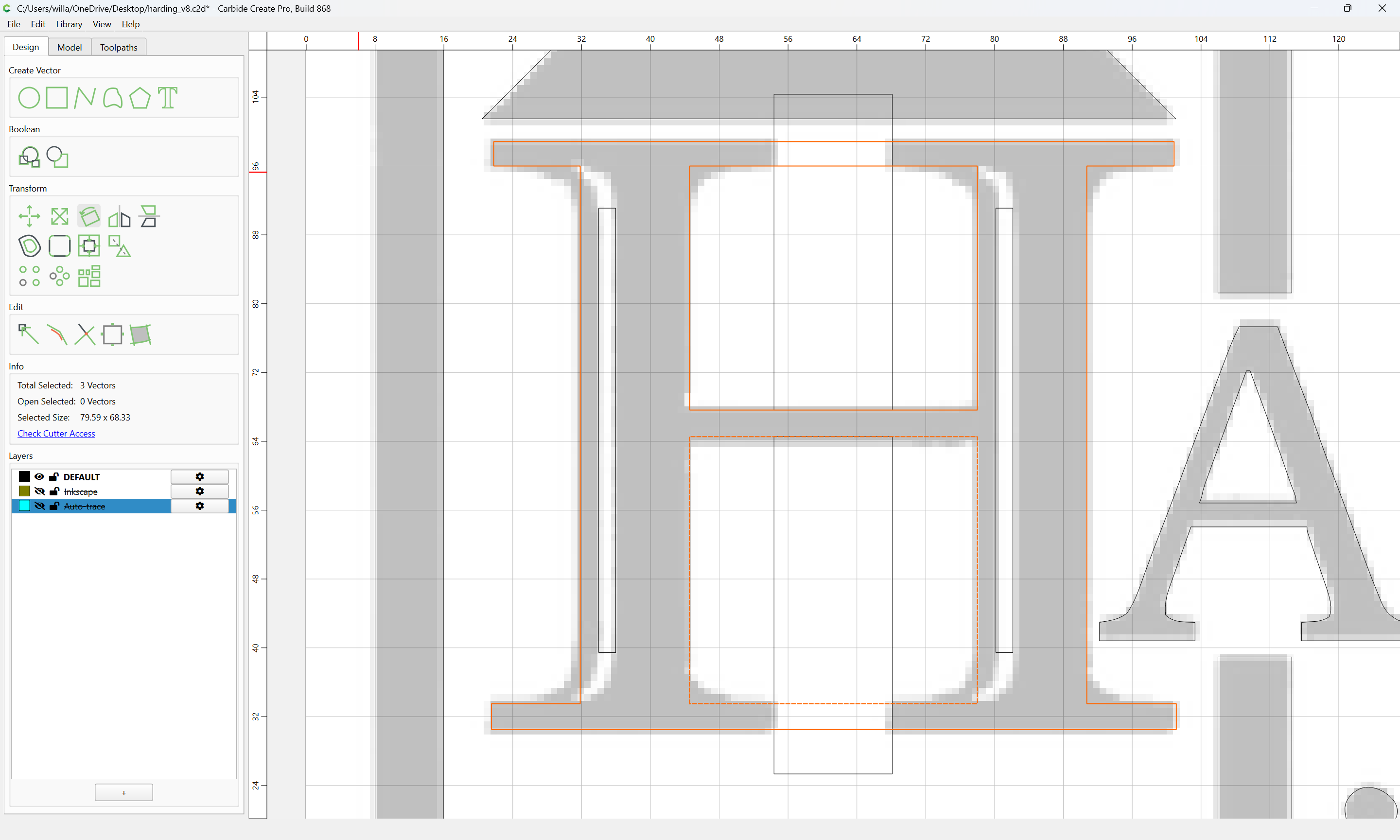

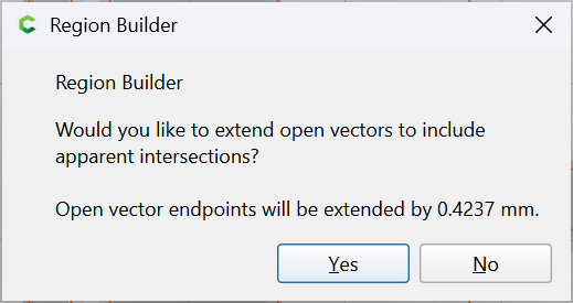

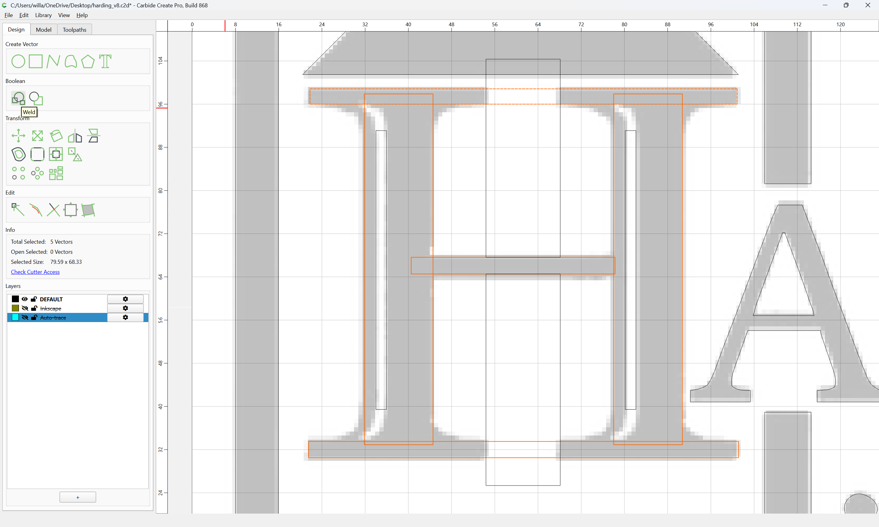

The H is pretty easily drawn up using rectangles:
and then constructed using the Region Builder:
Yes
Done

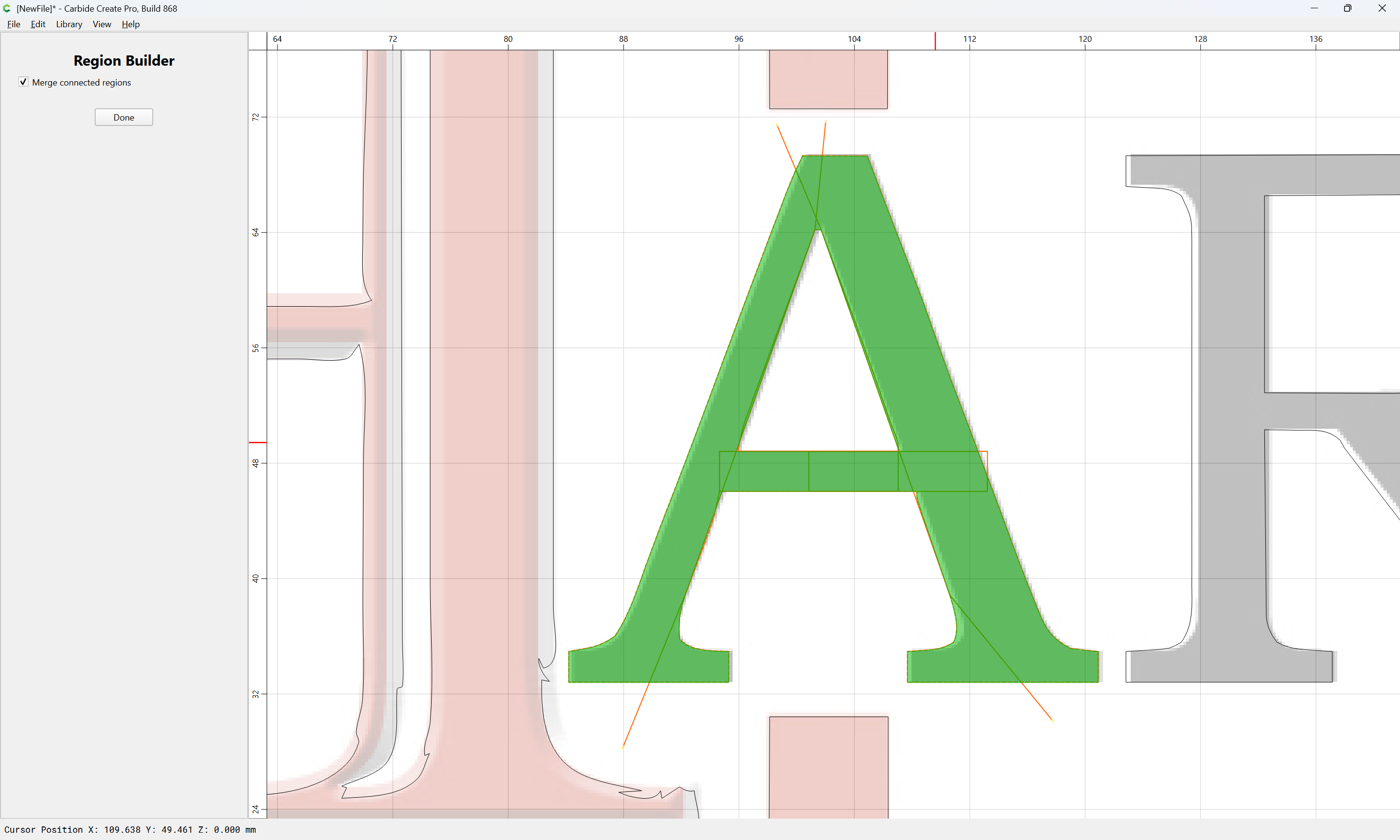

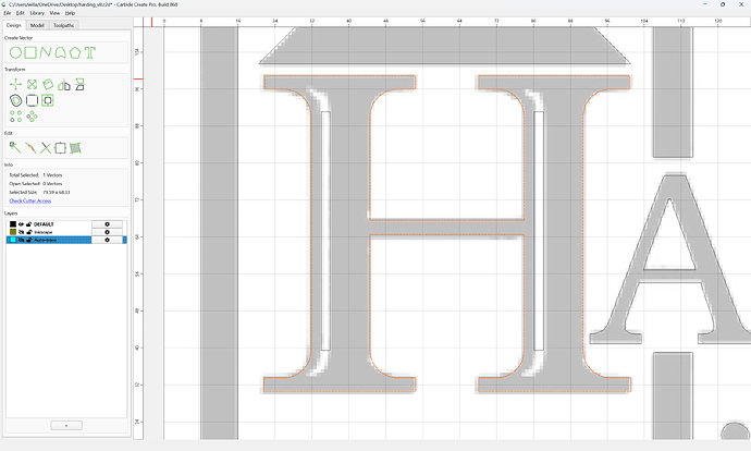

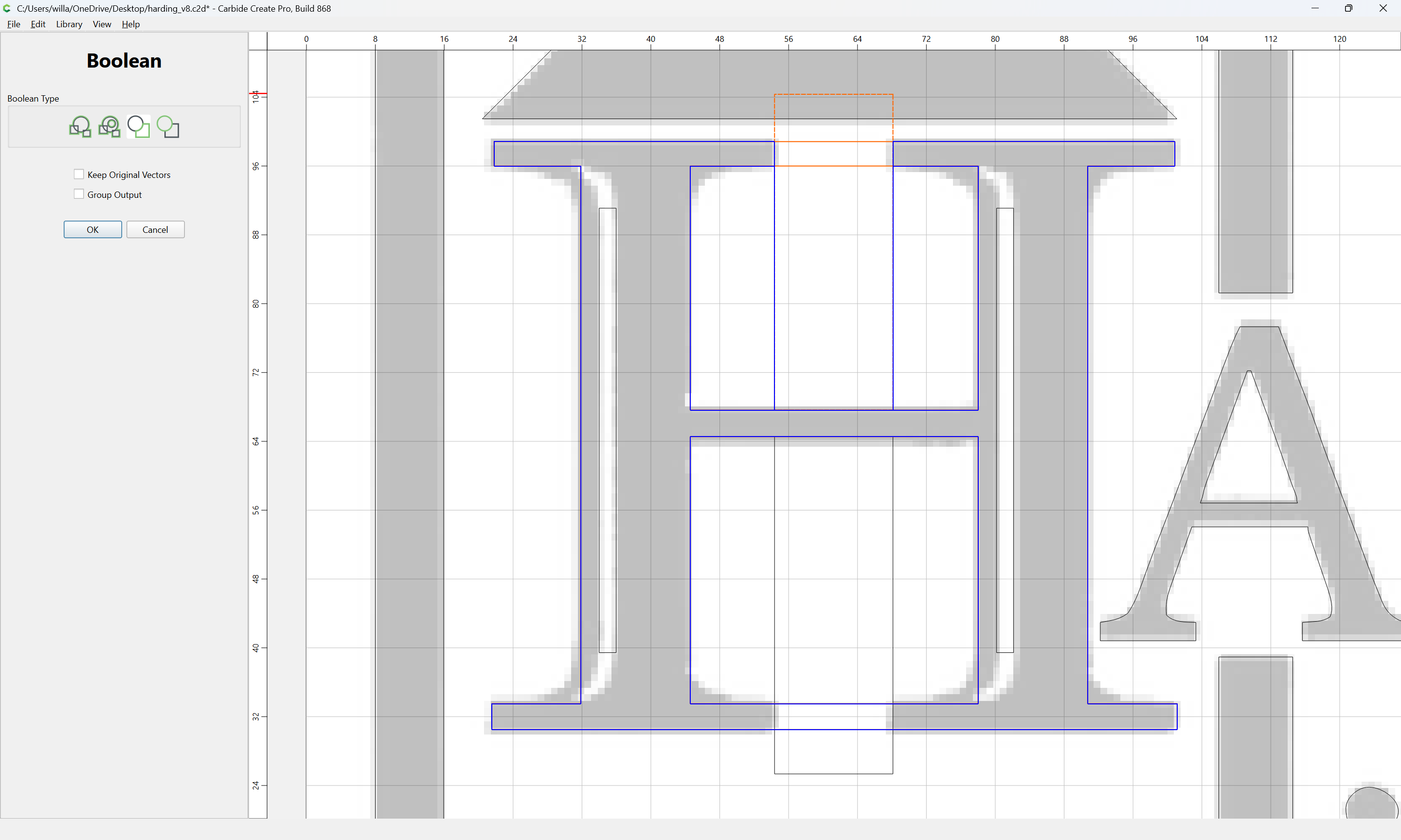

Or, use Boolean Operations:
and then apply the Region Builder:

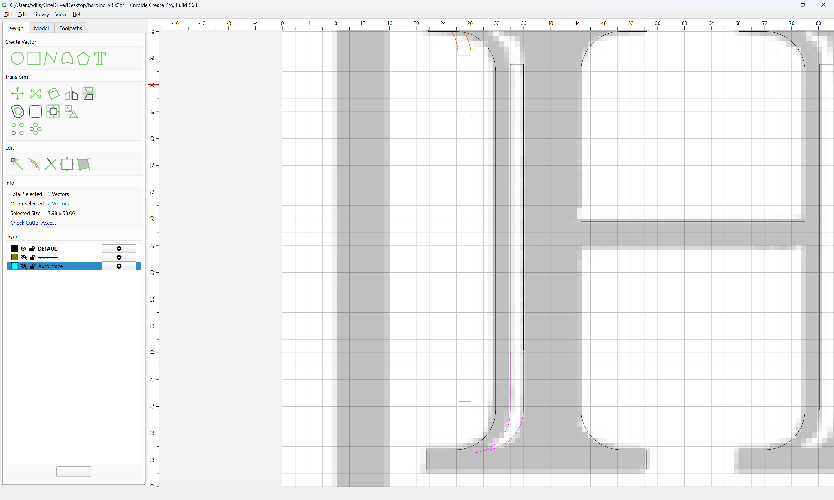

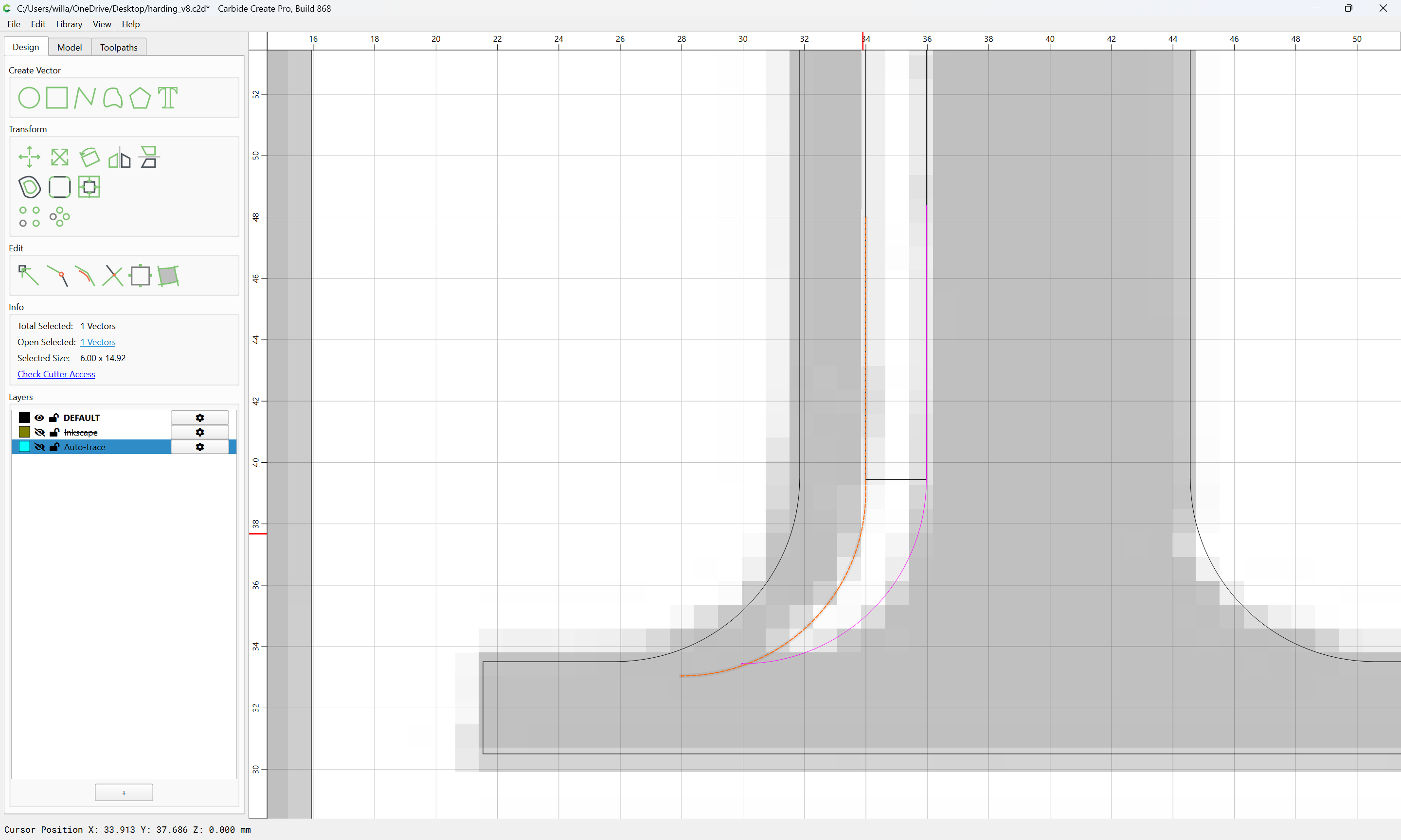

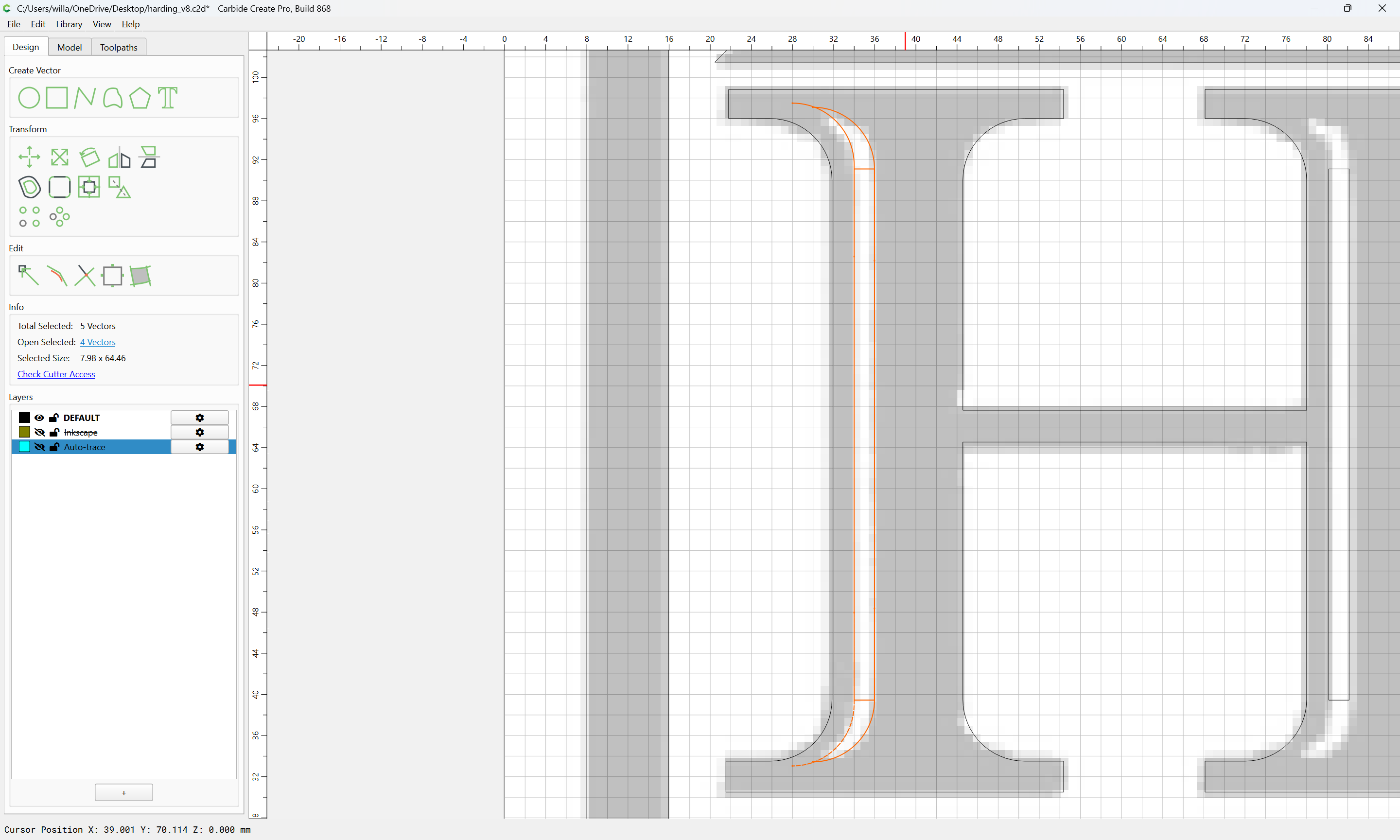

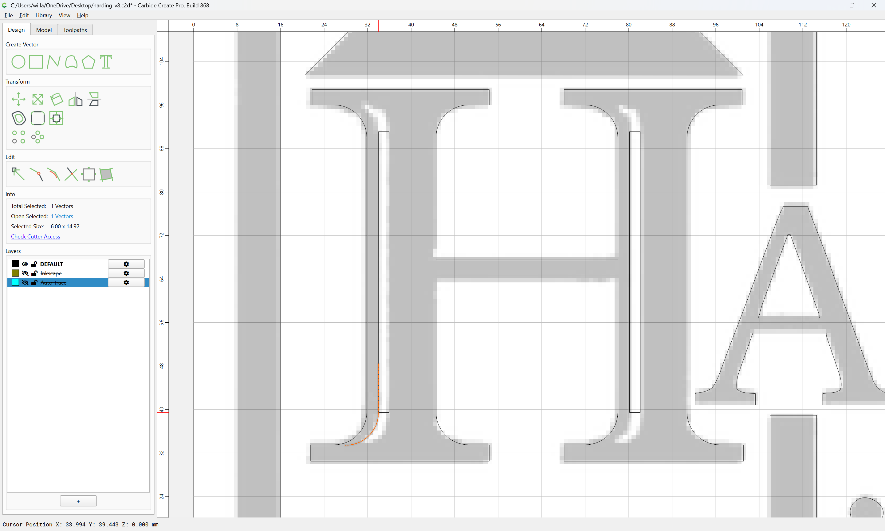

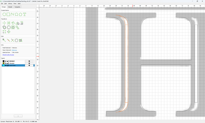

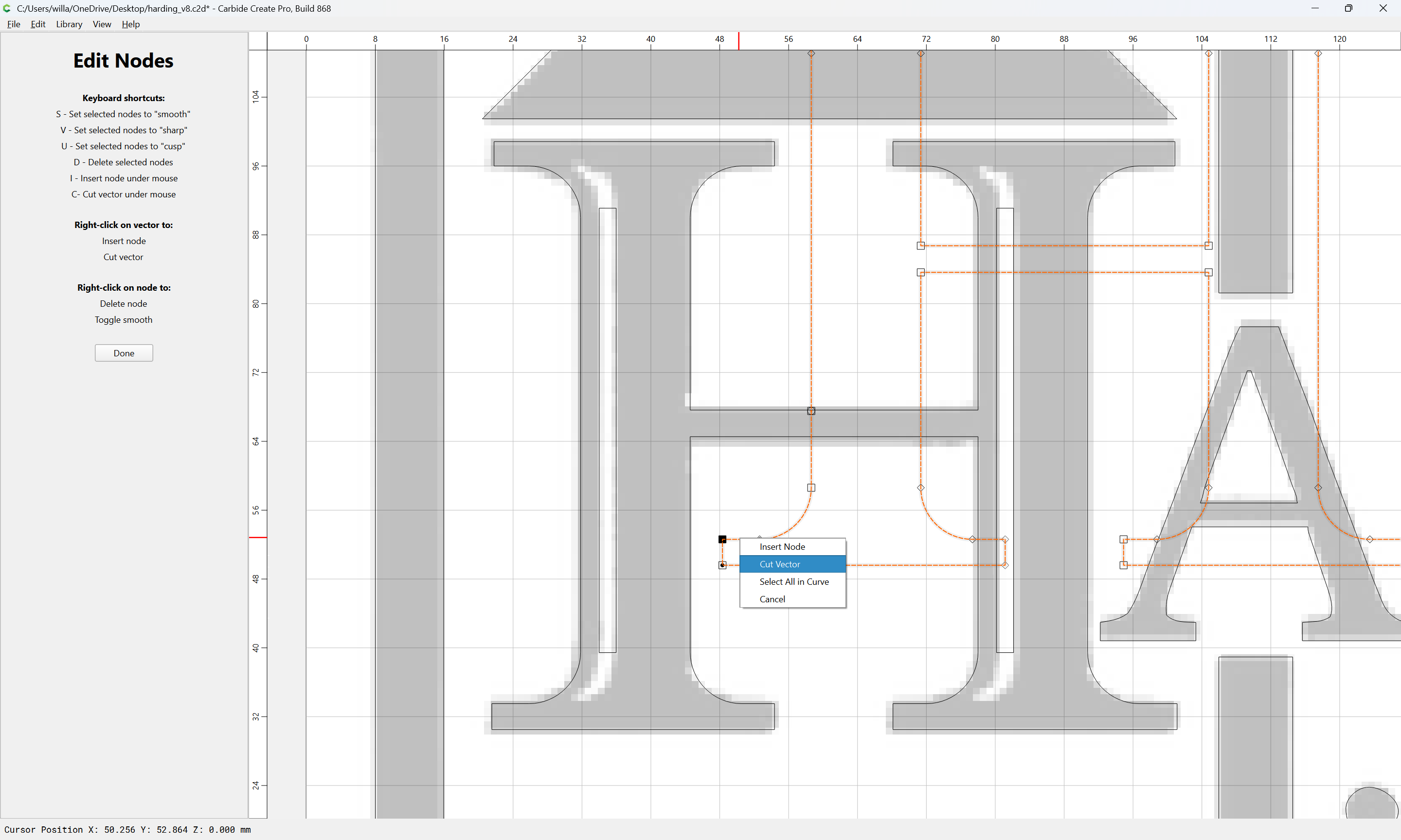

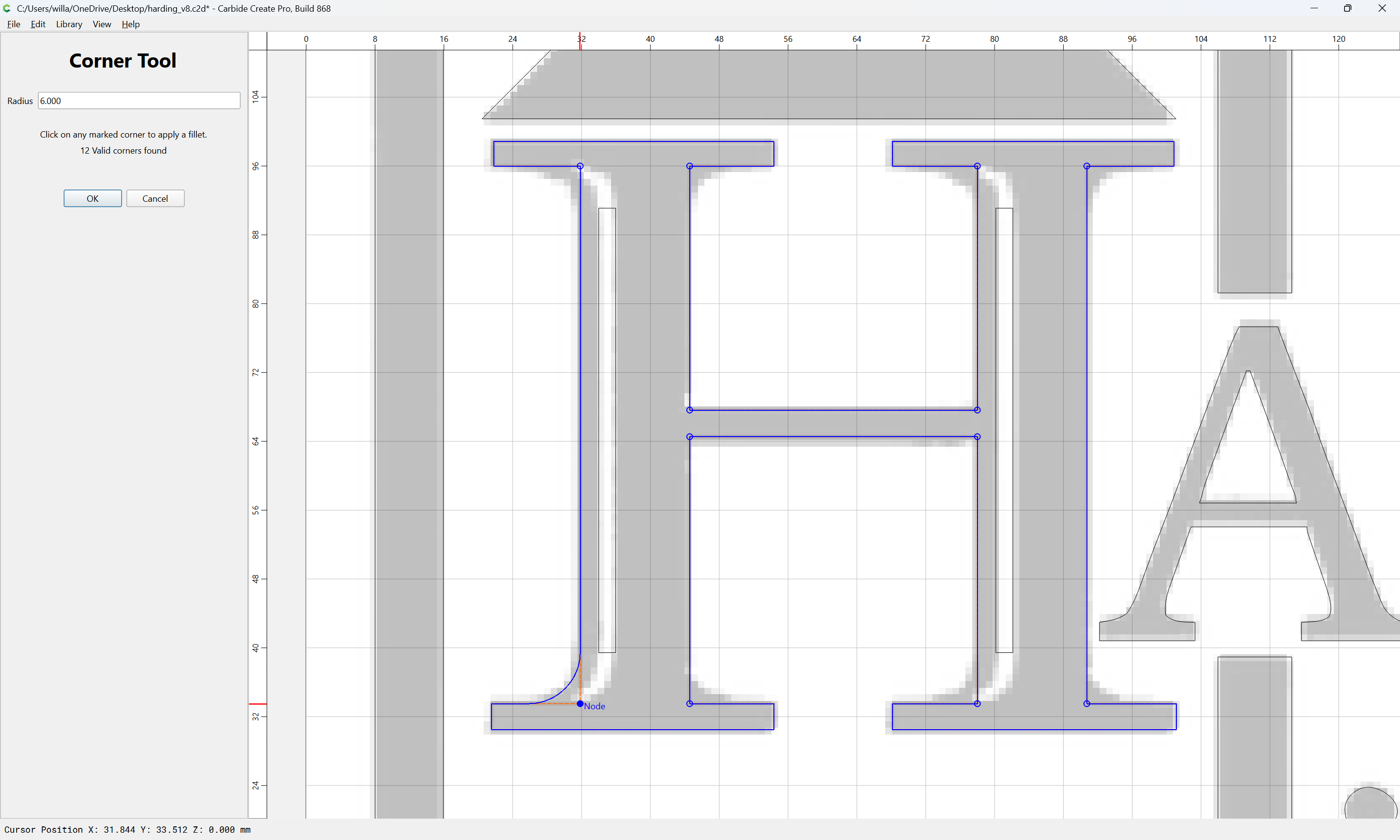

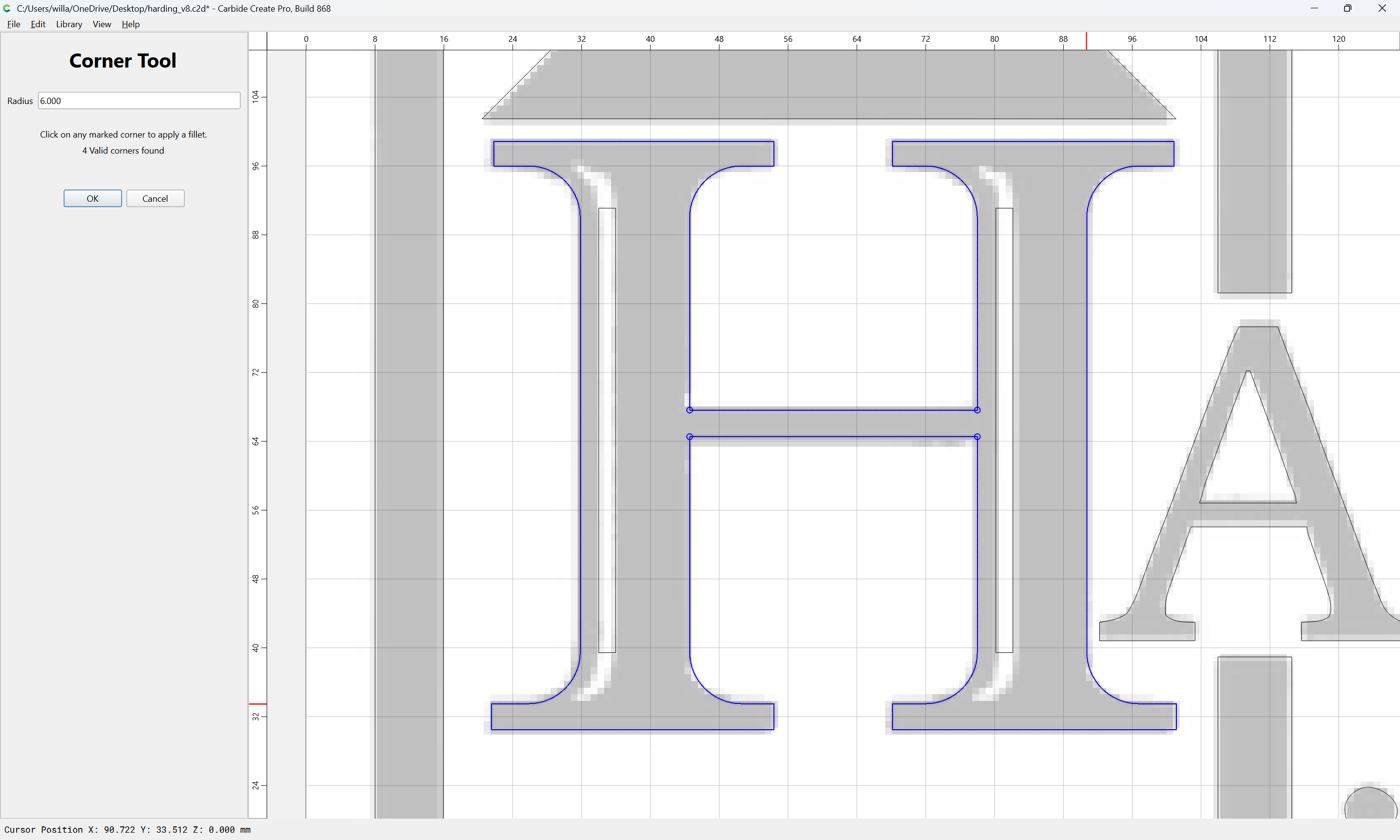

Then use the Corner Tool to round things off:
OK

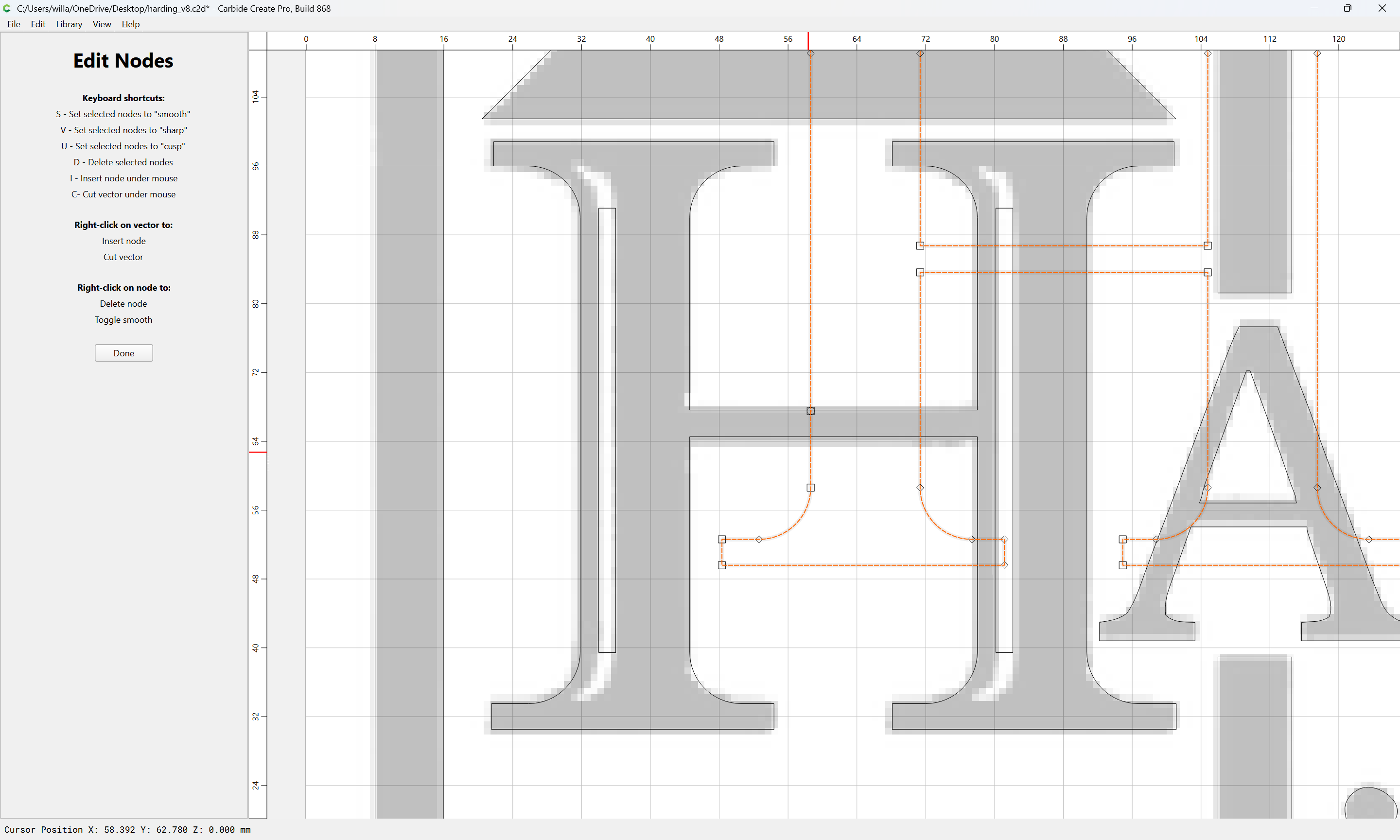

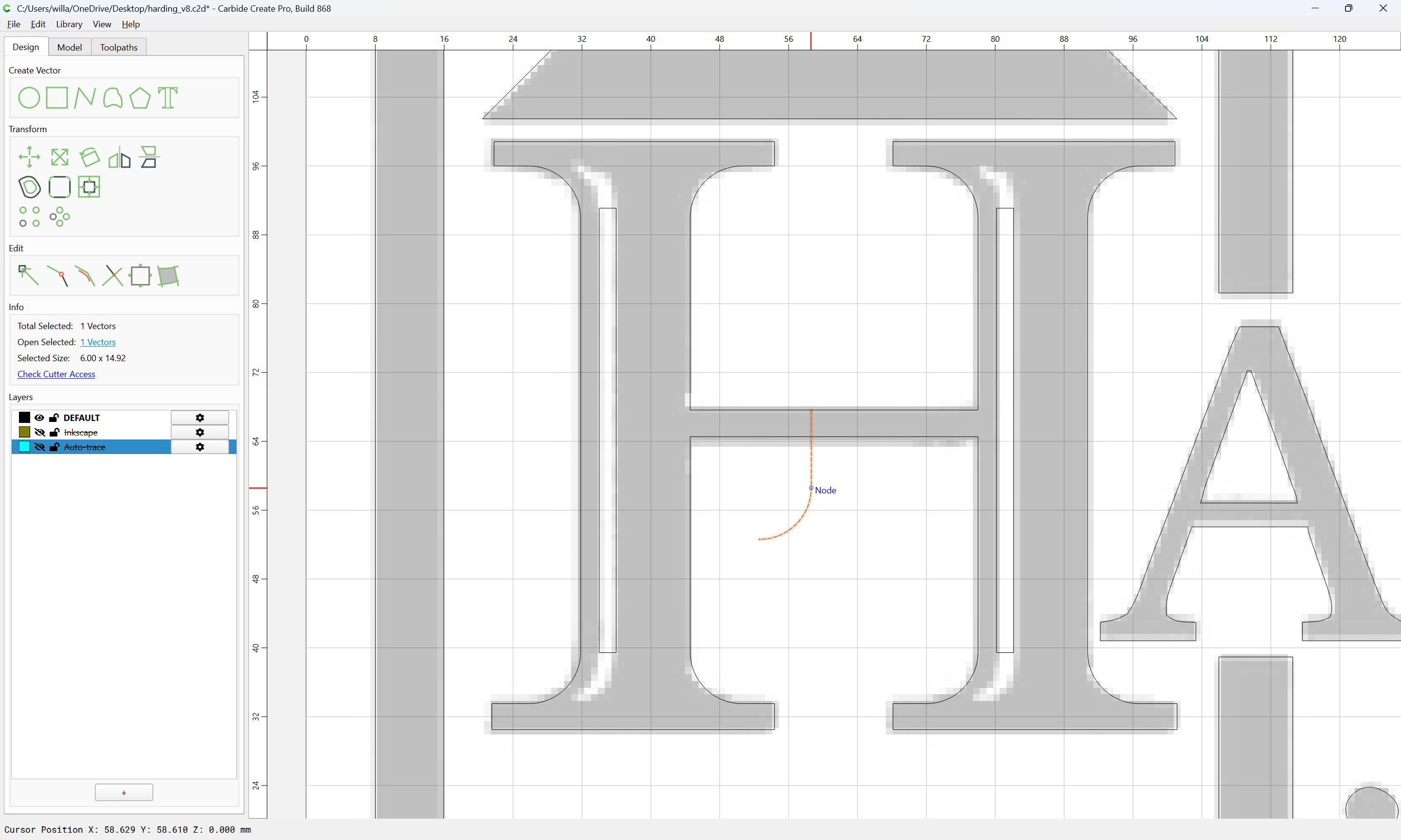

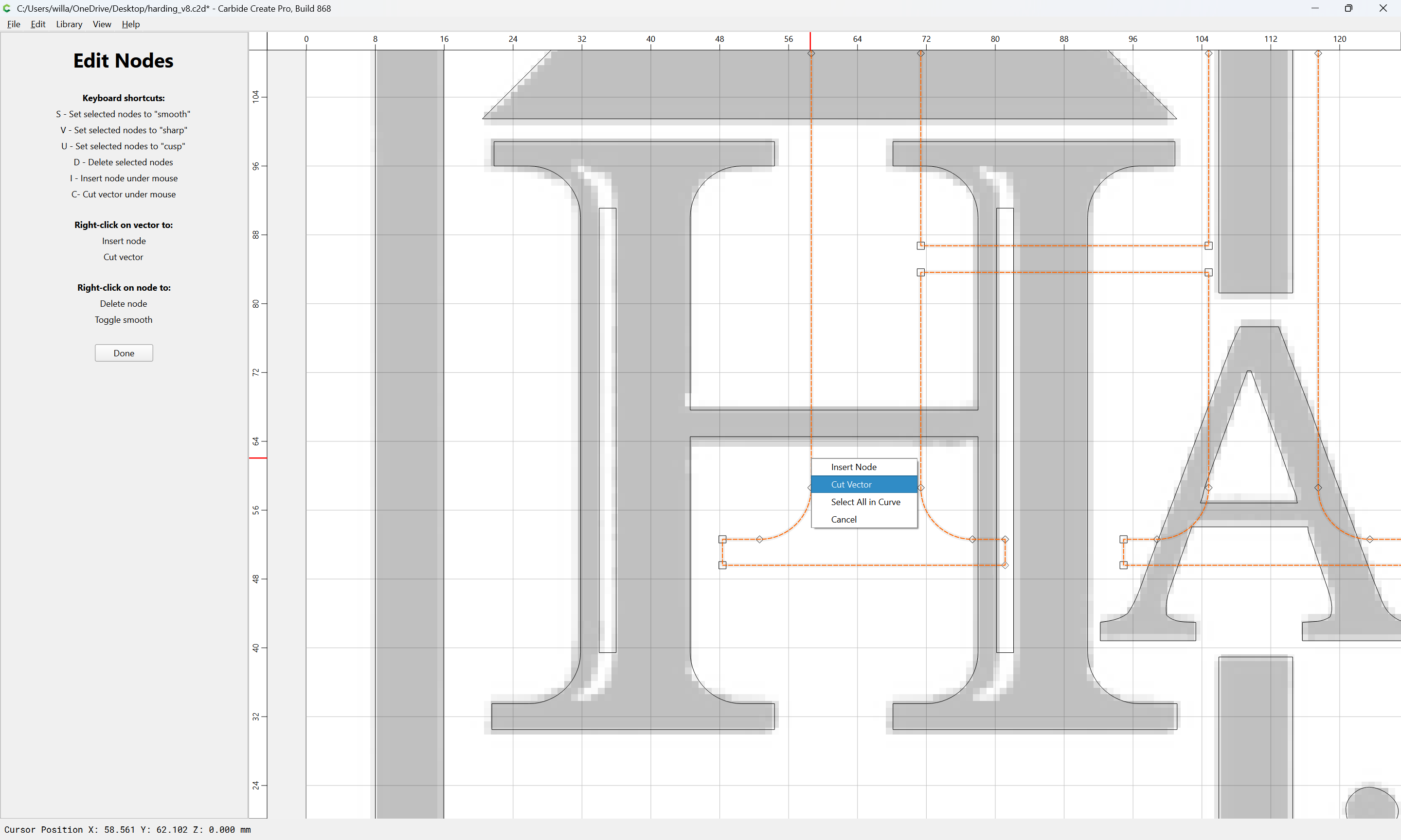

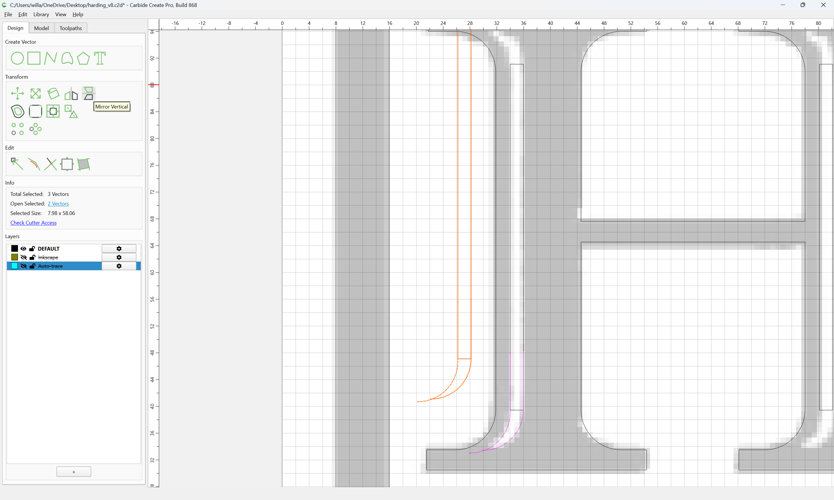

Then copy-paste what one has:

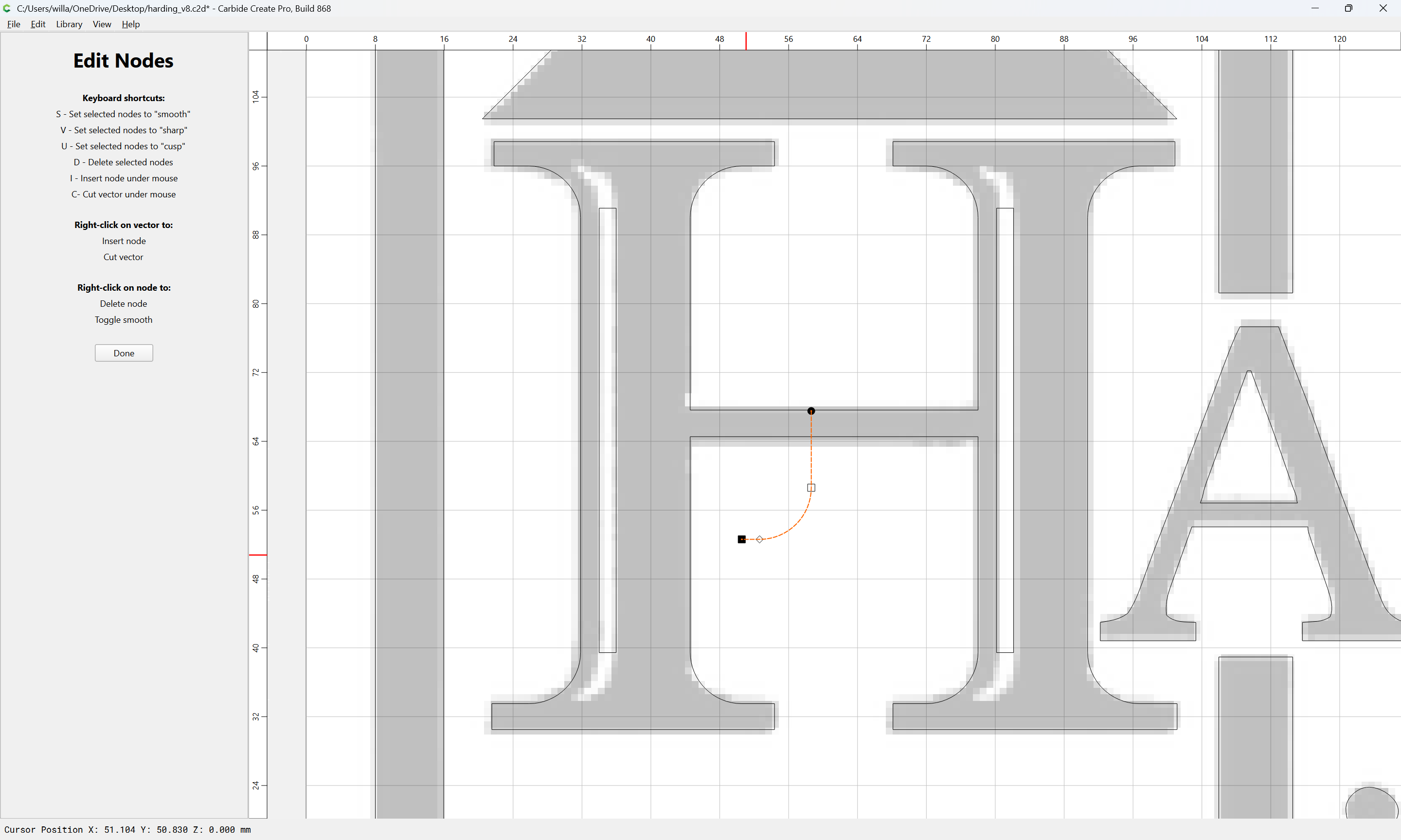

and use Node Editing to isolate a rounded portion:
Drag it into alignment:
and duplicate and reposition as need be:

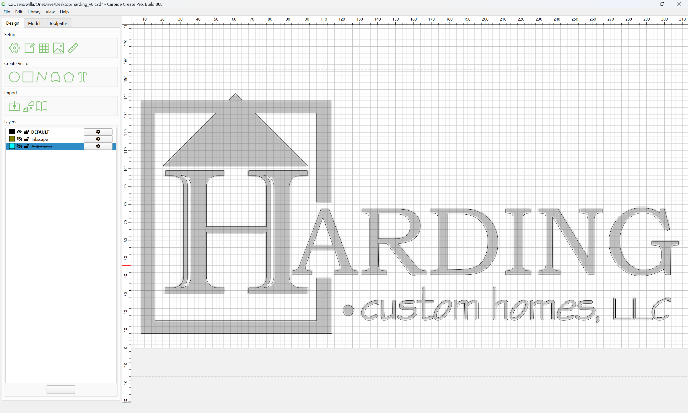

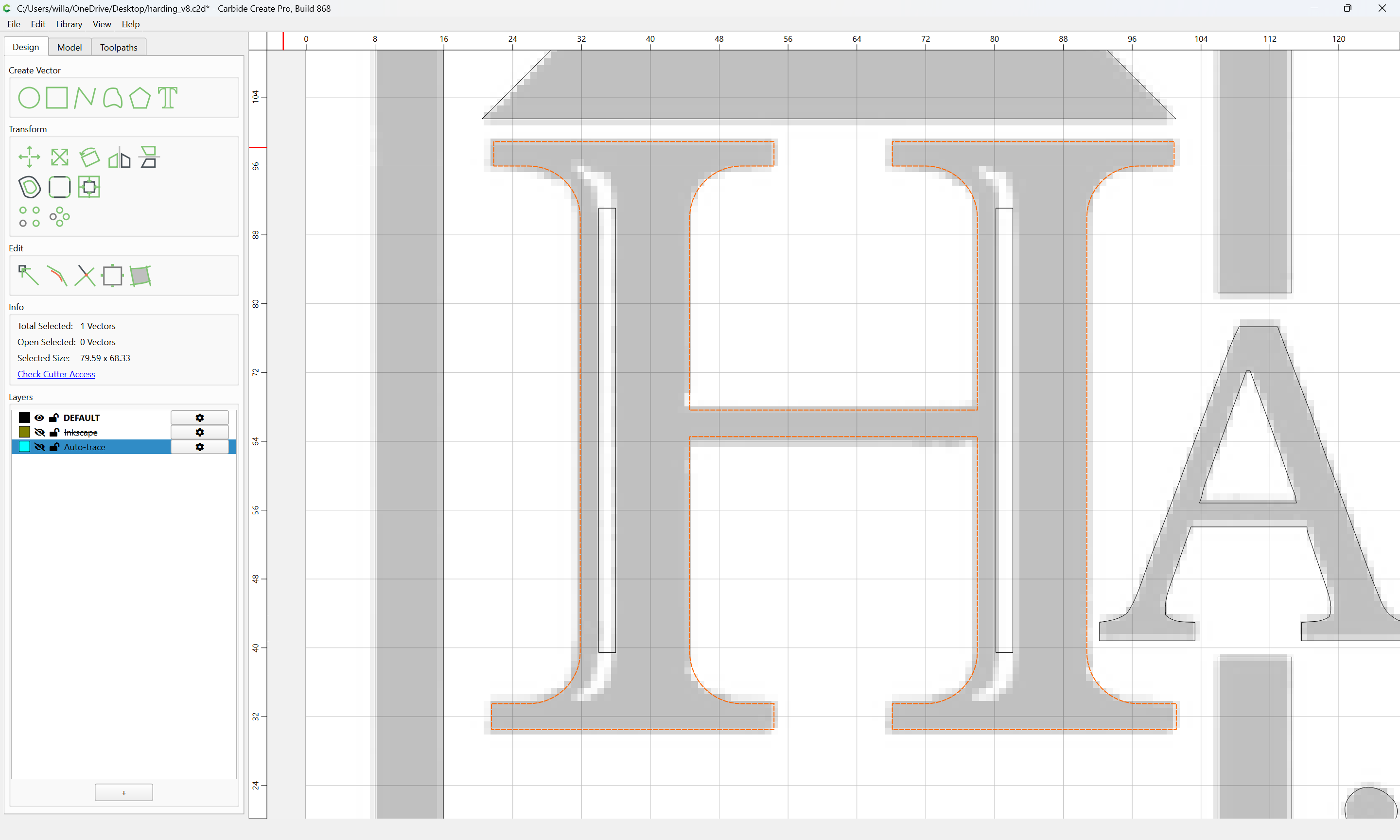

Eventually one arrives at something like:
Attached as a v8 file, w/ the other versions on hidden layers for comparison/inspection.
harding_v8.c2d (288 KB)
