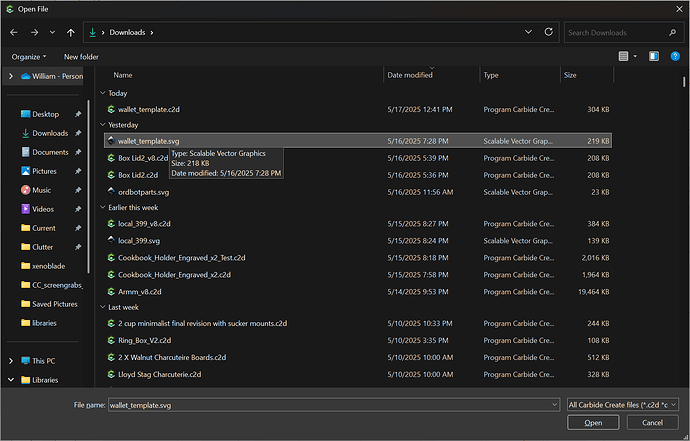

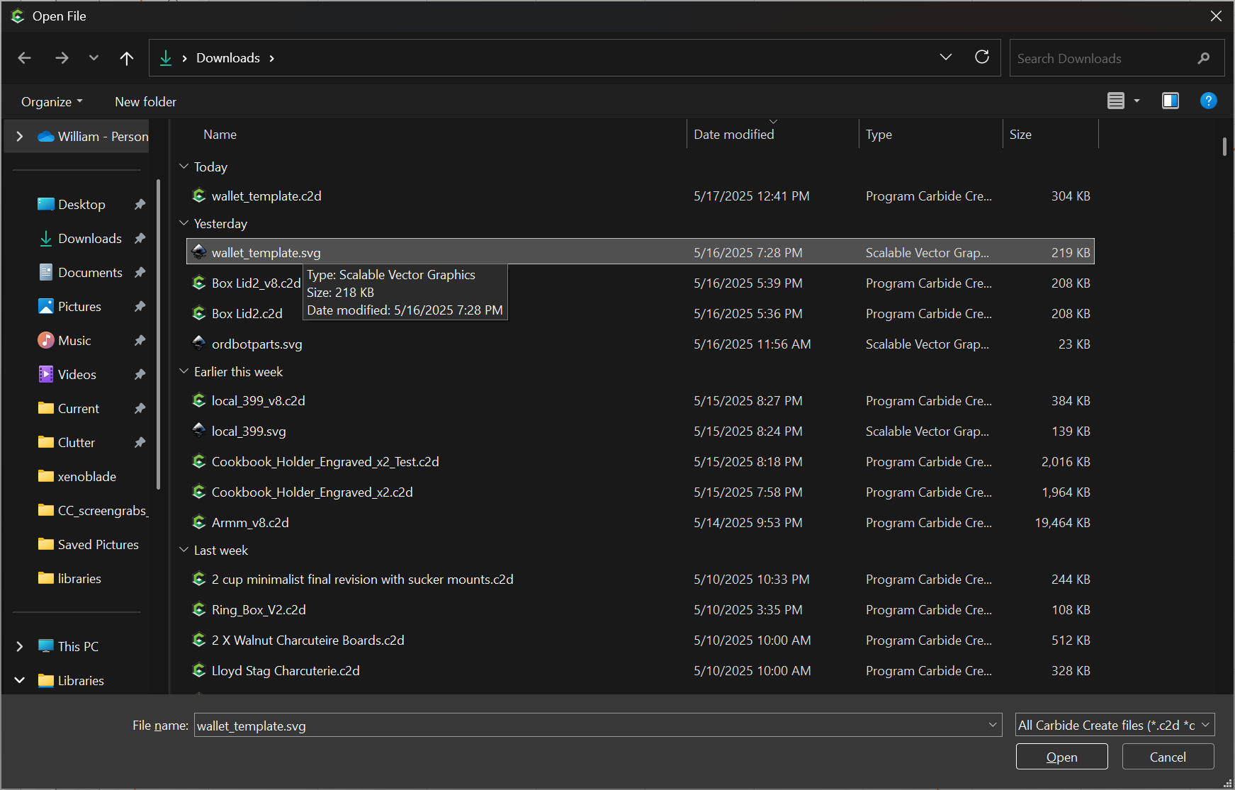

looks like you go over the file->open path, that shows *.svg-files, but does not open them.
Instead choose the import function from here
should work.
File | Open and selecting an SVG file should work.

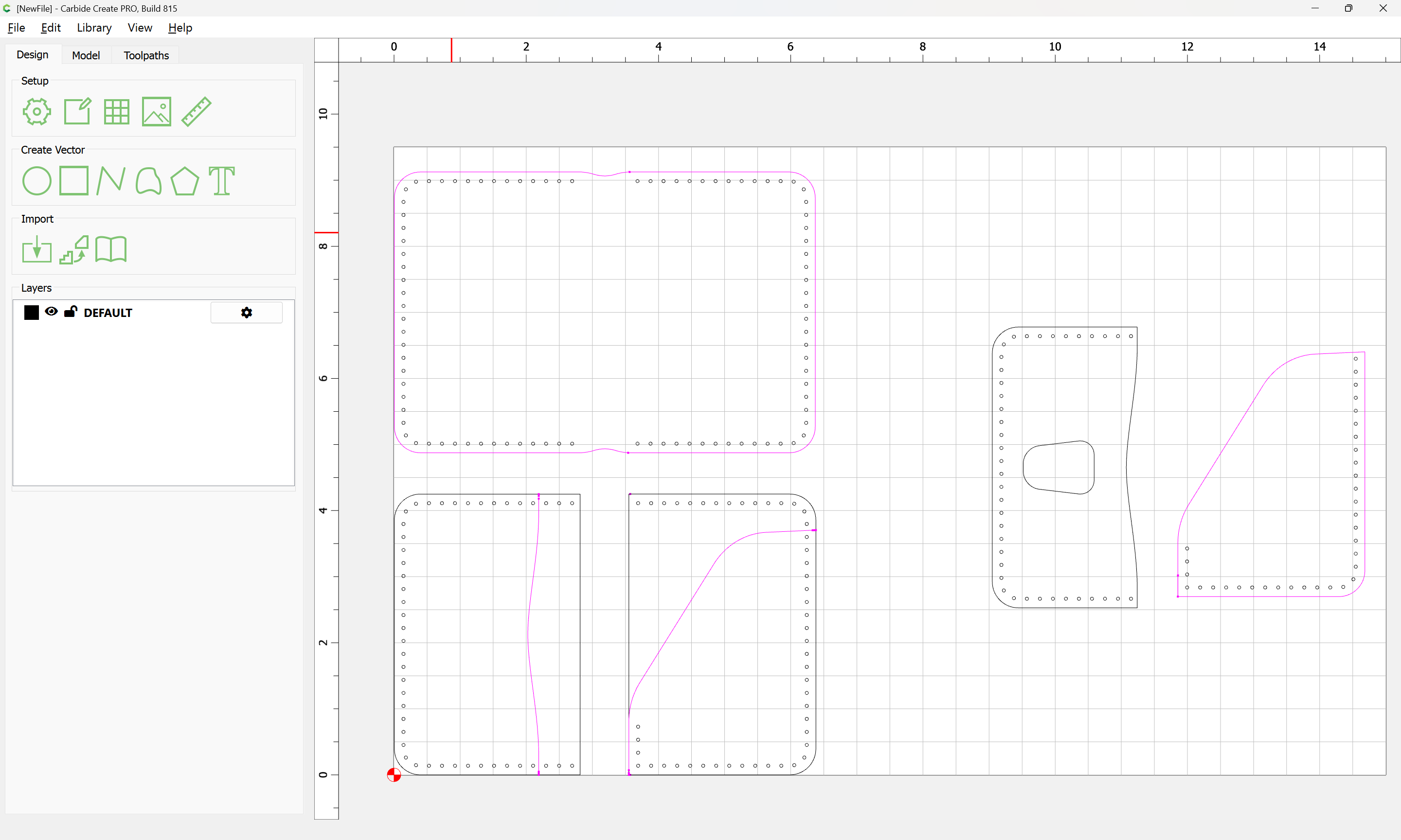

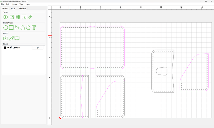

Dont feel alone. I have some SVG files that just do not open in CC. The files are valid SVG but CC just does not like them. The same SVG file will open in other programs. Seems like CC is quite particular about what SVG files it likes.
Usually such files use elements by reference — Silhouette Designer is the usual culprit.
If the files are opened up in a tool which parses such constructs, and then they are ungrouped and decomposed into Path objects (as opposed to clones), then they will open — if anyone has difficulty doing this, upload the files, or send them to support@carbide3d.com

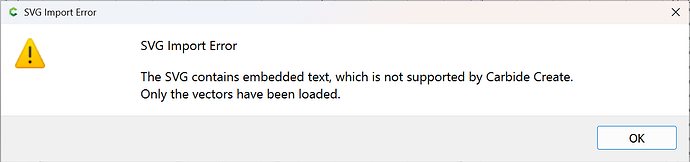

If you are using text fonts, you must explode the font into vectors for use in CC.
