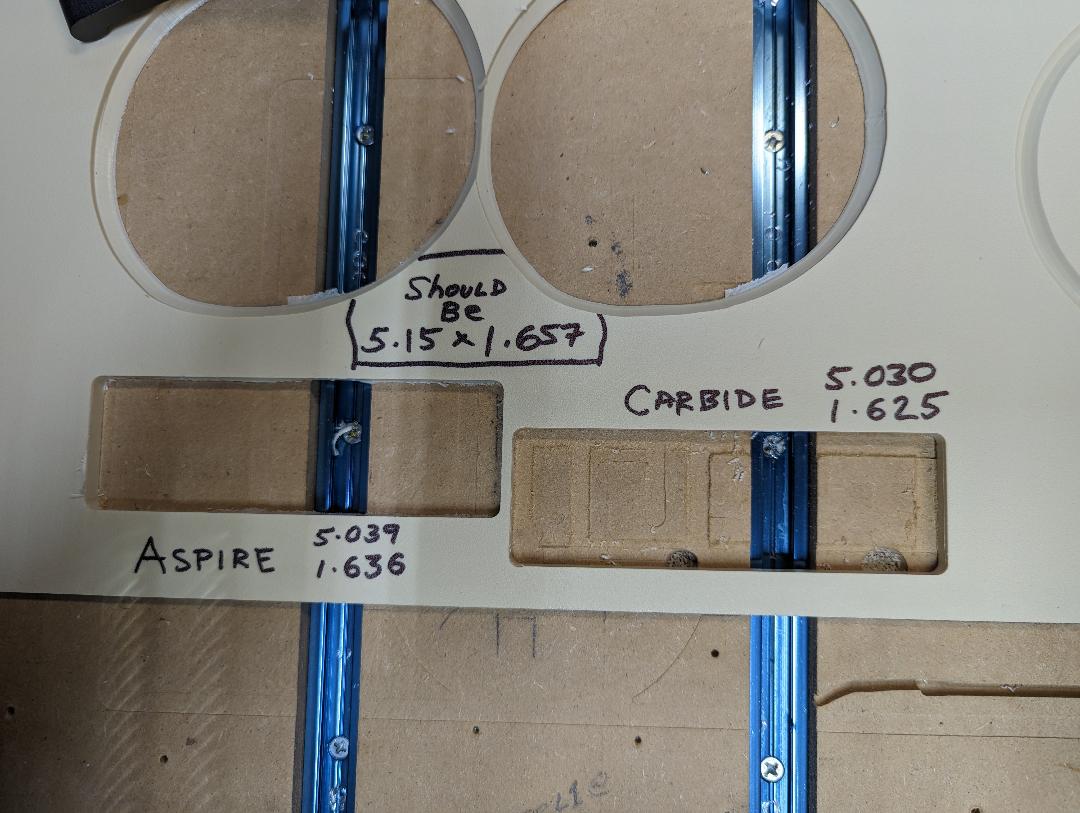

Will do. Thanks Will. Had just loaded a fresh piece of Star Board for test cuts.
Cut these with the same bit I’ve been using with no changes to any controller parameters.
Basically, both cuts are the same.
Are you cutting slots just as narrow as the tool? Where possible, avoid slotting.
Both tool paths are perimeter cuts the width of the tool: 0.247
Add offset geometry and cut as a pocket down to tab height or the penultimate pass — leave a roughing clearance and take a full-depth finishing pass.
I actually just finished doing that. I created a second rectangle 0.010 smaller and set 2 tool paths, one for each vector. I also decreased the $100 to 39.000. Helped. I’m going to change that again and recut over what I just cut.
Rather than randomly changing steps/mm value have you tried calibrating?
Will, this is getting crazy. I adjusted, after calibrating, the $100 which was the only one showing out of spec. I did another cut and it came out perfect.
I moved the machine X & Y over for a clean cut and re zeroed both, leaving the Z alone. Ran the cut. Did not duplicate the cut next to it at all. It came out 0.207 (X) smaller! Y was .01 smaller. How is this possible?
Do I need to re flash the control board?
