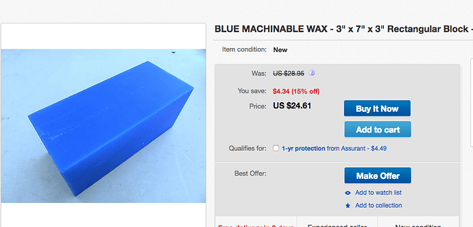

(mikep) #4
Wax turns out to be more expensive than you would think (2x3x5 = $10, 1.5"x2x3=$7 -> more expensive than renshape in small quantities), and although its reusable it’s got a hassle factor to do so I just don’t need.

My Fav: MACHINABLE WAX
It’s last’s forever.
Machine it, collect it, melt it, mold it (99 Cent loaf pan), over and over again…
