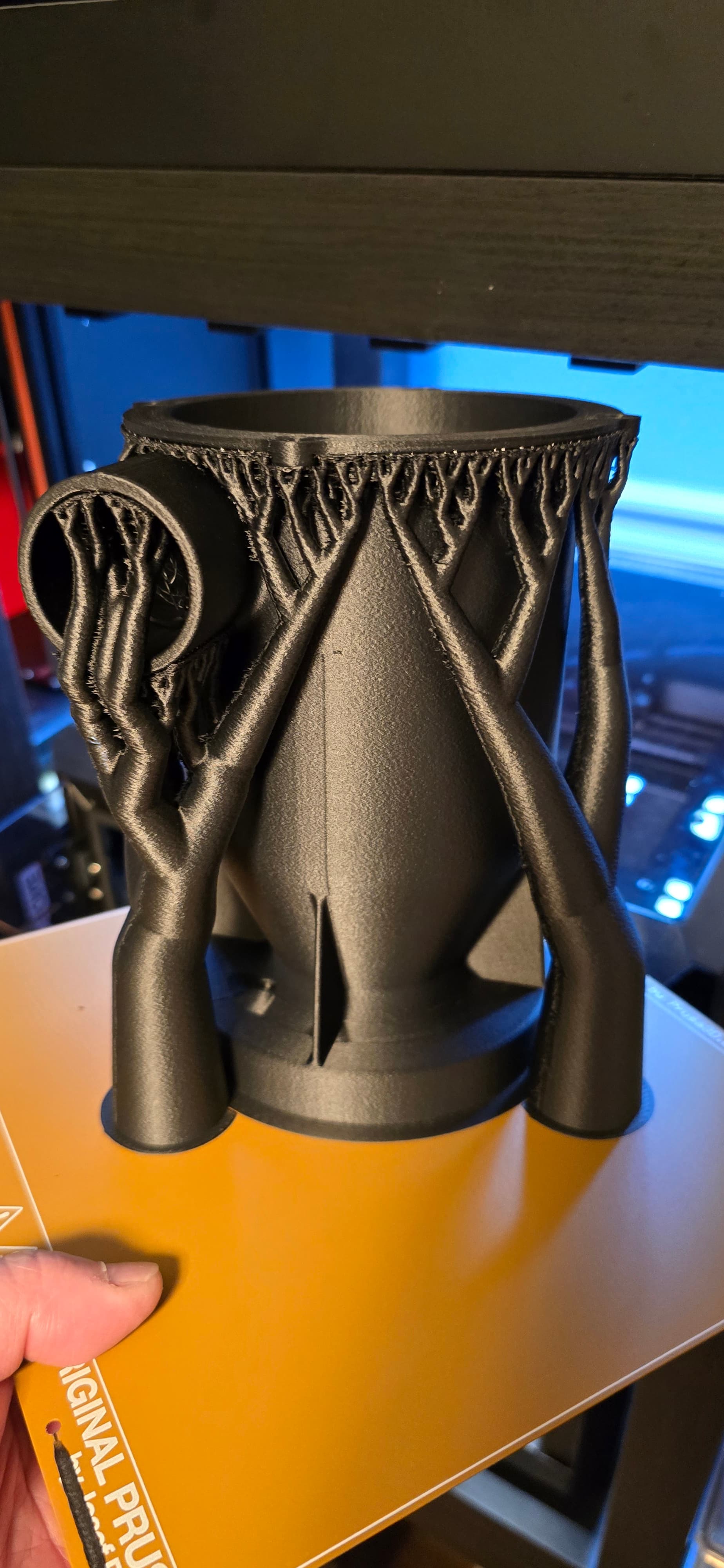

I also bought the CoreOne when it came out, and can print in PA, PE and PP, among other filaments. I have printed a little baby cyclone dust collector in PP-CF for my dad on my CoreOne, and he said it works great. That specific model was duplicated from a key cutting machine, and it had ~5" diameter threads for threading onto a bucket that was built into the machine. I originally just had to design and print a lid, because it didn’t have one, then he said he only had one, but wished he had a second one, so I ended up duplicating the entire thing. When I get time (Ha!) I am going to modify the base for mounting directly to a small 1 gallon or so bucket, then put it on Thingiverse and Printables.

Cyclone prototyping is one of the forays I would like to experiment with my self. Thanks for the info.

Yeah, I tripped and fell in that rabbit hole as well. Haven’t been able to do anything with the info yet, but someday.
Here’s a couple of links regarding cyclone separators.
https://powderprocess.net/Equipments%20html/Cyclone_Design.html
There are a lot of sites that talk about features of good cyclone dust collectors, but those two have equations that allow you to plug in numbers and generate efficiencies and pressure drops for a given design.

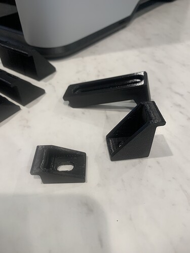

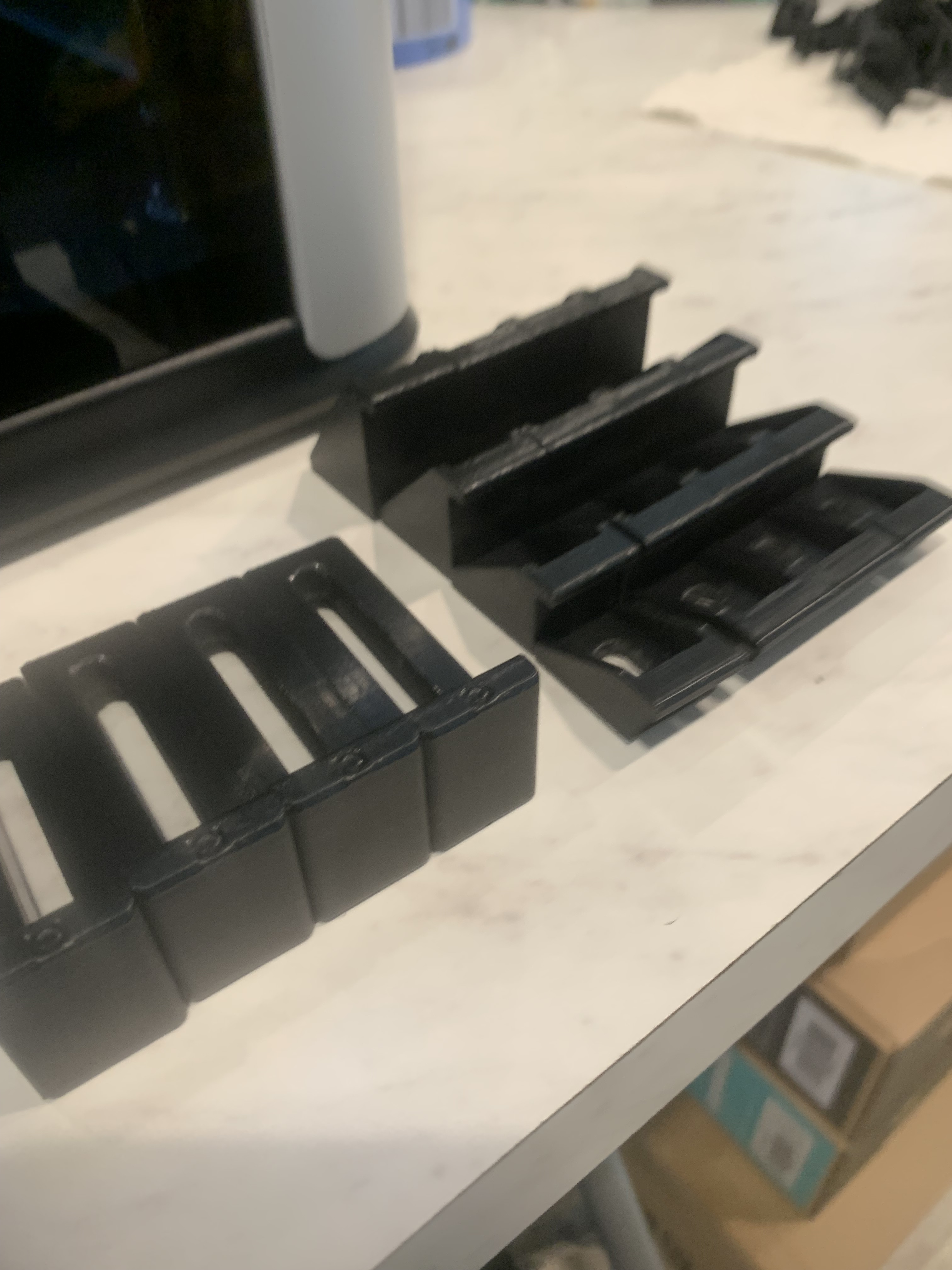

Finally got around to printing a small batch of clamps. These were printed on their side, 50% infill, PETG. I’l give them a go at it, they seem to be fairly rigid.
Also printed off a couple of drag chain retainers, not sure if I’ll need to fab a smaller one for the outside or not. Usually I’m the one knocking the chain off as I’m reaching over the Y rail.
Trying to get used to the machine and associated settings with respect to strength and infill settings etc.

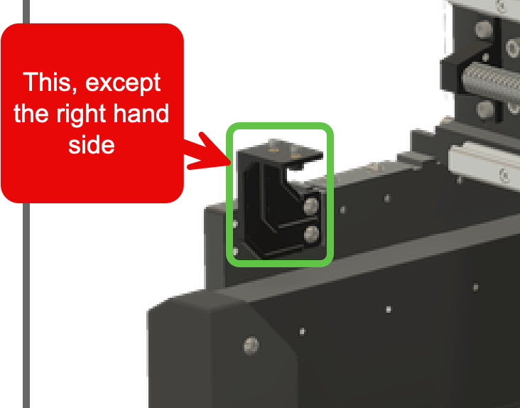

@WillAdams i didn’t see this part in the library. i don’t think it’s there, but if i missed it, can you point it out? if it’s not there, how would i get a replacement - i accidentally snapped mine. thx!
It’s an injection molded part.
Write in to support@carbide3d.com and we’ll work out how to get one to you.

I use a lot of those clamps, print them in different colours function of their height to differentiate them easily. Also if you cut a bit into the clamp, you don’t damage your end mill.

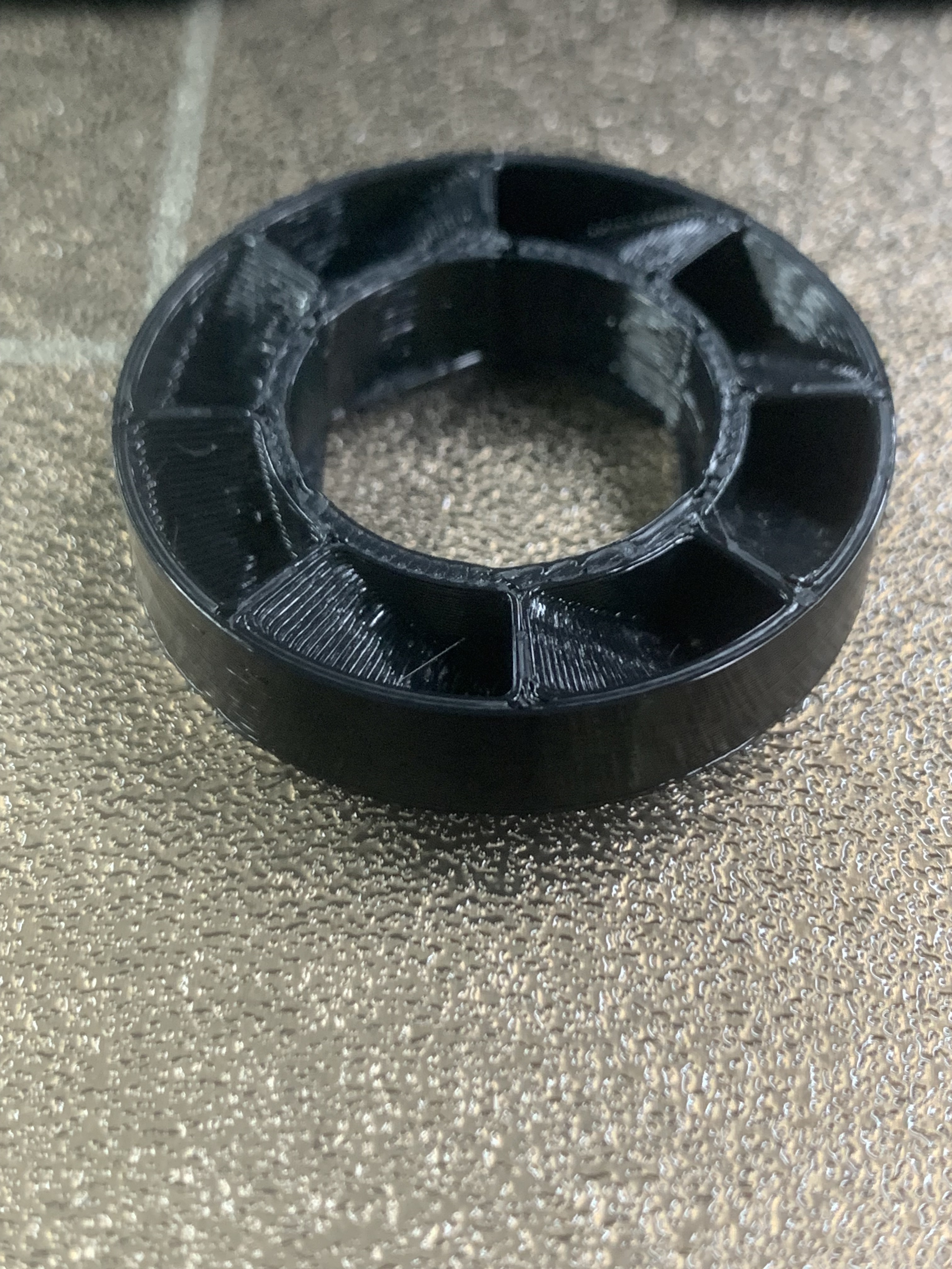

Now a story of another successful repair using a 3D printer:
A few days ago, a rubber tire on my wife patio lounge chair has fallen into pieces after many years under the sun. I have search the web to find some replacement without success for something closed enough to order. So I started Fusion360 and in a some minutes had this design:
This is a photo of the broken rubber tire:
Then I have printed a few short 1 inch tests prints in TPU to verify the fitting and to select the proper infill for proper flexibility/rigidity.
It took 14 hours to do the complete tire print. I put the tire in hot water to make it more flexible and installed it on wheel. It was a perfect fit and complete success. Wife is very impress and happy!
Here is the wheel with is new printed TPU tire:
I was lucky the outside diameter is just under 12" which is maximum size of my new H2D print bed.
Now a CNC question, if the diameter have been too big for my print bed, if I had a 1" thick rubber mat available, would it be possible to do it on the CNC? The outside profile of the tire is not critical but the inside is more important to fit the wheel properly.
