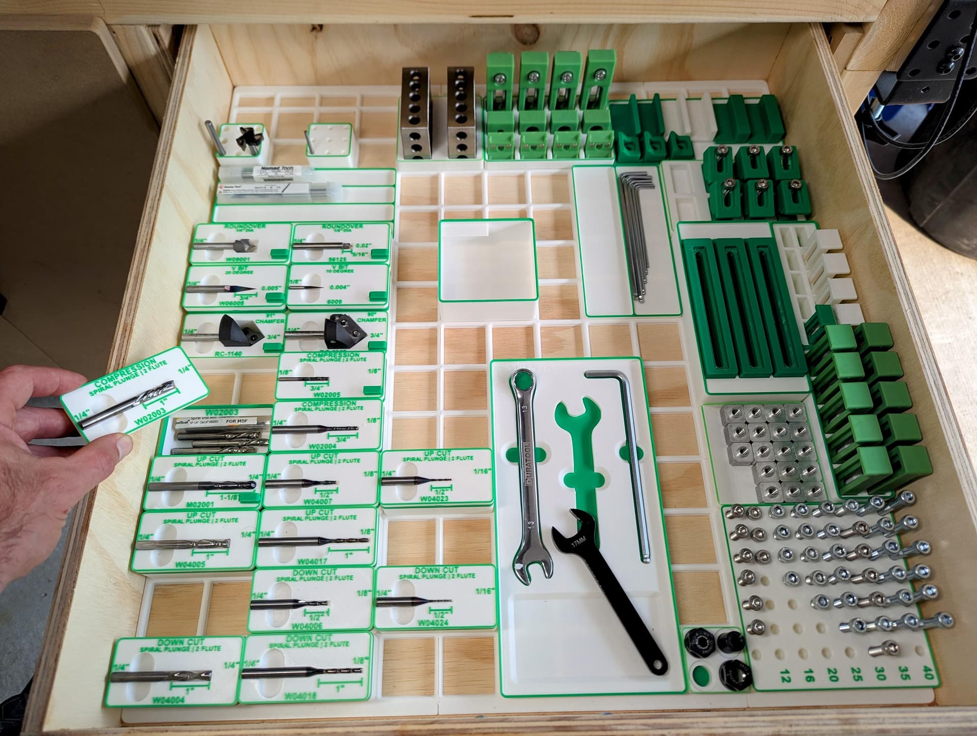

these are great! came across this post while searching for ones to use for my drawer. Have you posted these files anywhere? would you be willing to share what you have done?
many thanks!
Sorry it took so long, been very busy lately.
I just uploaded all files to Printables: printables.com/model/1426143
It includes (will add more):
- Bit Holder and Storage Bin (Fusion file included to modify to your needs).
- Curent Project Tray.
- Front & Back Edge Clamps Holder.
- ER11-A Collets Holder.
- Amana RC-1142 (90° V Groove).
- Amana RC-1140 (91° V Groove).
- 1-2-3 Blocks Holder.
- Various Bits Holder (1/8" Shank).
- Various Bits Holder (¼" Shank).
- Carbide 3D Essential Clamps Holder.
- Carbide 3D Crush-It Essential Clamps Holder.
- Carbide 3D “Teez-Nutz” T-Nuts Holder.
- Carbide 3D Screws (12mm to 40mm) Holder.
- Other bins and trays.
That’s it for now, let me know if you need anything else!
Really nice setup for storage, appreciate you making this available to everyone. Time to dry some filament!

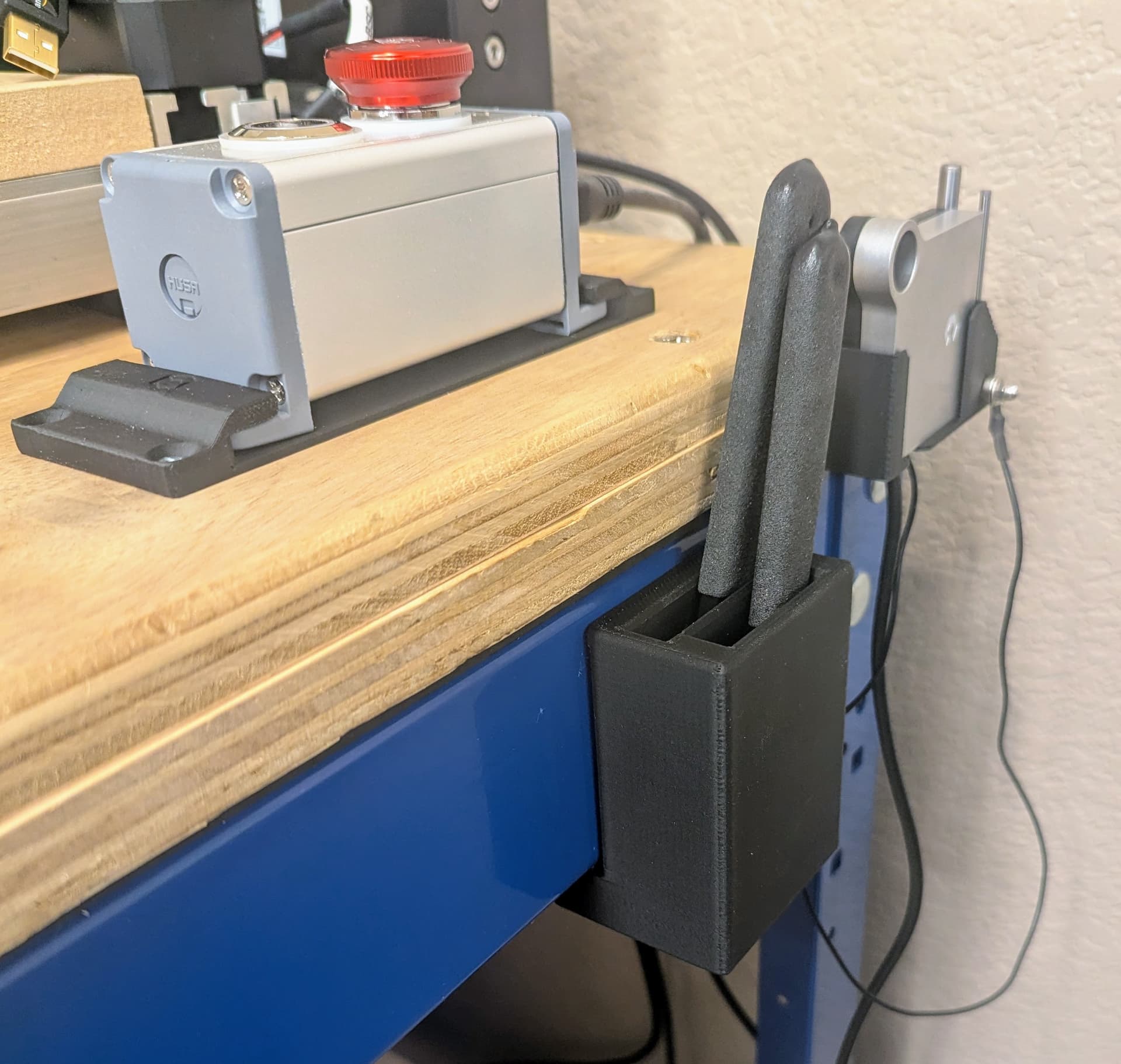

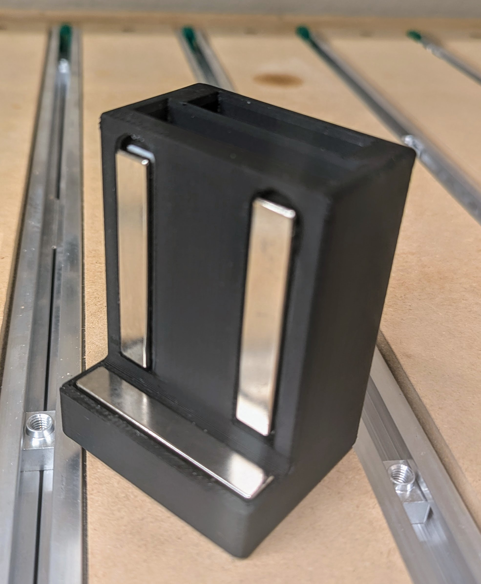

For those folks using the Kreg frame for the CNC work table, I designed a “holster” for my collet wrenches so I could keep them handy for tool changes. I’m using 3 60x10x3mm N52 neodymium magnets to attach the holster to the frame. I initially tried to use just a pair of magnets on the face, but found even with very strong magnets the holster had a tendency to slide down a bit. The magnet on the bottom keeps it very solid (but still removable).
Dropbox Link: https://www.dropbox.com/scl/fi/gmd7znibzme07xplecdwz/Kreg-Table-Collet-Wrench-Holster.stl?rlkey=y7bf9jd3tu9s02c24q5w47reb&dl=0 (an STL file; if anybody wants a STEP file instead, message me).
-M.
That’s amazing, nice work .
