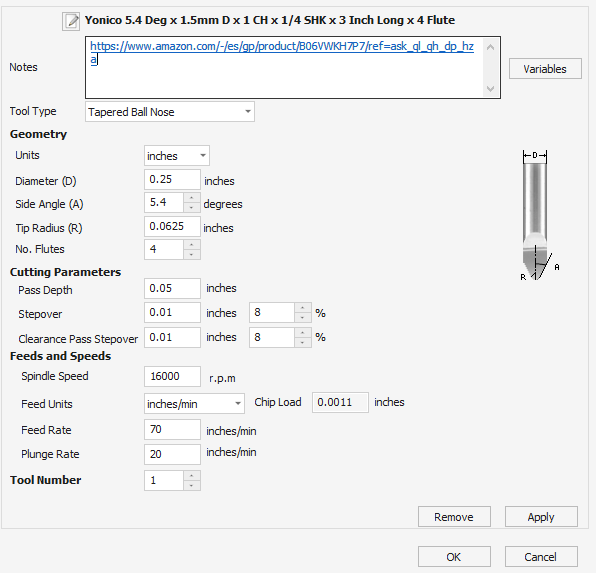

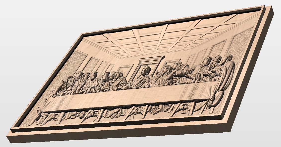

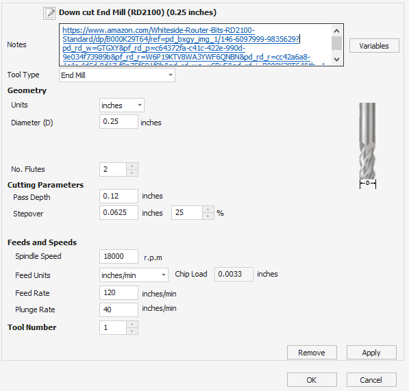

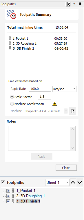

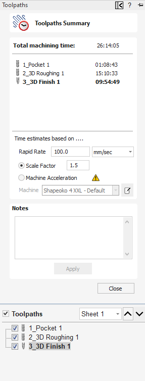

I’m about to start a 3D carving project, and I noticed that the machining times were really high since the piece is quite large (about 24" x 18"). I’m running a Shapeoko 4 XXL with a spindle and HDZ.

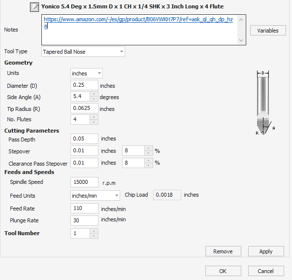

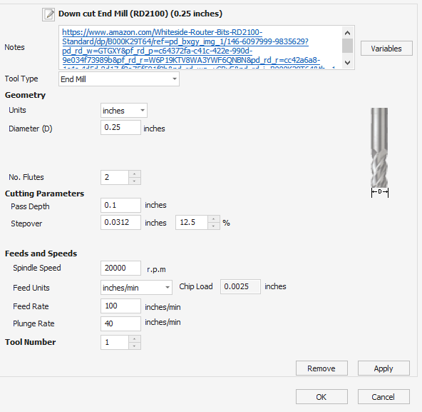

Thanks to ChatGPT, I was able to “optimize” my feeds and speeds for both my downcut endmill and tapered ball nose, which reduced the total machining time significantly, down to something much more reasonable and comfortable.
That said, I wanted to ask the community: would you trust ChatGPT to optimize your feeds and speeds?
In the past, I actually paid someone to help me with this because I never took the time to properly learn how to calculate feeds and speeds myself. So being able to get good results with ChatGPT sounds almost too good to be true, which is why I’d love to hear your thoughts, especially from those with more experience.
I’ve attached both my original feeds and speeds and the ones recommended by ChatGPT for reference.
Thanks a lot for your input!
Large language models are simply going to extrapolate based on examples in the training data and whatever the “temperature” and similar settings cause them to output.
That said, the feeds and speeds in Carbide Create are quite conservative, and a spindle affords a lot of torque which machines running a trim router lack, and the HDZ and larger V wheels and wider belts of an SO4 are quite the rigidity improvement over an SO3 w/ a belt-drive Z-axis.

Thank you very much for your explanation. I’ll take some time later to go through all the resources you mentioned. That said, I’d really appreciate a more direct answer in this case, especially if someone else has the same question I do. Your message kind of gives me “no but yes” vibes, so should I actually test the feeds and speeds myself, or is that not recommended?

I’ve used a handful of them to try and get starting points for feeds and speeds.
Direct answer from my personal experience: they’re either very good or downright terrible with very little in between. As in they’ll work great or they will blow up your tooling and then some…
If you don’t know the difference already, it is very difficult to distinguish the good from the garbage.
The other issue is that most of the data the model has been trained on probably does not apply to our types of machines. Same with generic feeds and speeds tables, they’re just not made with a desktop machine in mind.
Regardless of if you end up using the models or not, I’d highly recommend learning the basics of feeds and speeds yourself. It’s well worth the time and effort to build that intuition. If only so you can call out the BS that an LLM spits out.
If you’re going to use the LLMs without dedicating the time to learning the feeds and speeds stuff, I’d recommend you always prompt it to explain the reasoning step by step. This will help you build that intuition passively while also letting you more easily identify the nonsense when it does pop up.
Bottom line: it’s not terrible, it’s not great. Use it or don’t use it, I’d highly recommend learning F&S yourself either way. (Dedicating a week of after work time to really studying and understanding feeds and speeds was genuinely one of the best things I’ve ever done to progress my machining activities. I wish I had done it 5 years sooner…)

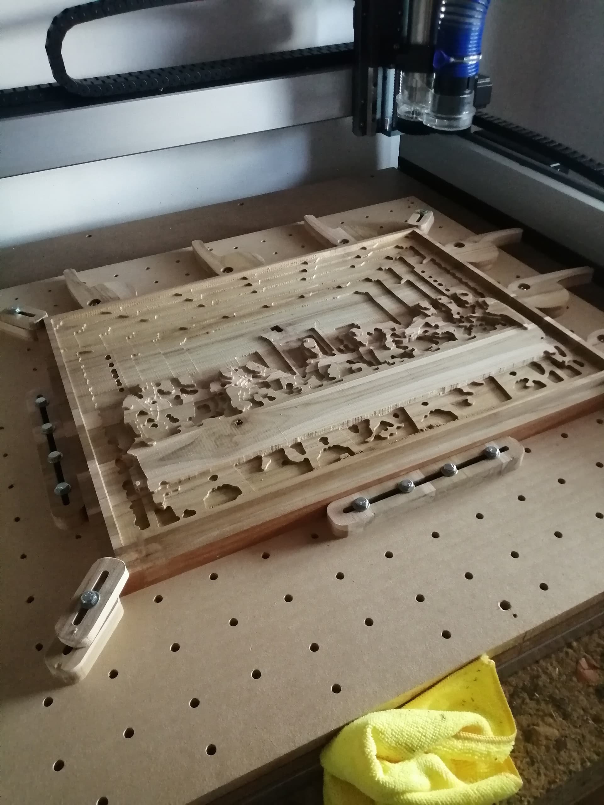

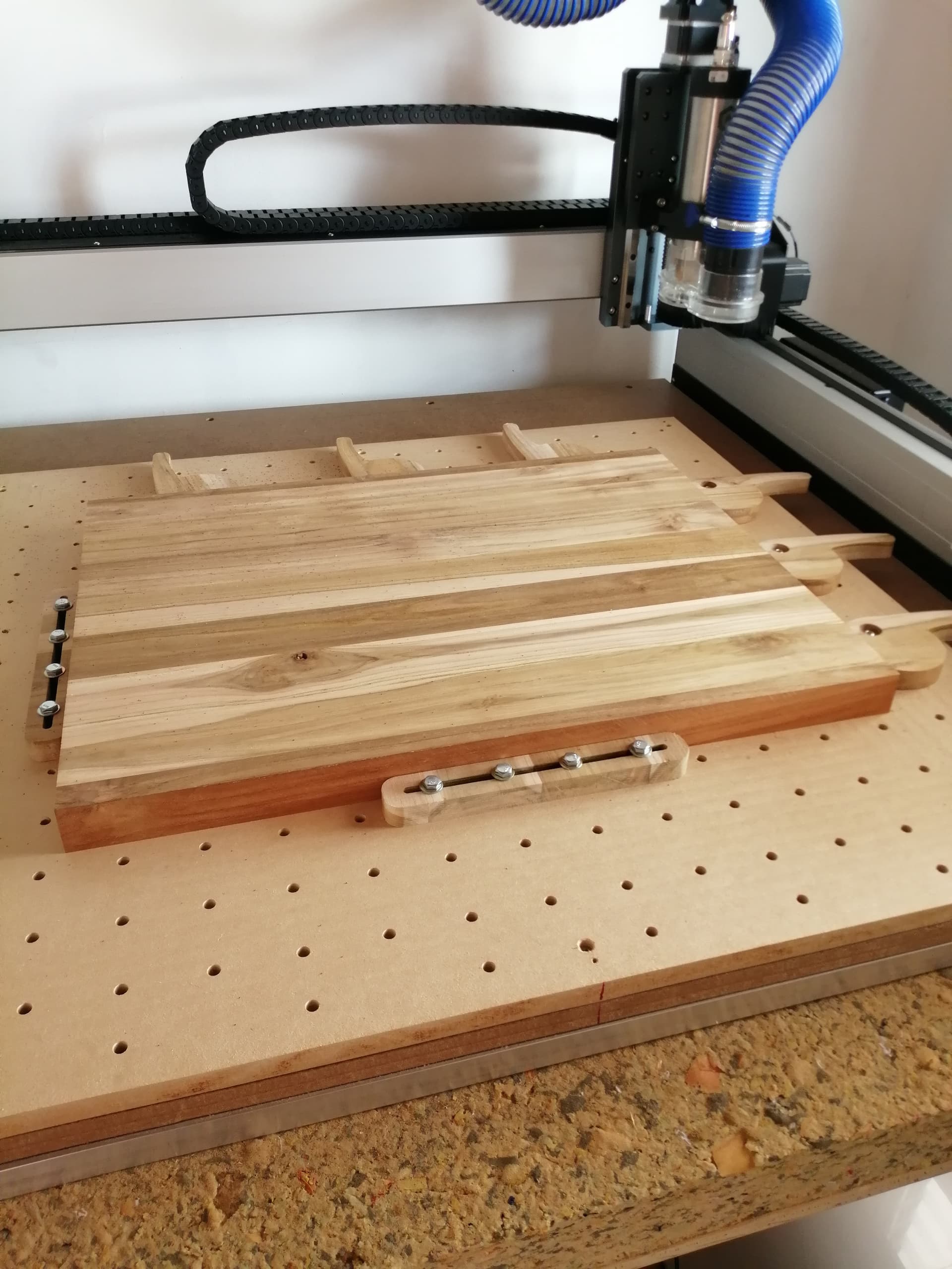

Hope I don’t destroy the machine, wish me luck
Is that cork on the table?
And: is that scrap would you use to try? or is that the real thing?
(I produced enough wood for our open fireplace for the whole winter from excellent lumber …, and I do that every year.)
You’ll be fine…probably :slightly_smiling_face:
Wood is pretty forgiving so unless it’s waaaay off (which it might be :man_shrugging:) it should be good.
Let us know what numbers you went with how it works out :beers:
Looks like foam board under the machine? Vibration reduction?

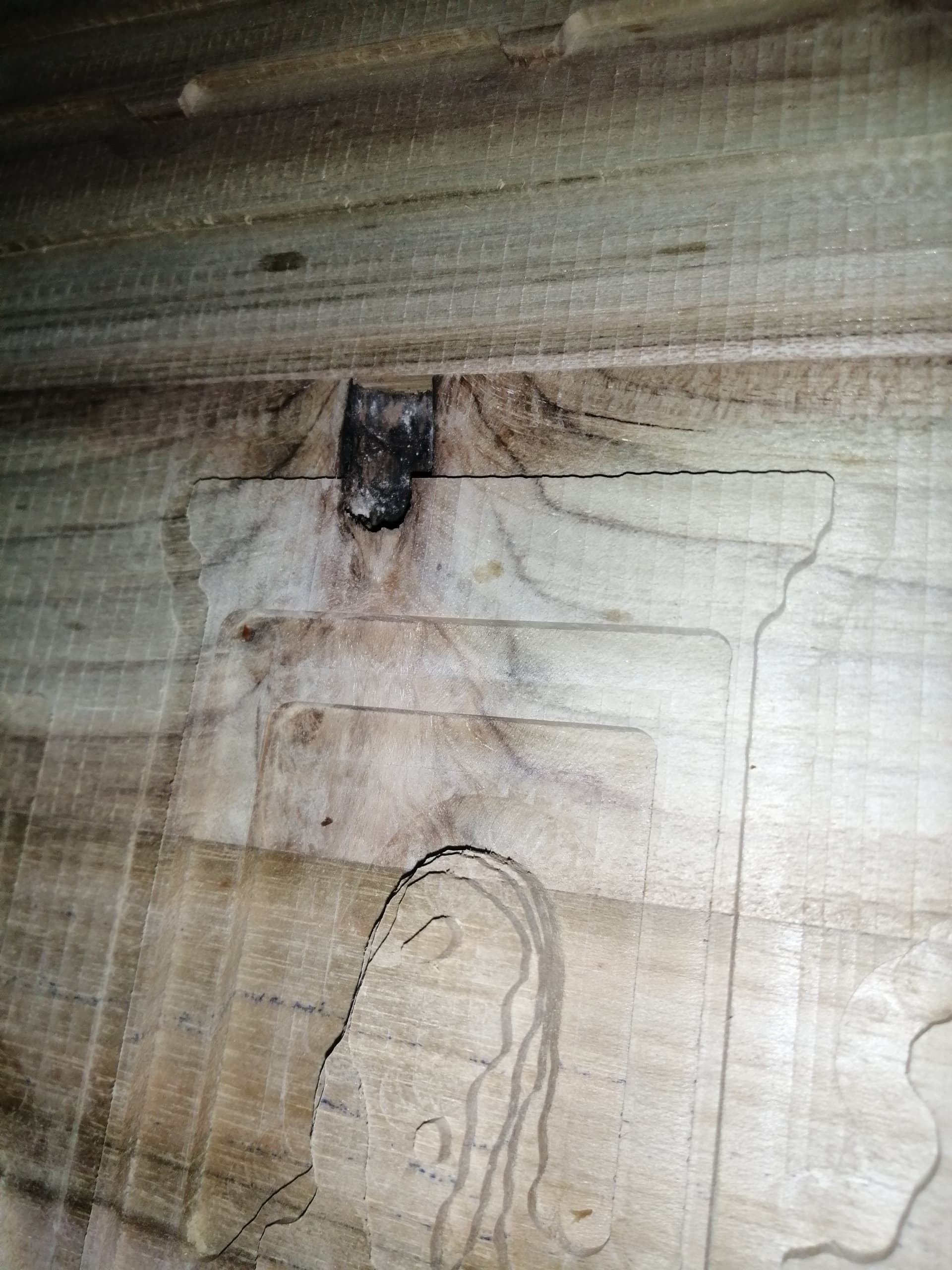

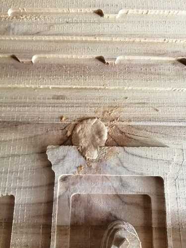

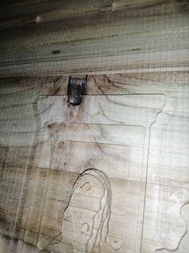

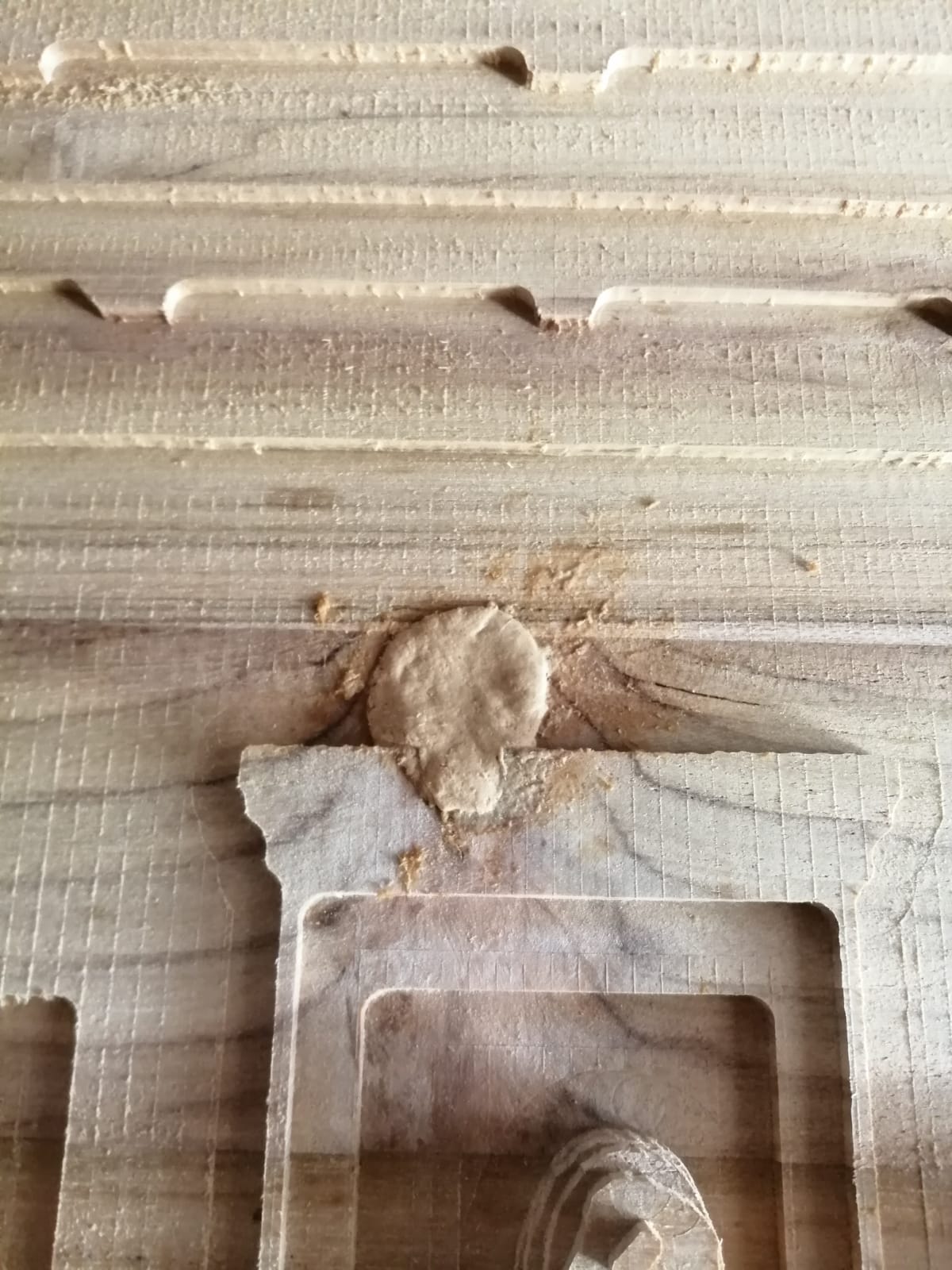

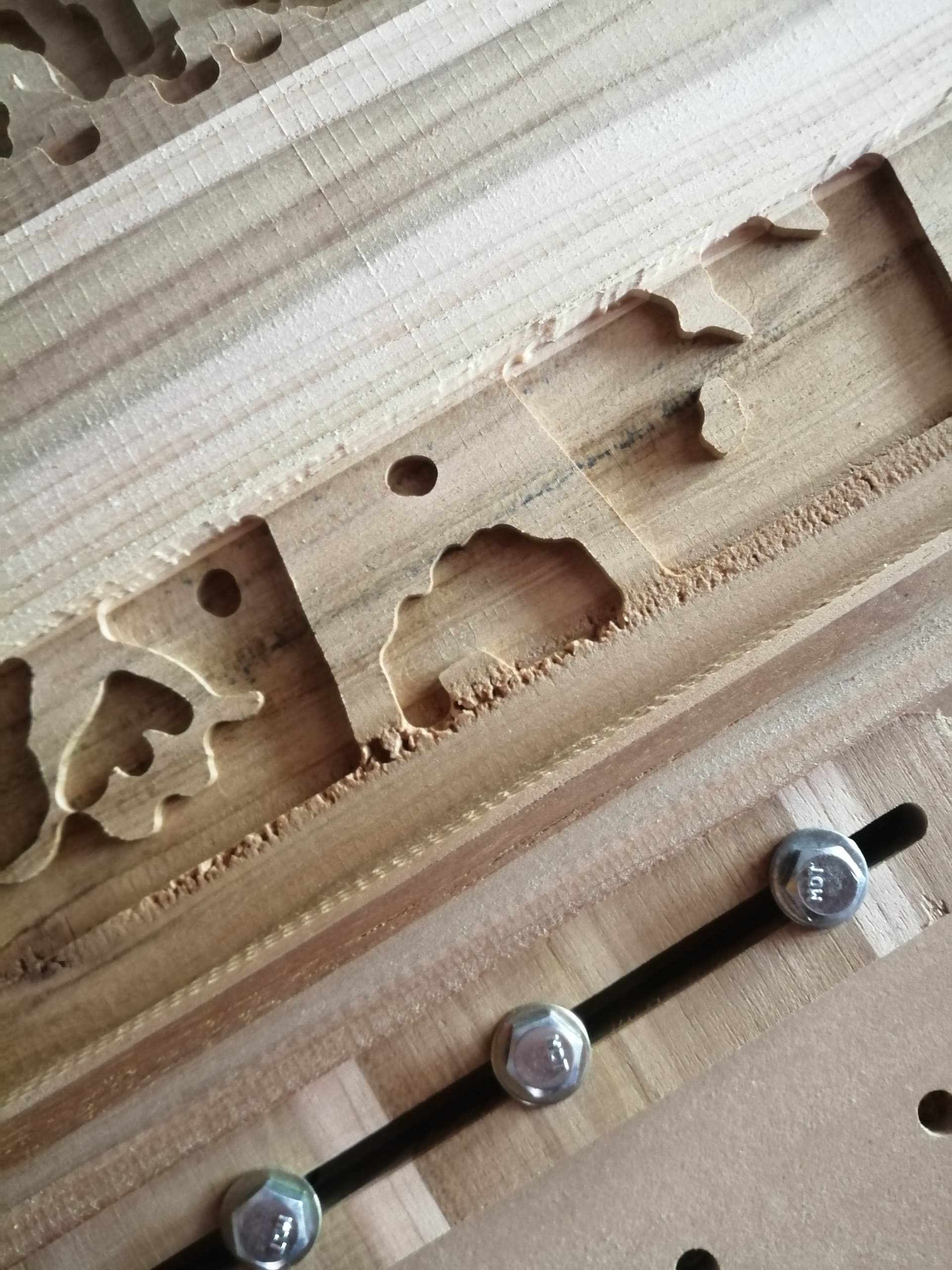

Gentlemen, I’ve survived Day 1!
Now all that’s left is to survive Day 2 as well. So far, I’m really happy with the new feeds and speeds provided by ChatGPT; they’ve been performing great.

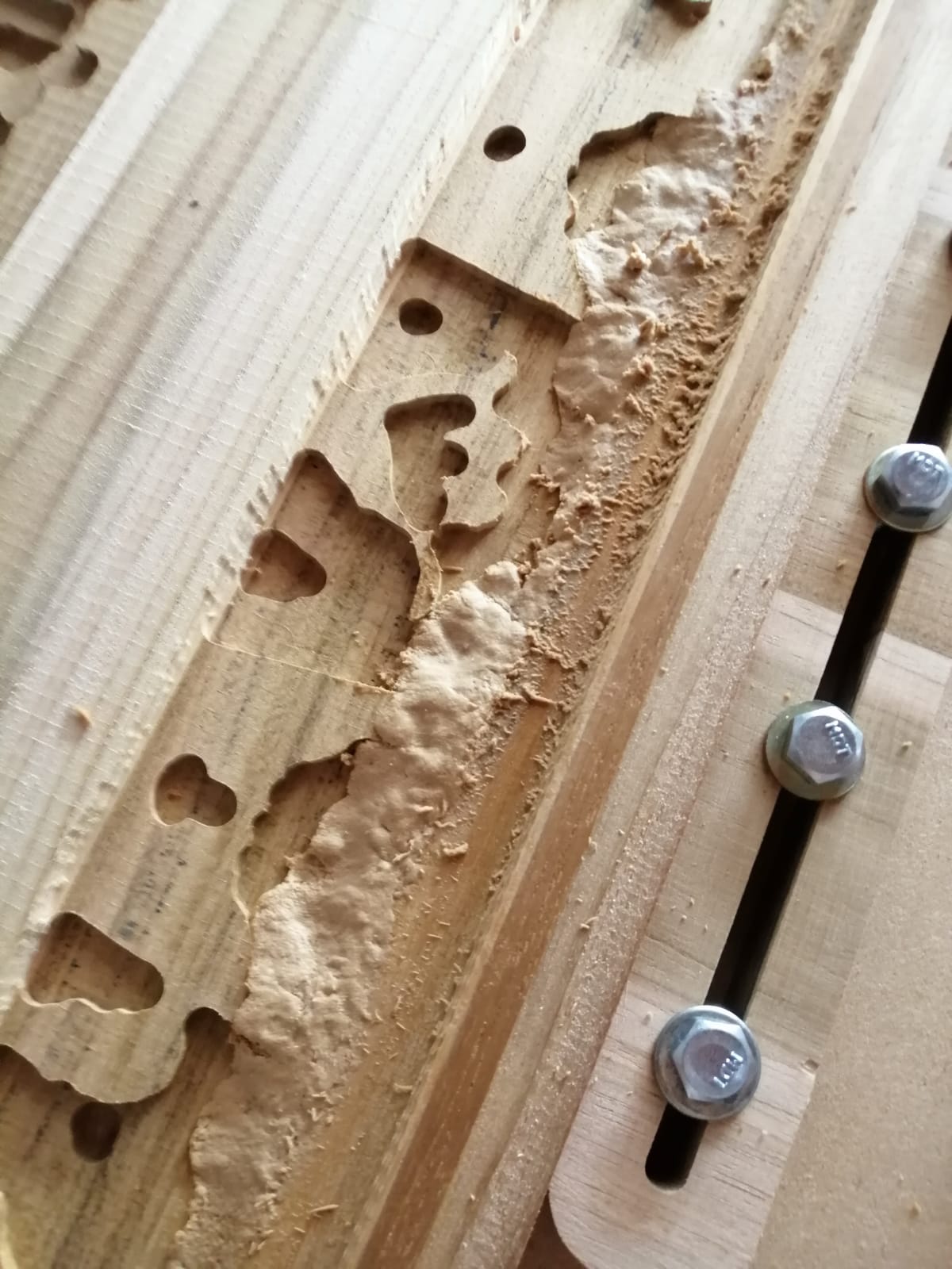

Unfortunately, not everything can be perfect. It seems this particular board had some kind of filler inside, and I lost the 50/50 gamble of picking the right side to machine, ended up hitting a huge void that doesn’t go all the way through.
Still, at the end of the day, it’s all about doing the best you can with what you’ve got.
Edit: I’ll try to fix those issues with some glue mixed with teak chips before the finishing pass.
I’m from Colombia. This is Amazonian teak, and since I only have this board left for the next month, it was all or nothing.
So far, the downcut feeds and speeds have worked nicely, and yes, that’s a foam bed recommended by WillAdams some time ago.
Last supper?

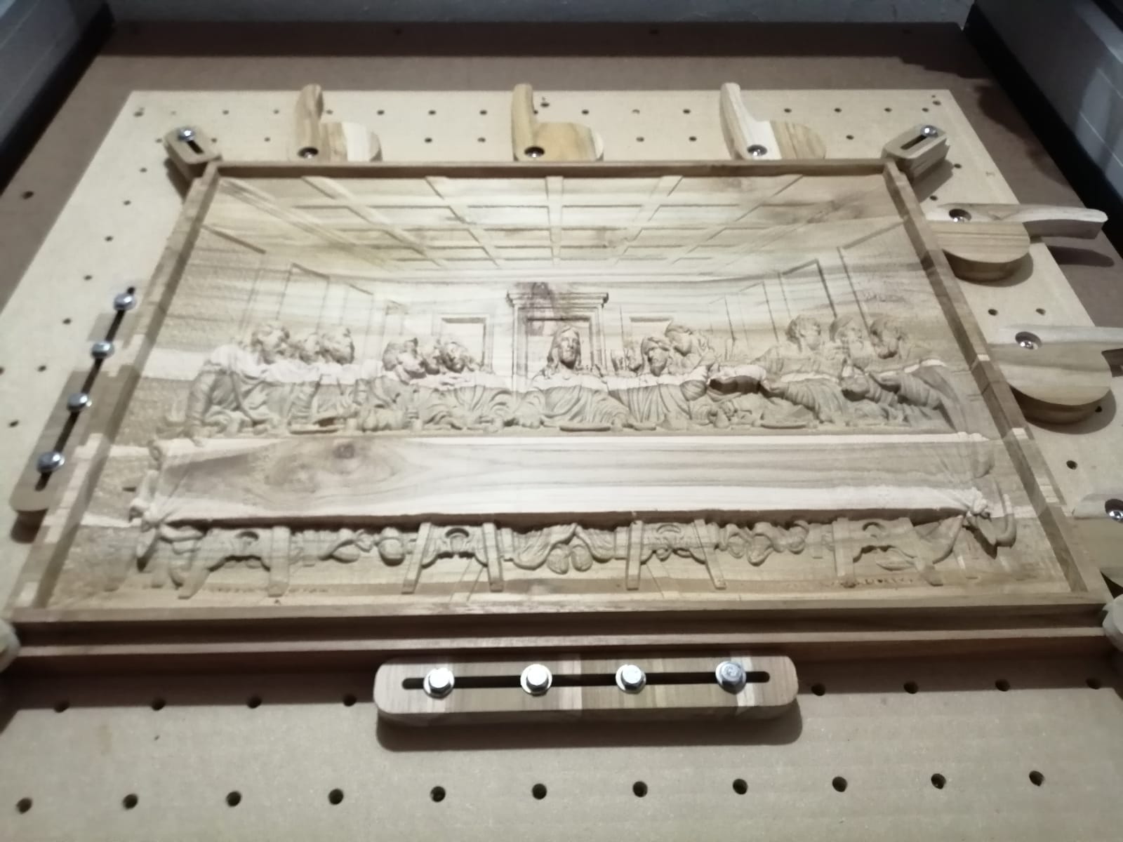

Looks like it’s progressing well, do you have a plan for finishing up the contours? Ball nose maybe?
Yes sir, you can’t go wrong with a Last Supper.
To be honest I don’t have a plan for the contours, I kinda like the Square style, seems solid, plus with this technique I can use the full board since I can put my Z clamps there without any risk of colission. But if you have an example of a really nice contour that I could use please let me know."

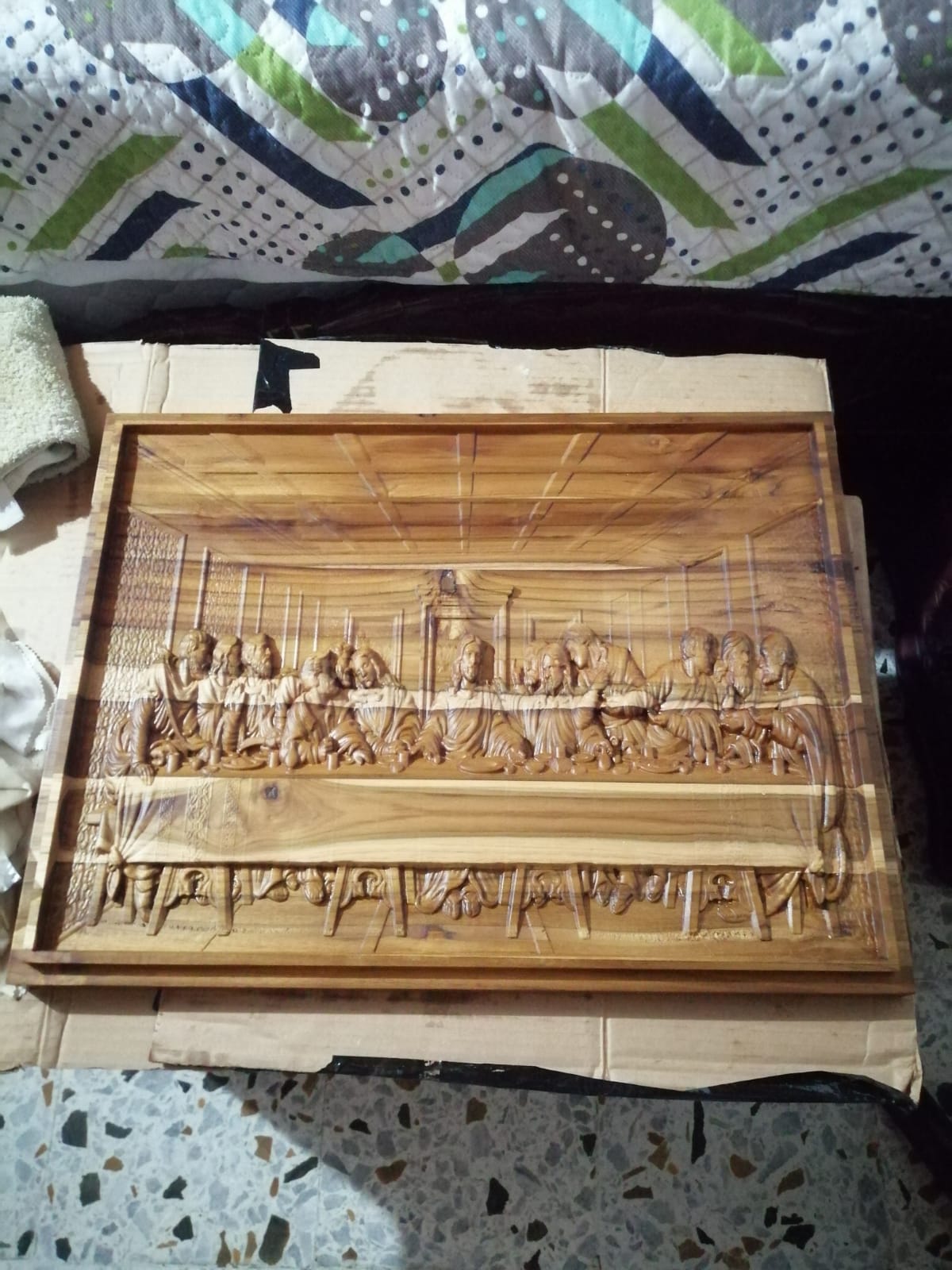

Day 2: I swear I tried my best, but applying that paste is really difficult. Let’s hope for the best.
At the end all worked just fine. Pretty happy with my machine.
