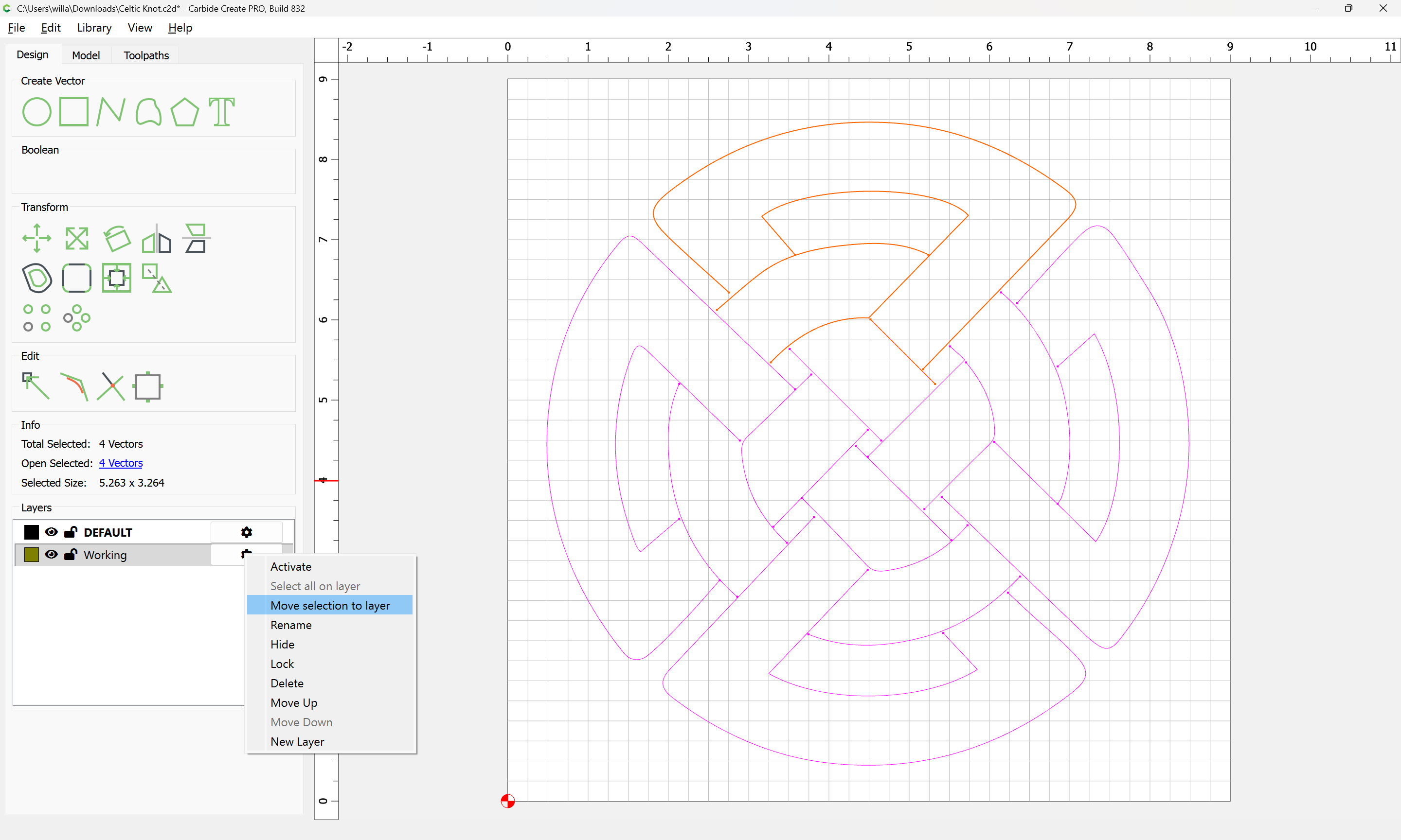

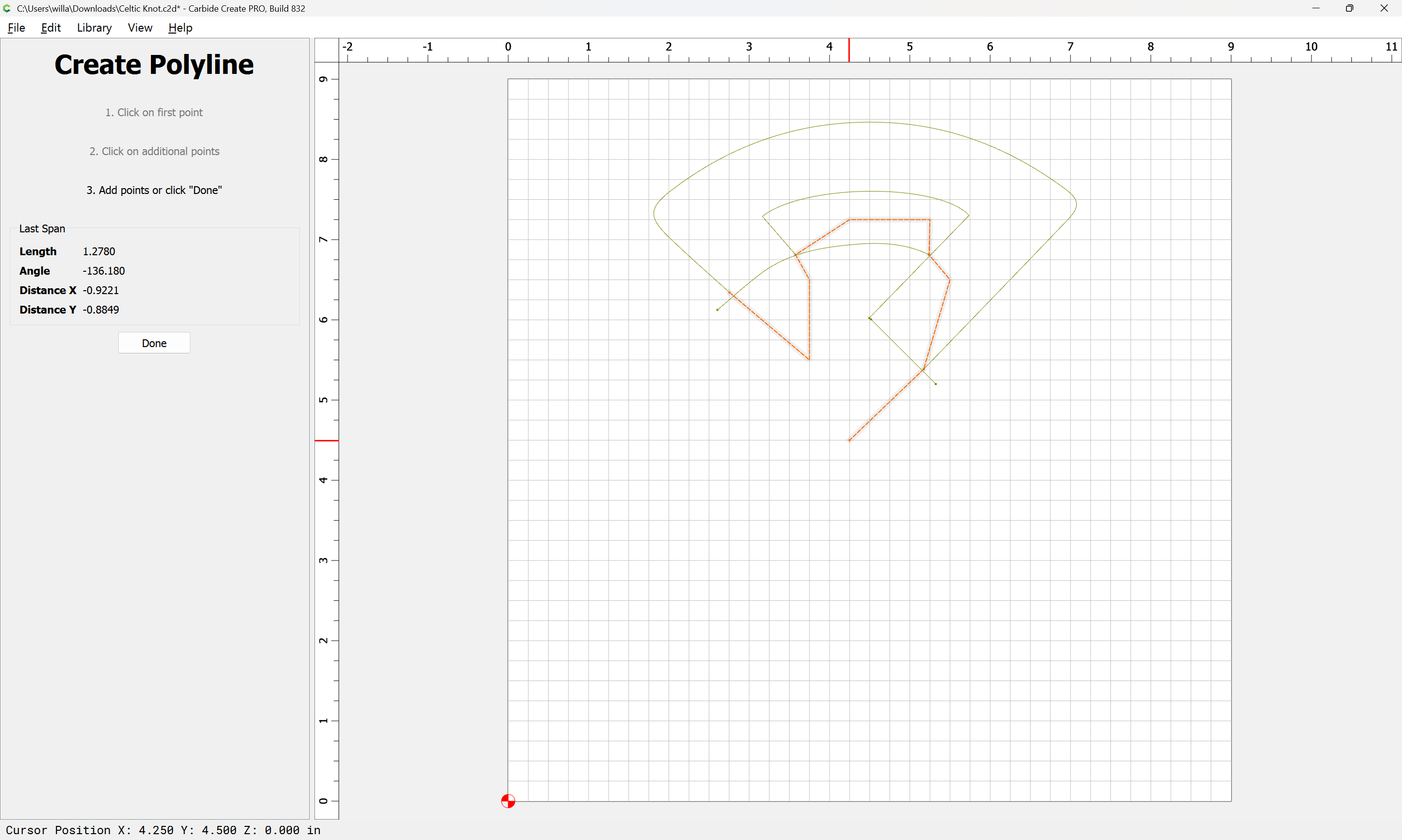

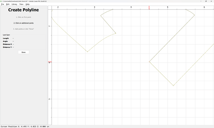

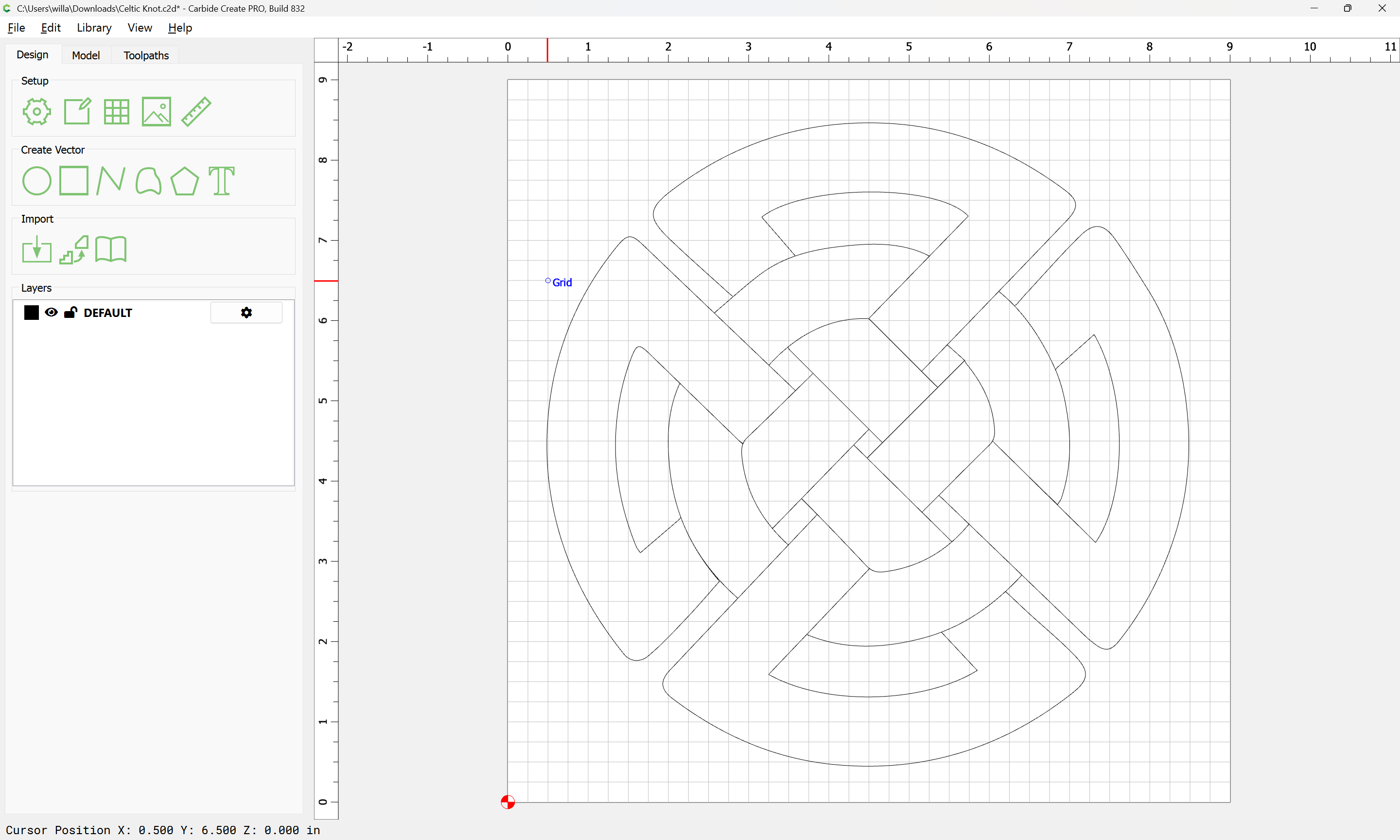

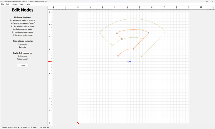

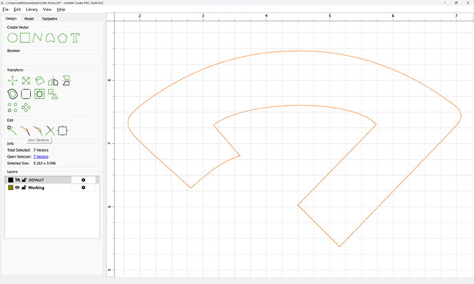

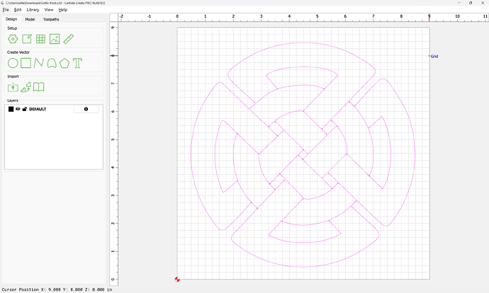

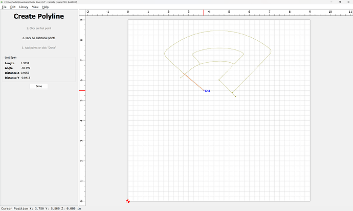

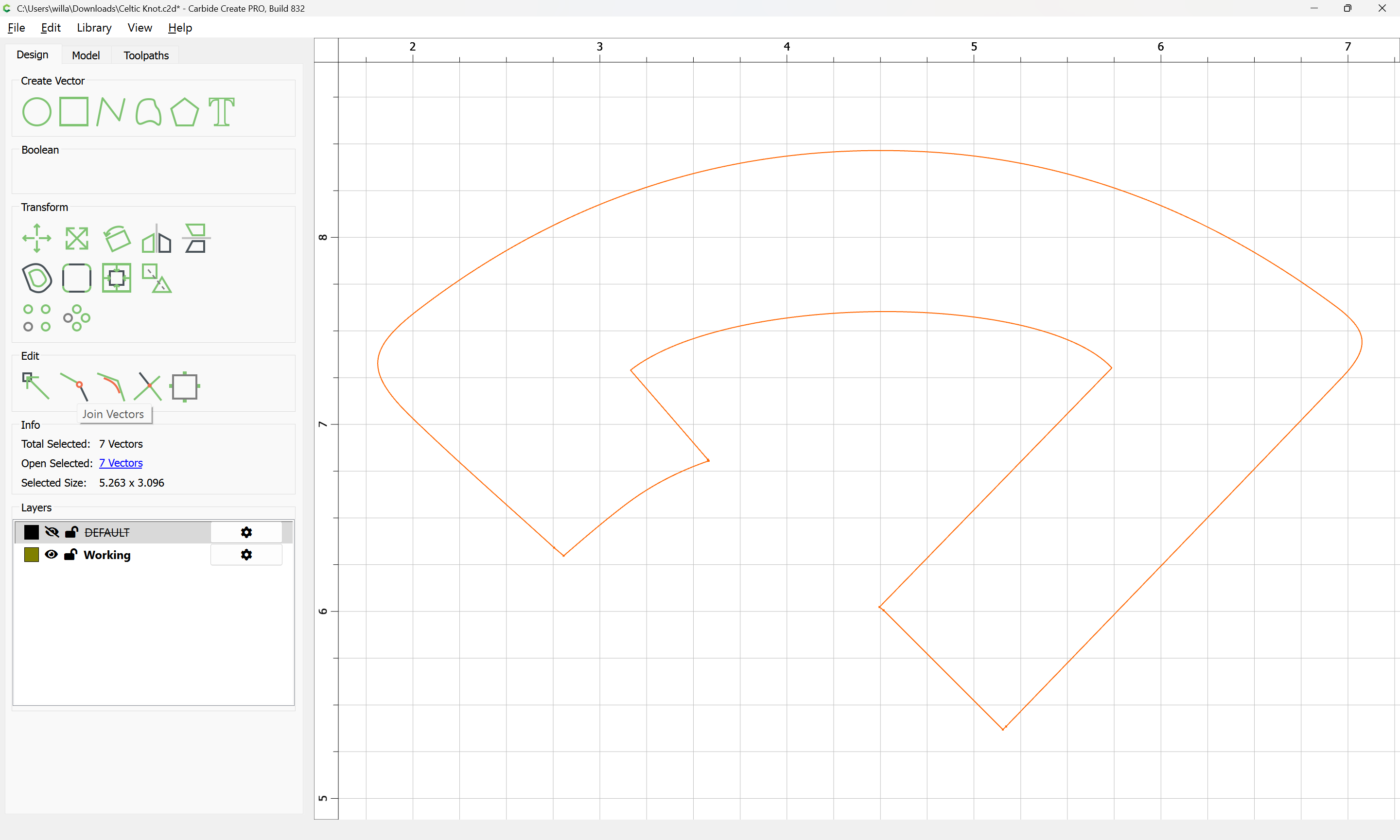

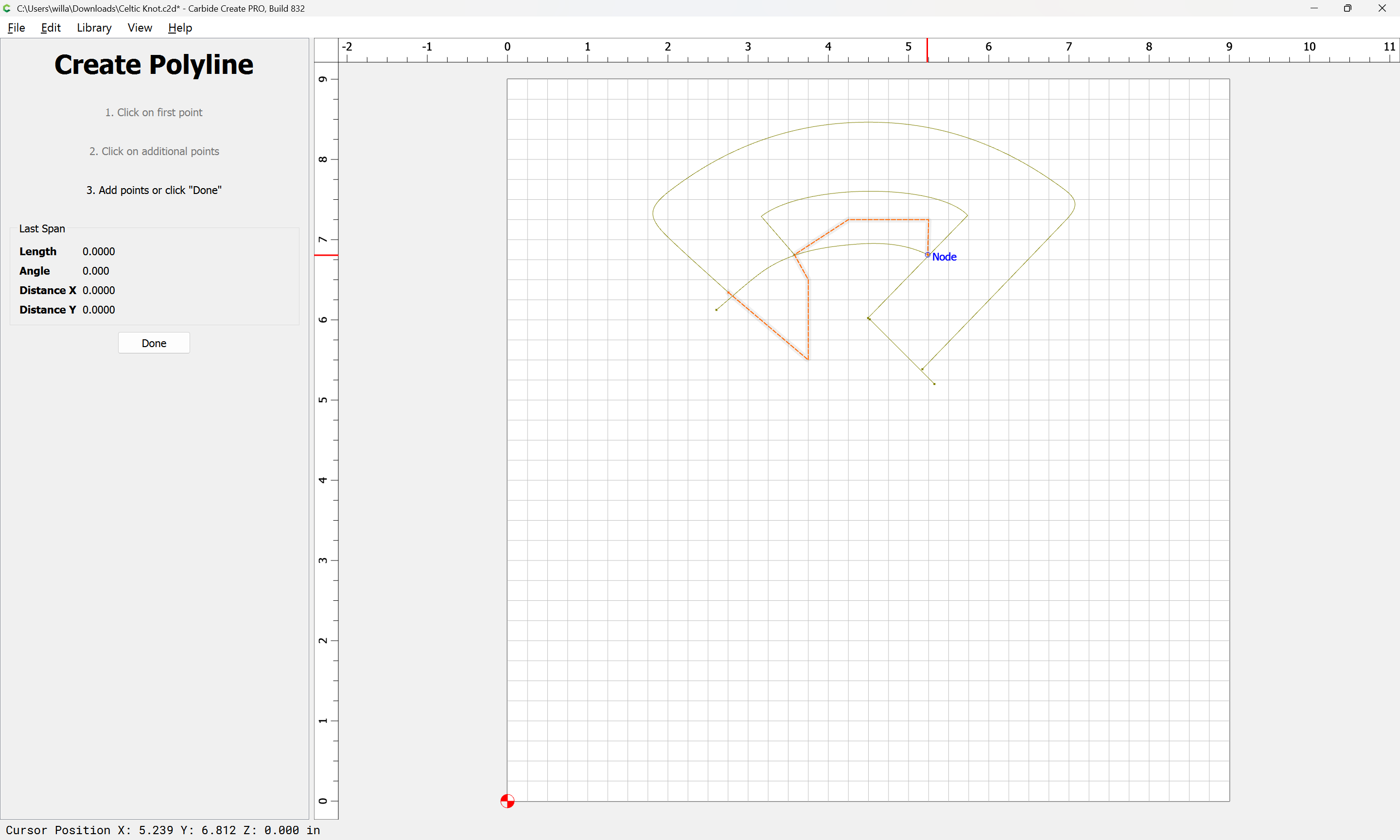

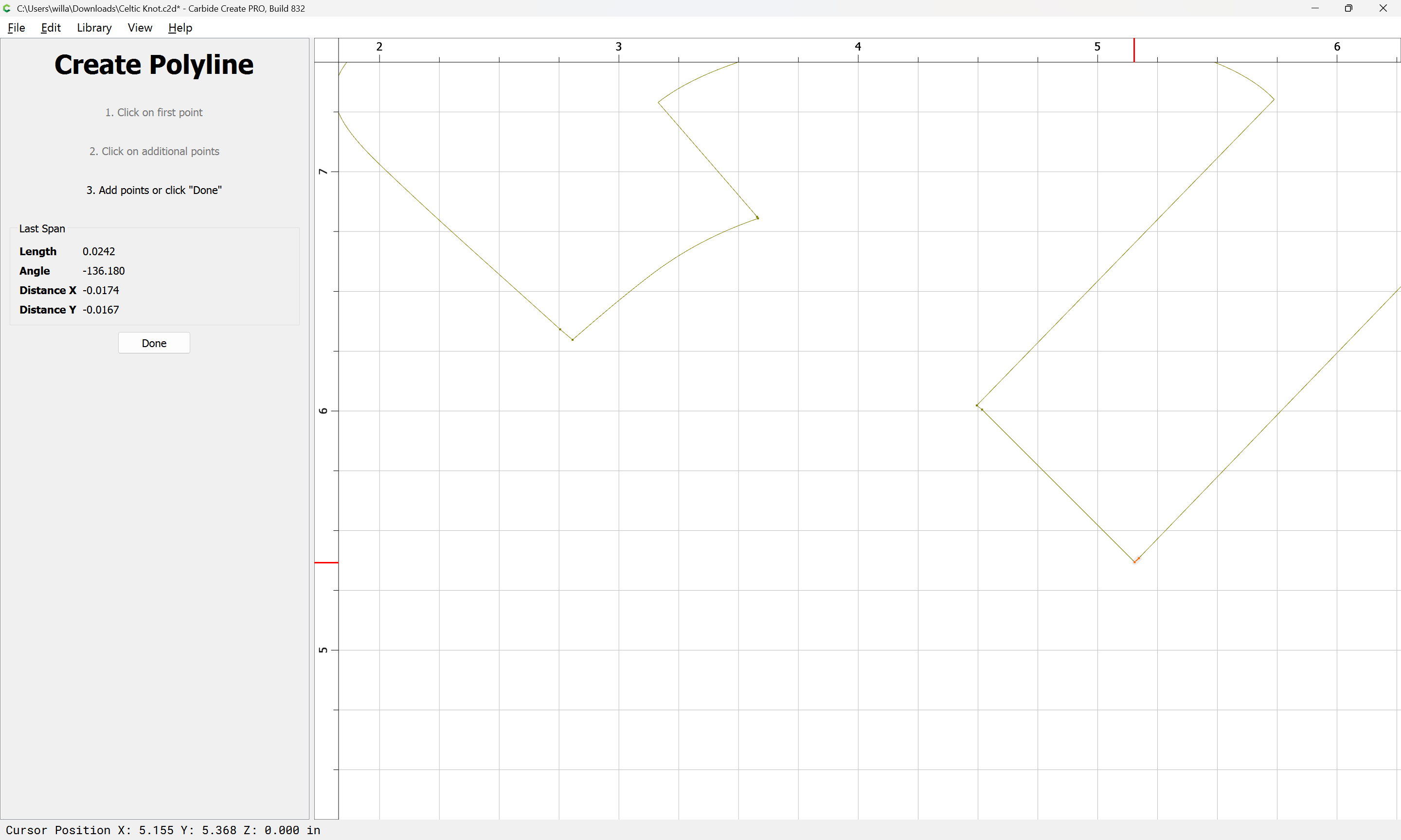

Hey gang, total newbie here - first post. I’ve yet to get a CNC machine, but I’m hoping to get a side hustle going here soon. As such, I’m working in Carbide Create at present and I have an SVG file of a Celtic knot.
I know you can’t join the end of a vector with the middle of another, but that just begs the question - what’s the best way to close these open vectors? I’m trying to avoid recreating the whole thing.
Perhaps slightly off topic, and possibly getting ahead of myself, does it make more sense for a design like this to use layers? I foresee it being a challenge to identify which areas to carve for something like this. Perhaps the solution to the first issue will render this one moot.

We went over this sort of thing once before:
Yes, layers can be used, but they are not necessarily needed.
The design seems straight-forward enough:
The issue is that lines are drawn so that they are involved with more than one region. It will be necessary to duplicate such elements and edit them down so that a selection may be made which encloses a given area…

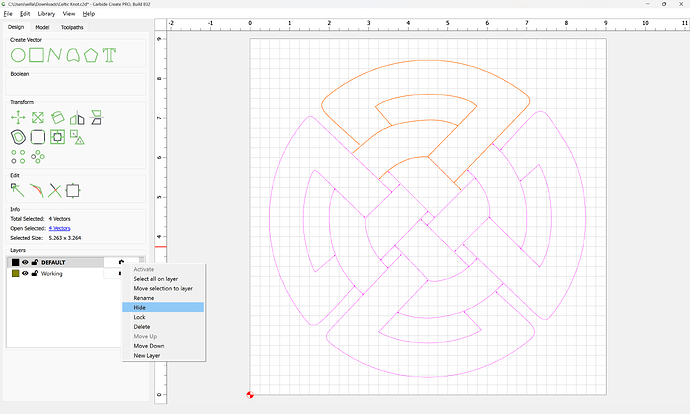

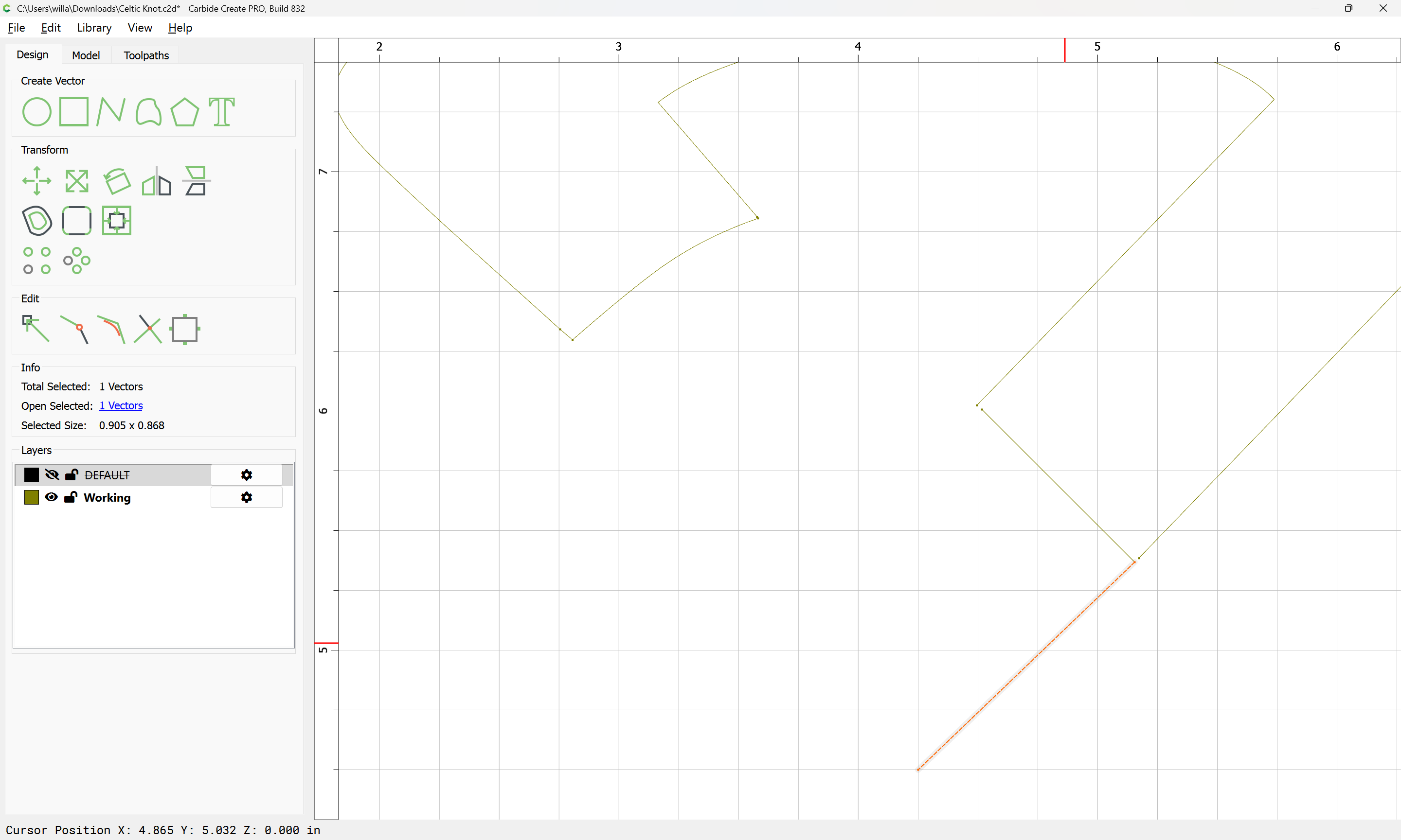

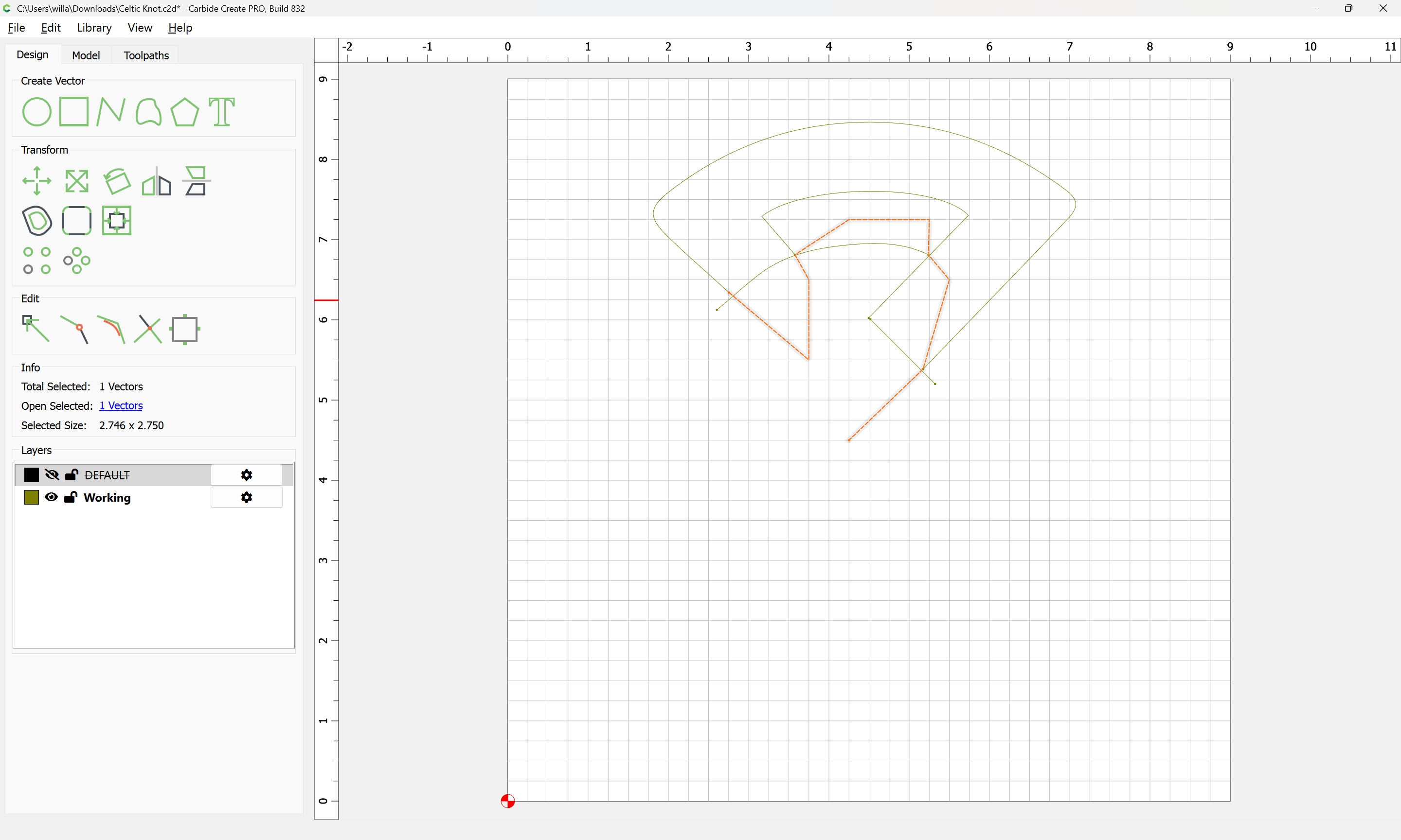

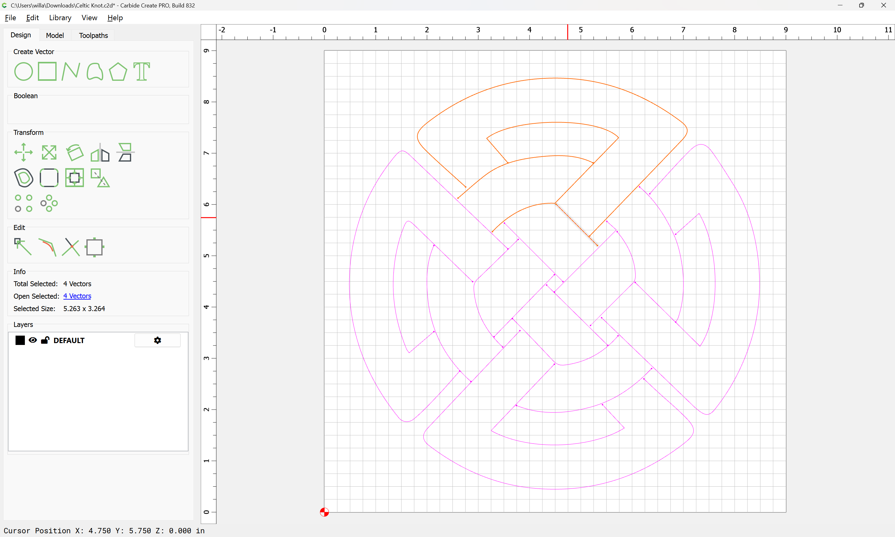

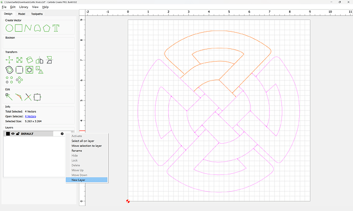

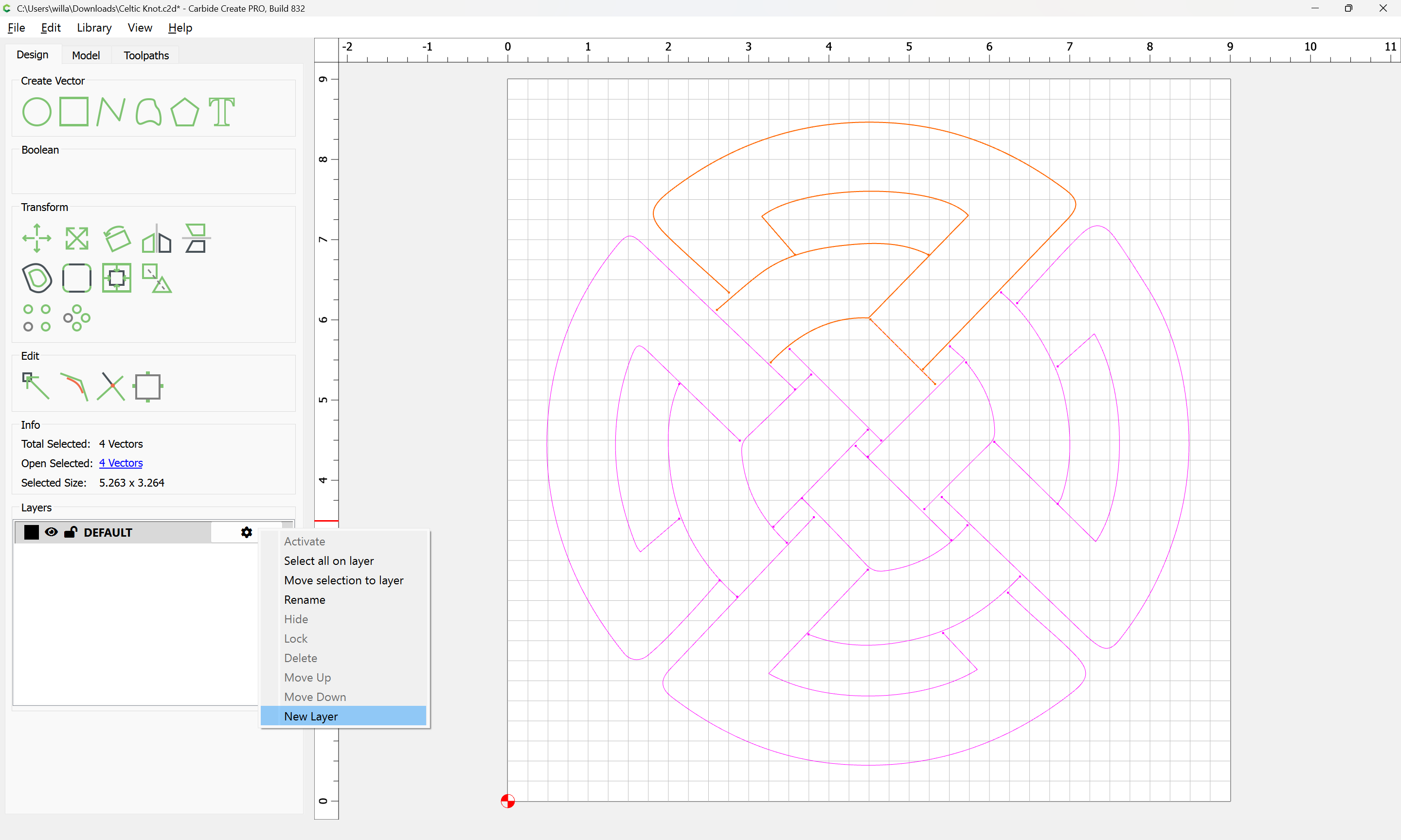

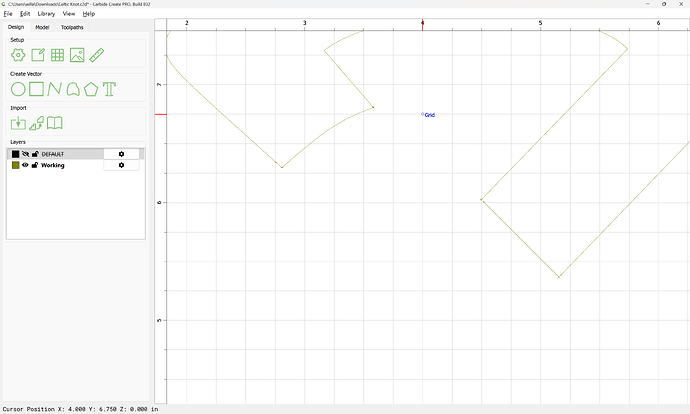

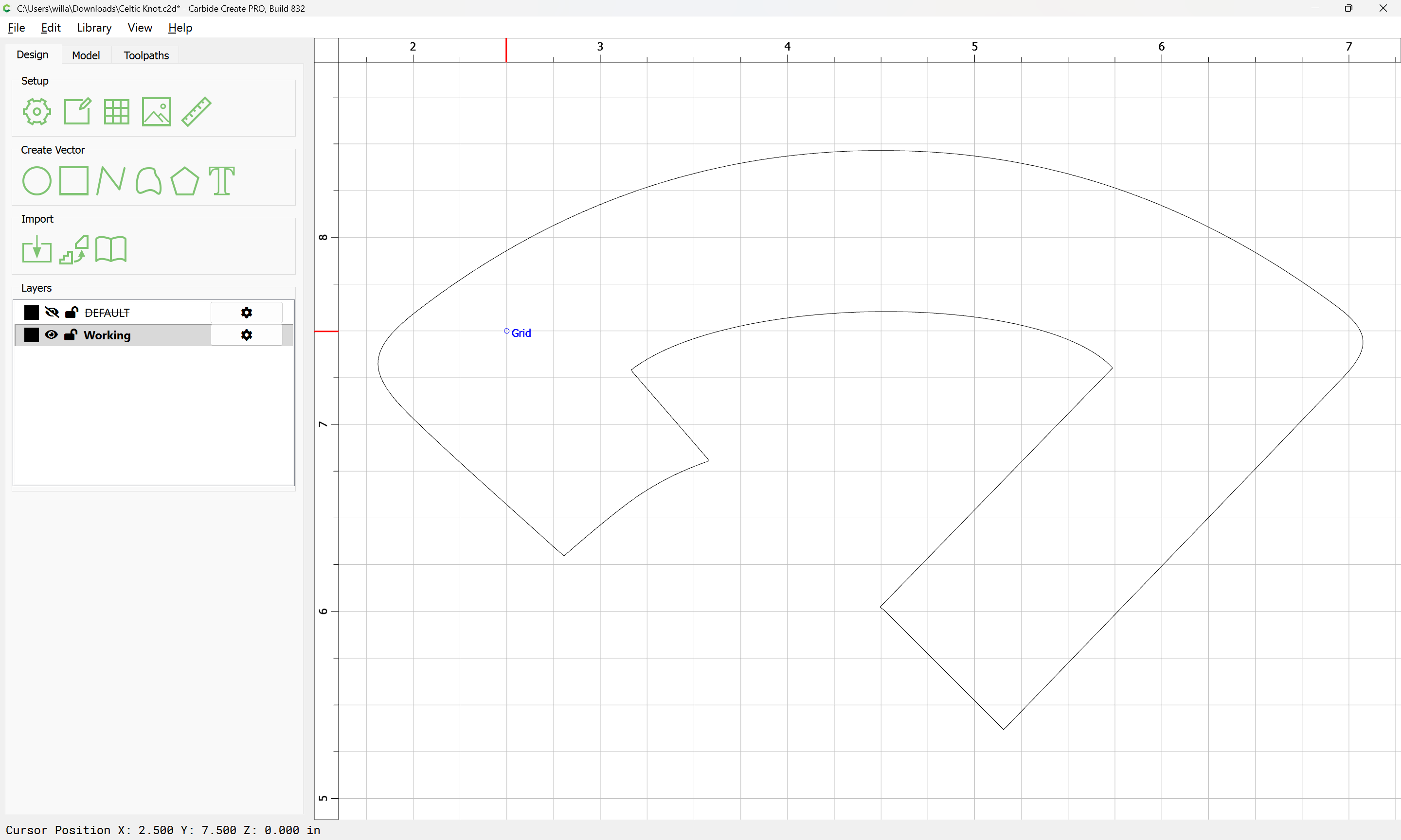

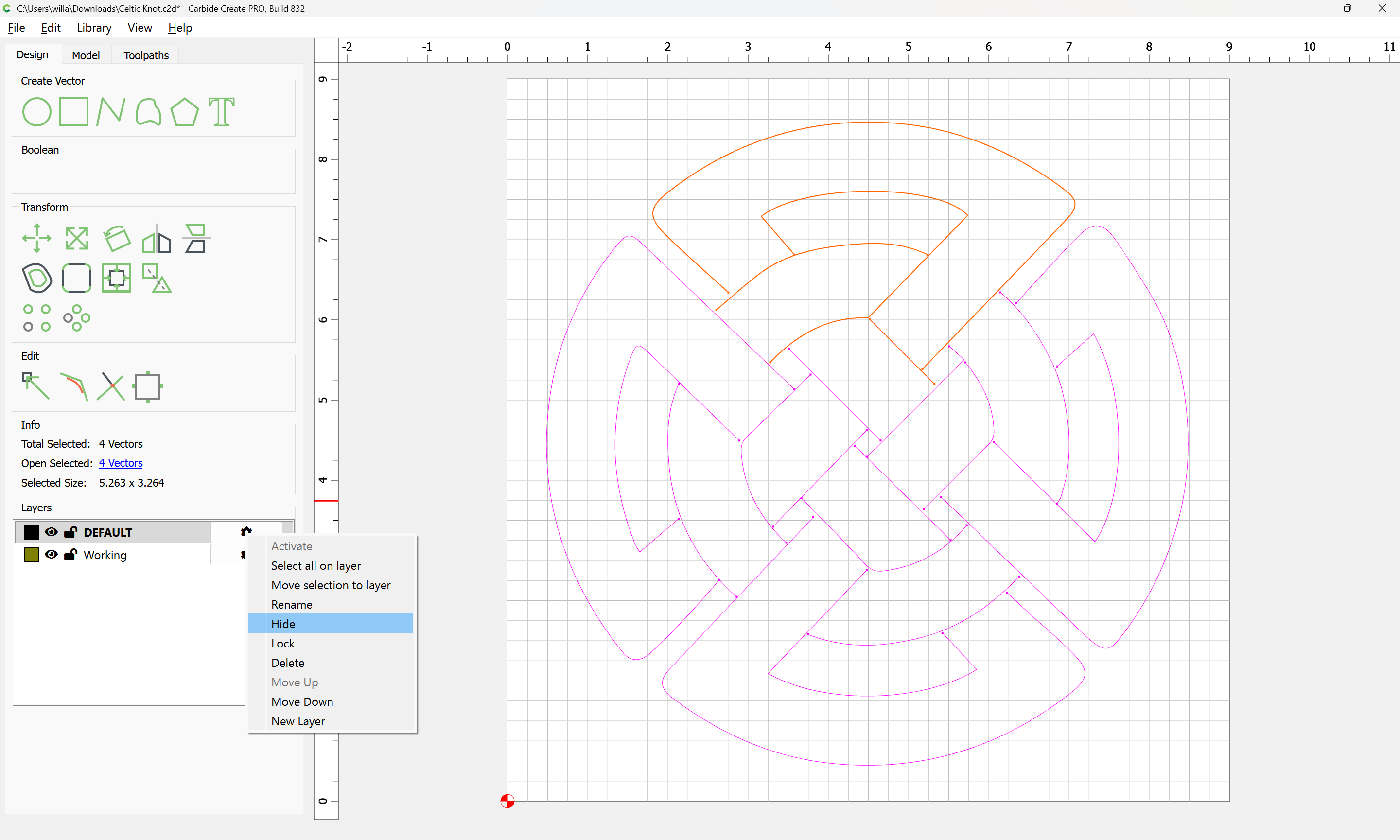

Select the elements which surround one region:

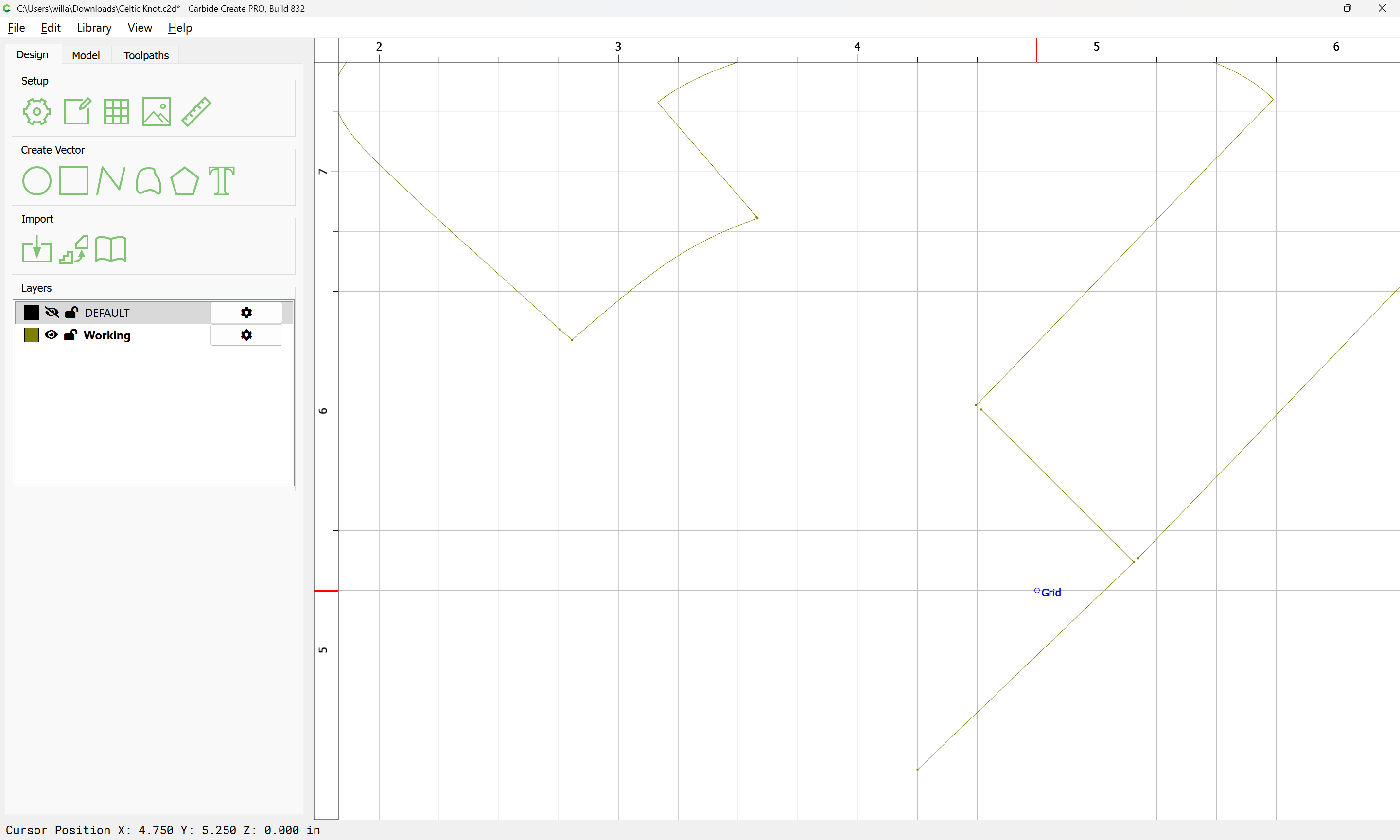

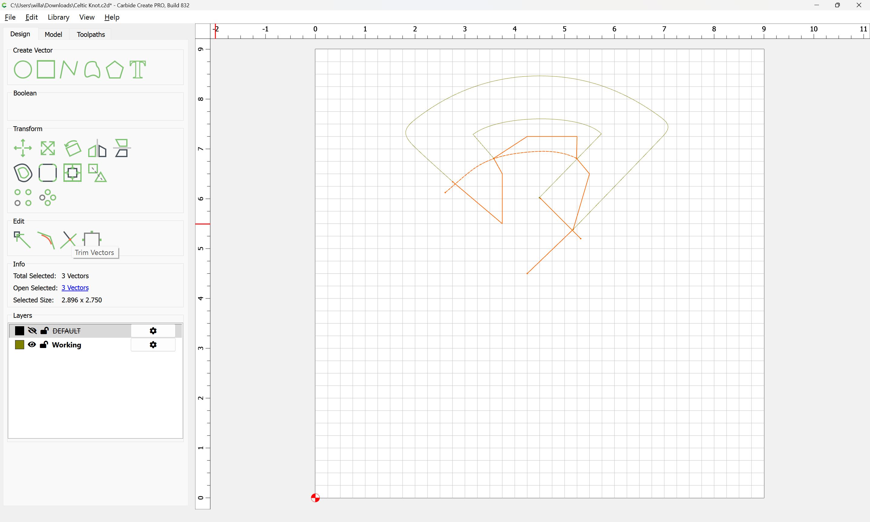

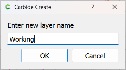

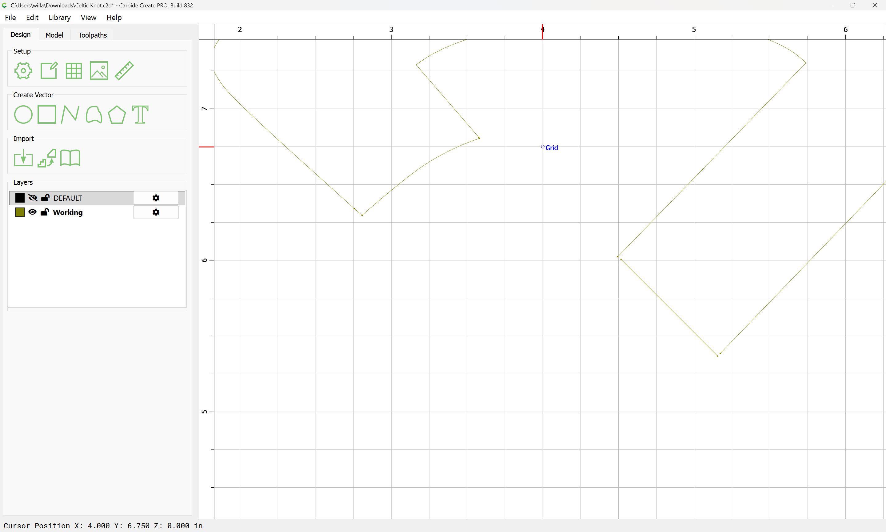

and duplicate them — to make things easier, make a new layer:

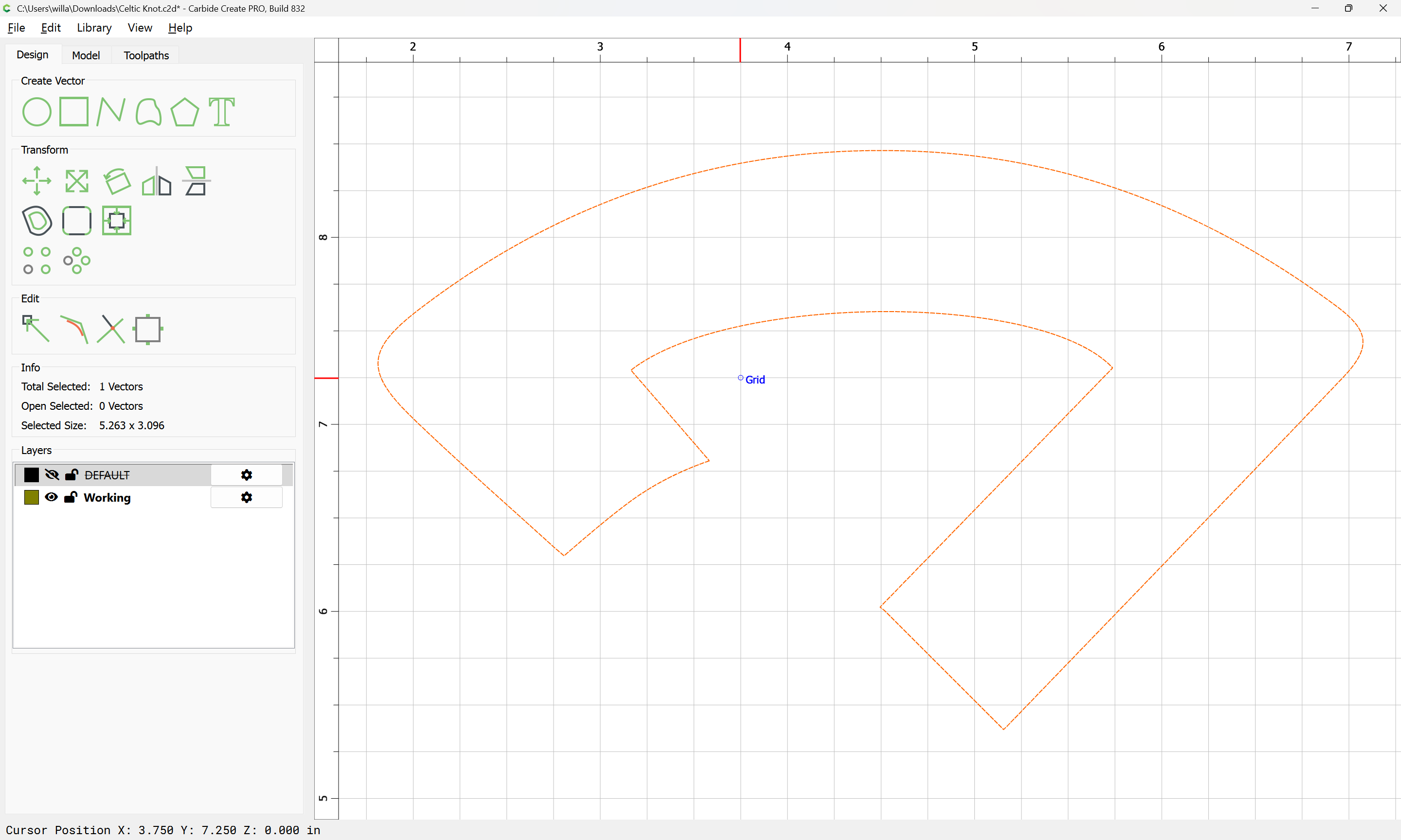

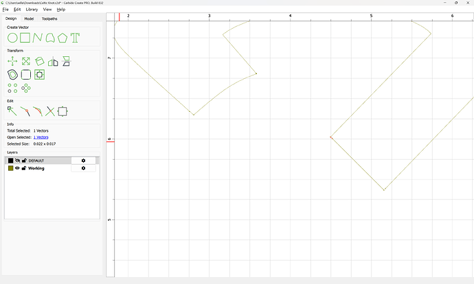

and hide the original layer:

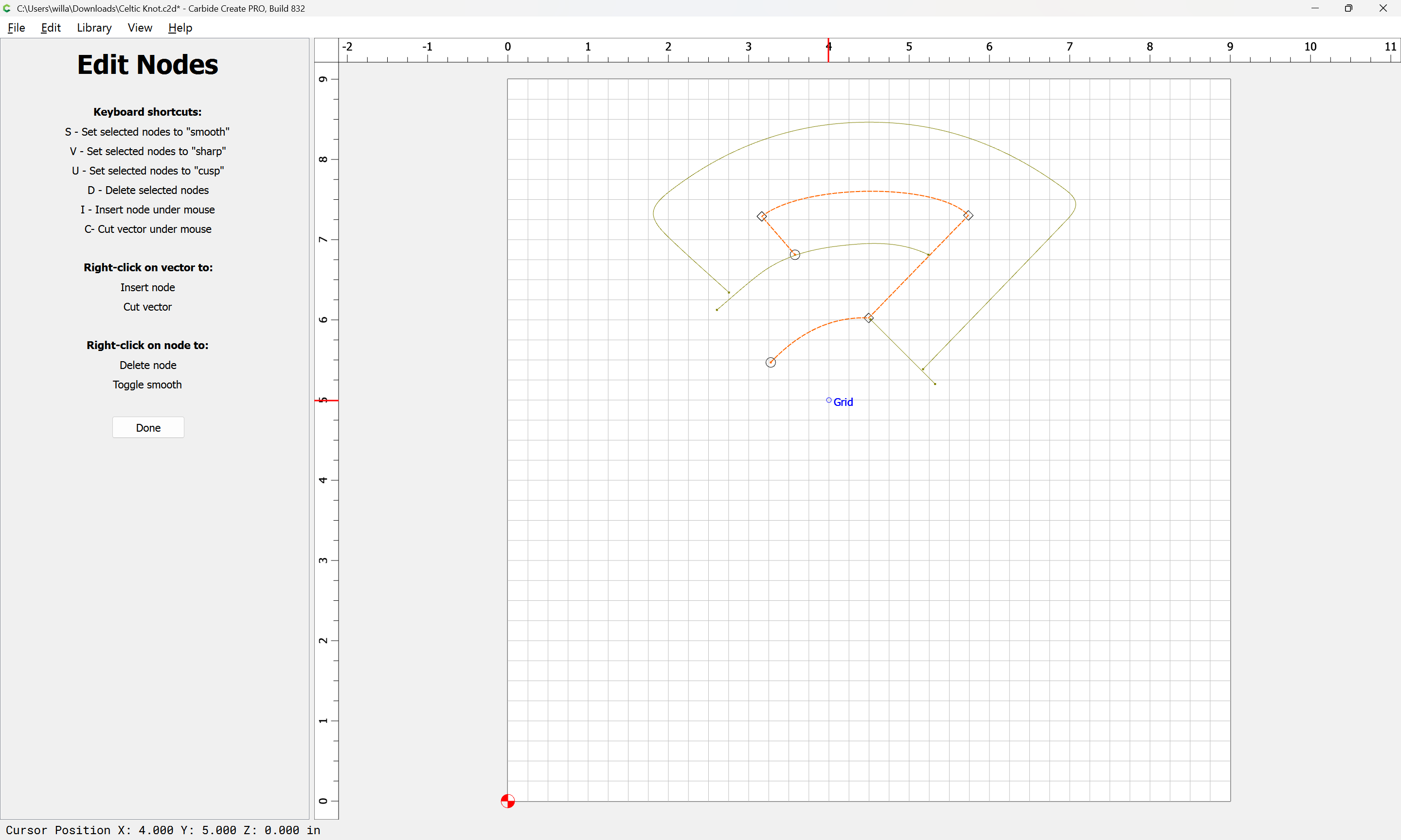

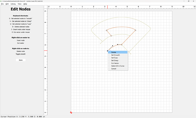

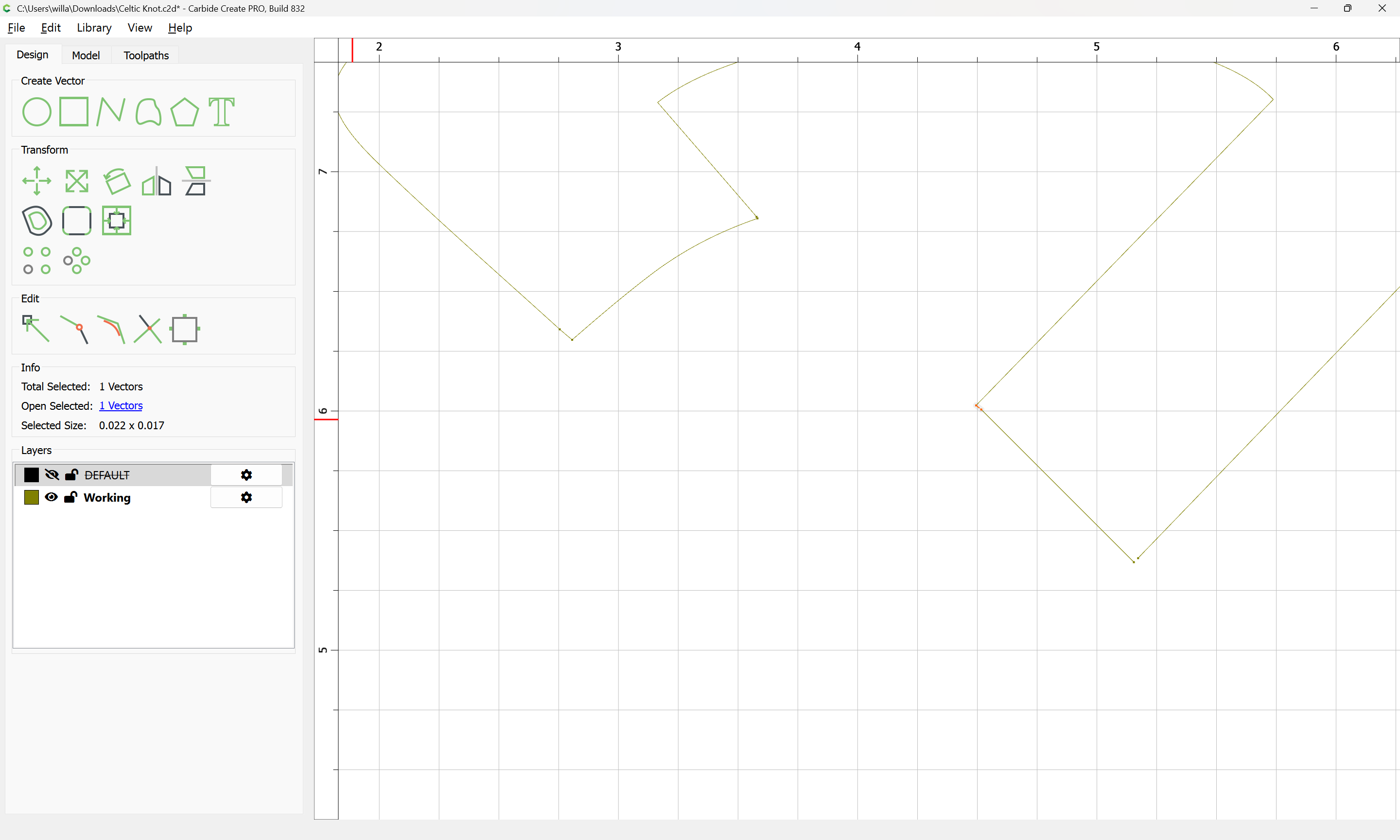

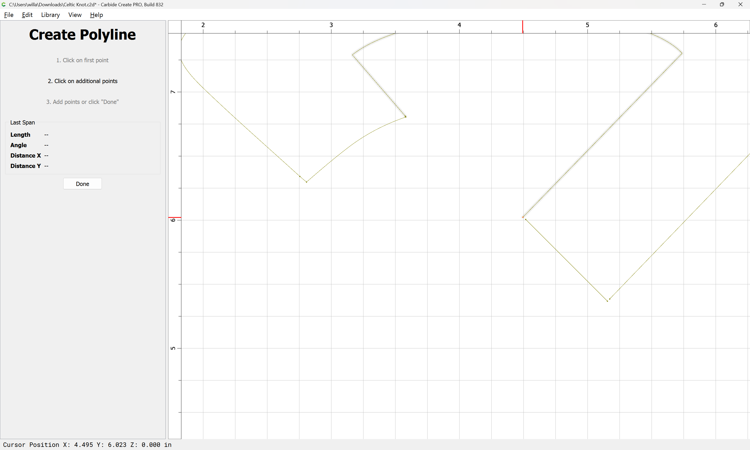

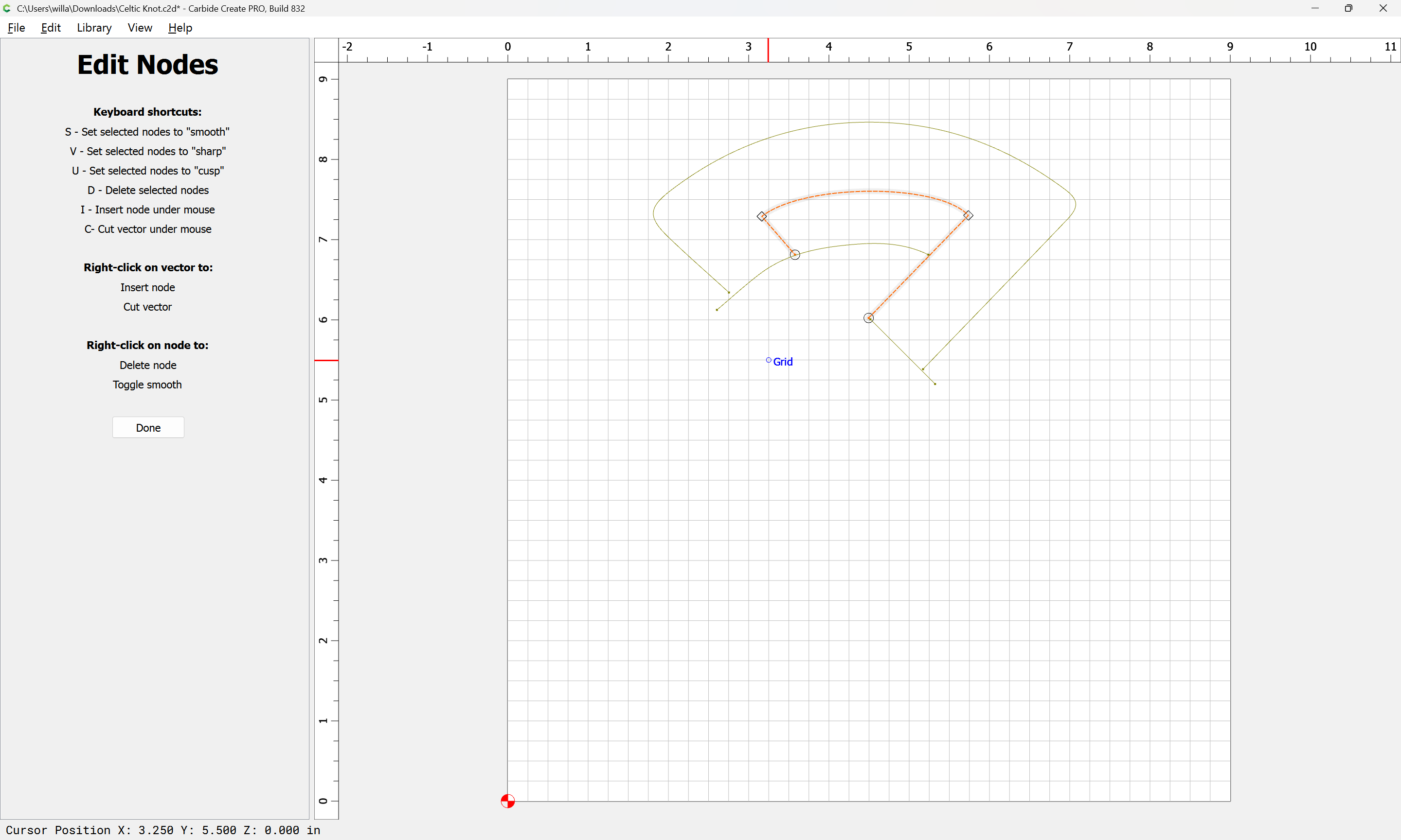

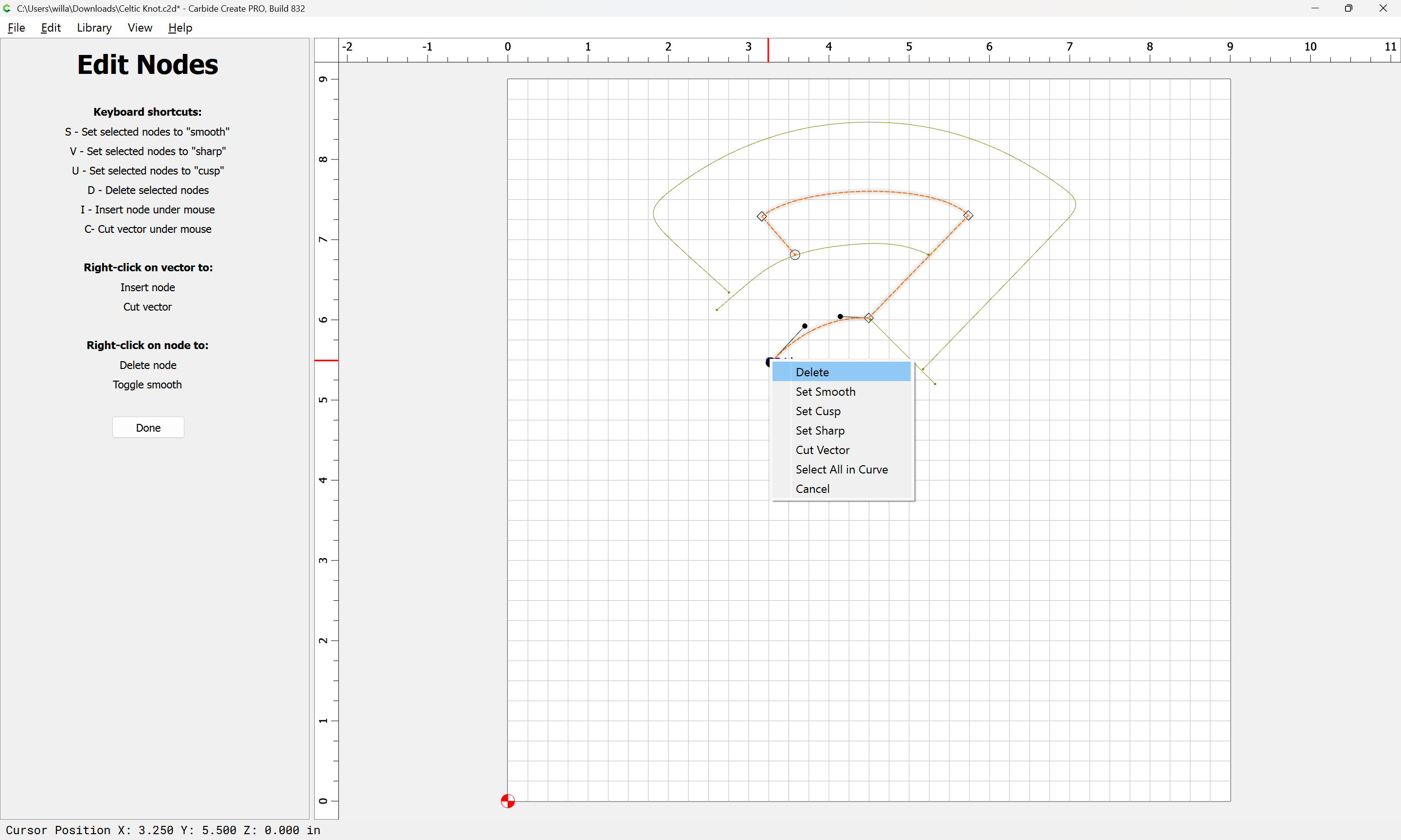

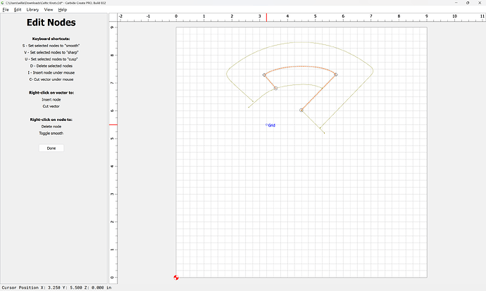

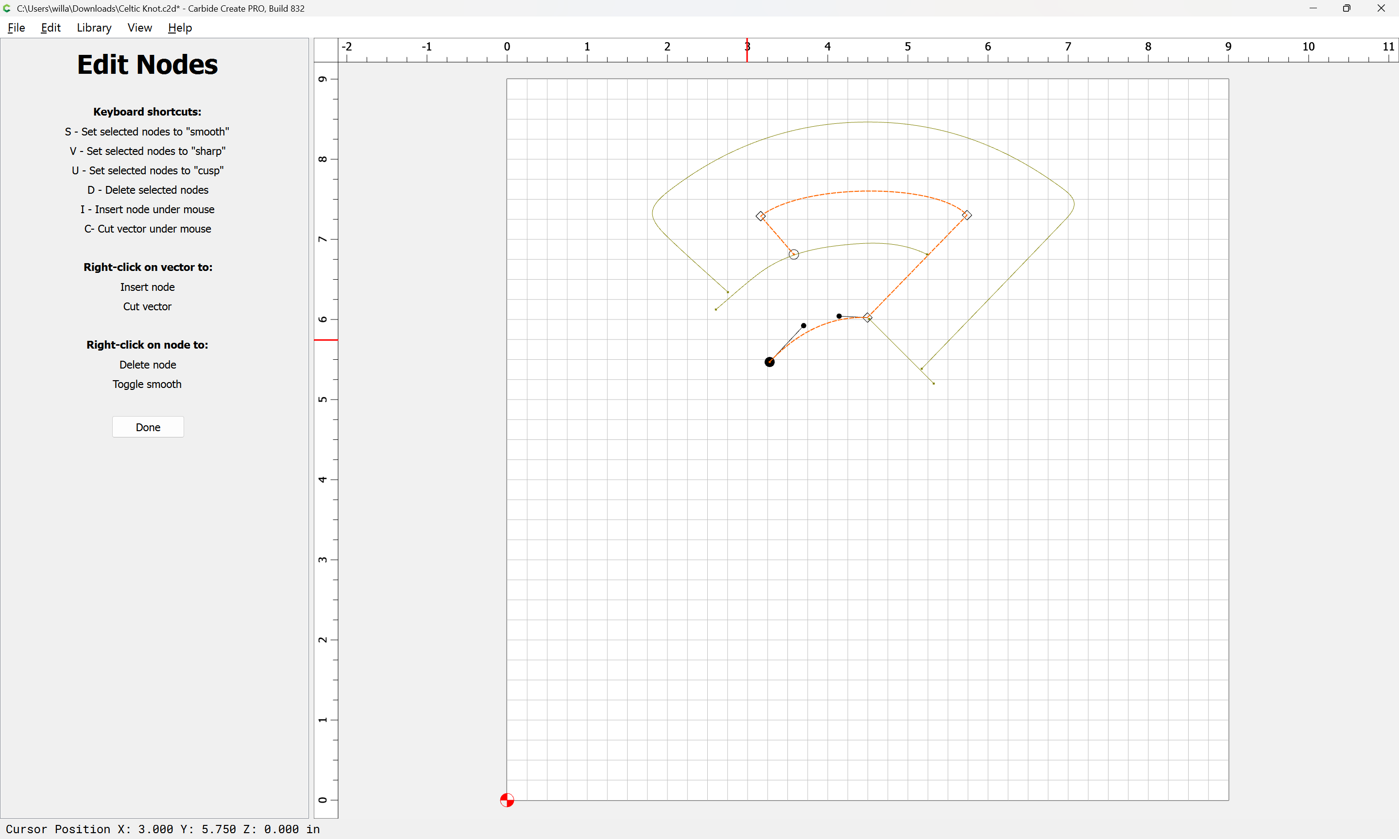

Select each element and Node Edit:
Done

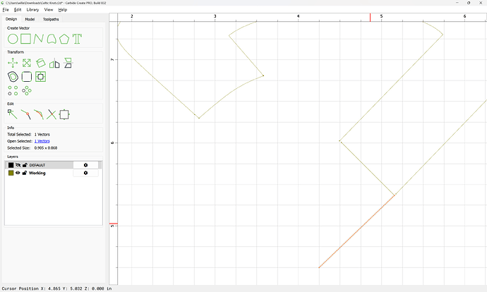

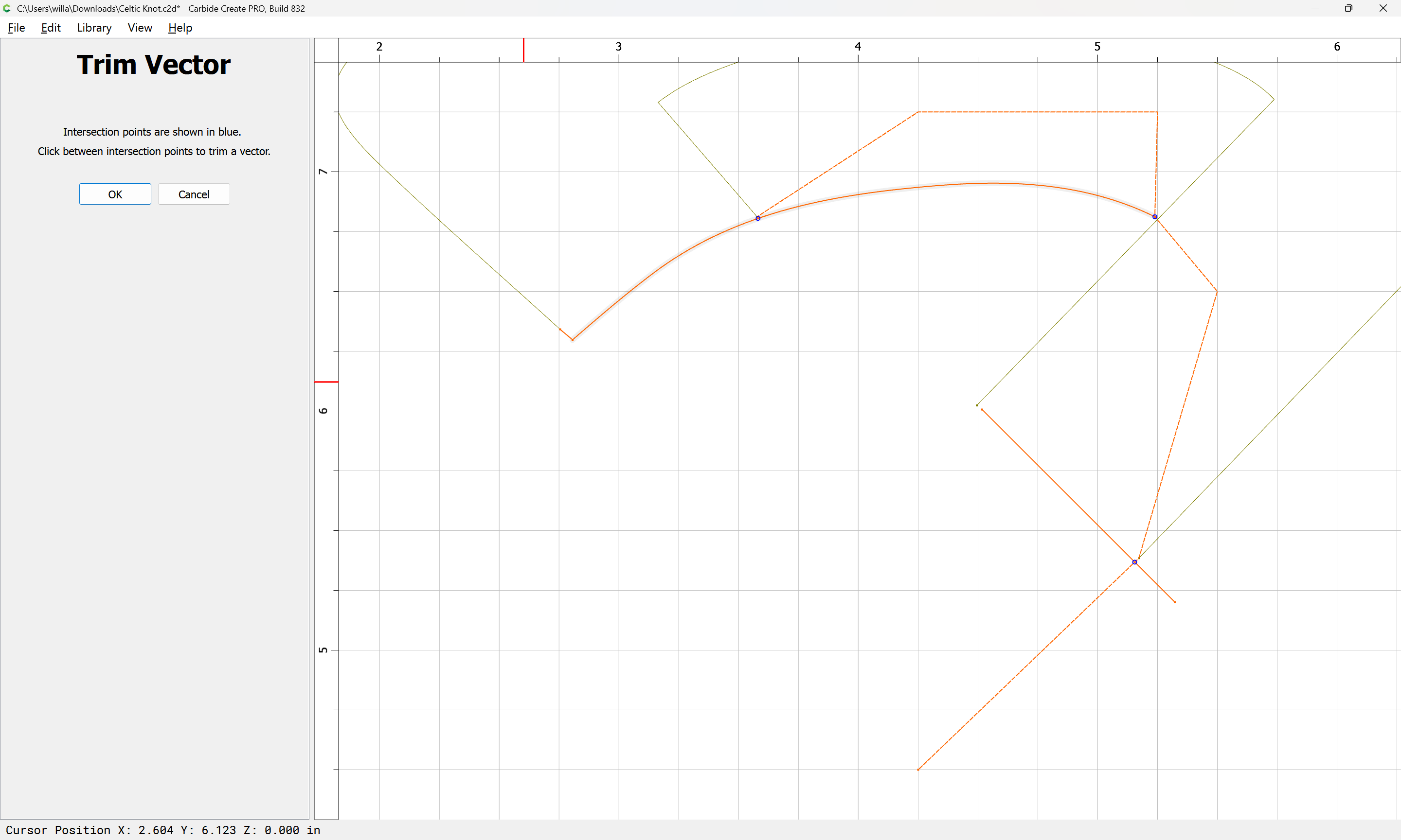

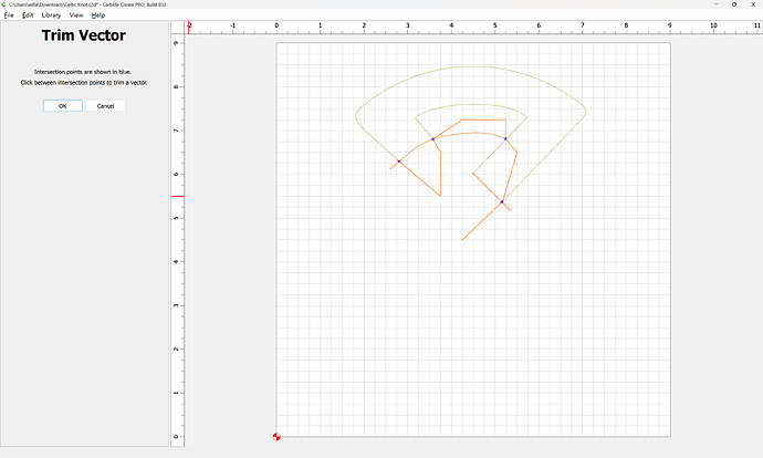

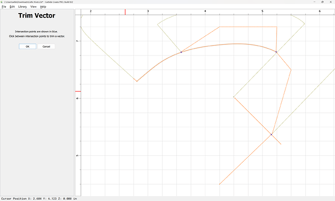

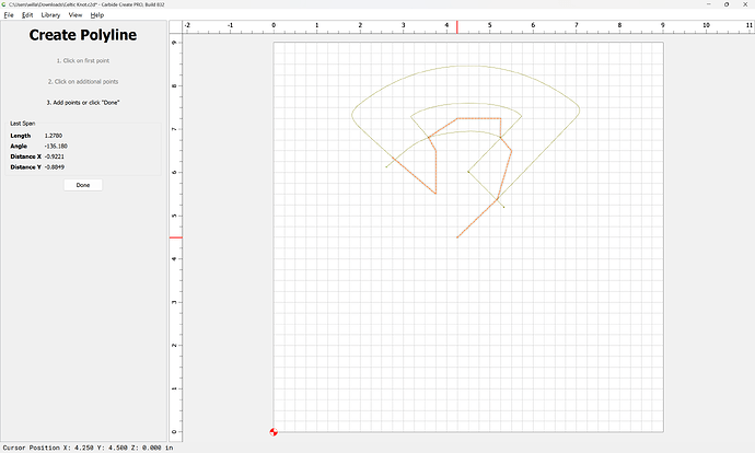

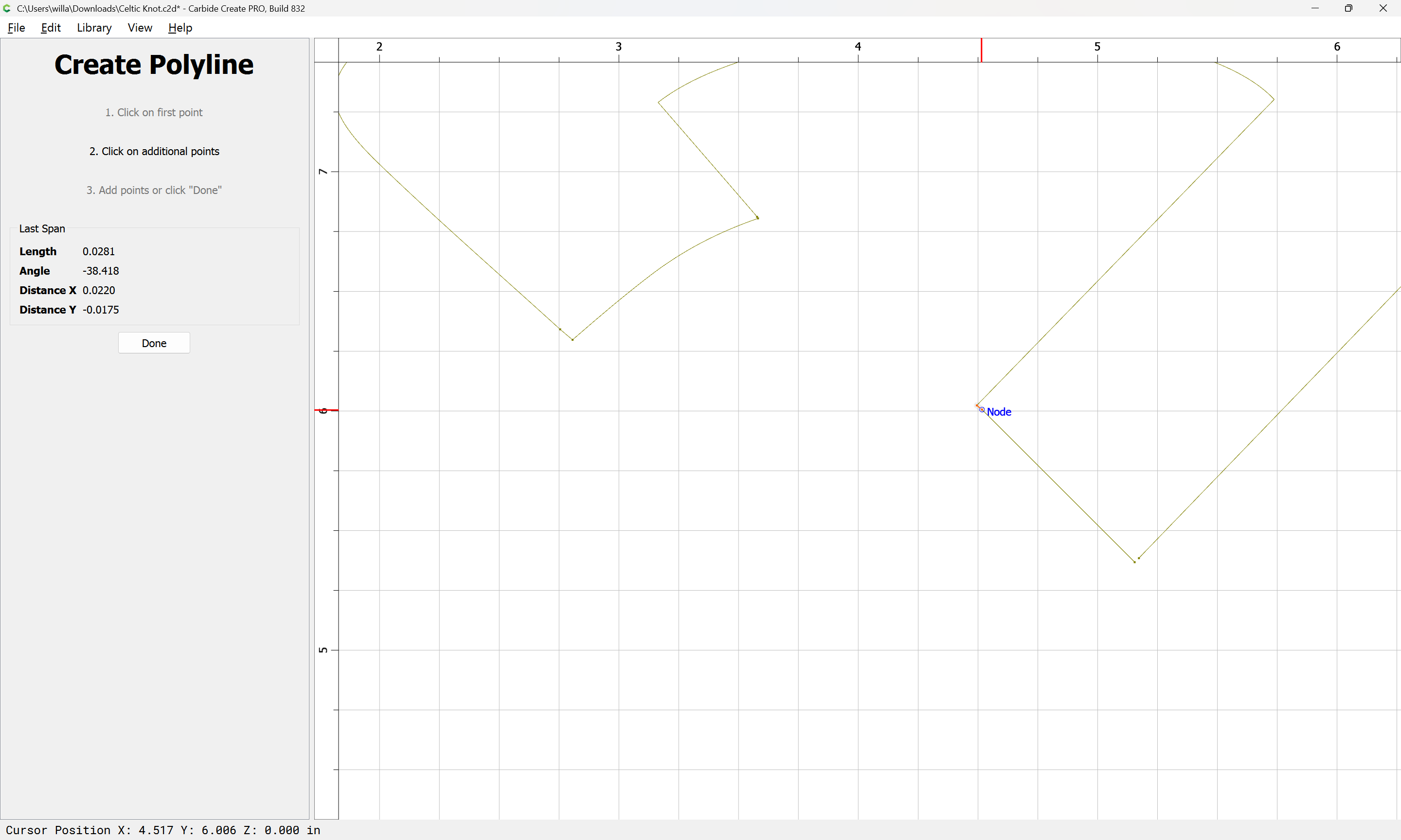

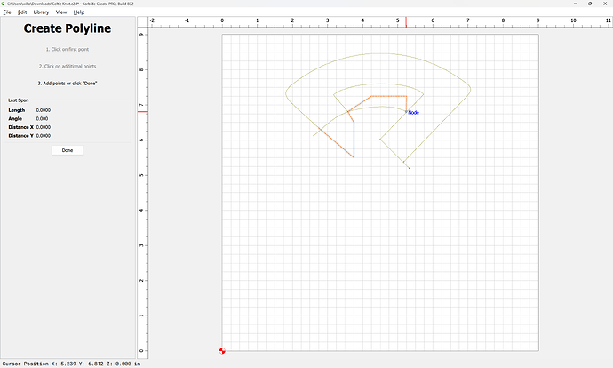

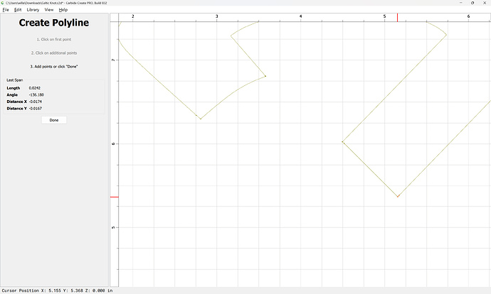

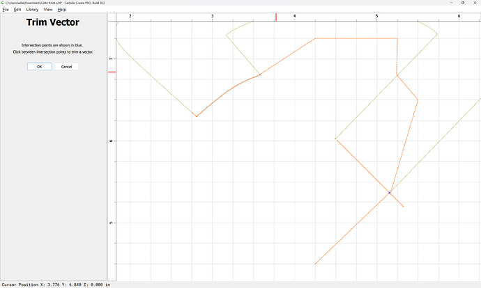

Then draw in geometry to isolate the elements:

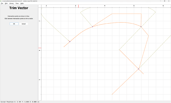

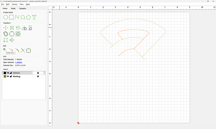

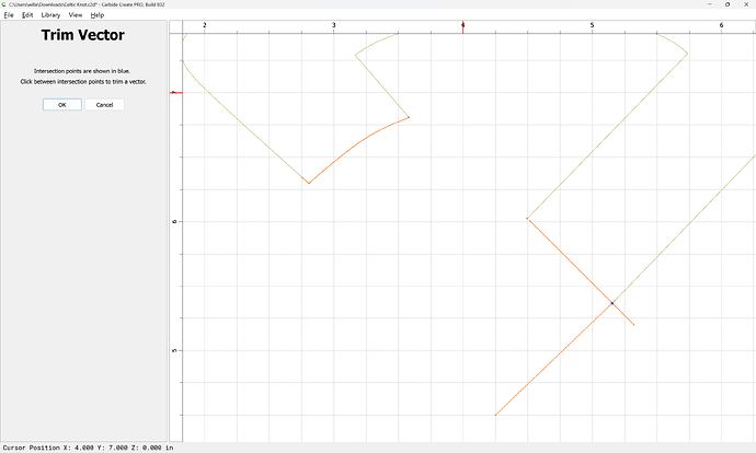

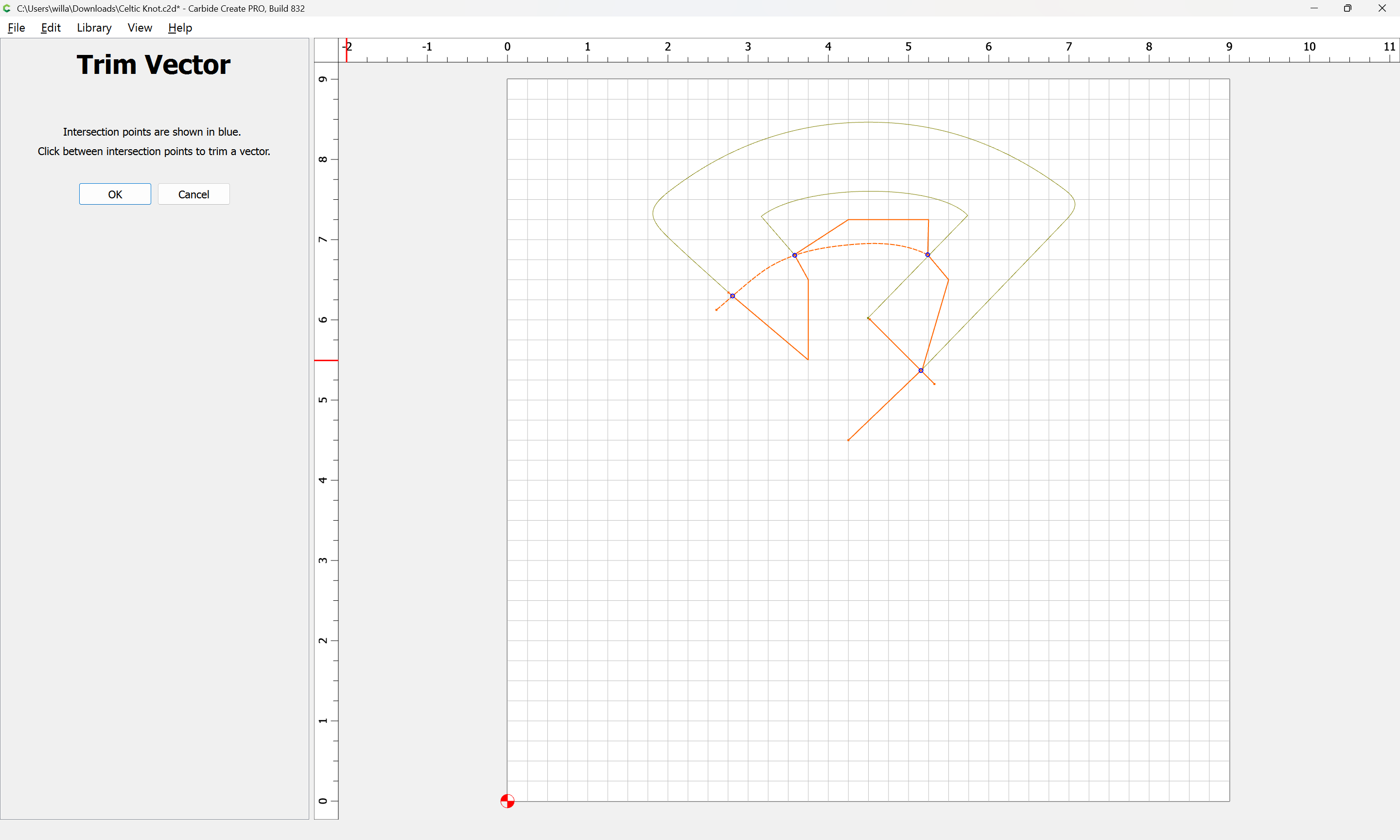

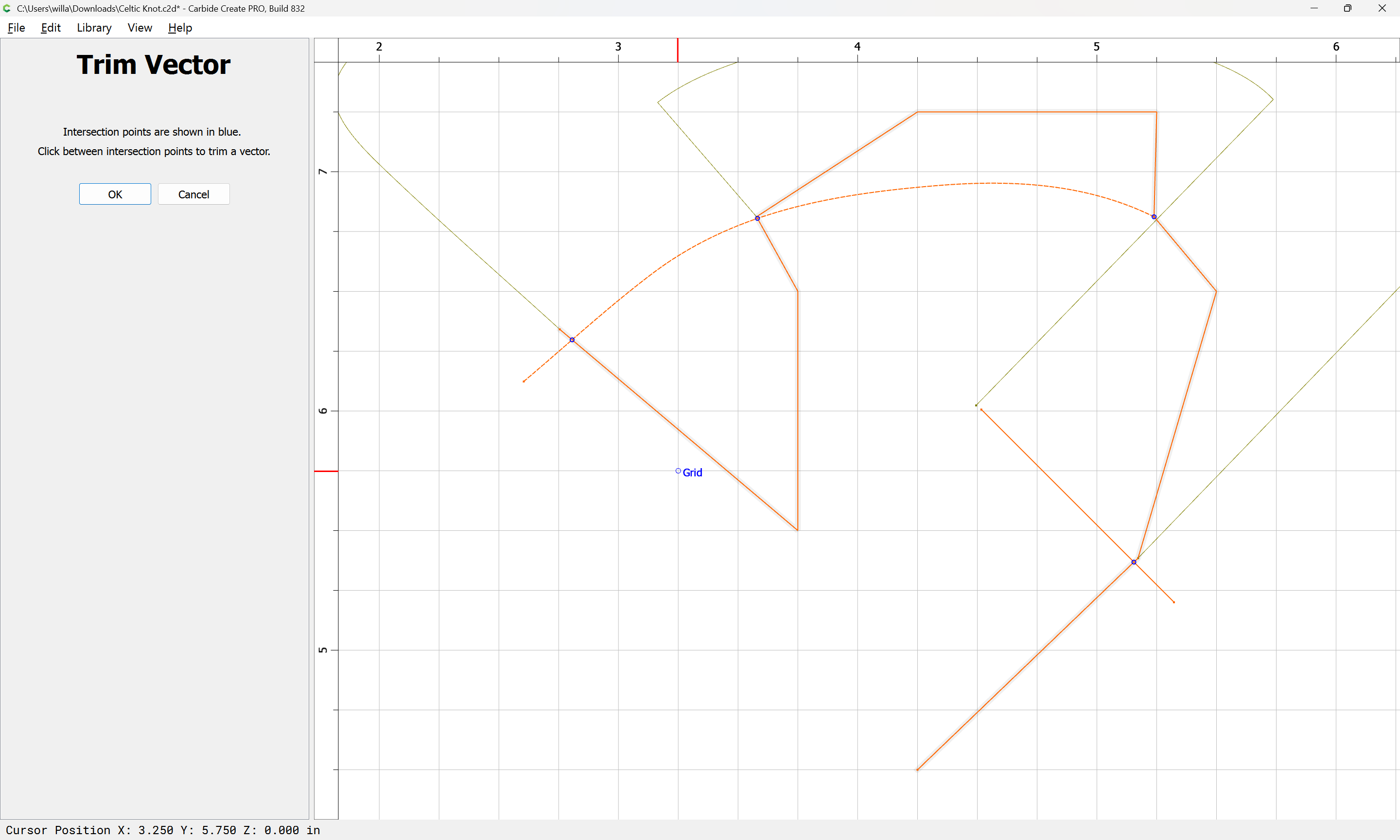

Select the elements:

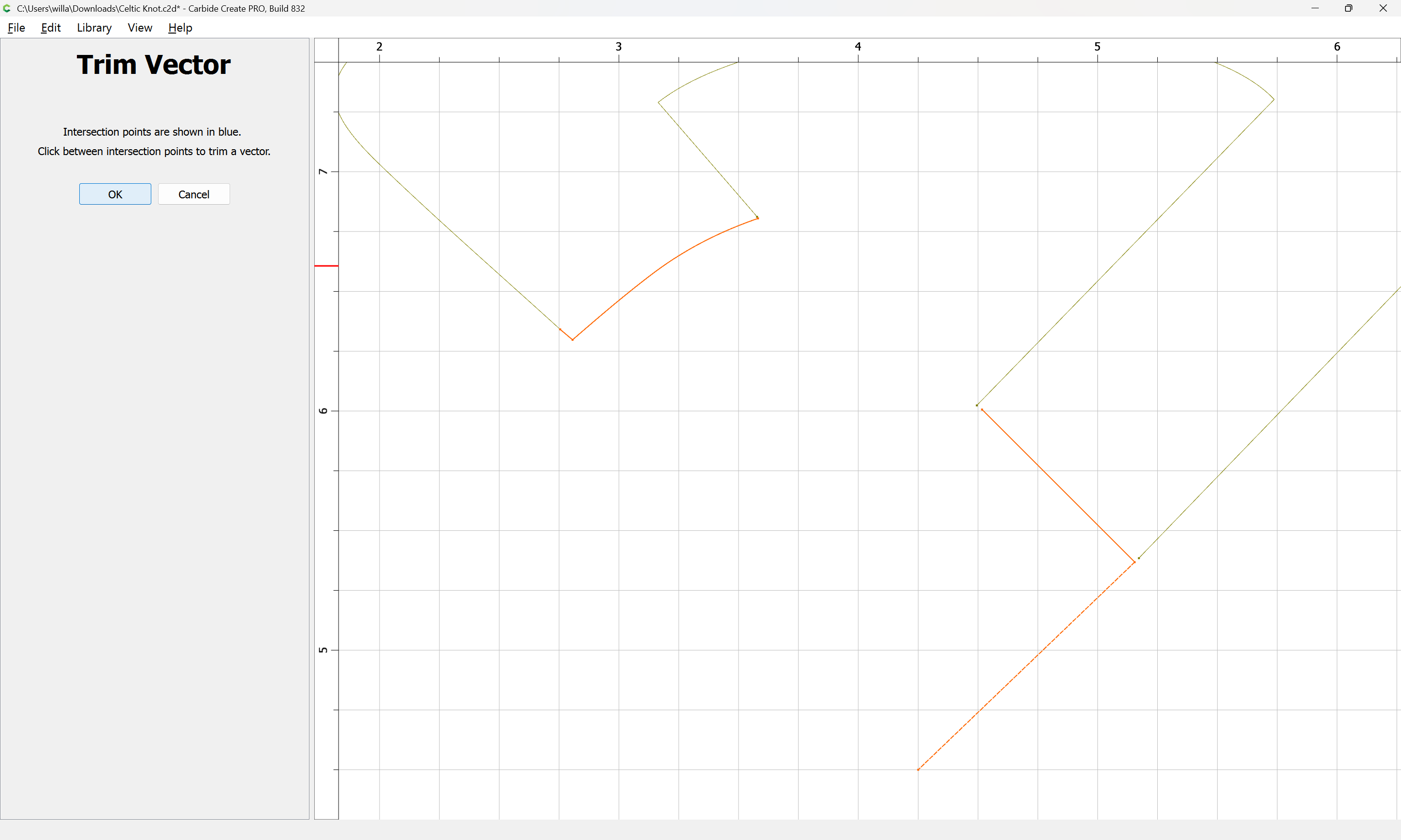

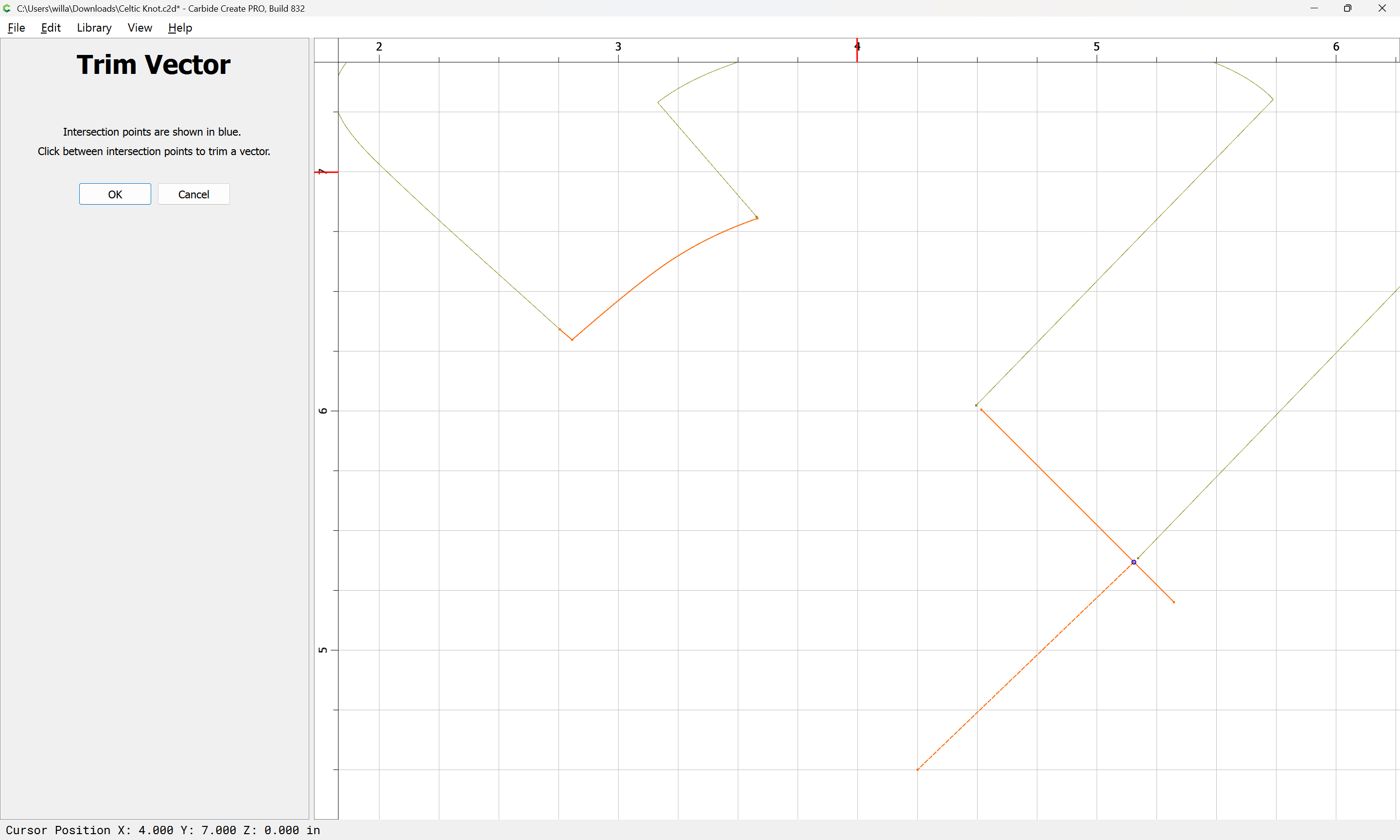

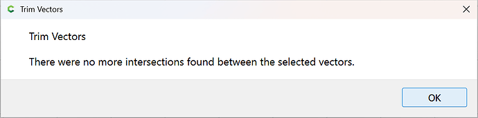

and use Trim Vectors:

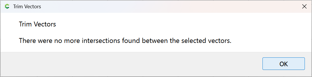

To isolate down to only what is wanted:
until one arrives at:

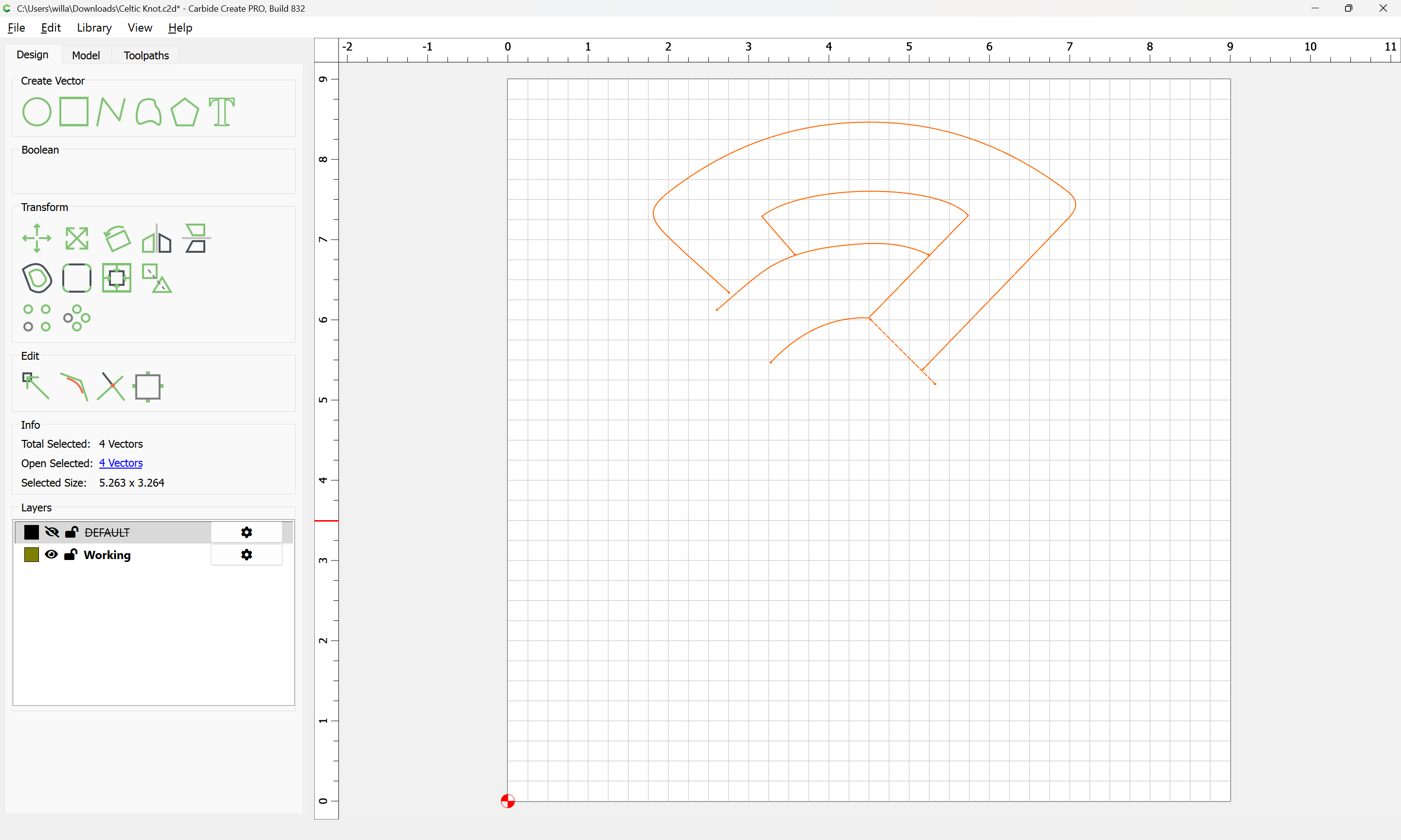

OK

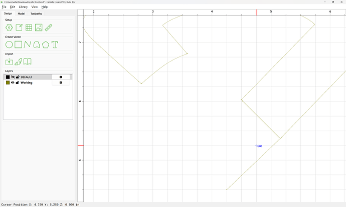

Select anything which is not wanted:
and delete it:

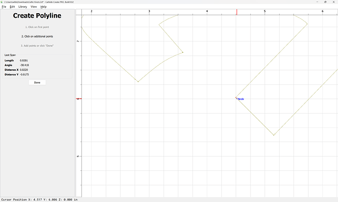

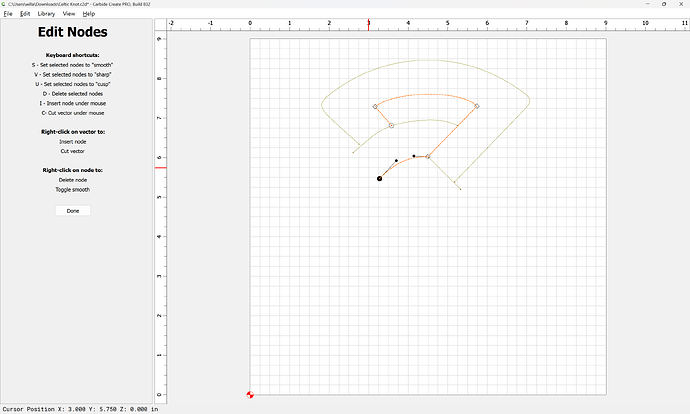

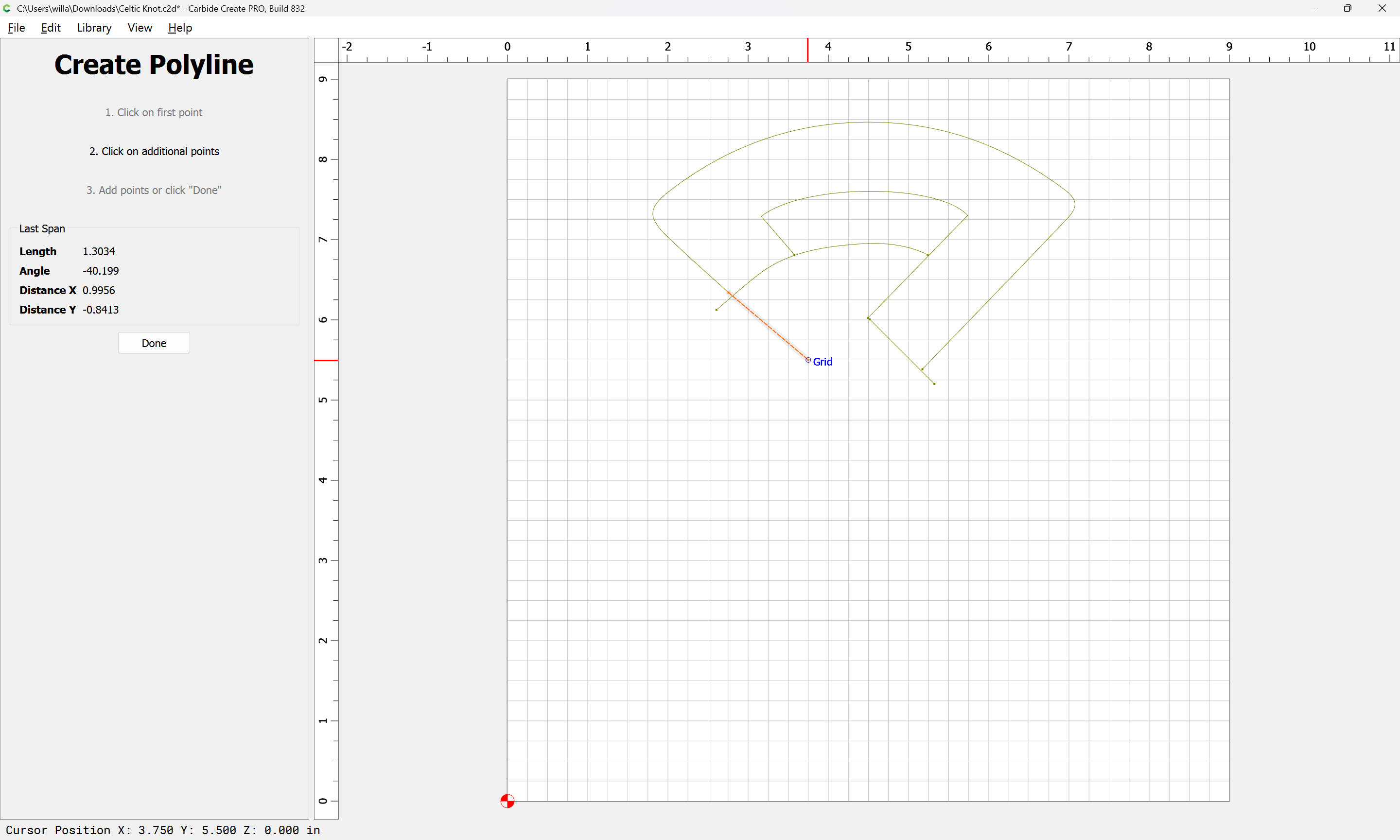

Draw in lines where necessary to close gaps:
Done

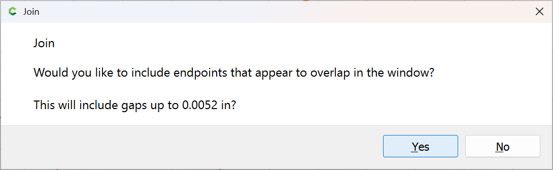

Select everything:
Join Vectors
Yes

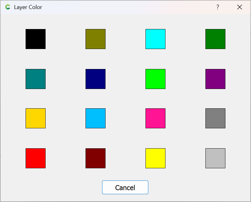

If we change the layer colour to black:
We see that the region is now closed:

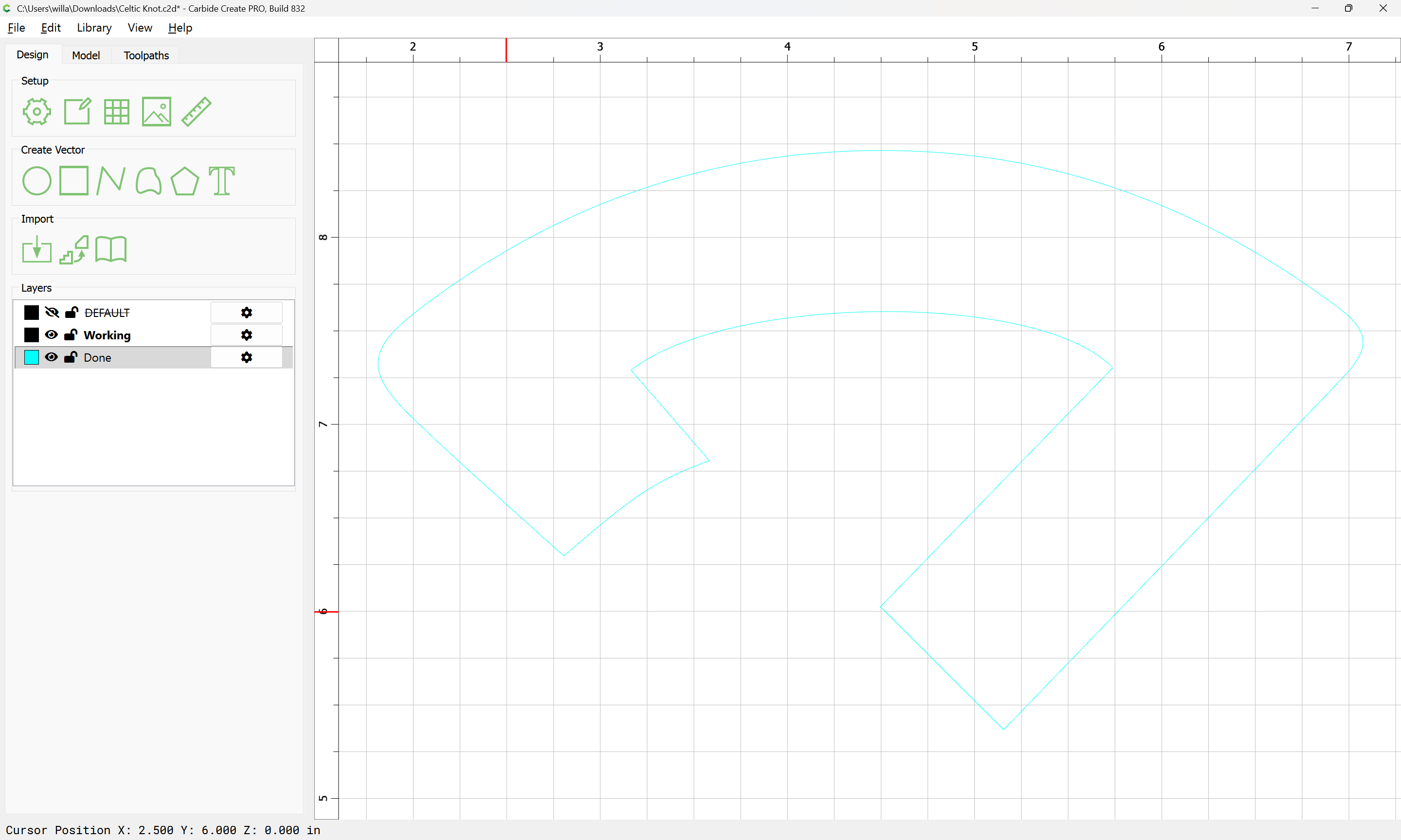

Repeat this for each other region…
Make a new layer for Done elements and move the finished elements to it:
Repeat for each other region.

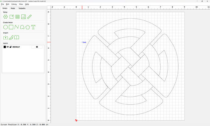

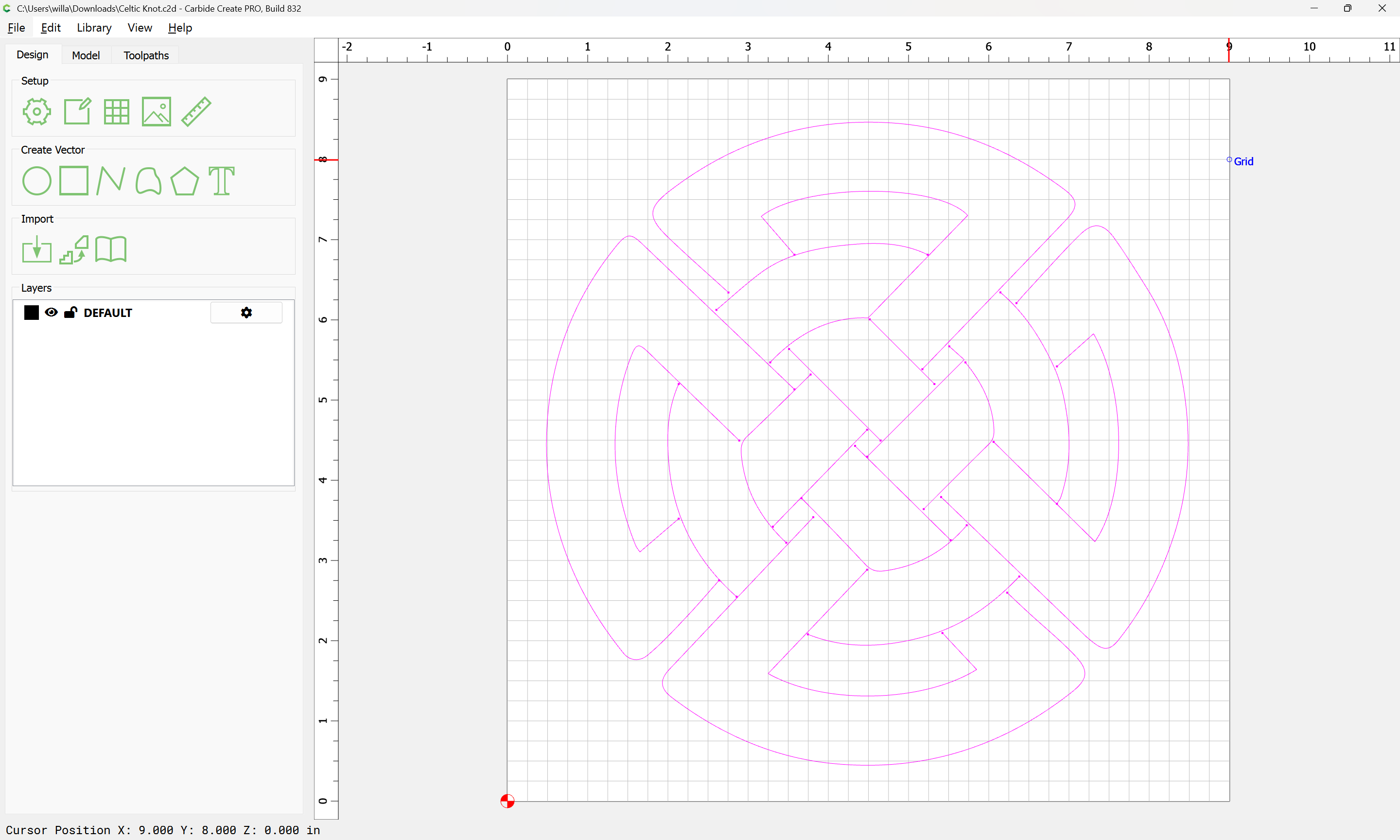

Eventually, one arrives at:
Attached as a v8 file.
Celtic Knot_v8.c2d (72 KB)

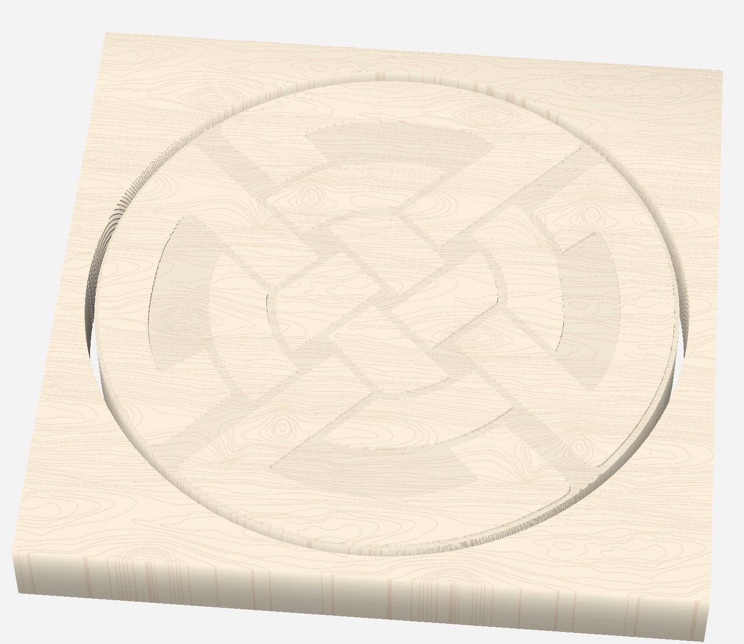

@WillAdams Thanks so much for the thorough explanation - and for an updated source file. It was really helpful. I was able to use that file and your instructions to figure out how to get this looking like I wanted it to.
I ended up creating a new layer for the negative space in the design and created the shapes for that. I simulated a pocket cut for those shapes. Then created a contour cut for the positive space/default design (no offset). Finally, I made a third layer for the perimeter (contour; bottom of stock) to cut the design out.
At this point it’d just be a bit of tweaking to get everything just exactly perfect, but the whole exercise was really helpful as I’m starting to get the hang of 2D editing in Carbide Create. It took me a bit to understand how to edit nodes, and there are still some UX things I don’t love/need to figure out, but by and large I consider this a success given I just downloaded the software for the first time earlier this week.
