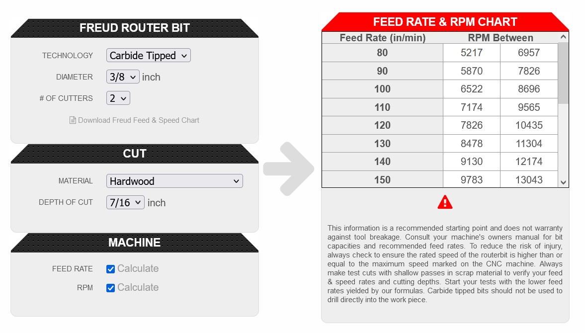

I did some more research for the Freud 70-104 Keyhole bit that I have. I found the specs and on the Freud site I found a F&S calculator for the bit. They dont ask for the machine type but they ask for depth of cut (7/16") and RPM (16000).
Please comment on this Freud recommended speed and feed. I would need to be running over 150 IPM to get to my Dewalt router minimum speed.

I refined my tool definition after cutting a test. The Freud recommended F&S was way too aggressive and the router was howling. I modified the parameters in my tool data base to 10 IPM Plunge and 60 IPM. The piece I wanted the key holes went perfectly.
I put 3 keyholes in, one in the center and two more spaced 6" apart. You can hang it with 1 or 2 screws. I will make a paper template to drill the holes in the wall.
Here is my tool database for the #701 Freud 70-104 Key Hole Bit
number vendor model URL name type diameter cornerradius flutelength shaftdiameter angle numflutes stickout coating metric notes machine material plungerate feedrate rpm depth cutpower finishallowance 3dstepover 3dfeedrate 3drpm
701 Freud 70-104 Keyhole end 0.39 0 0.25 0.25 0 2 0 Shapeoko Hardwood 10 60 16000 0.4375 0 60 16000
