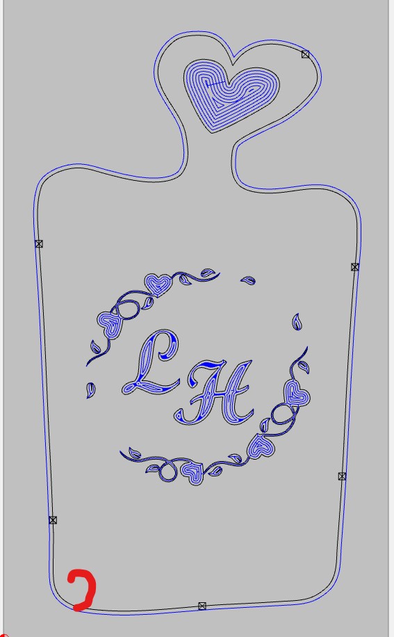

Hello Im hoping someone can take a look at this project. Yesterday I ran this project and it was a few percent from being done. It was finishing the last contour path and all of a sudden made a direct turn back into the main piece, I dint have a specific picture but it almost seemed like it wanted to return to the path where it started from. It rendered the piece useless and locked everything up because it was a full depth cut. This happened one other time on a smaller project and I was unable to determine why it happened. Im not sure if its an error on my part or some sort of glith. Failry new to all this so any insight would be appreciated. Ive added a highlighted drawing to show the path the bit took at end as i described

This can happen if the endmill came loose in the collet.

It would cause it to make a turn like that? The whole spindle went with it
Where possible avoid slotting and add geometry and cut as a pocket
and/or
Yes and it will pull down into the project as well. @WillAdams gives good advice above

To add to what Will and Jeff posted, when I cut the contour outline of a project I will offset the initial cut (by 0.02”) all the way down to the tabs with a rough cut bit that handles contour cuts a bit better in my experience. Then I will swap to a standard downcut bit for the finishing pass to get a nice clean cut.
Hi Tim, thanks for your feedback, what I dont get though is why the turn if there is nothing in the toolpath designating that?

Lots of torque on the bits that can be affected by wood grain and or loose bits. I’m not the authority on these issues but have seen posts about them on the forum. I have a S5 Pro with the 65mm spindle and have not experienced this yet. I have have had issues due to my setups for toolpaths with som retract heights and cutting across a project, or two….
I do know from extensive use of hand routers that “slotting” can go wrong quickly especially with a climb cut and grain direction.
I didn’t see you mention which machine you were using when this happened?
Hi Tim i think you may be right with the slotting, the bit was deep at the time when it grabbed and pulled and I was definitely near the max cut depth. for that bit. I know what your talking about w hand routing so now it may make sense.
Im using a Shapeoko pRo 4 w same 65mm spindle

Yep, max depth on the bit is a lot of bit surface area to grab onto material.
