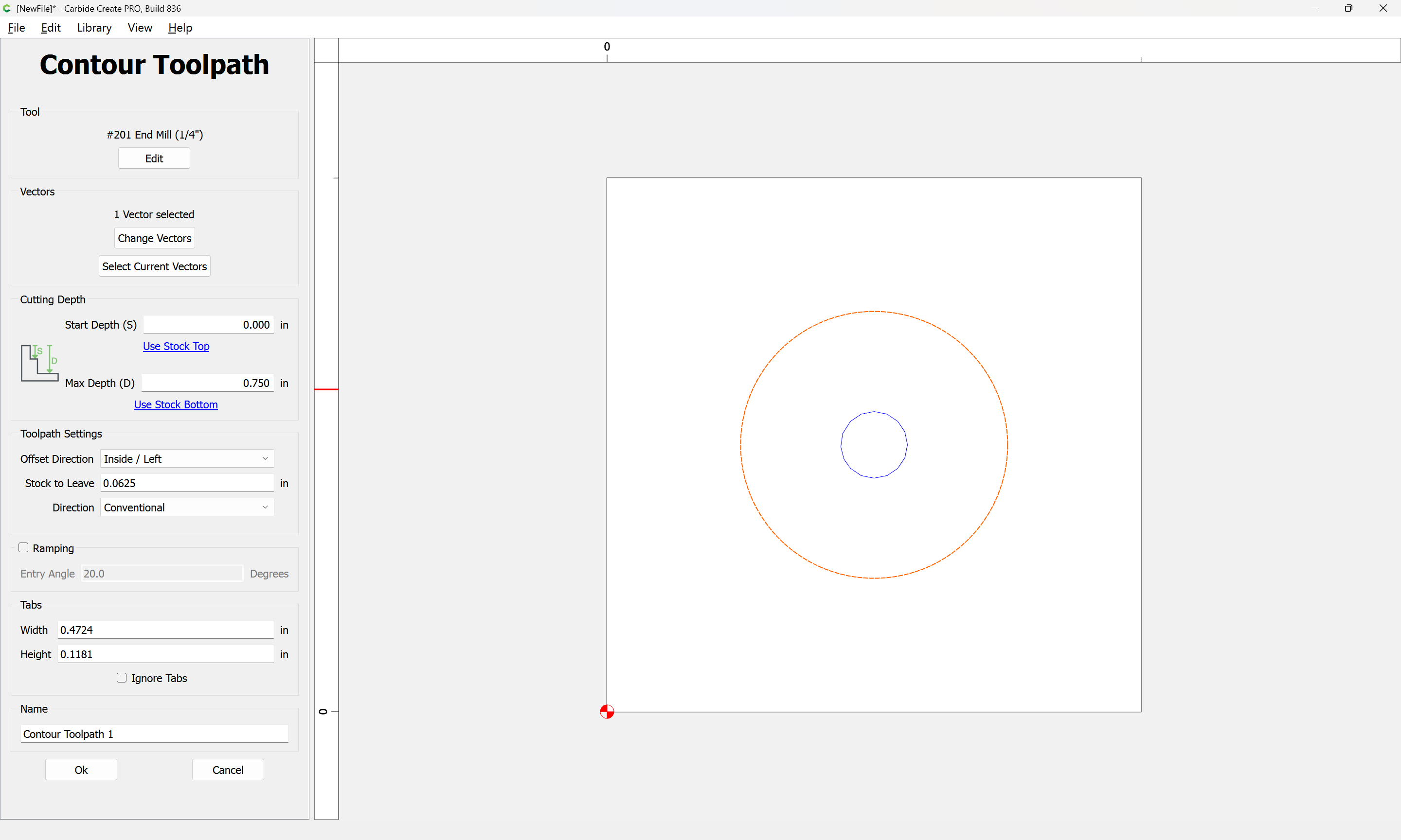

Tool deflection most likely.
If you have Carbide Create Pro you could use an Inside Contour and set Stock to Leave to greater than the defect you are seeing to make a roughing pass, then have a second toolpath which cuts to the final dimension as a finishing pass.
Where possible avoid slotting and add geometry and cut as a pocket. If you don’t have Pro, then add inset geometry:

One technique which is often suggested to avoid slotting is to add geometry around a part which one wishes to cut out and cut as a pocket down to tab depth — here’s one technique for that.

Big thing is the toolpaths — if cutting out, rather than just cutting a slot:
[image]
Offset to the outside by endmill diameter plus 10% or so:
[image]
[image]
[image]
Then cut as a pocket:
[image]
down to tab height or the penultimate pass:
[image]
then move the contour down to below the pocket and start cutting at the bottom of the pocket:
