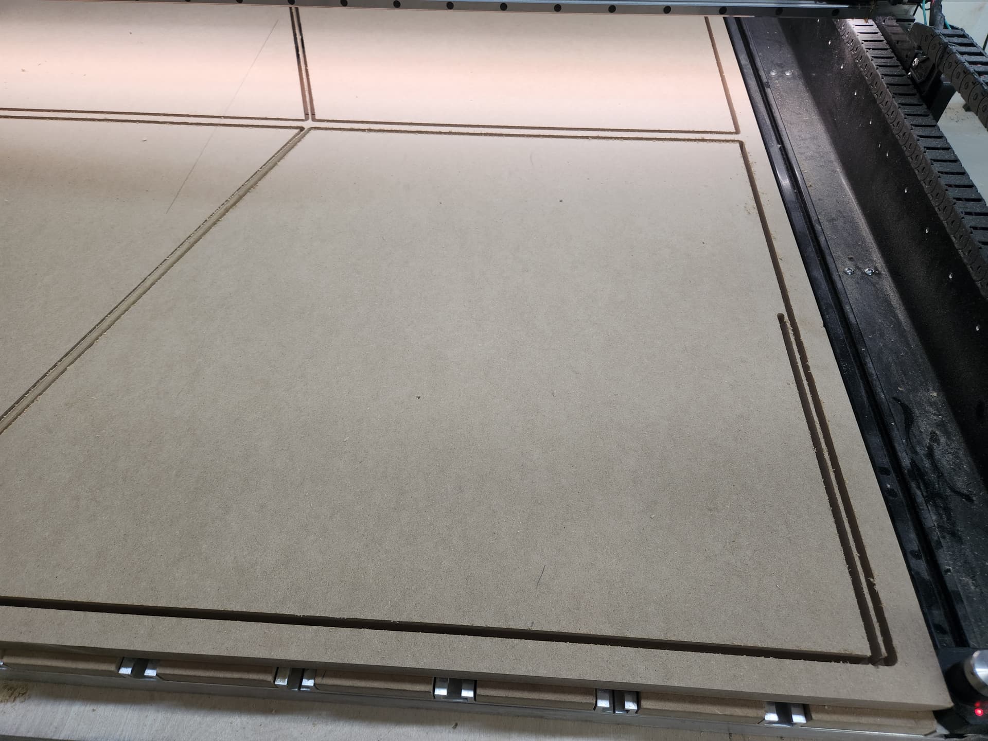

Im new to this. I have a 5 pro. I have only made 2d designs. Noting crazy. The problem seems to happen when the machine goes from 1 part to another part. It acts as if the X coordinate. Then cuts at the current depth across the work piece.
The preview looks just fine but it just goes rogue randomly. Im cutting with factory settings on MDF. The ma hine has already destroyed about 4 full sheeets.

This was the first time that i took a picture.
I lower the spindle to the surface and turn it until i feel resistance and sed that as z zero.
I have bitsetter installed and enabled.
The material appears to be 0.50 thick and you are doing a contour cut.
Contour cuts generally create drag that might make your unit lose steps while cutting. A pocket cut, while taking more time is easier on your machine.

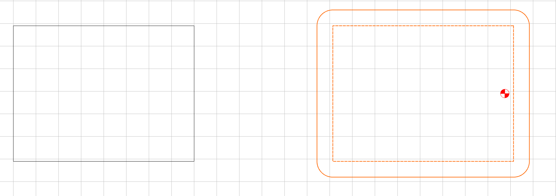

To avoid this, the usual advice is to pocket the perimeter instead. Are you using CC? In CC, you would use ‘Offset Vectors’ to the outside, and pick a distance about 10%->25% larger than the diameter of your bit. Then, do a Pocket operation between the original perimeter and the new vector:
On the left, a simple perimeter, on the right, the same perimeter PLUS a vector 7mm (a bit bigger than a 1/4" endmill) away.
Now instead of a contour (on the left), do a pocket (on the right).
Where possible avoid slotting and add geometry and cut as a pocket

Seeing how close your design is to the bitsetter, it almost looks like your passes were missing it until your Z was low enough (spindle or dust boot) to finally hit the bitsetter, thus throwing off steps.
Check that the set screws on your stepper motor / ball screw couplers are tight. One might have slipped.
The bitsetter was never hit
In your picture, it looks like it cut fine when it first went to the part in the lower right. Then after a few passes it became off. Is this correct?
You said it randomly happens, do you mean sometimes it cuts fine and finishes the entire sheet and randomly does not finish but fails in the same corner, or it never finishes a sheet and randomly fails, sometimes on other areas of the sheet?
