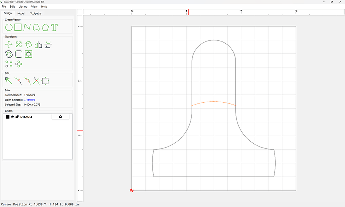

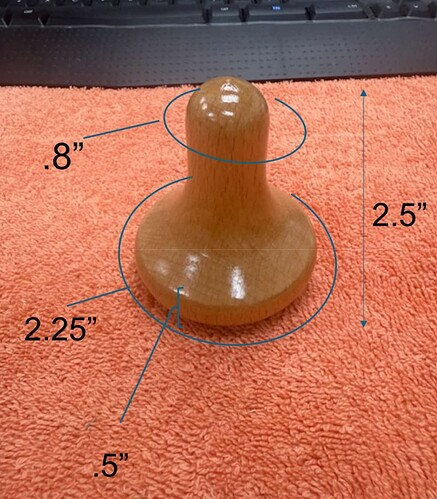

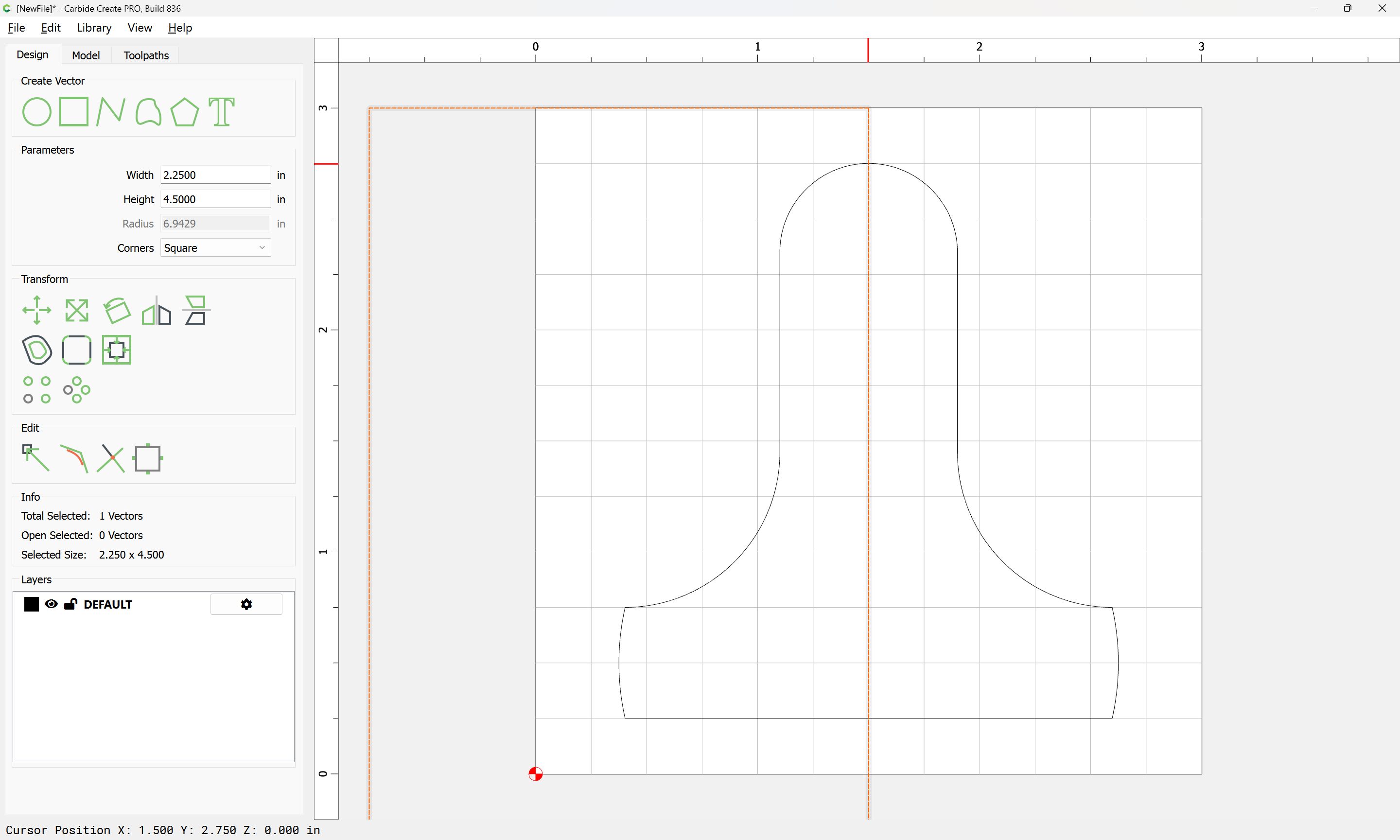

Making an object in the round
as requested on support…

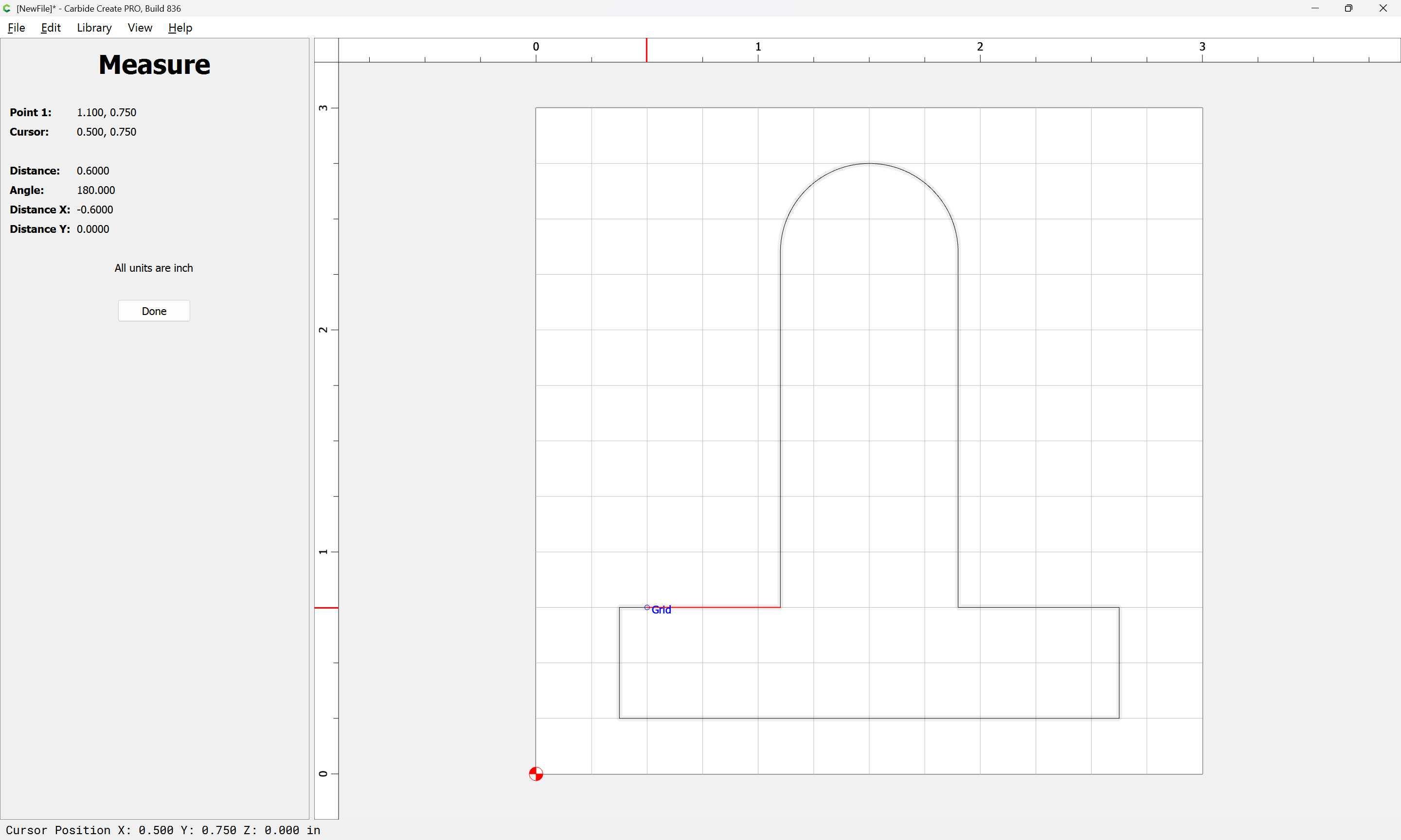

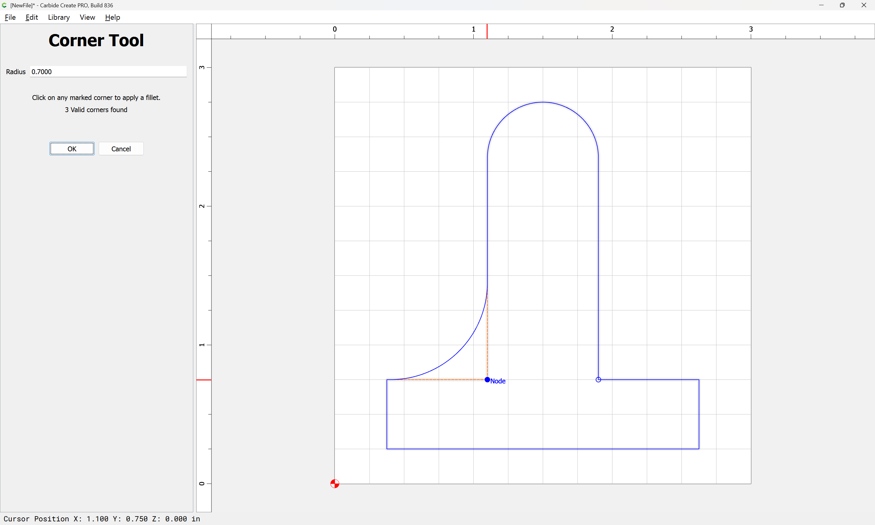

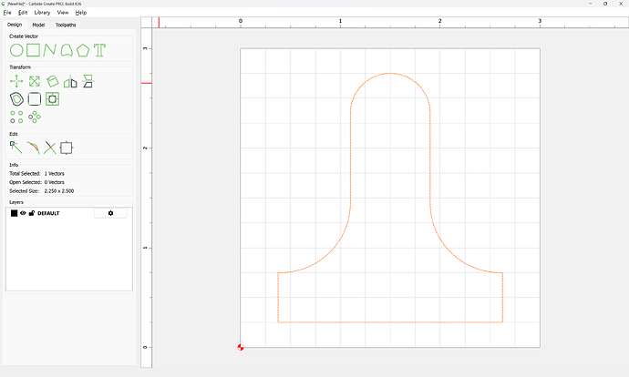

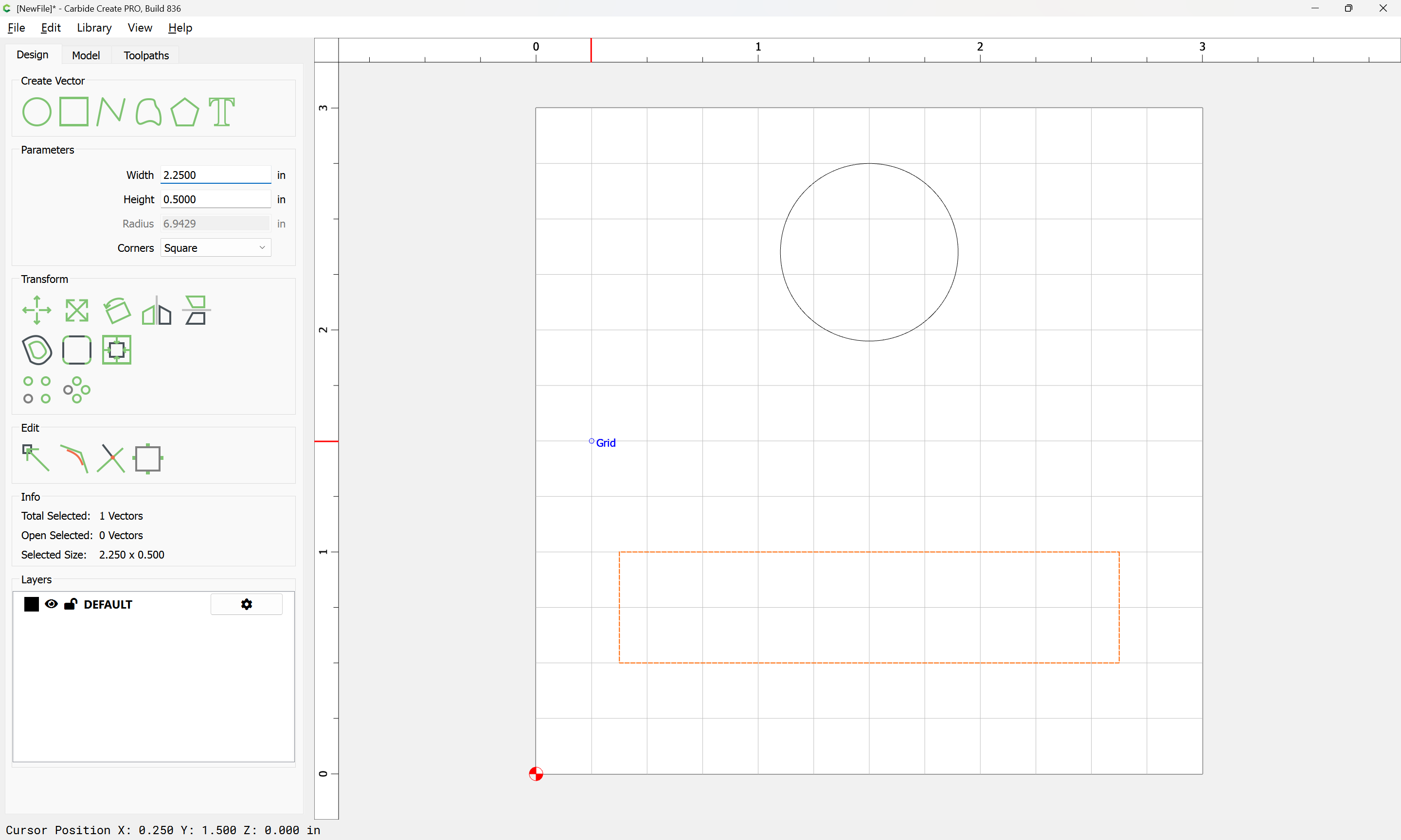

rough dimensions

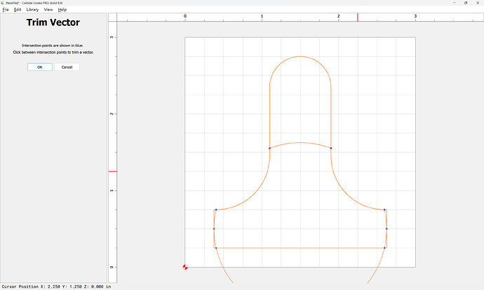

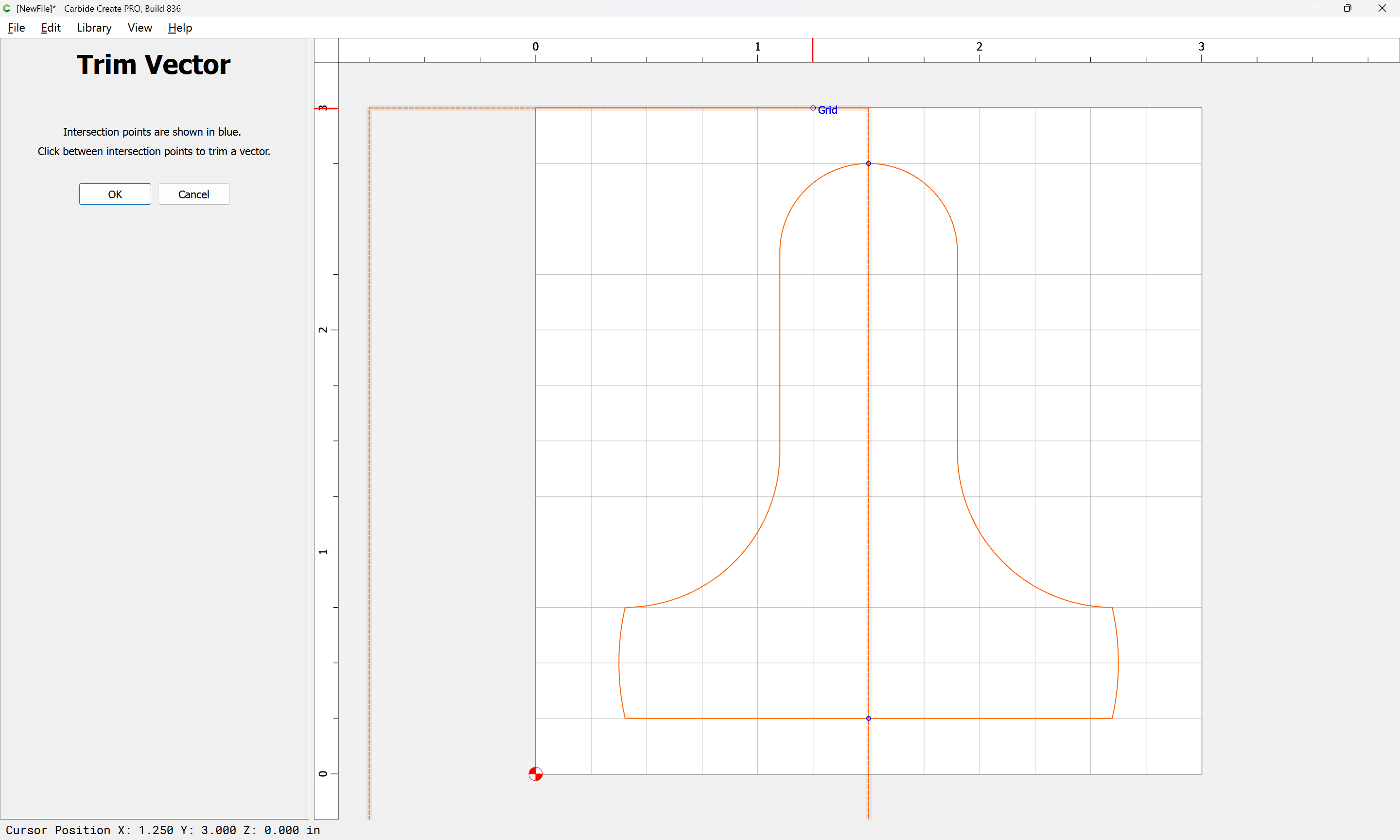

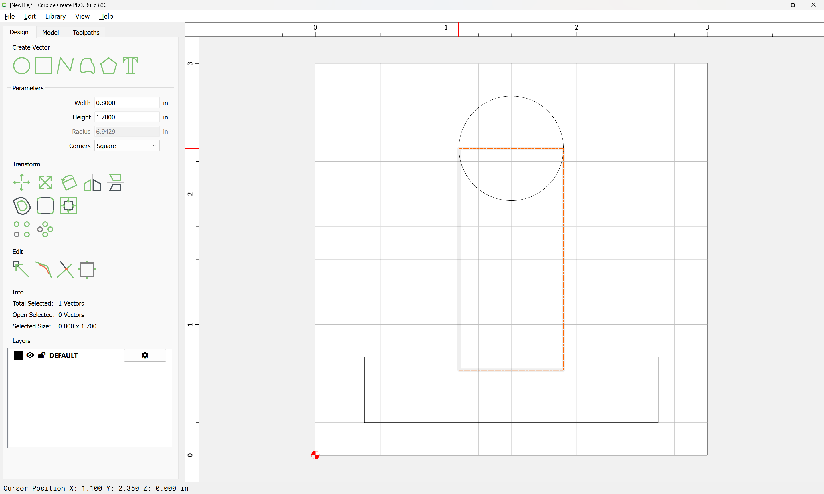

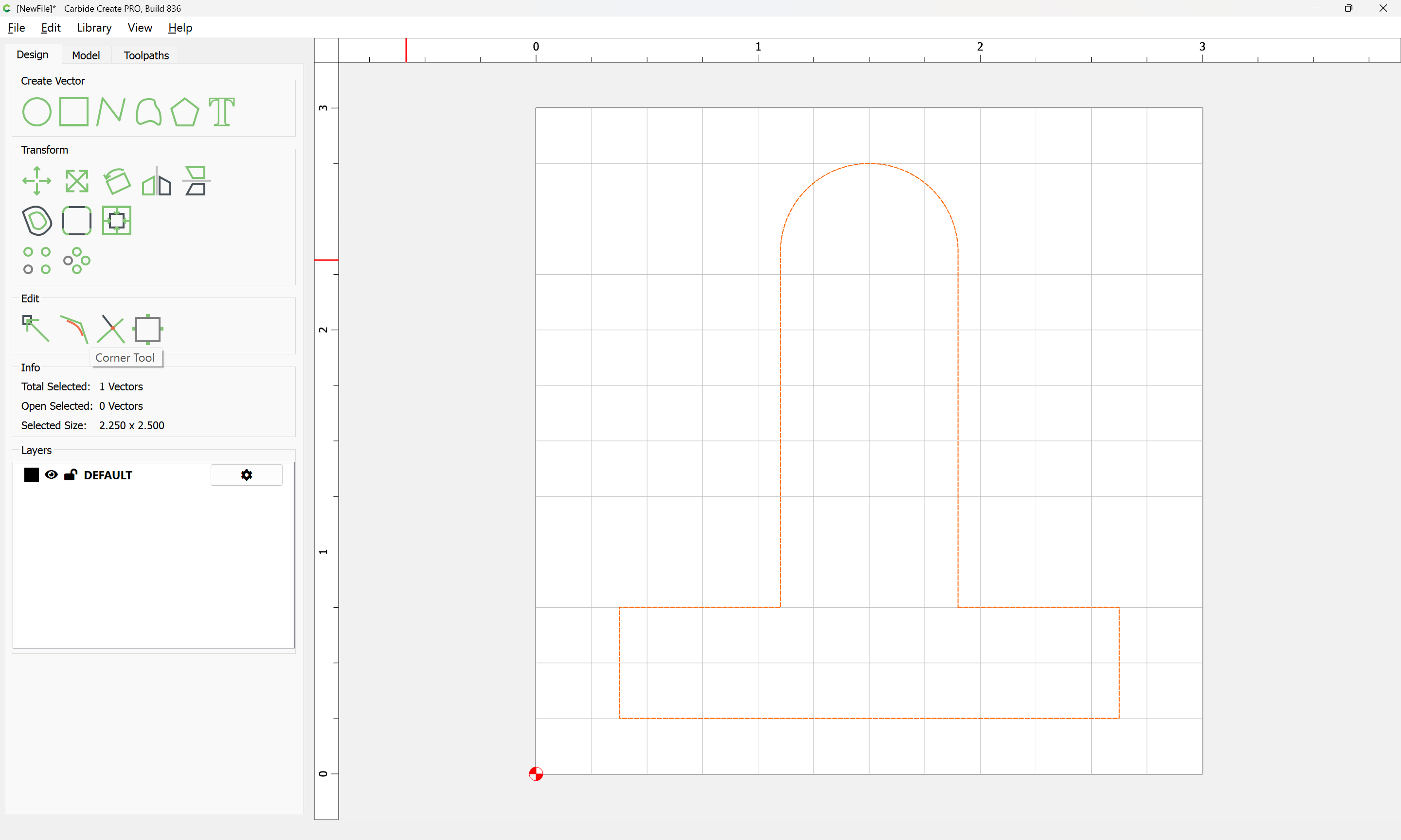

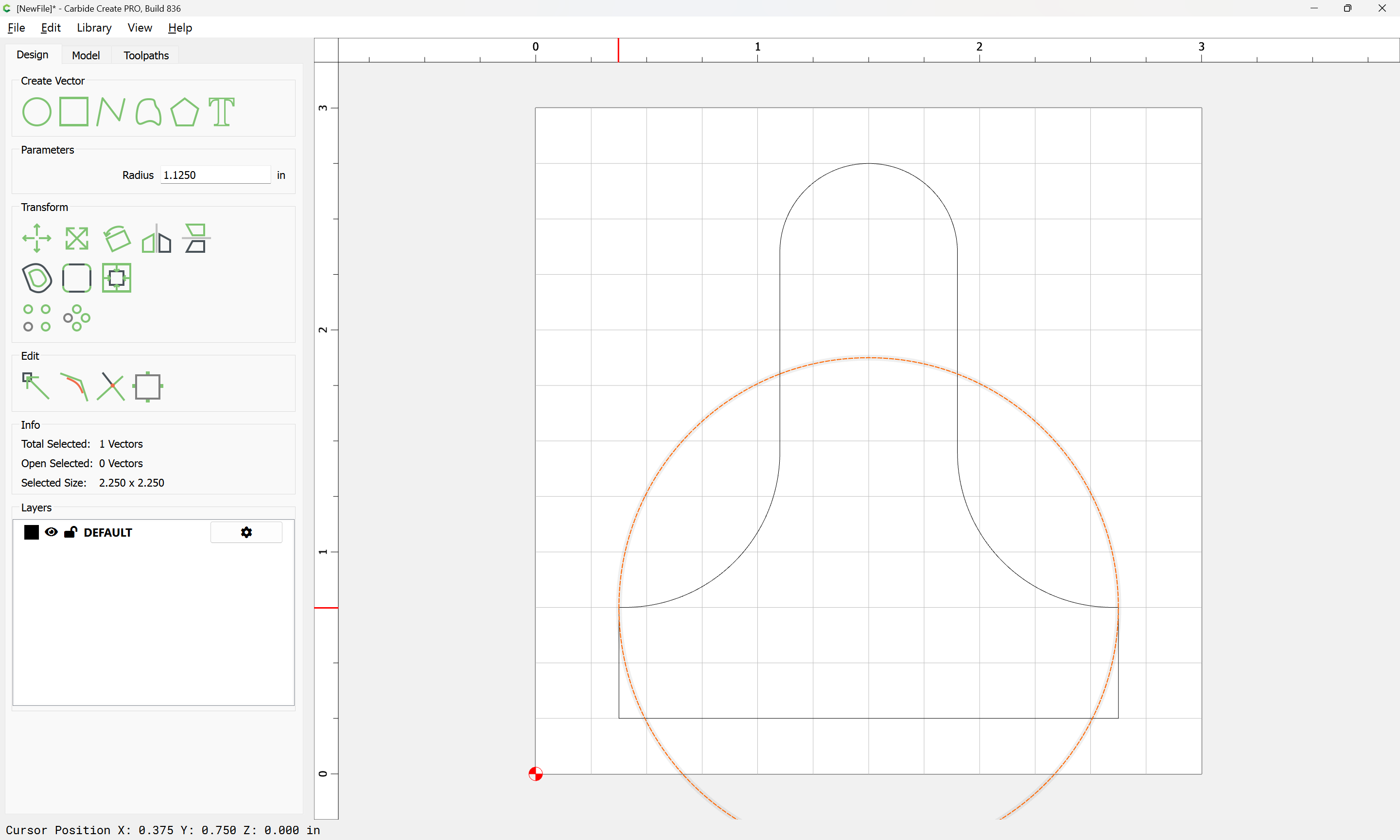

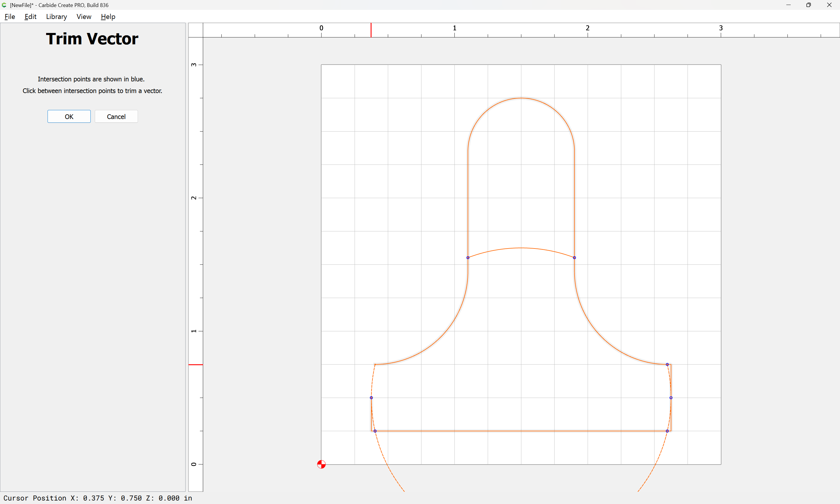

First, draw things up in profile…

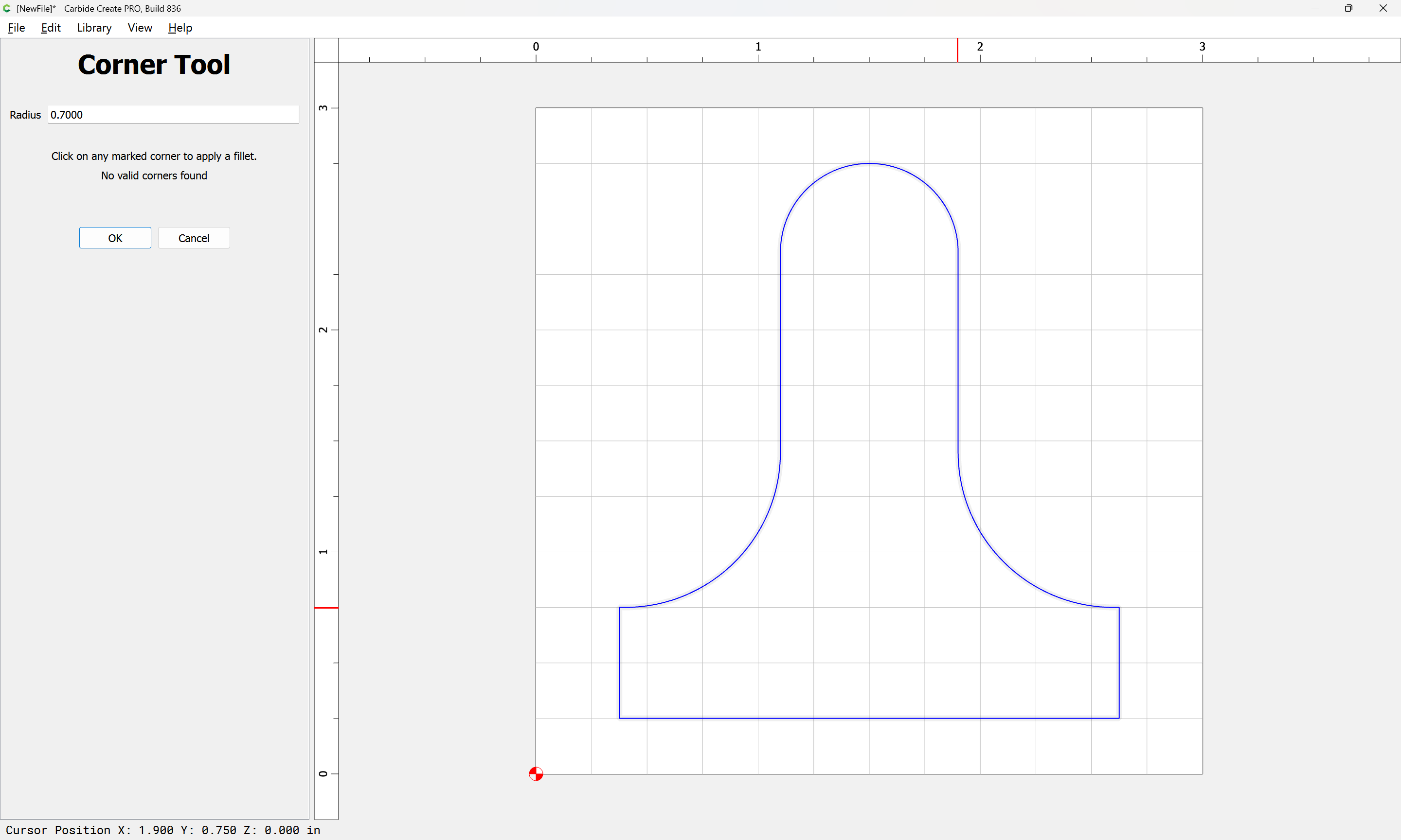

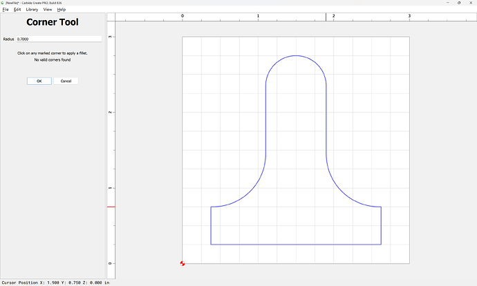

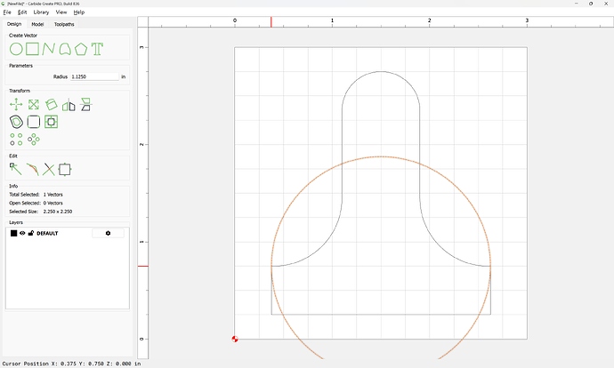

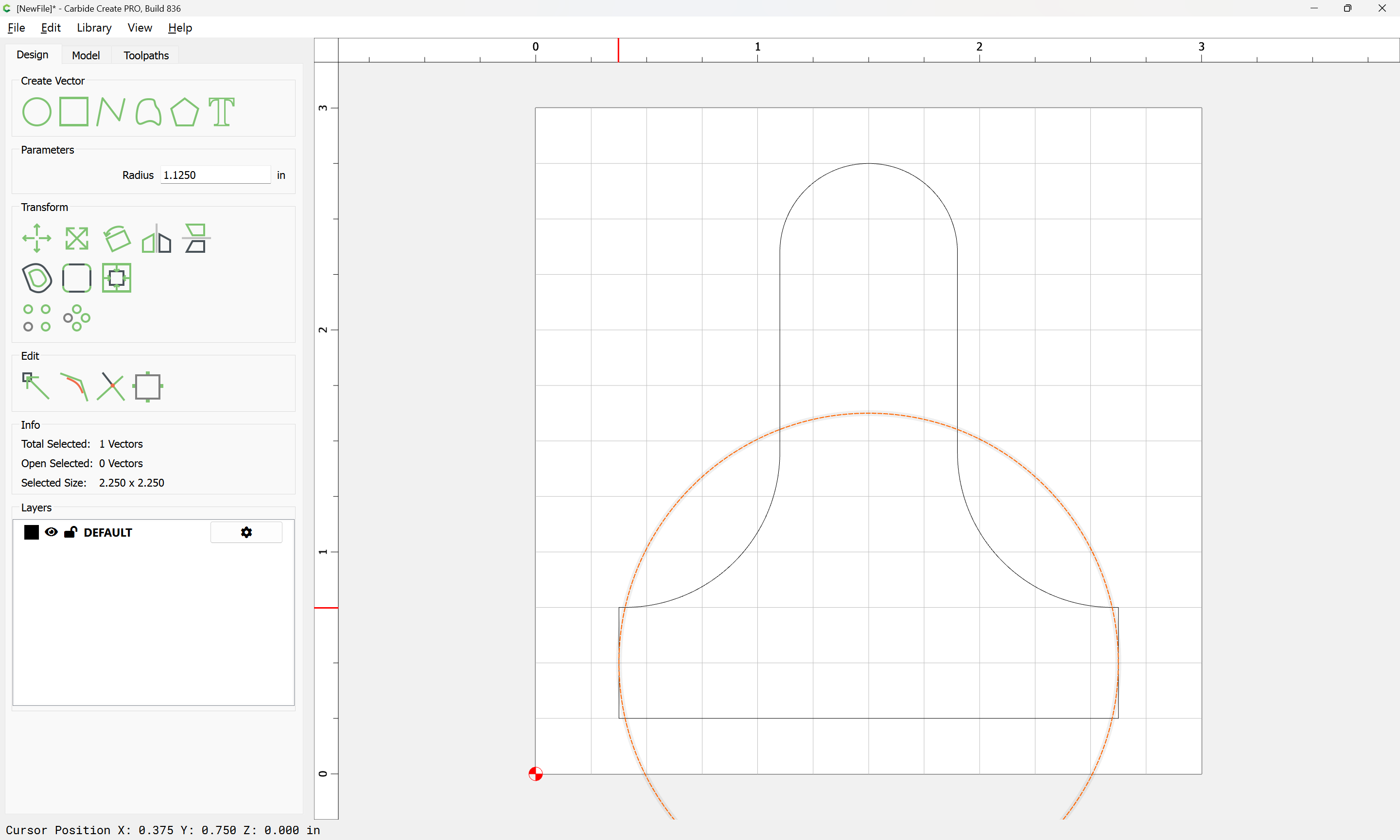

The radius at the bottom looks to be quite large:
OK

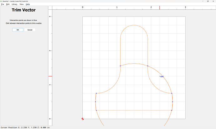

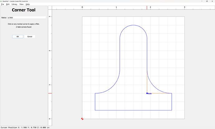

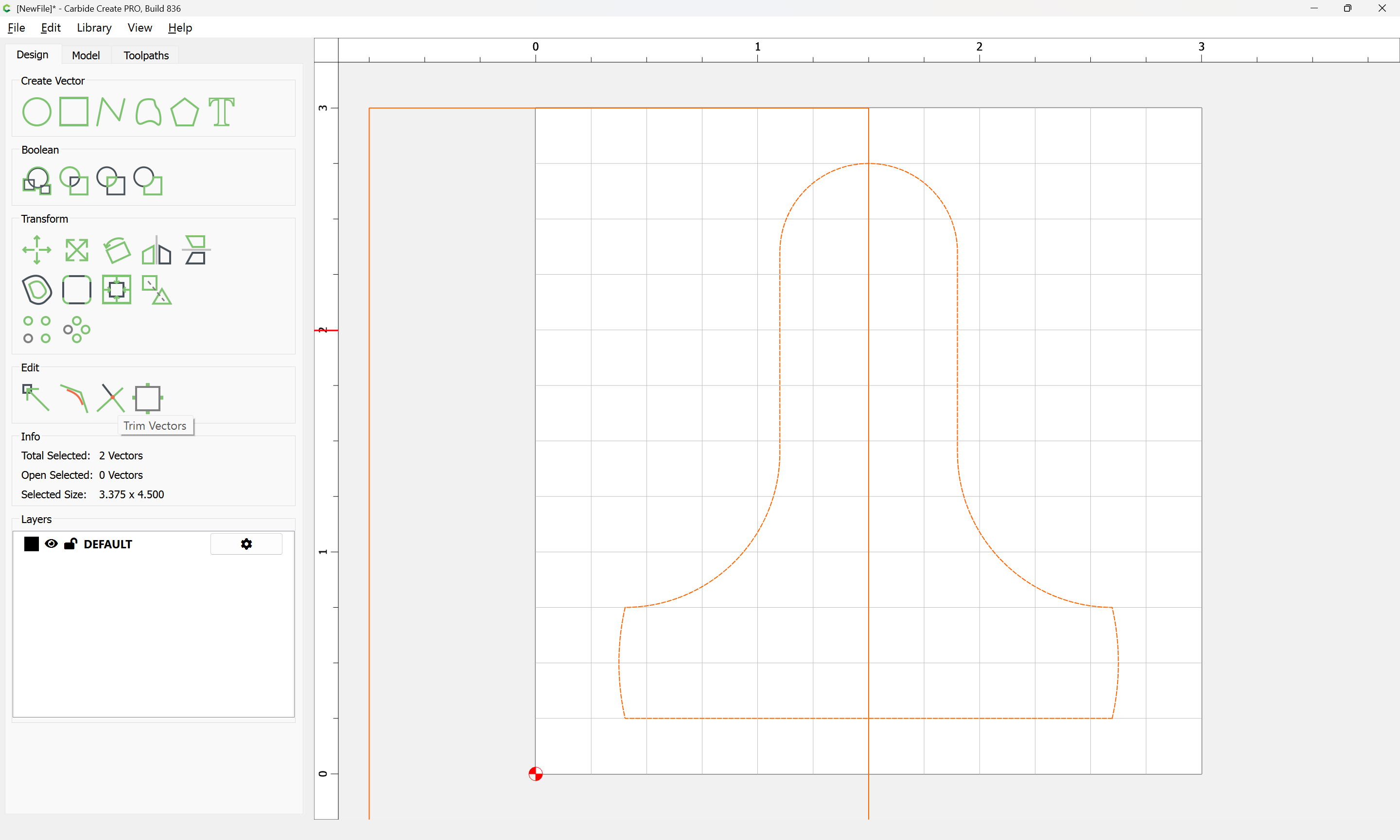

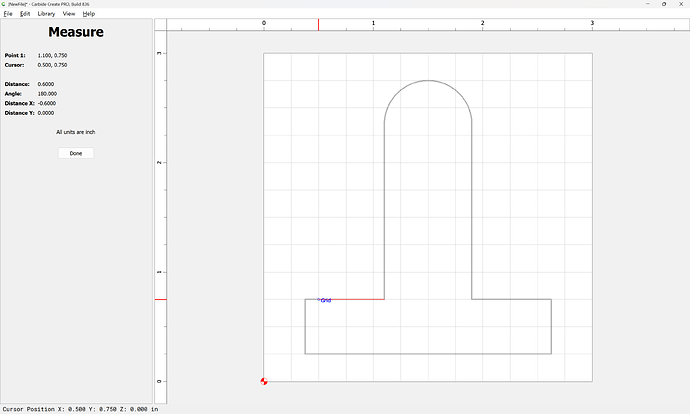

The bottom rounding looks to be a full radius:
nudge it down:

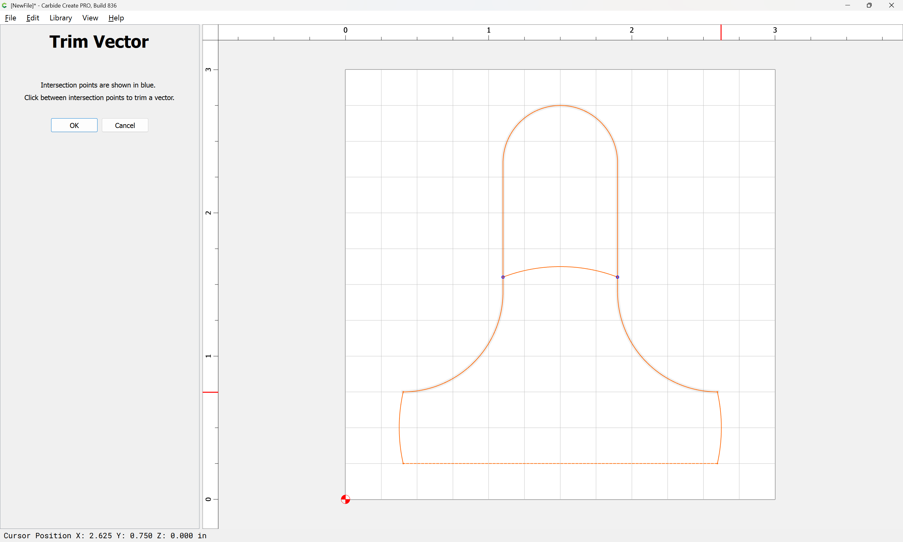

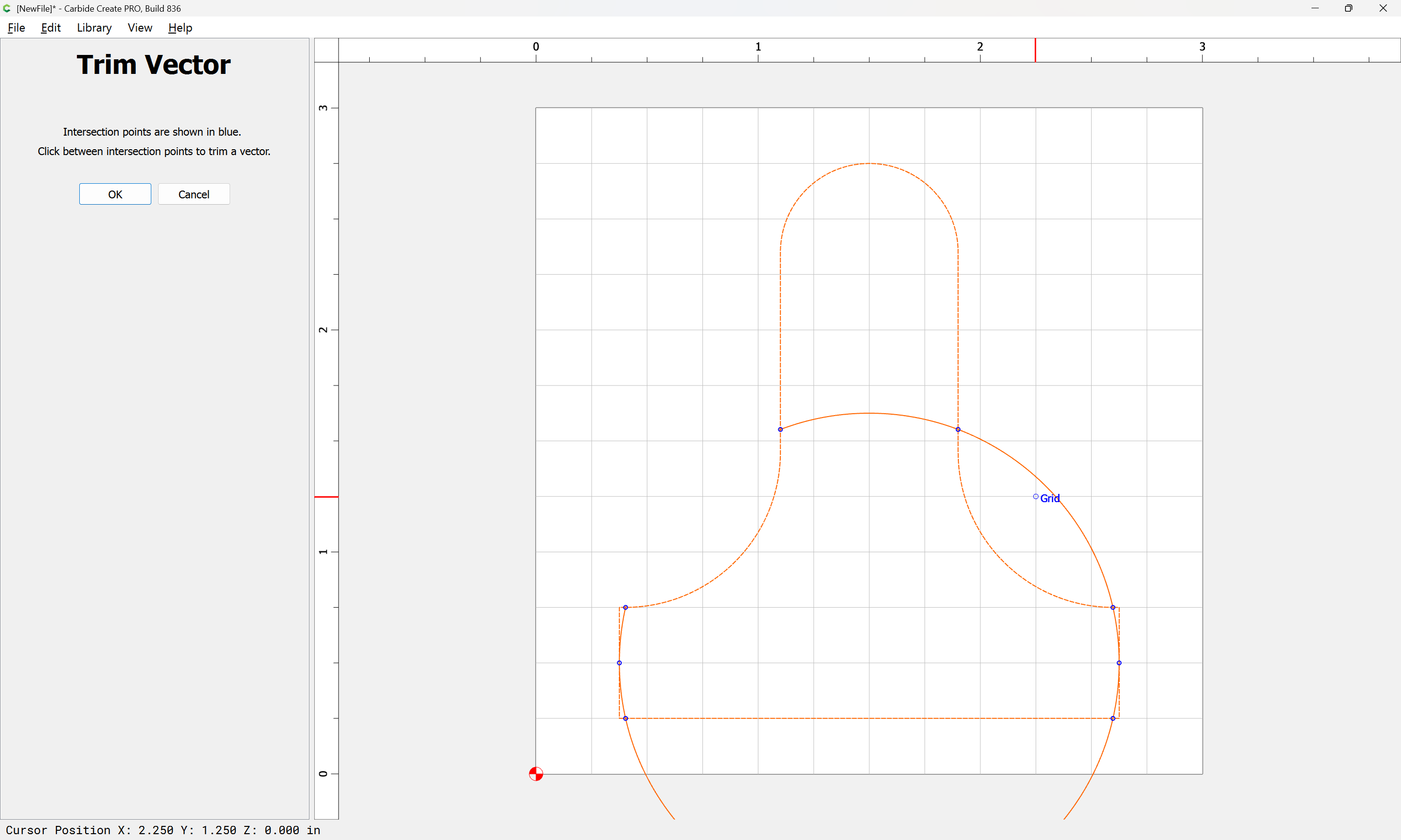

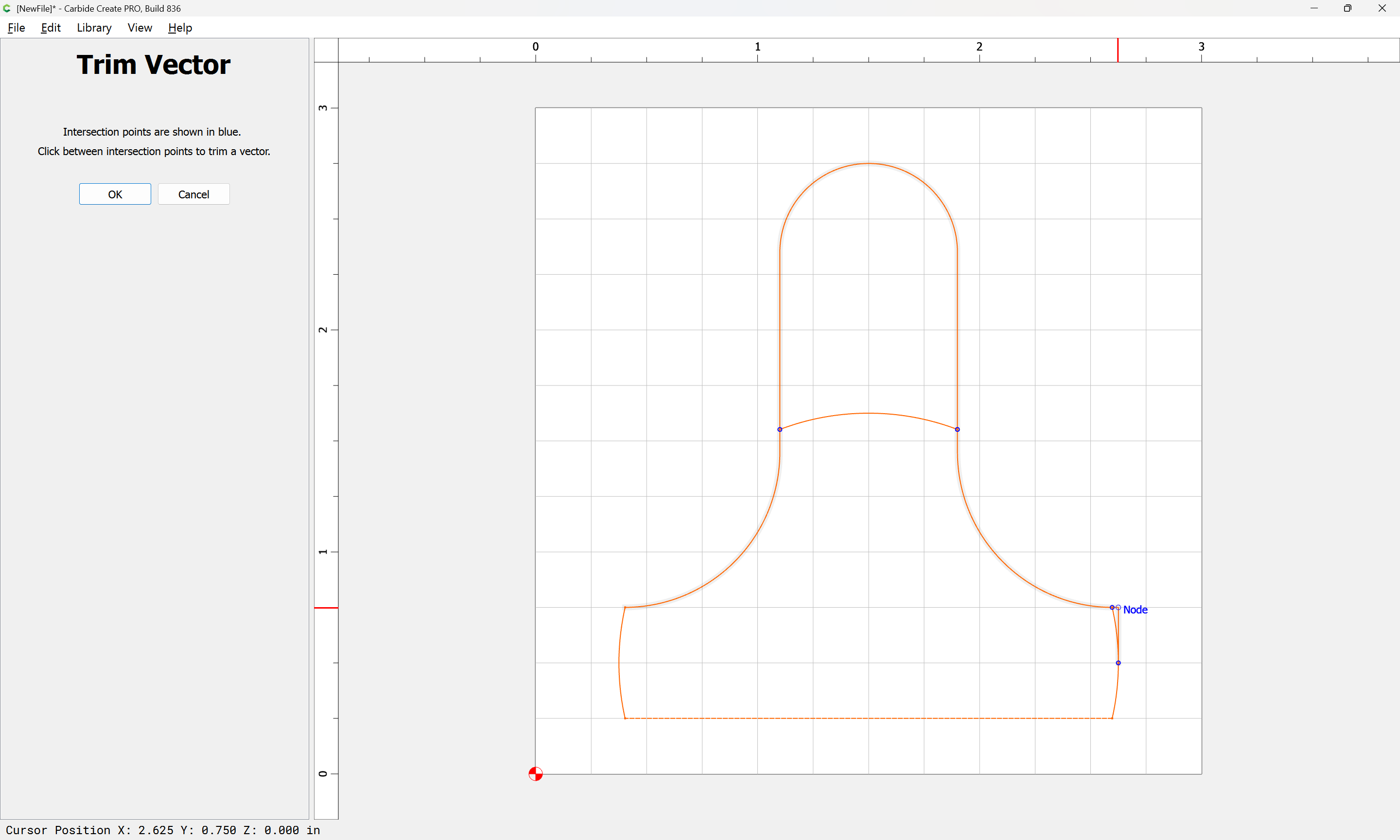

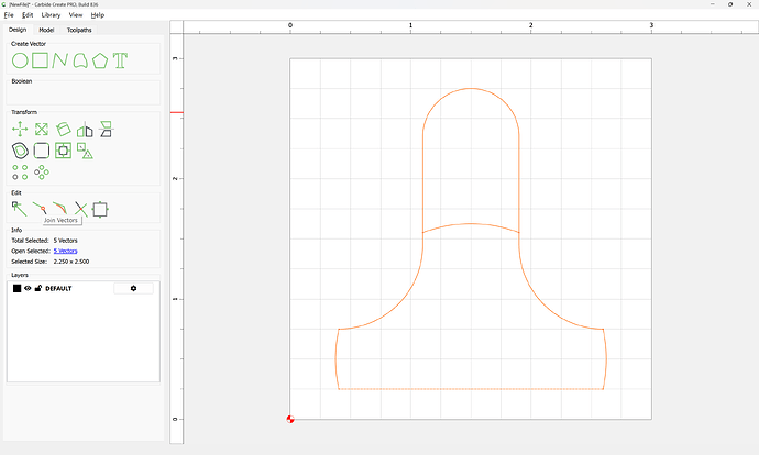

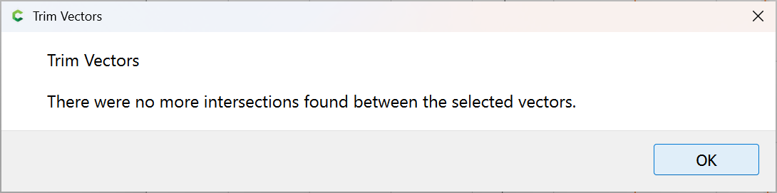

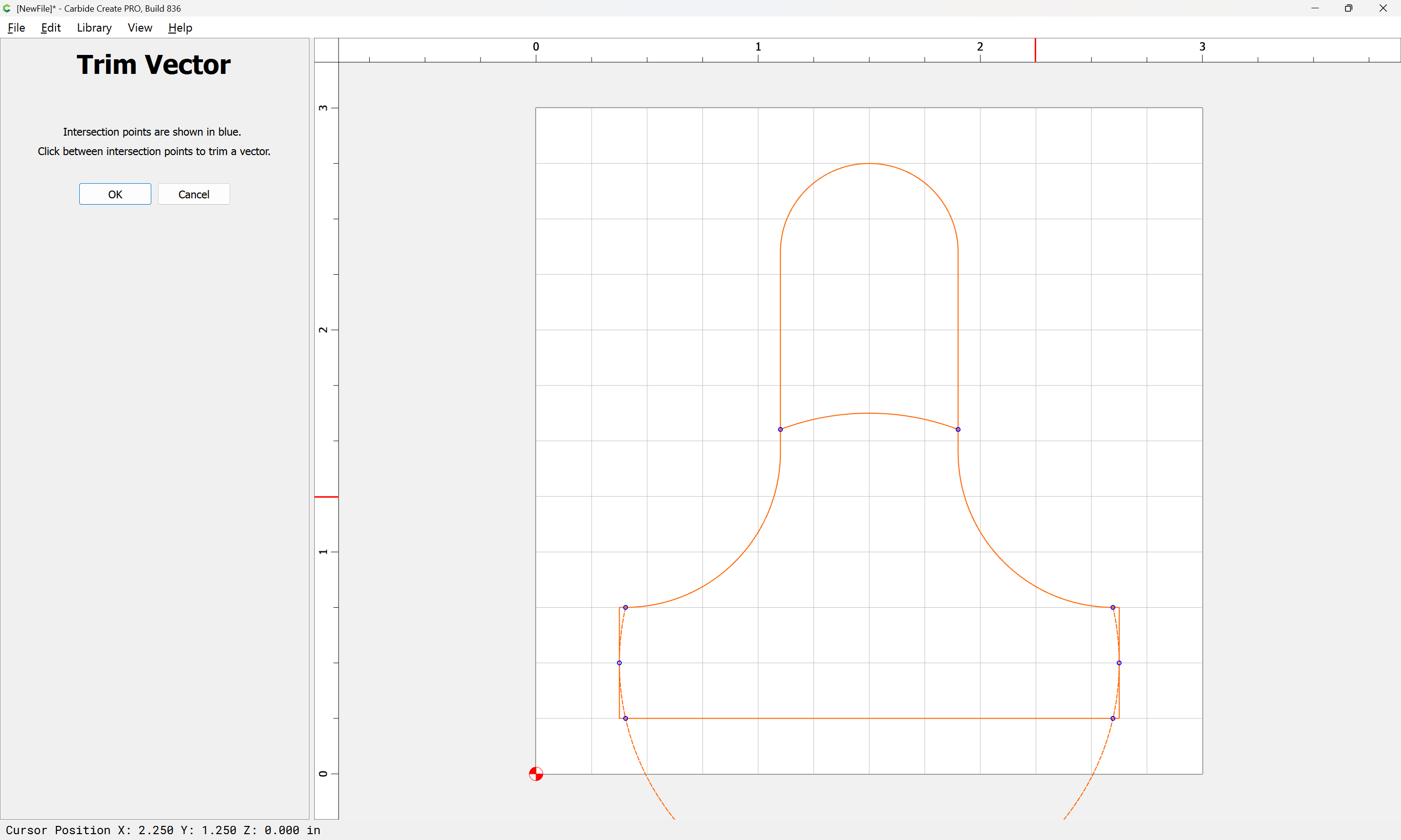

Then use Trim vectors:
OK

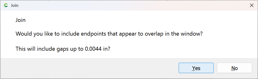

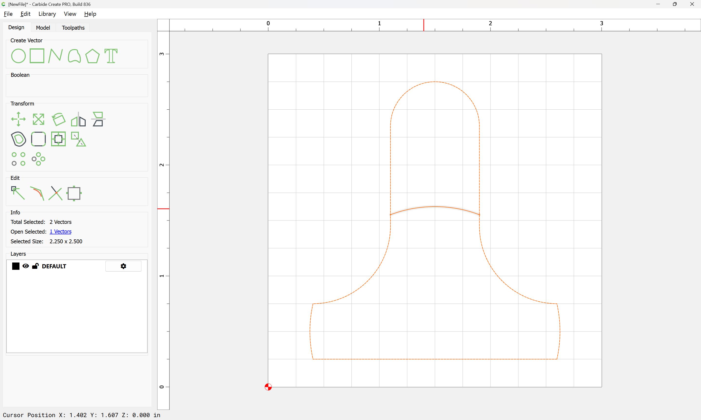

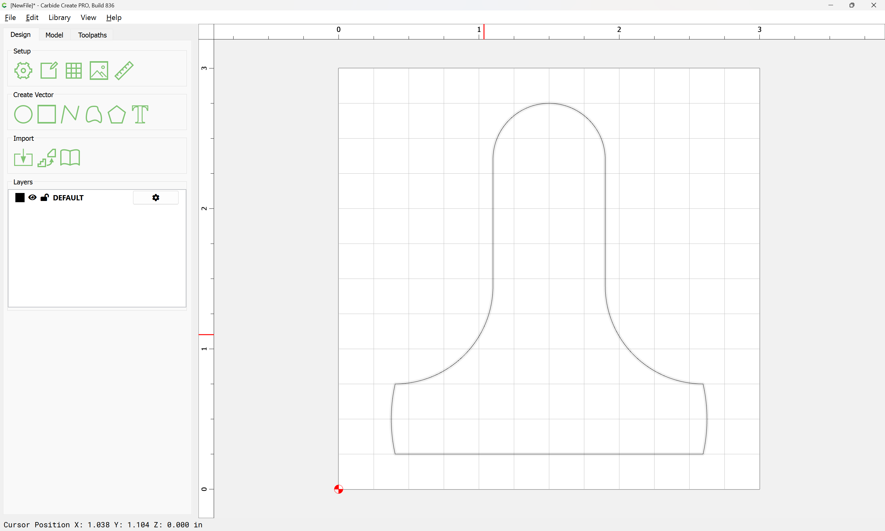

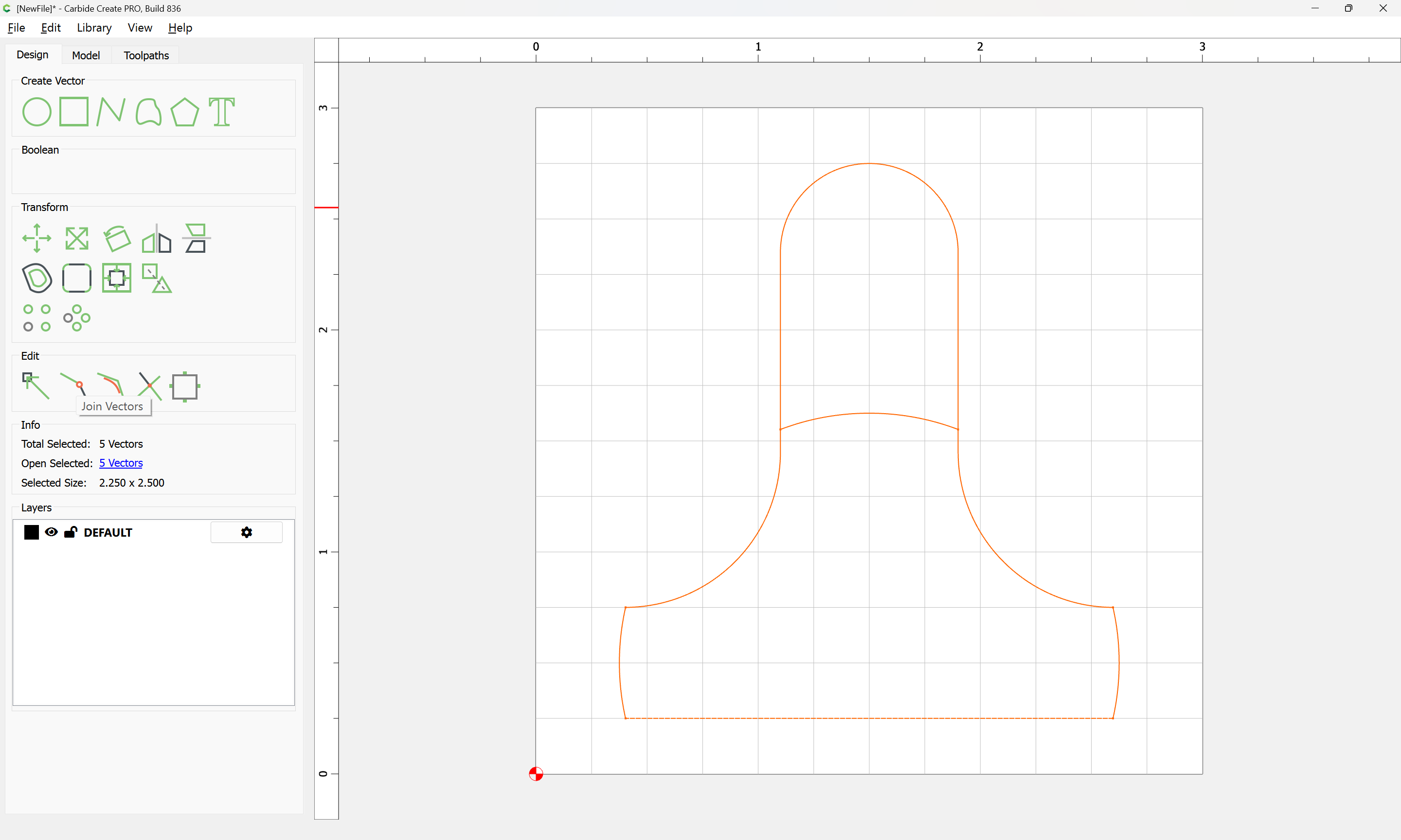

Join Vectors
Yes

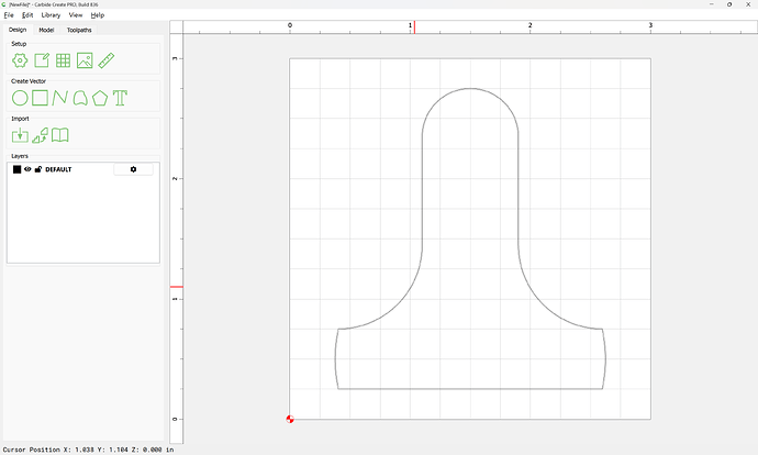

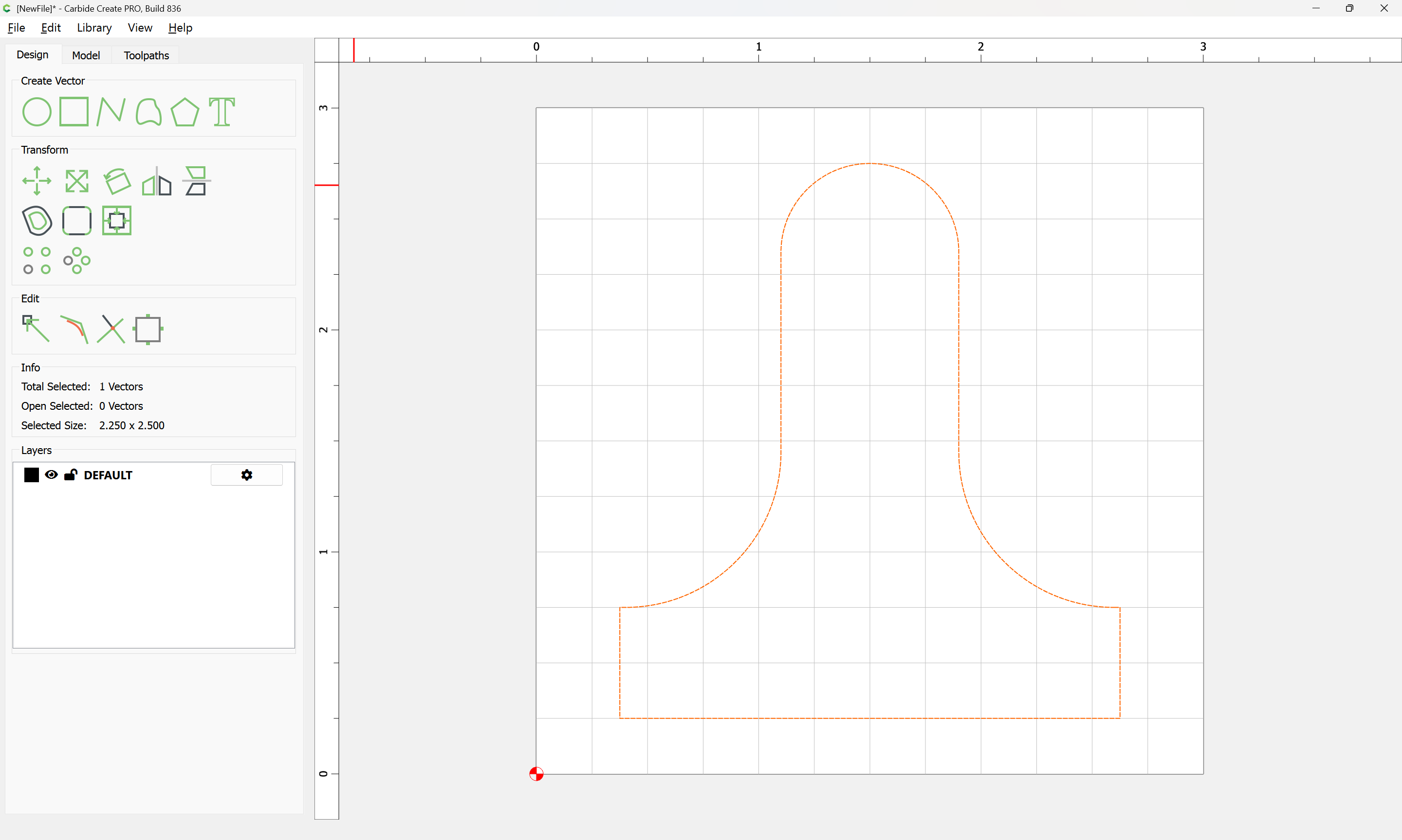

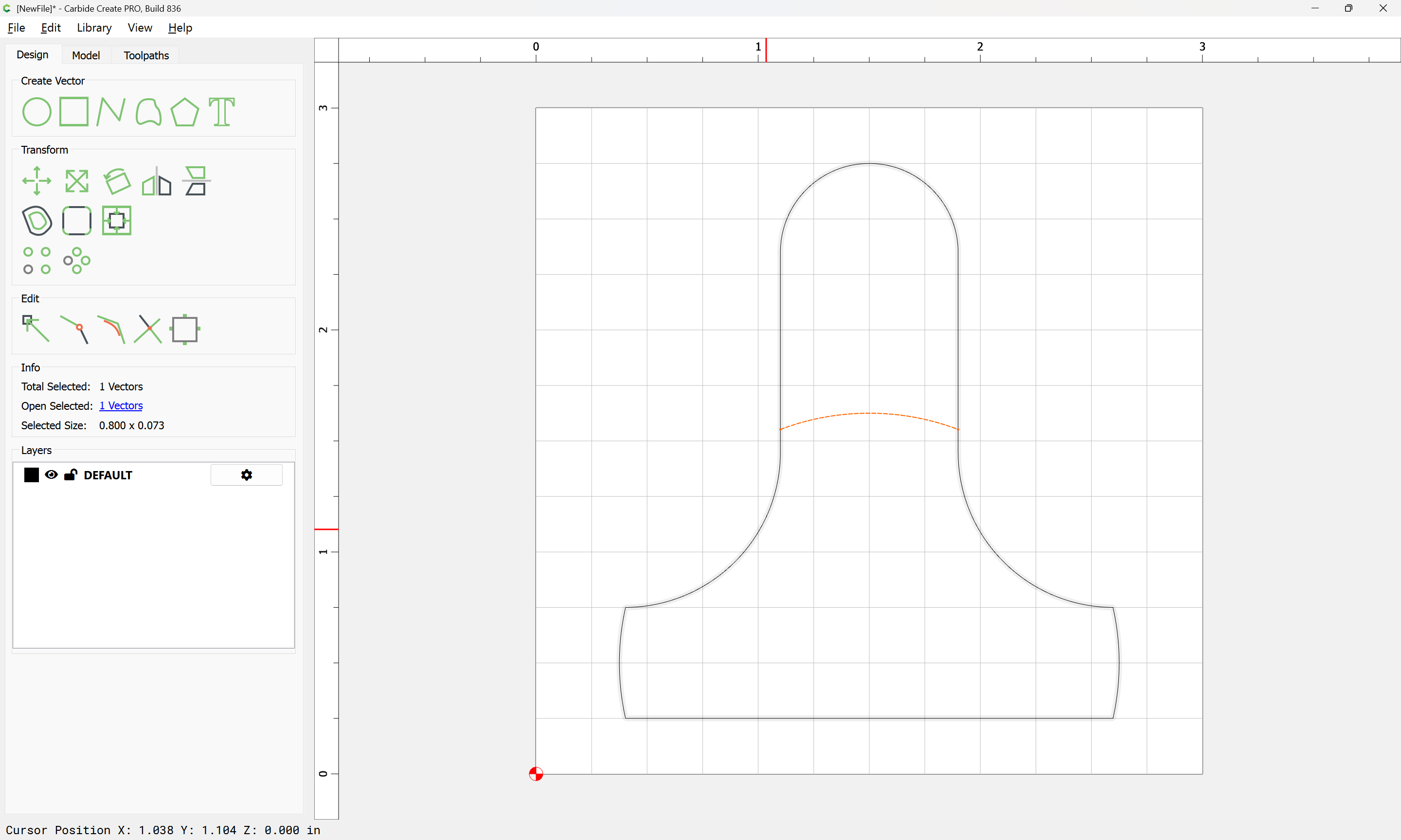

Delete the excess geometry:

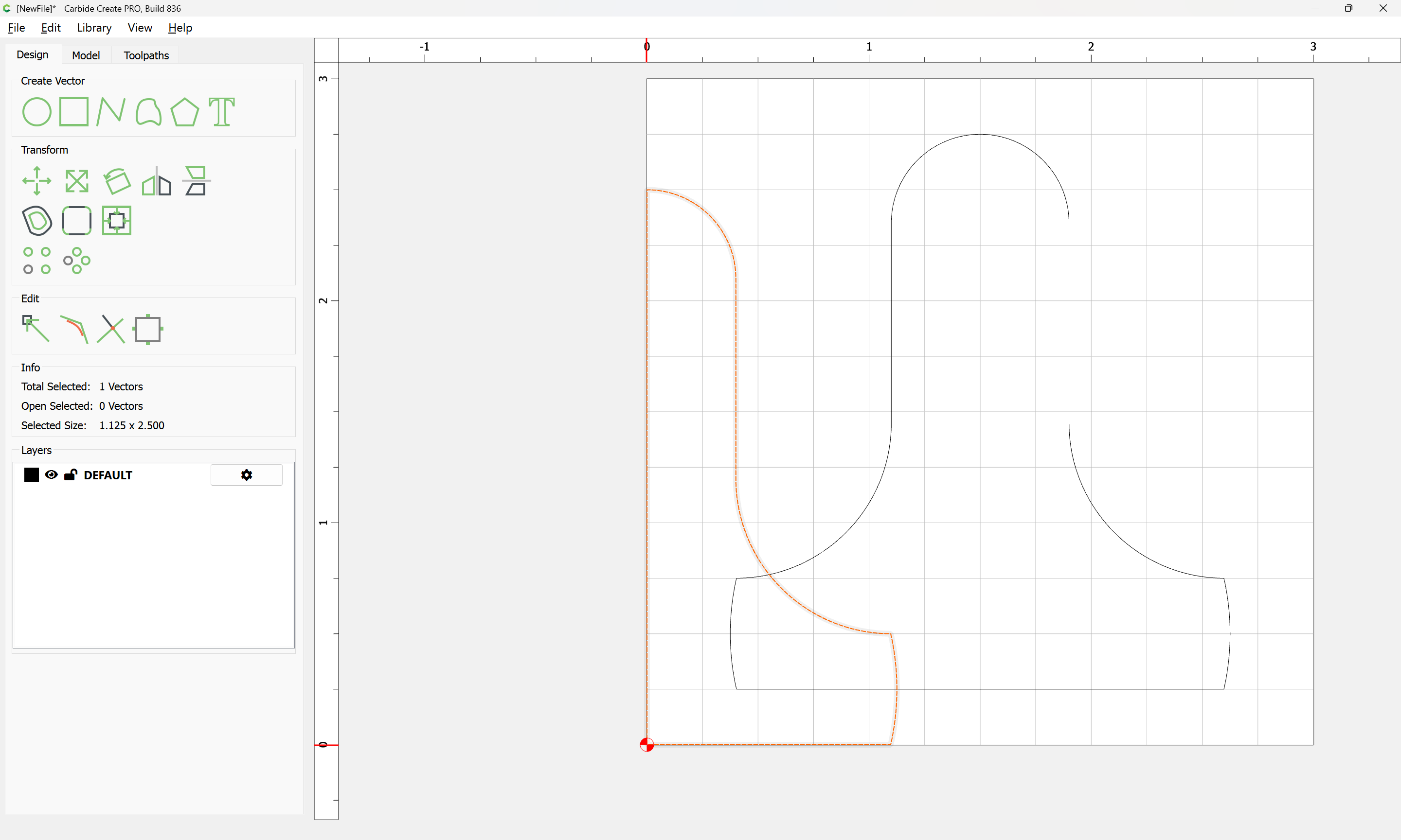

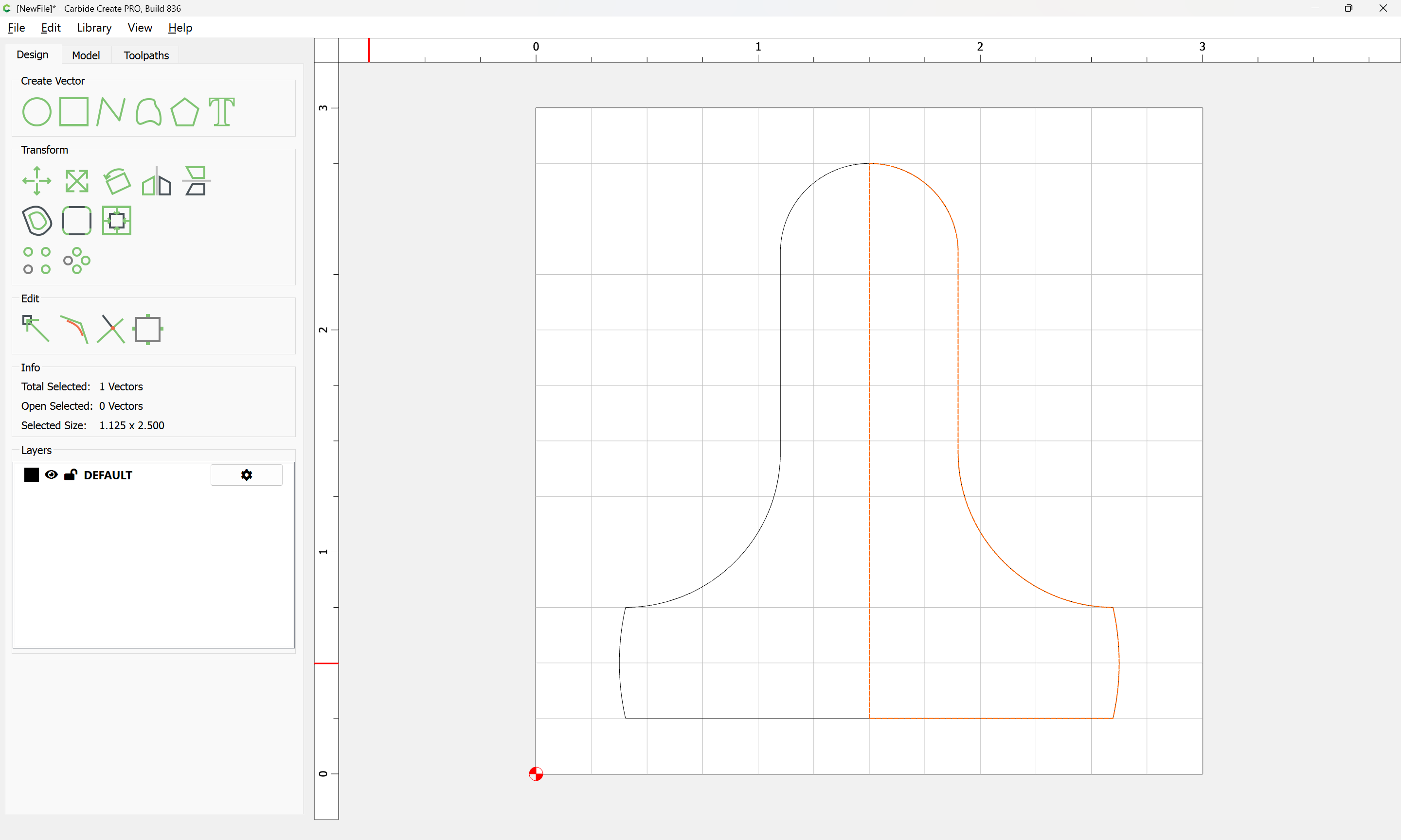

Once one has the profile there are two ways to cut out the design:

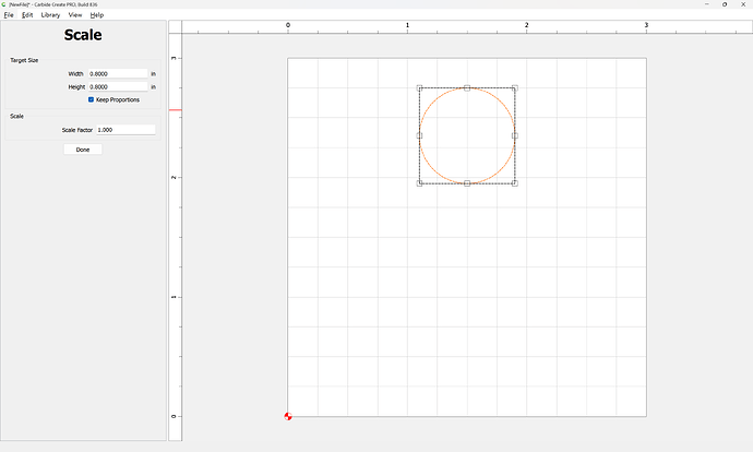

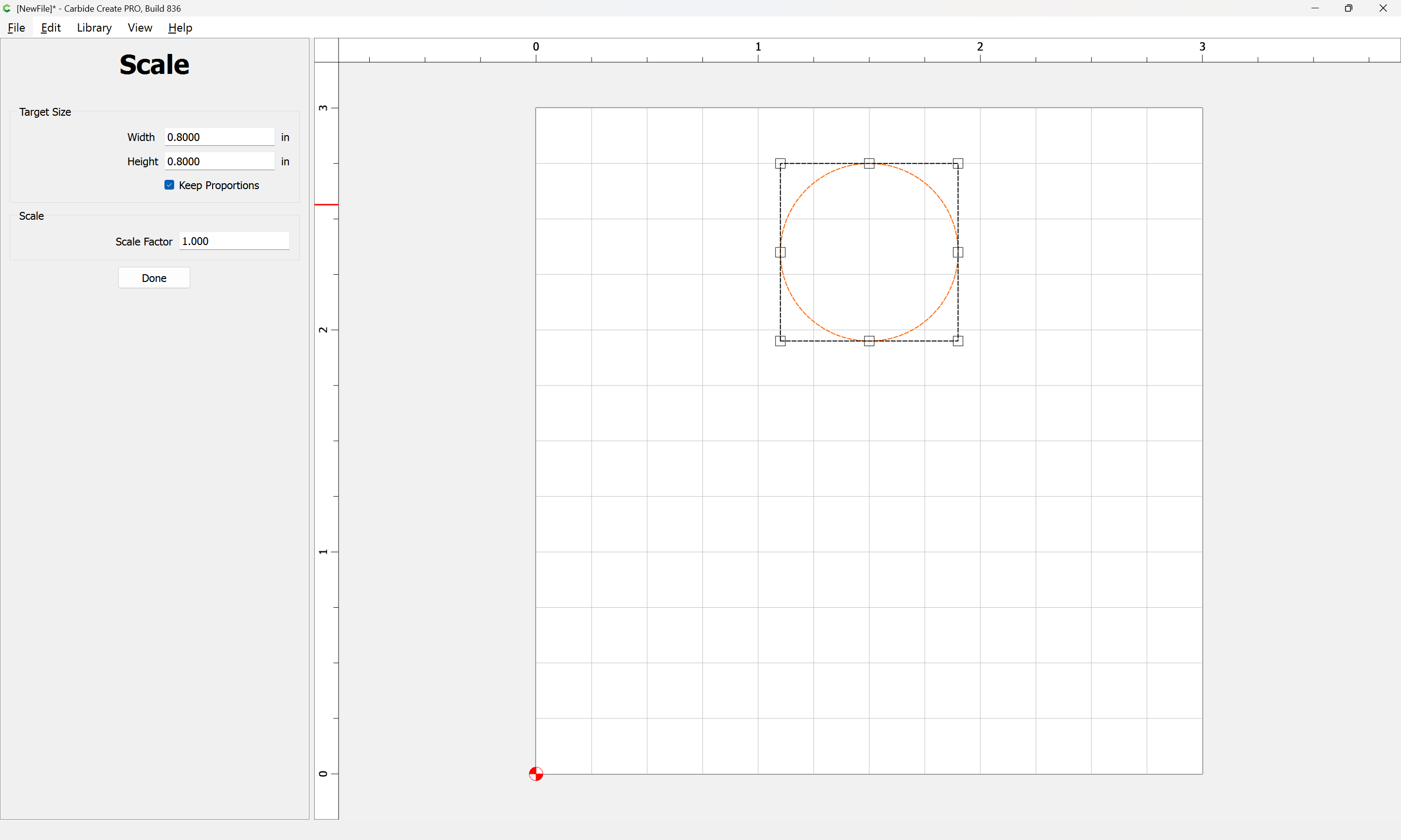

  • draw a profile of the ball-nose tool (note that you will need to source one with a length suited to making the entire cut) and then measure a suitable number of perimeters and assign No Offset Contour toolpaths to circles of the requisite width and at the needed depth — for an example of that approach of modeling see:

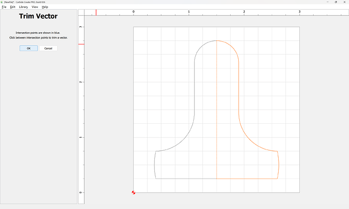

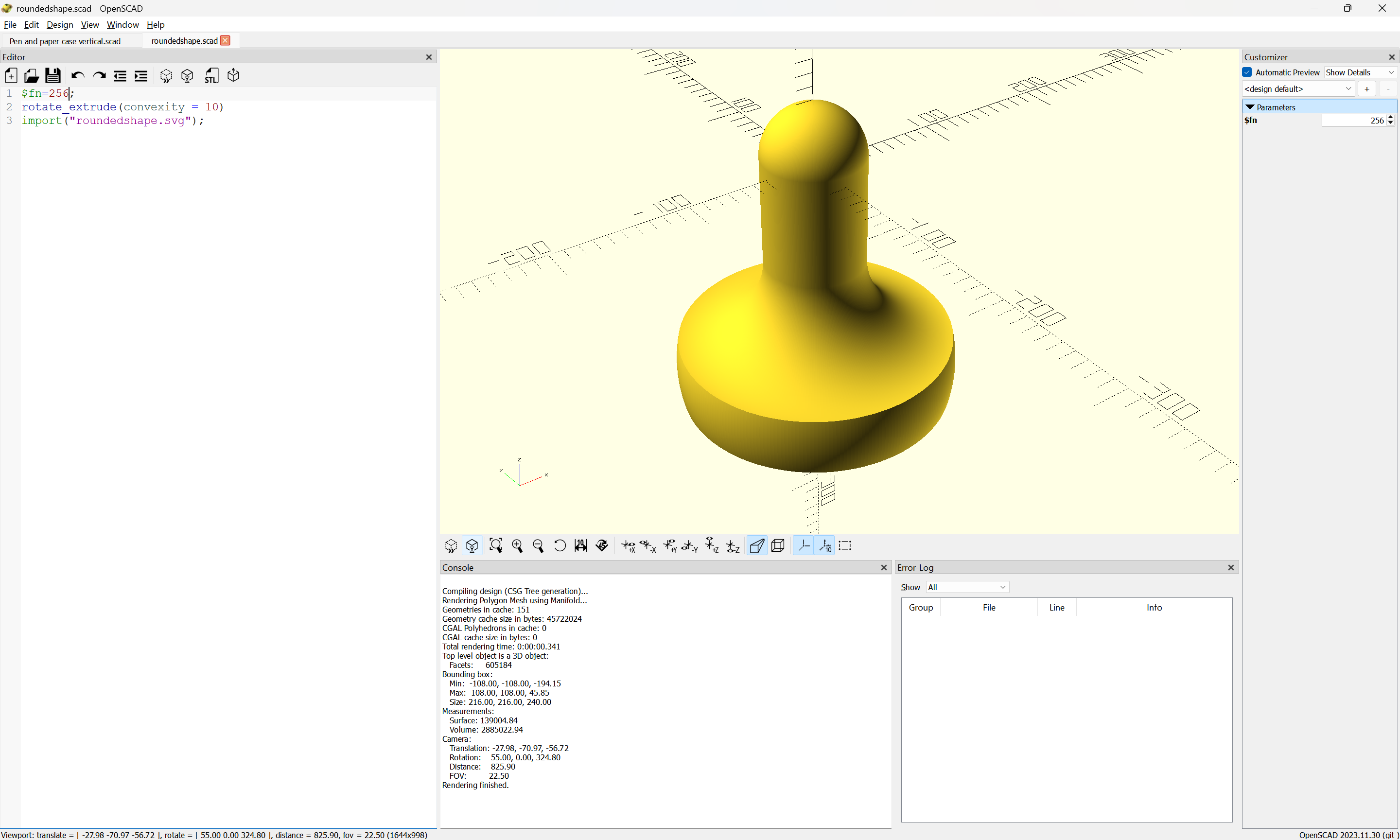

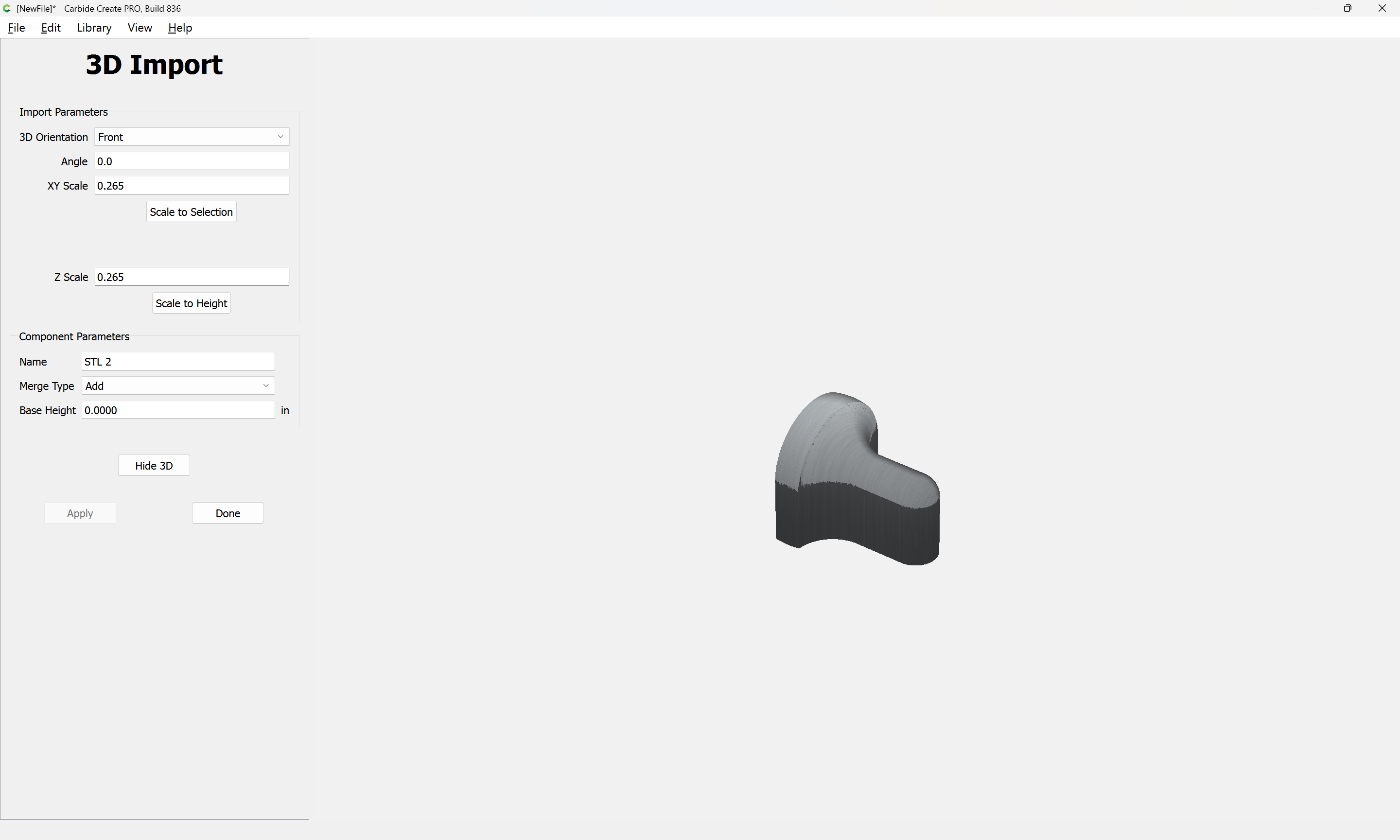

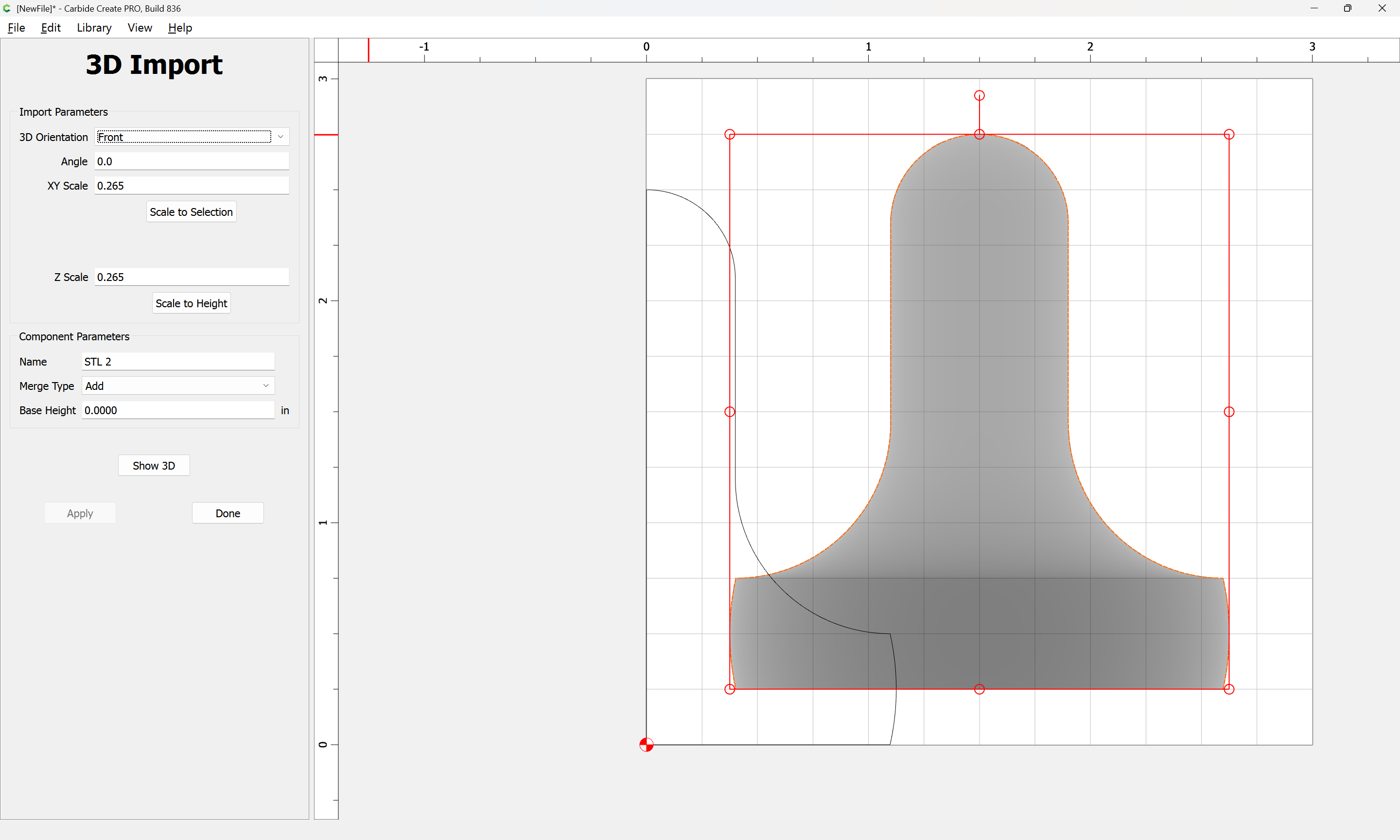

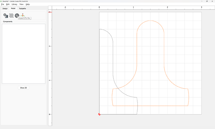

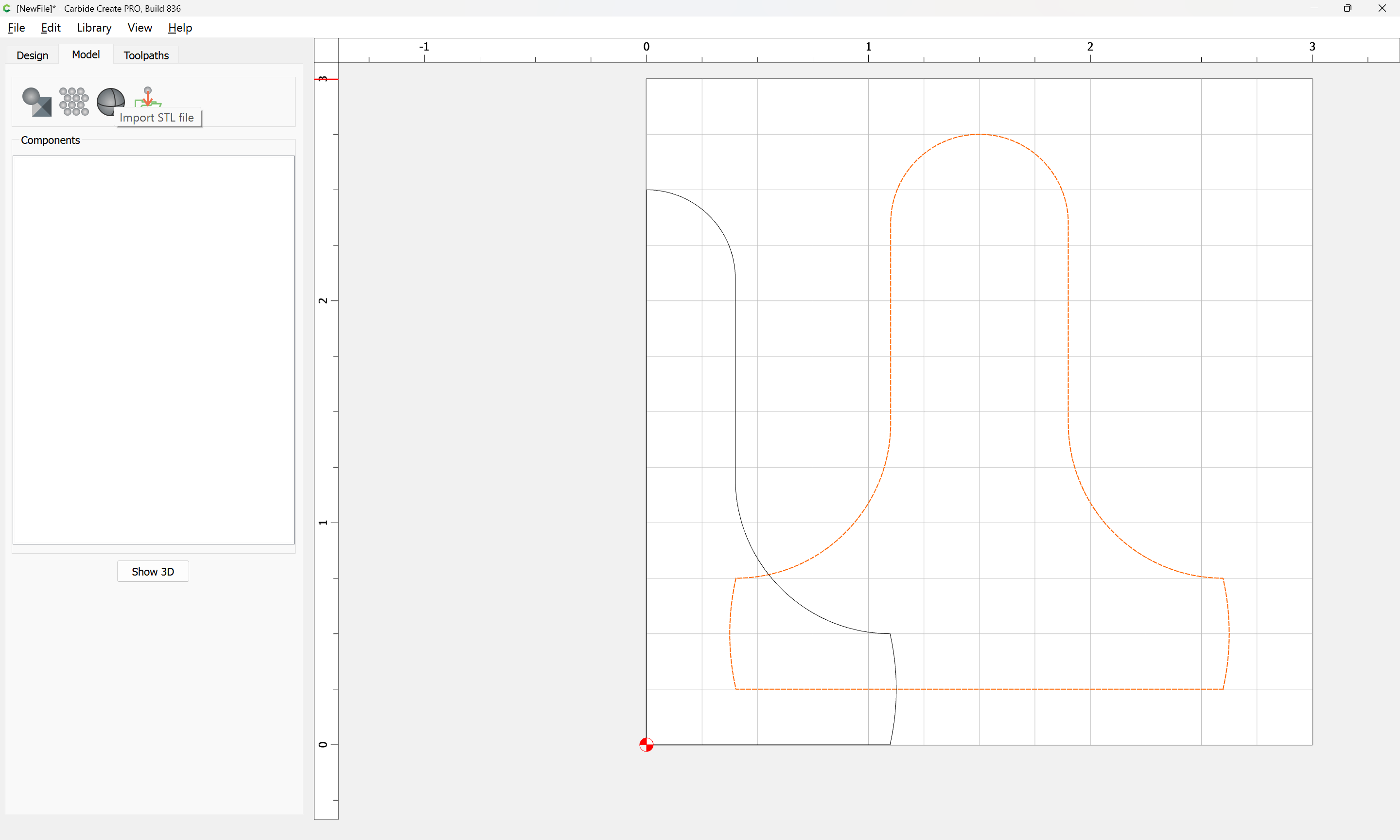

  • export half of the profile as an SVG and rotate it to make a 3D model, then import the 3D model into Carbide Create

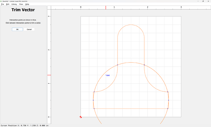

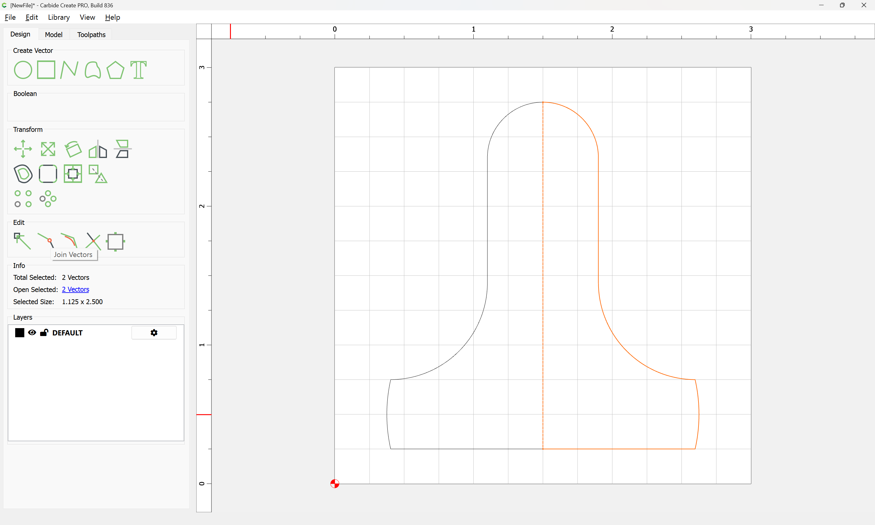

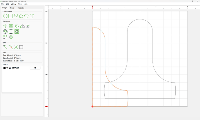

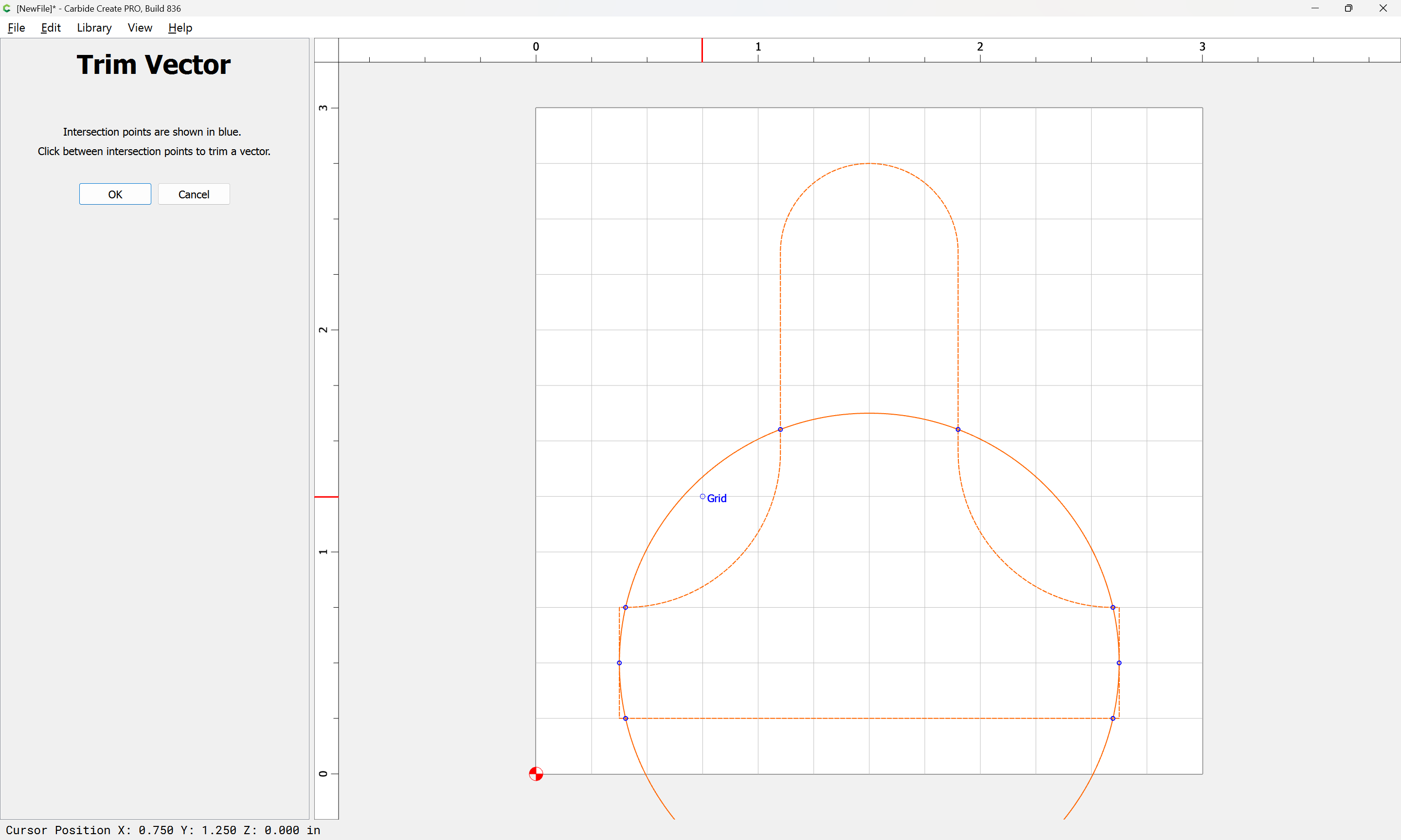

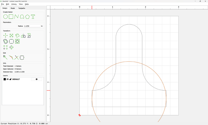

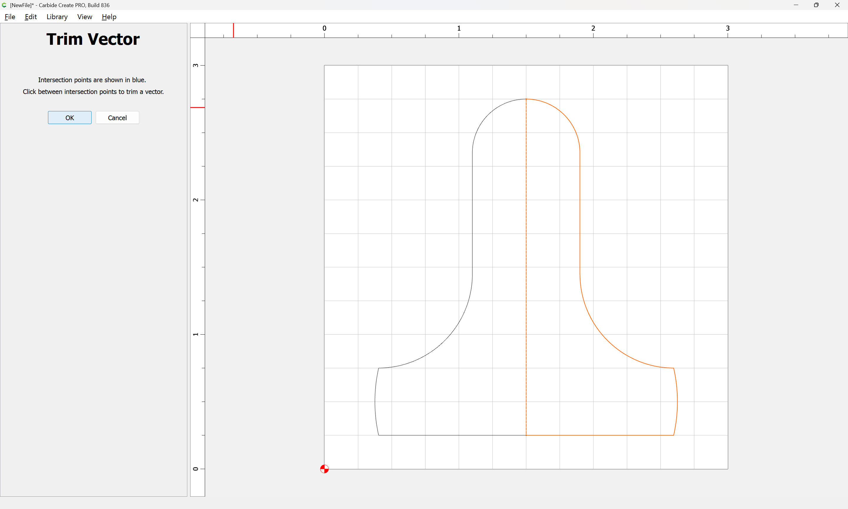

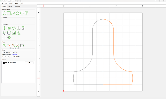

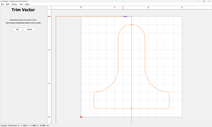

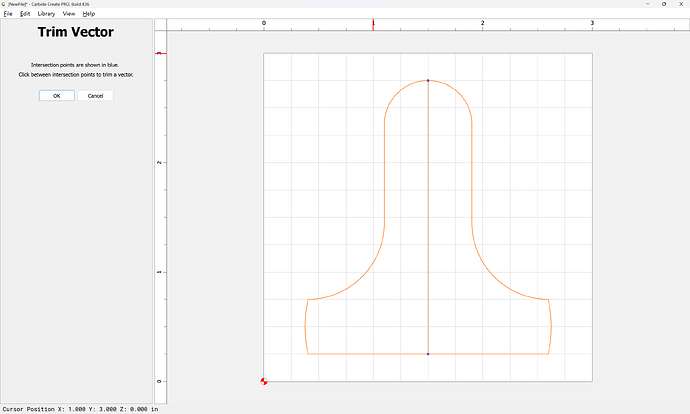

Draw in geometry to define the halving:

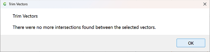

then use Trim Vectors:
OK
Join Vectors
Yes

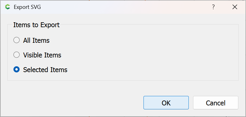

Drag the geometry to the lower-left corner of the stock:
and export it as an SVG.
and rotate that into a 3D model and export as an STL
Here is the v8 file:
For cutting the design it will be necessary to cut at least two sides:
More might be better:

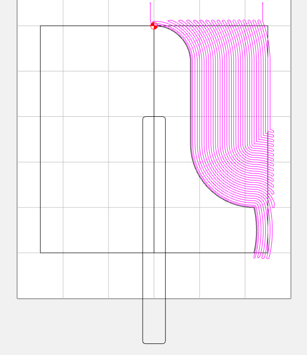

This is a design to cut it like a lathe with a 2.25 x 2.5 cylinder blank.
Insert a 1/4" shank into the blank.
Careful!! Even at the slowest speed (Mine is 8000 RPM) it will need to be very close to balanced to start with. I would bore the 1/4" hole (slightly undersized for a press fit) on the machine.

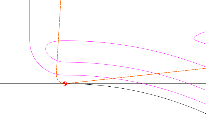

This one is for a lathe tool with a 0.010" nose radius.
You would post the program then replace all the Y moves with Z, and edit any of the Z moves accordingly.
Yeah, sometimes a lathe is the right answer.
Im certain I could turn this faster on the lathe than set this up on my cnc. But, not everyone has one or chooses to simply complete on the cnc.
I was talking about cutting it on my HDM, but setting it up like a lathe.
Chuck the part using a 1/4" shaft in the spindle
Use a vise to hold a turning tool
