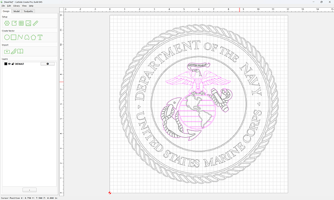

Can you walk me through the steps to do the emblem on a 12"X12"CC1.76" board
This was covered at:
I believe the file in question is:
https://elements.carbide3d.com/category/us_armed_forces/usmc-seal.svg/
Download it.

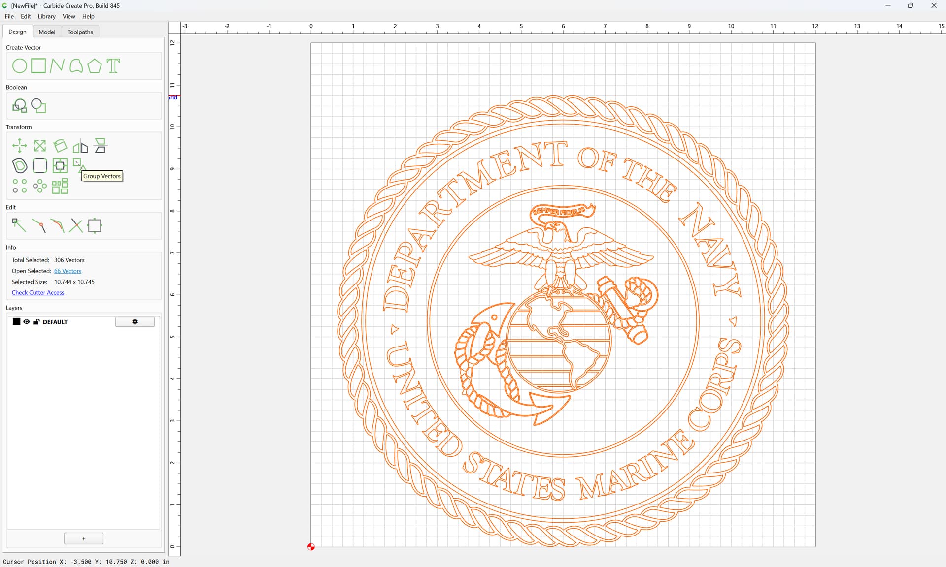

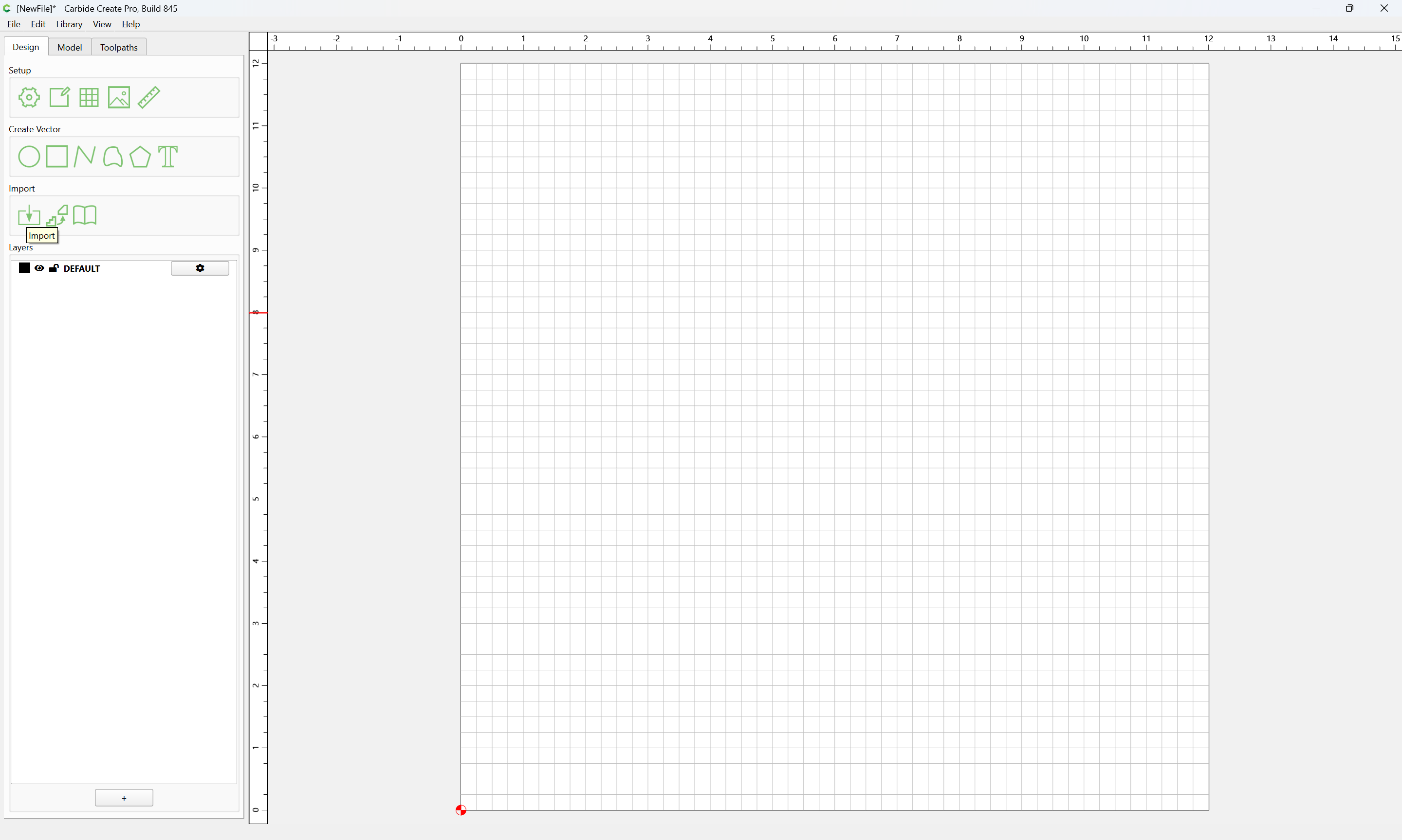

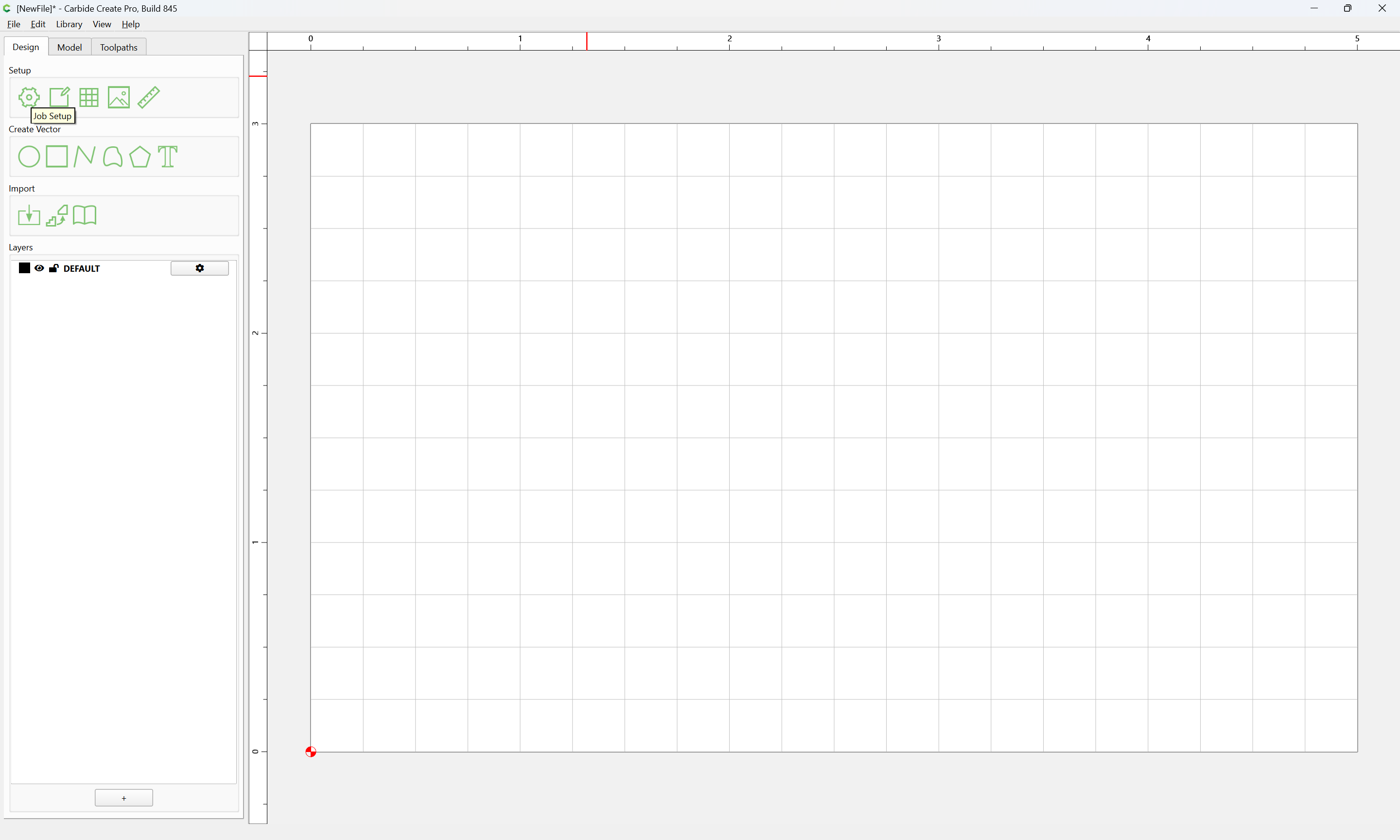

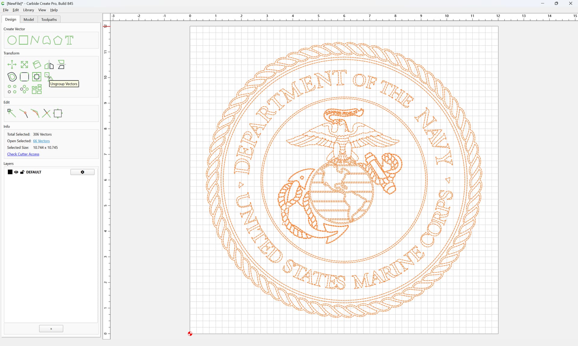

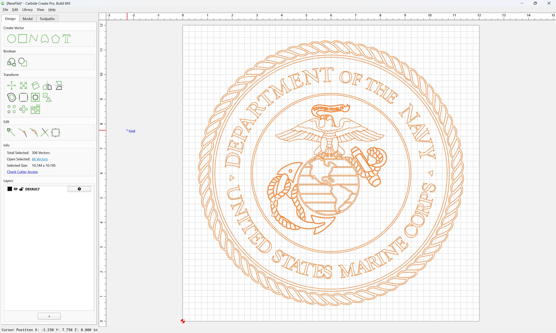

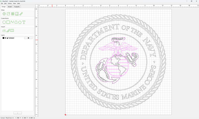

Launch Carbide Create:

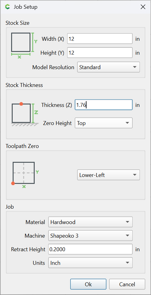

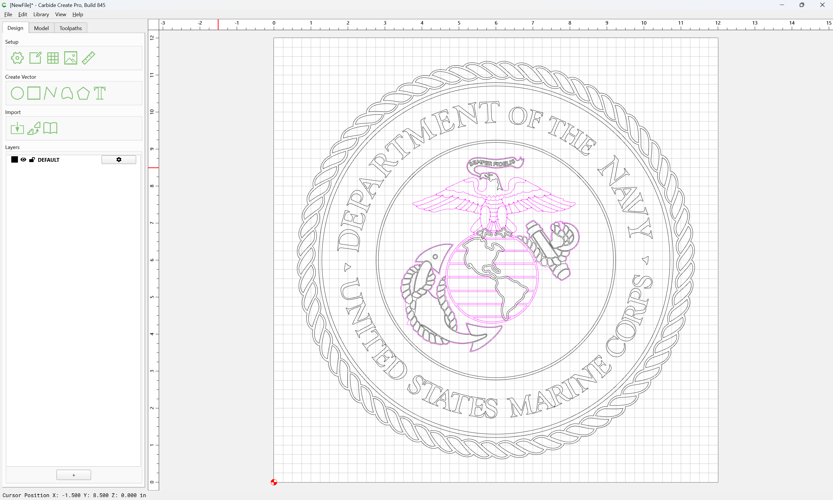

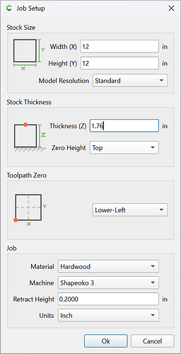

Job Setup:
enter the desired dimensions, Ok

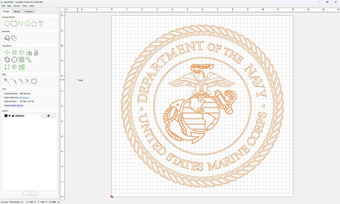

Import
OK

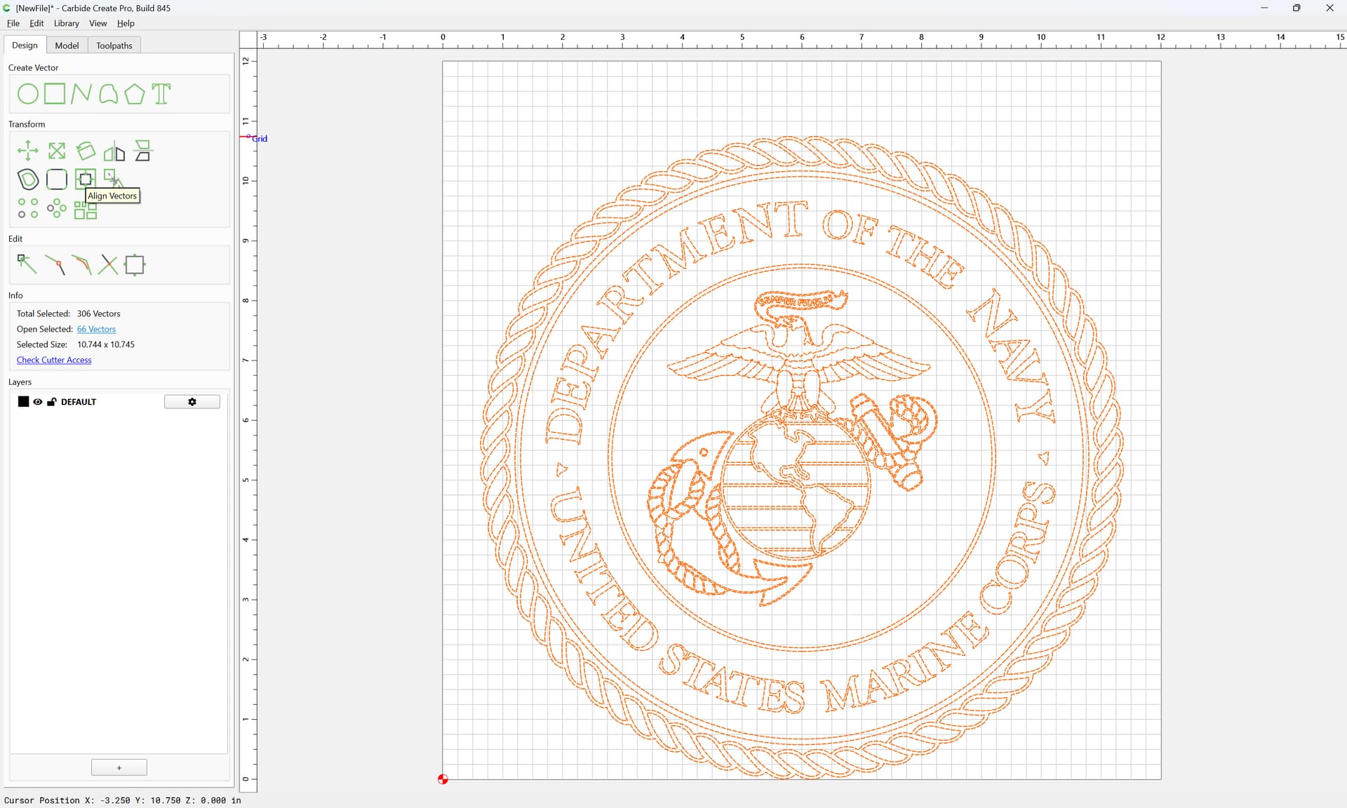

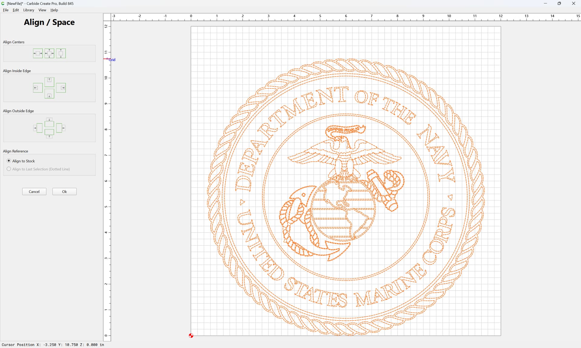

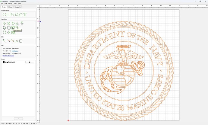

Group Vectors

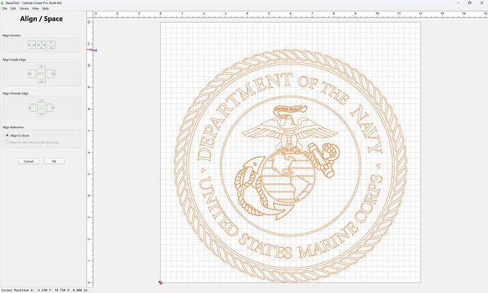

Align Vectors
OK

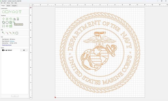

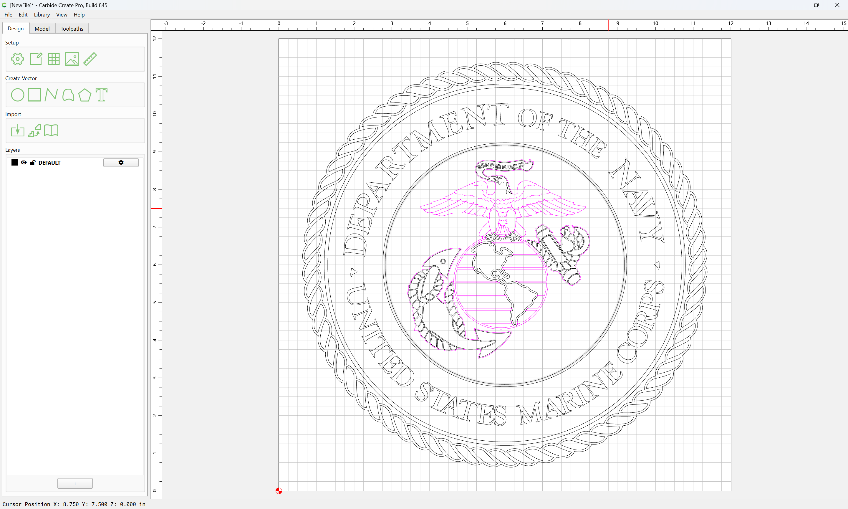

Ungroup Vectors
Click away to deselect

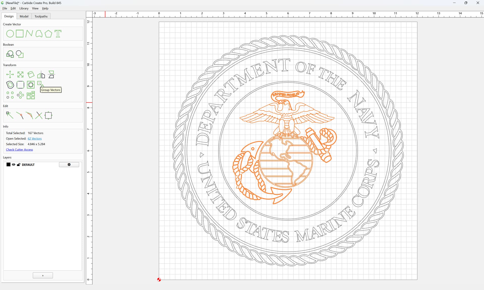

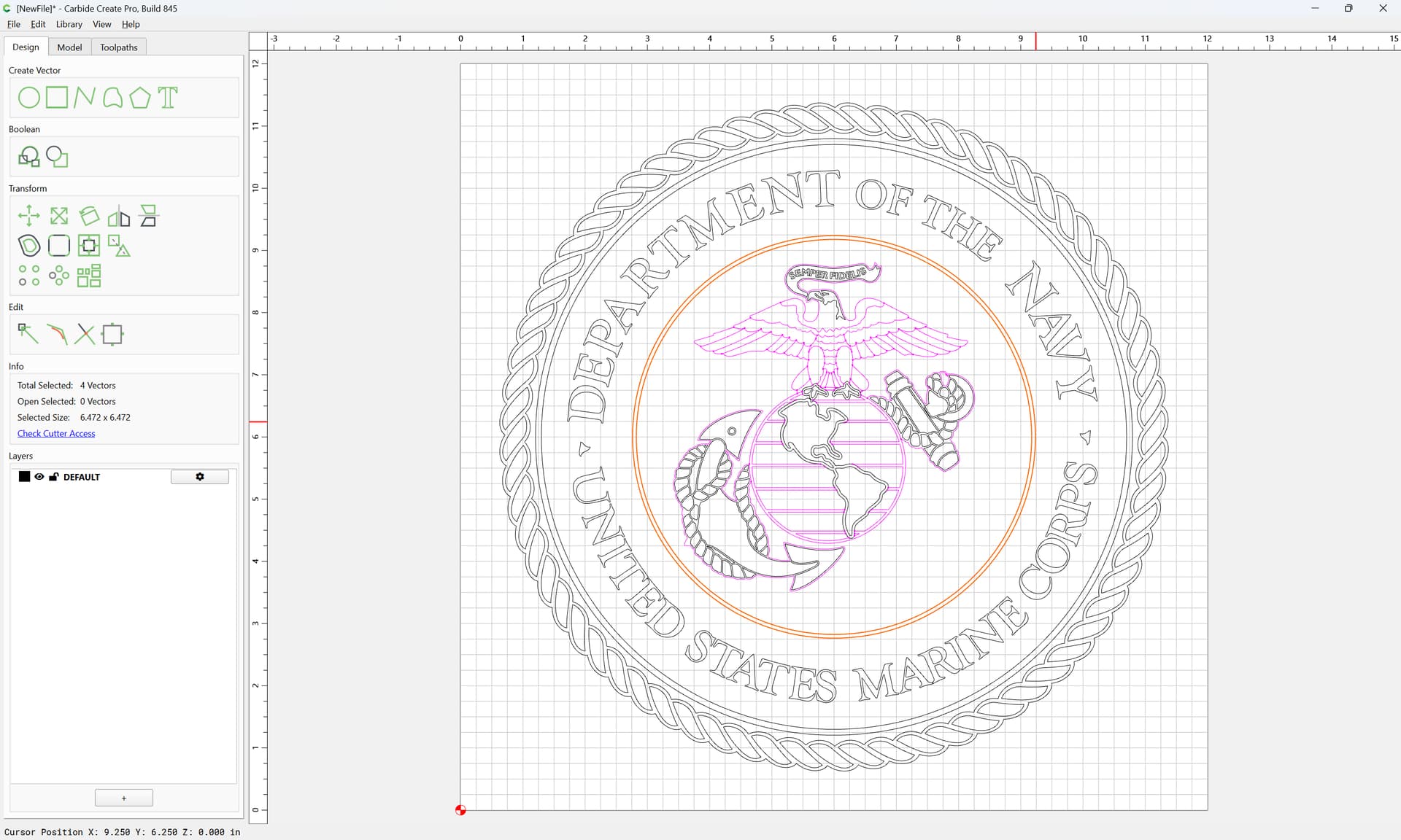

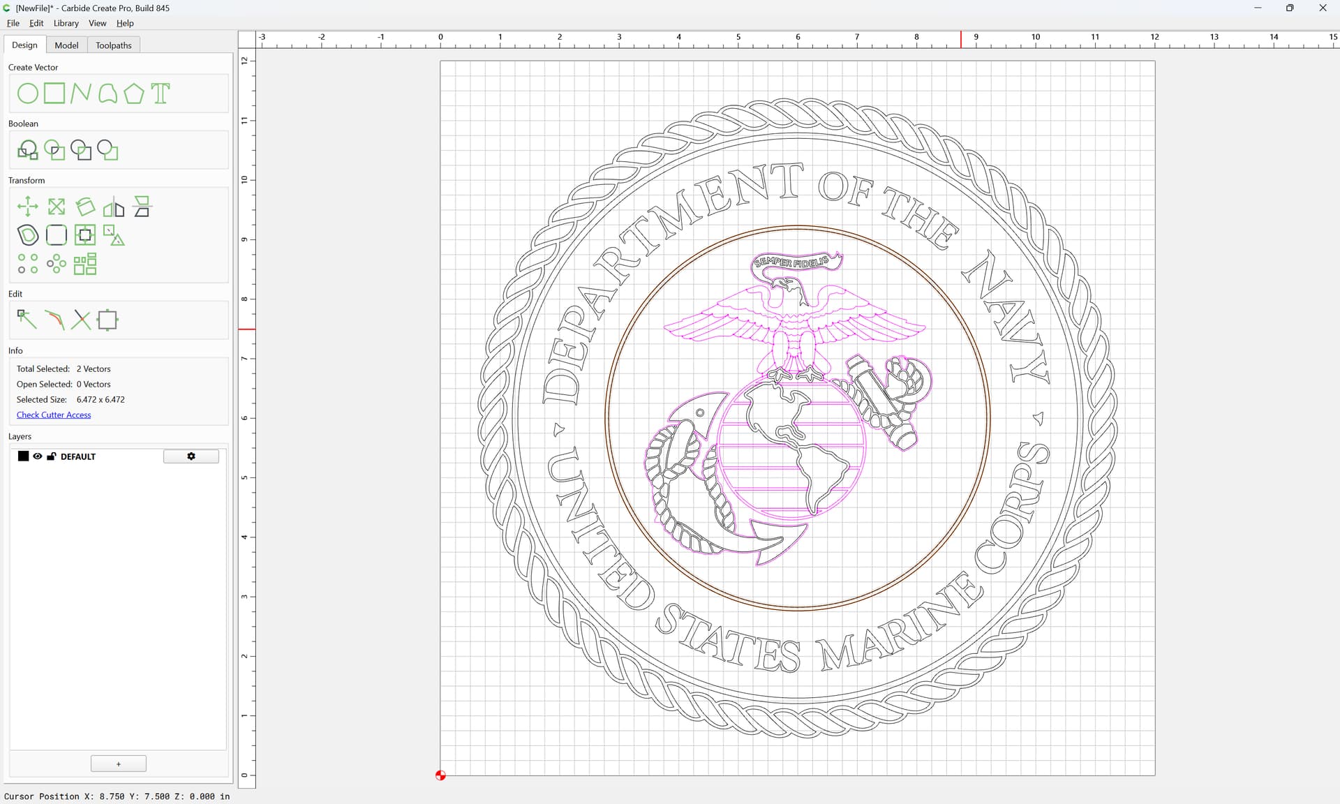

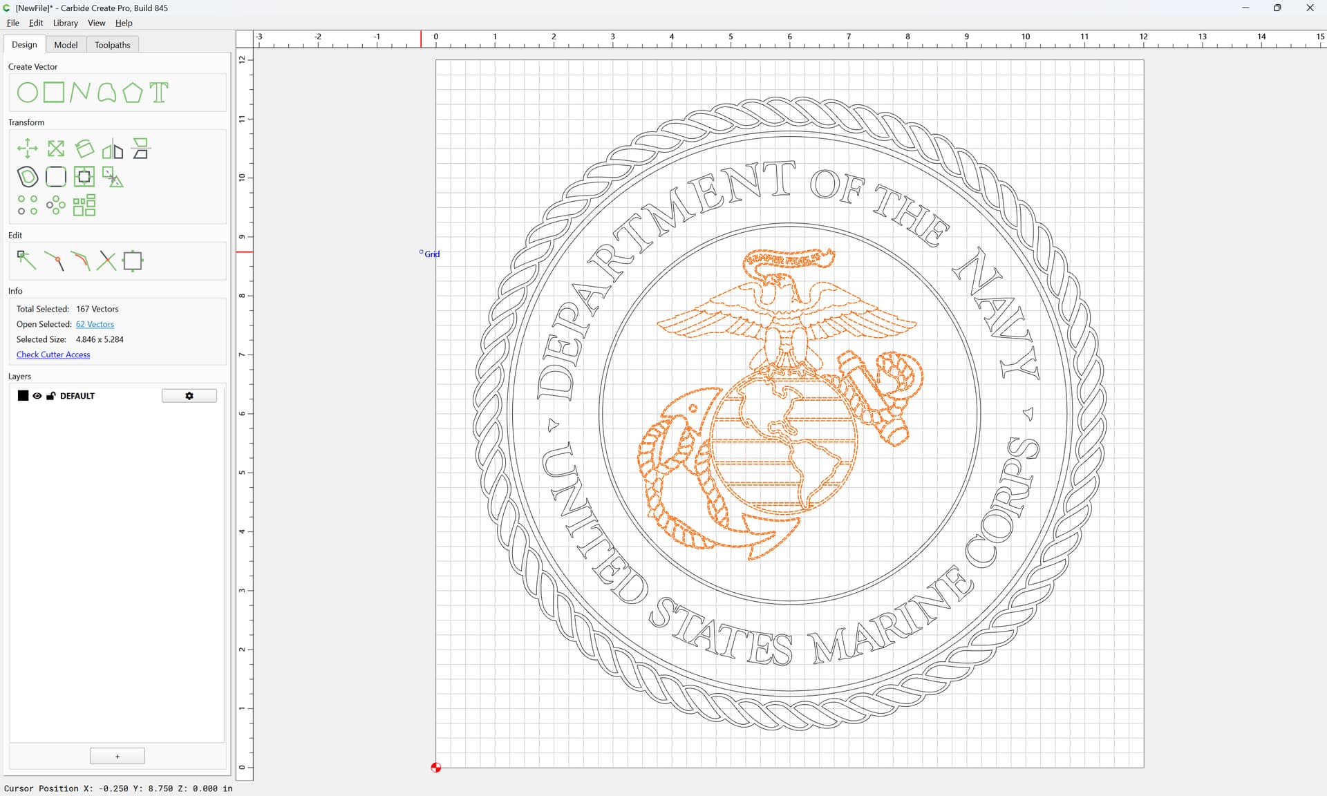

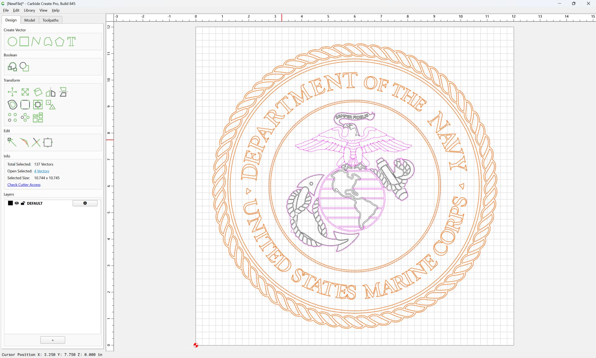

Drag-select the circles around the center:
The shift-click to remove two circles:
and delete the two duplicates

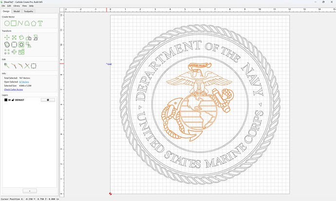

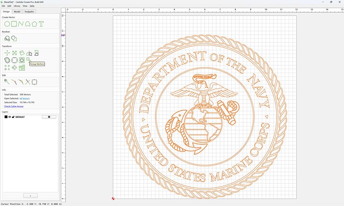

Select everything in the center:
Group Vectors

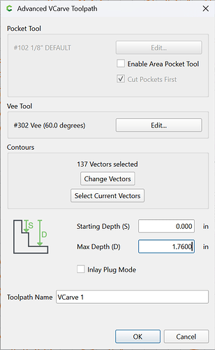

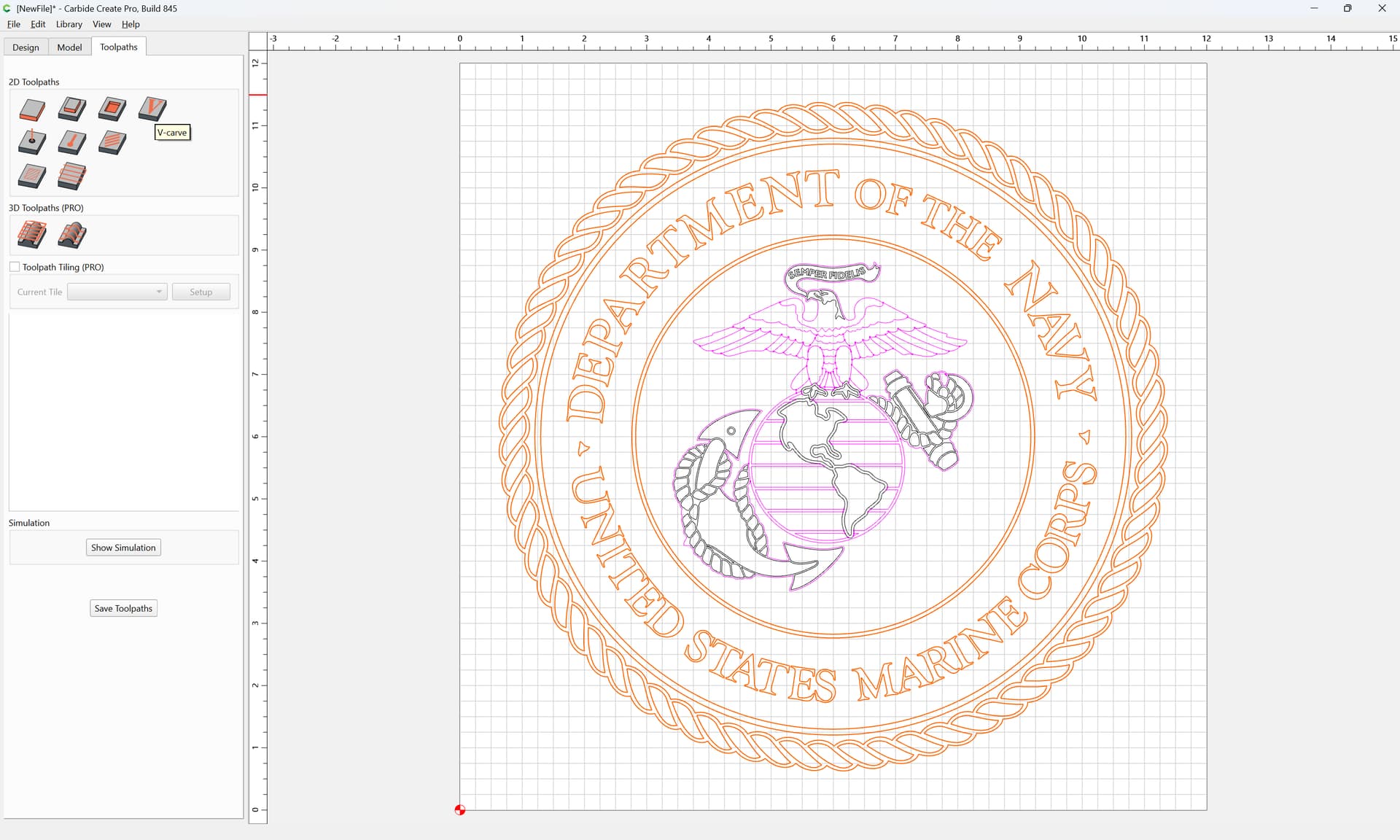

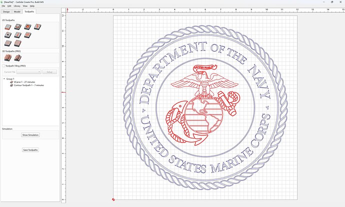

Select the balance:

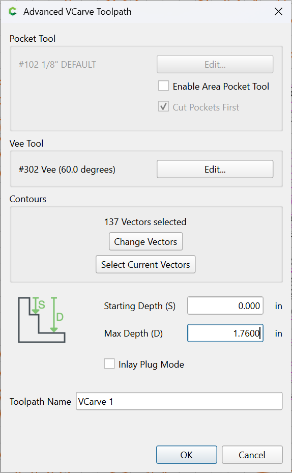

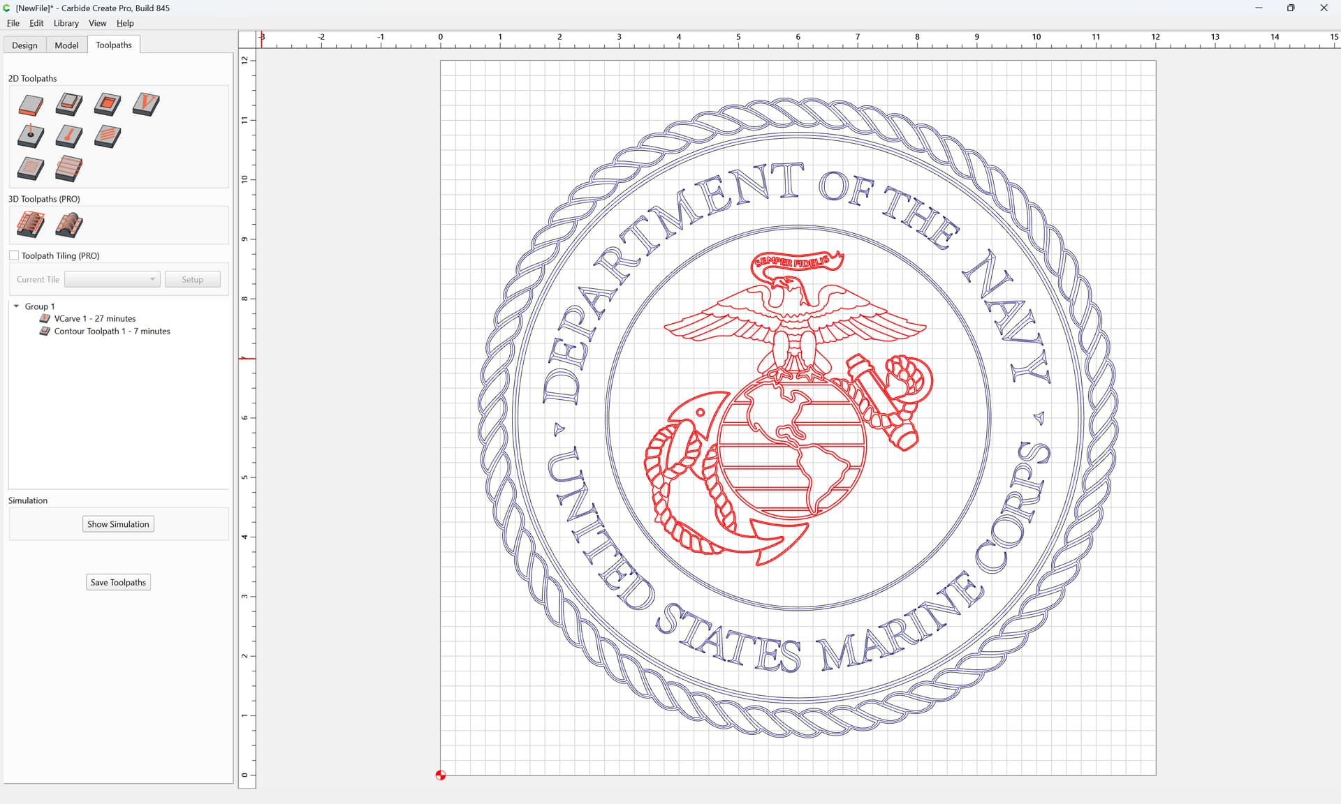

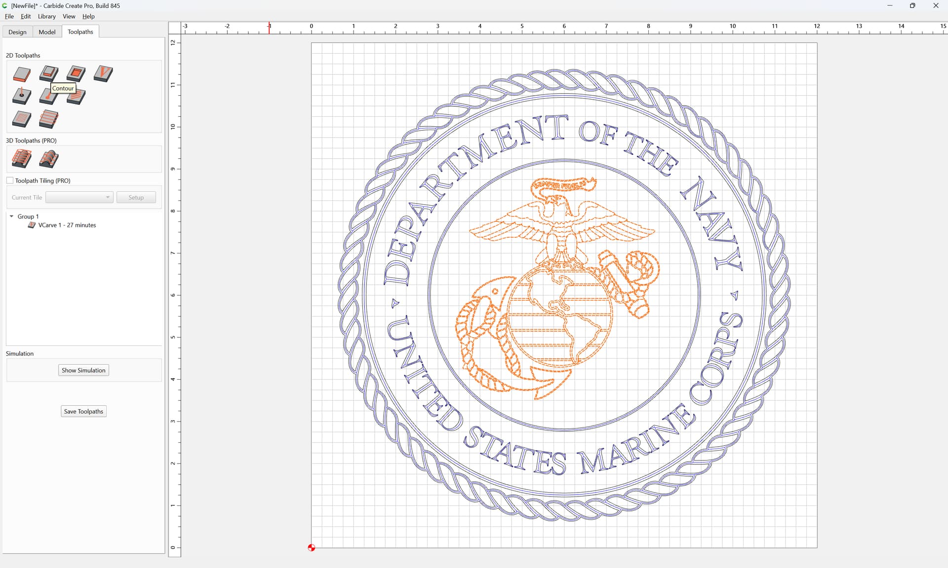

and assign a V-carve Toolpath:
Use Current Selection

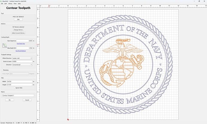

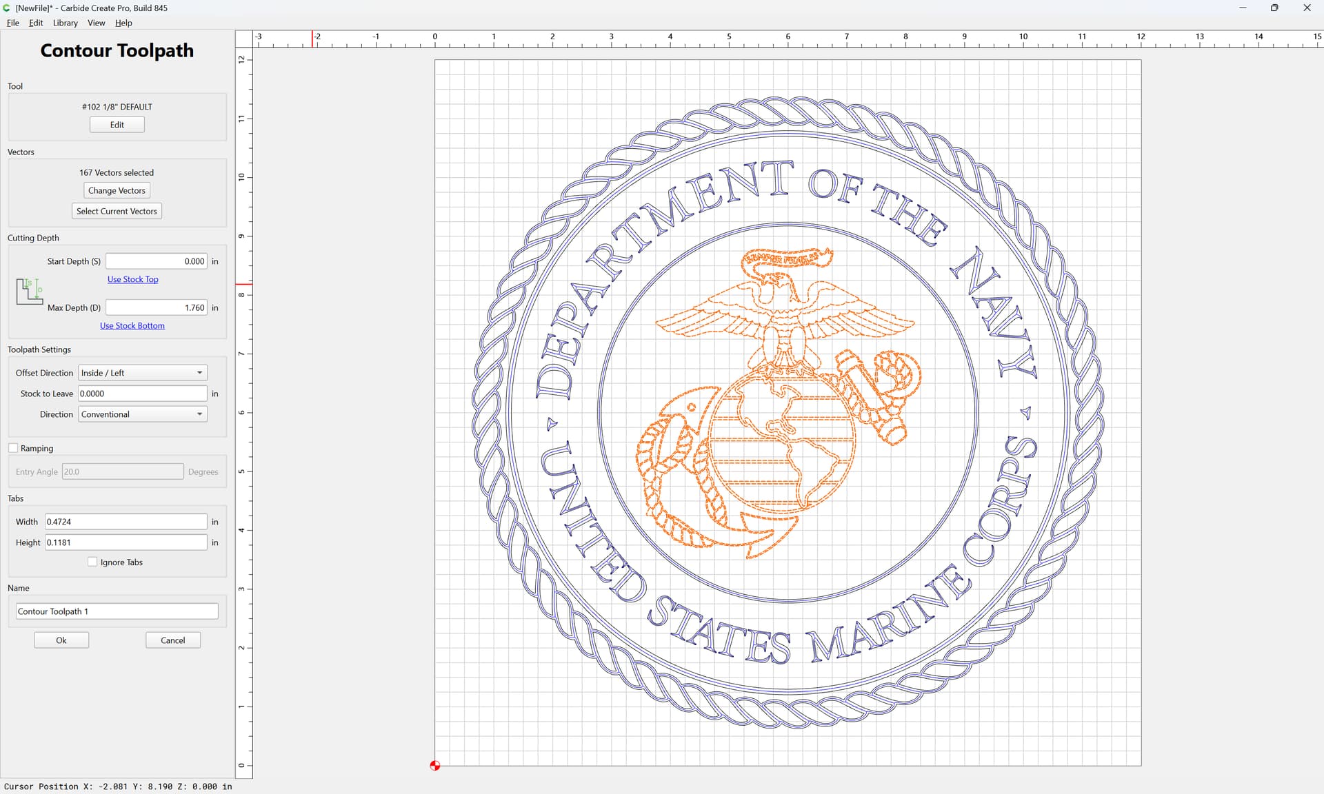

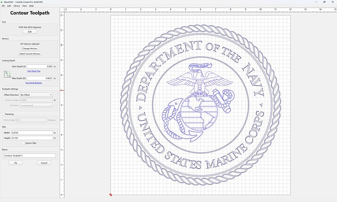

Select the central elements:
and assign a No Offset Contour:
Use current selection

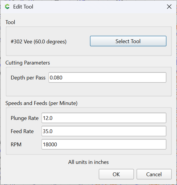

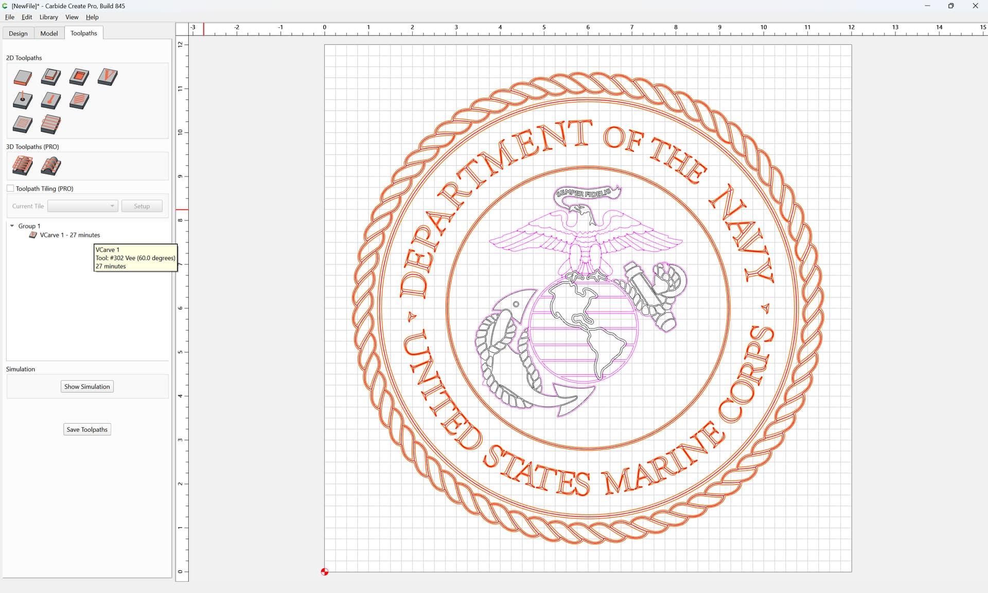

Edit the Tool
and select a V tool
and adjust as desired:

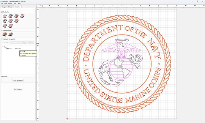

Ok

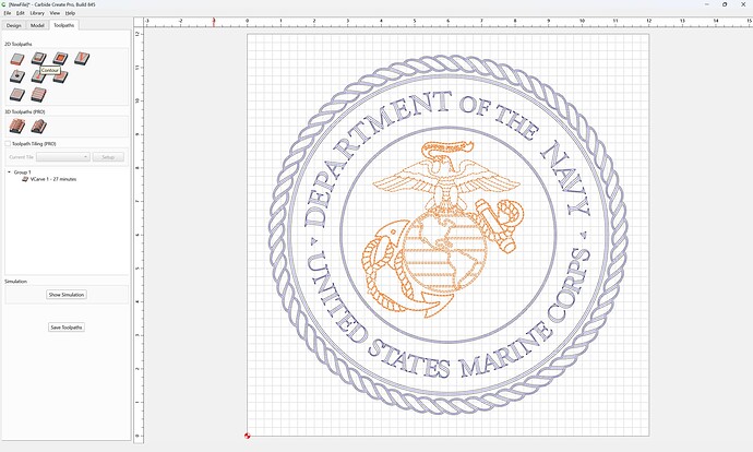

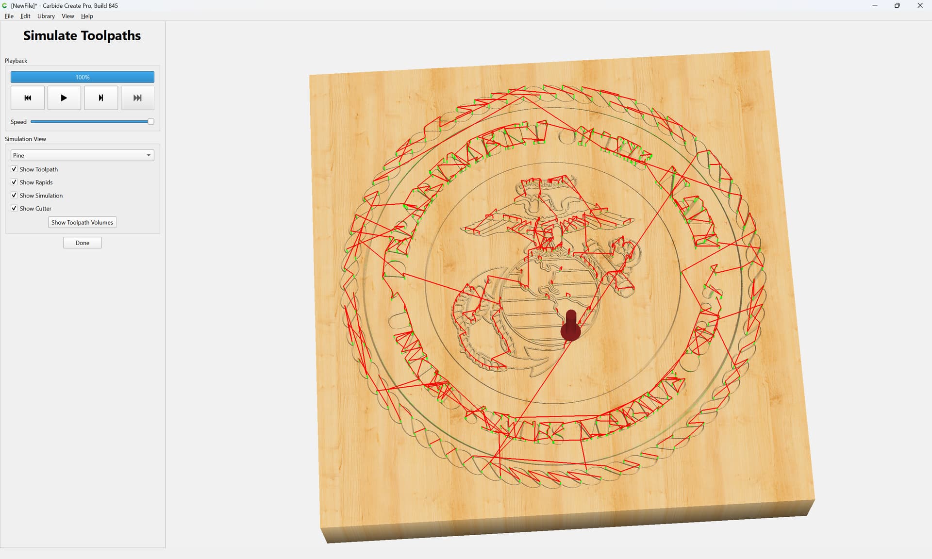

Simulate Toolpath:
