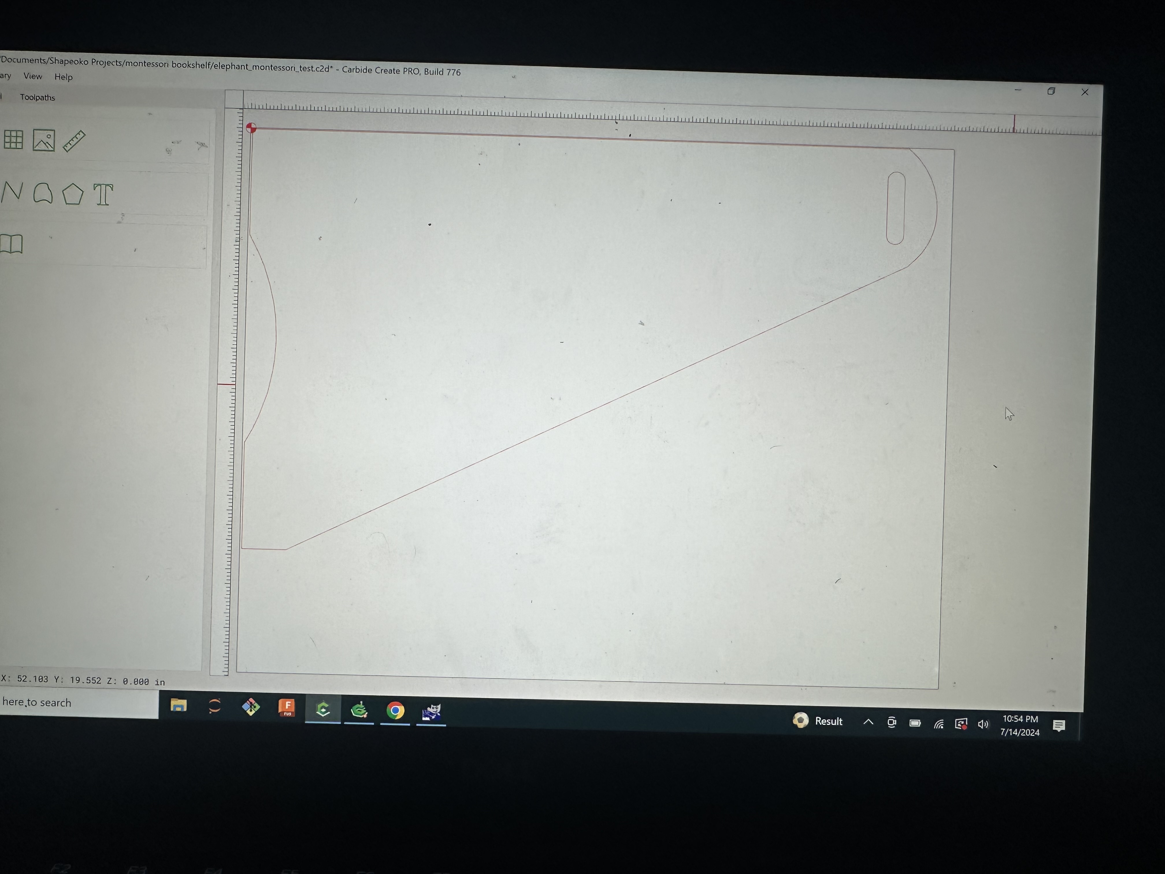

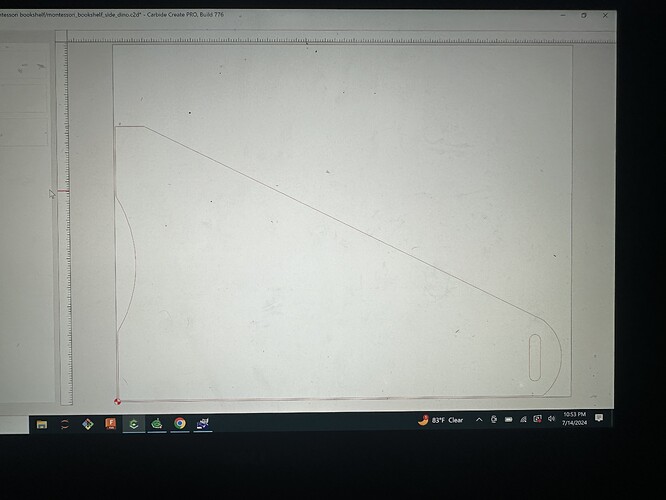

Pics of the shape cuts are below. I used contour cuts with a 1/8” end mill to cut out the shapes. You can see them below. The ONLY thing different is where on the stock the machine is cutting them and the tool path zero (bottom left - cut1) / (top left - cut 2)
Again - these are EXACT mirror images of each using a duplicate of the original shape. One would expect that they would cut out the same.

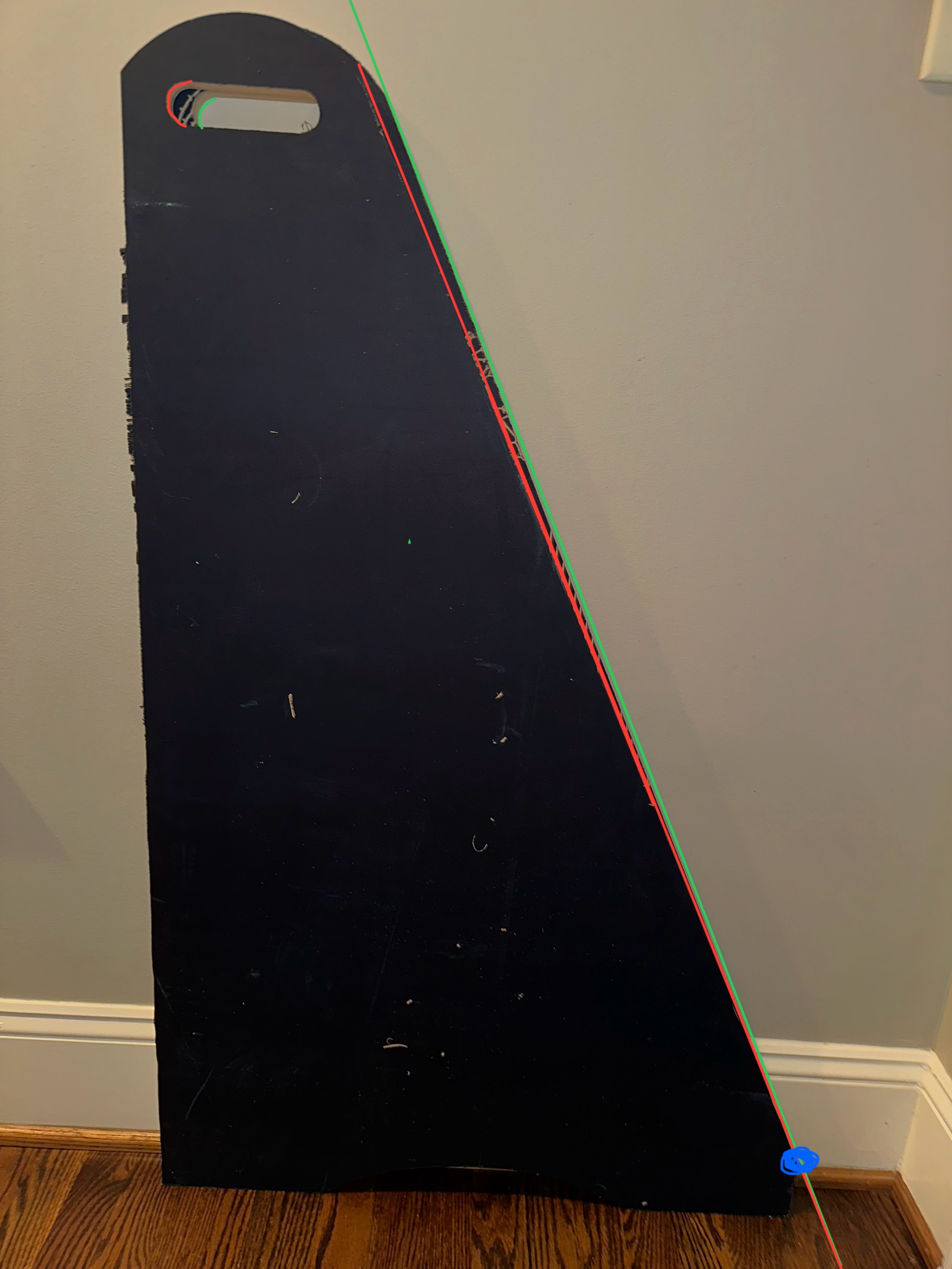

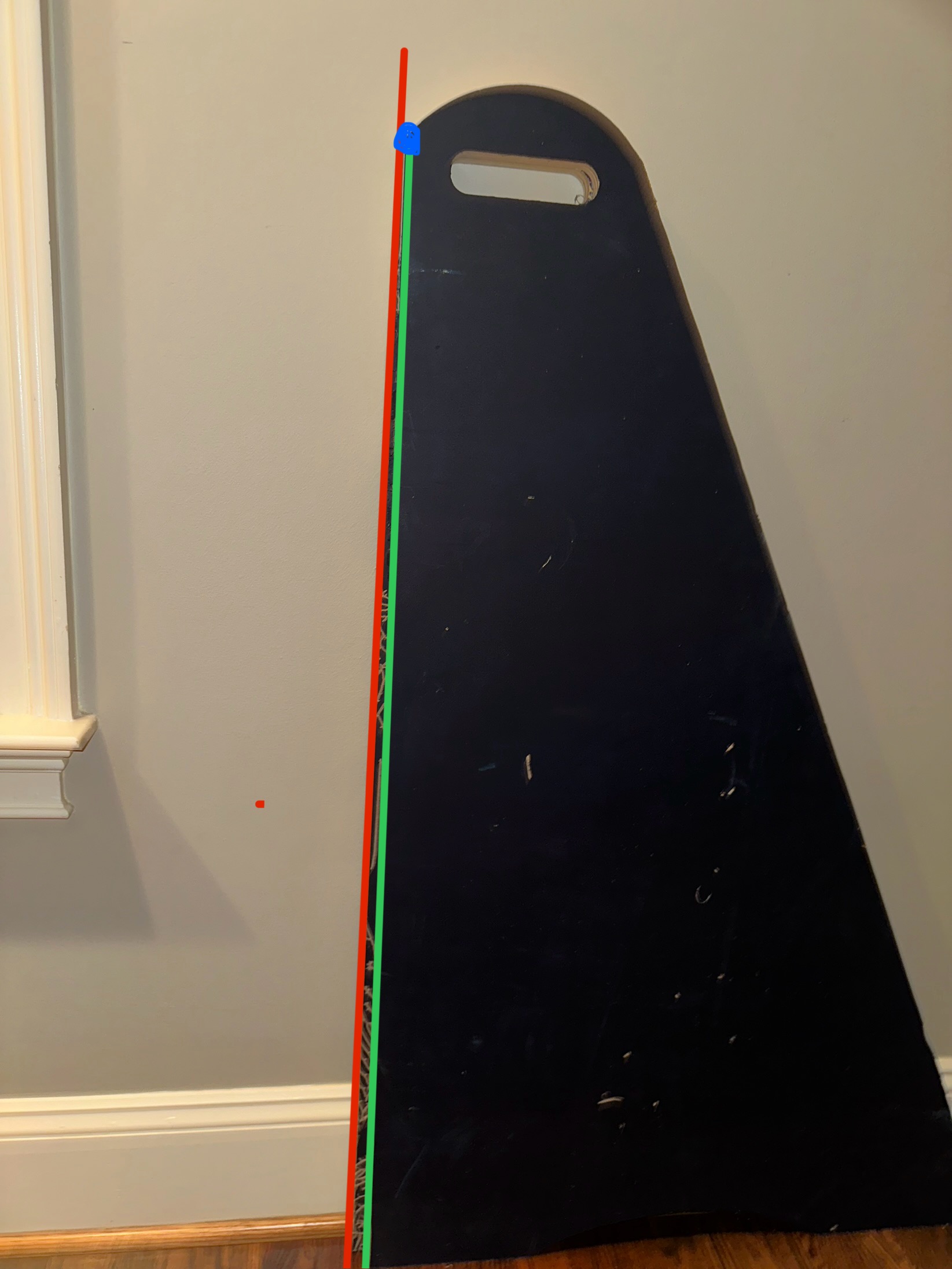

I now have 4 cut sides in total. (2x side #1 and 2x side #2). Both the sides #1 align just fine with each other, as do both #2 sides, but #1 does not align with #2?
What am I missing here???
Side1:
Side 2:
Bookending misalignment results:
Red line vs Green line = showing misalignment
Blue dot = edge of alignment

@mhotchin - I thought of this, too and only used my tape measure. That being said, this is the literature on squaring for the S5pro: Troubleshooting Homing
Although- thinking through this again, 25mm is definitely well in line with the zeroing tolerance built into the s5p, so squaring may in fact be the issue.
My first instinct is that it’s a squaring issue. Most likely you will need to make minor adjustments to one of the homing switches on the Y-axis, bringing it forward or backwards, so that it triggers sooner or later. That will bring gantry much closer to true square when the machine is initialized. You will need to do some testing and measurement to figure out which direction to adjust things.
Michael’s test is valid. Another crude way you could gauge the squareness of your gantry would be to rest one edge of a large, decent-quality T or framing square against one of the Y rails, center the spindle to the perpendicular edge, and jog along it’s length. You’re looking for any deviation of the spindle away from the reference to indicate which side of the gantry needs to come forward.

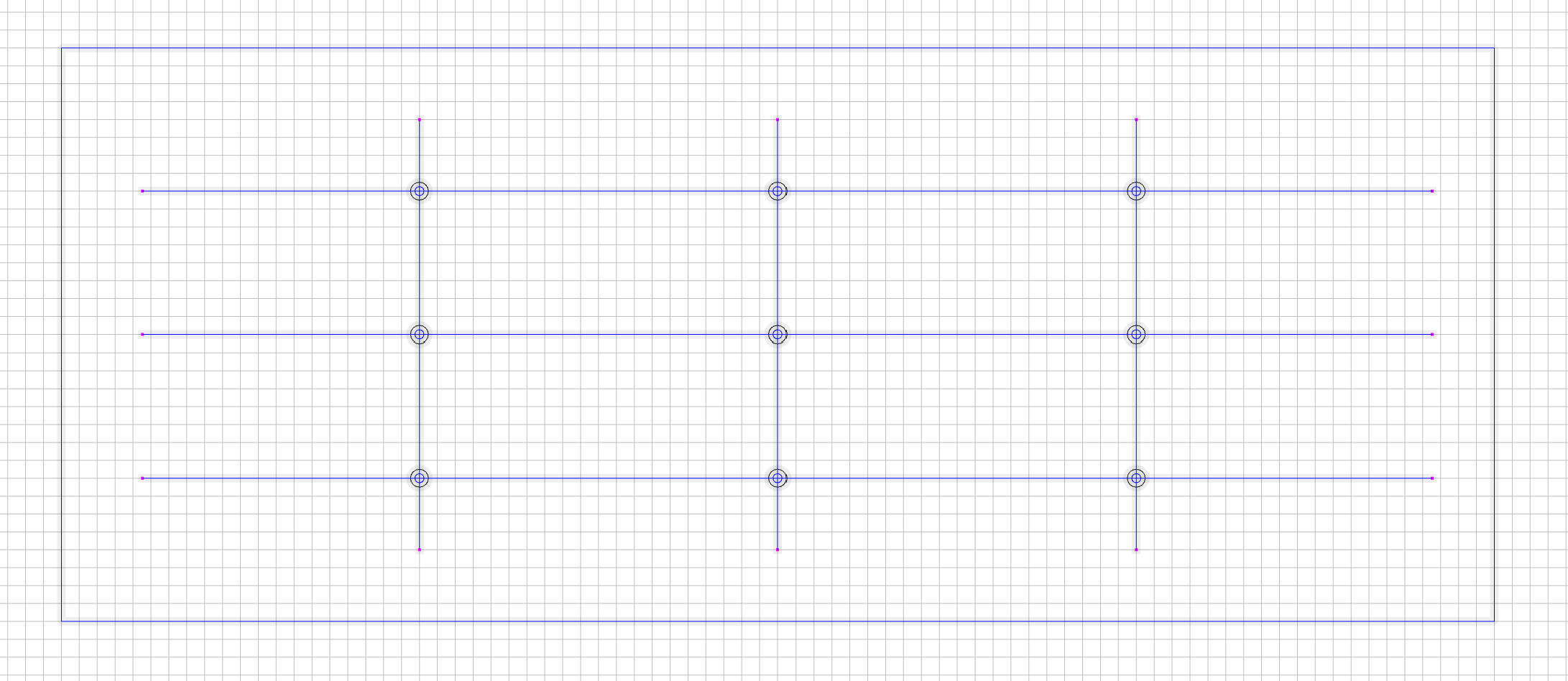

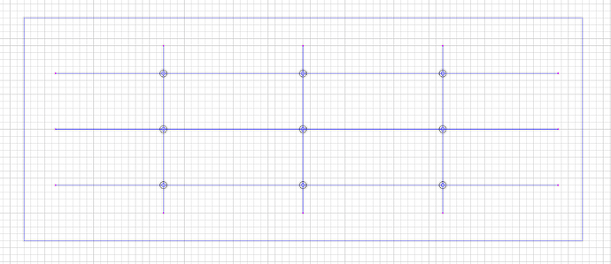

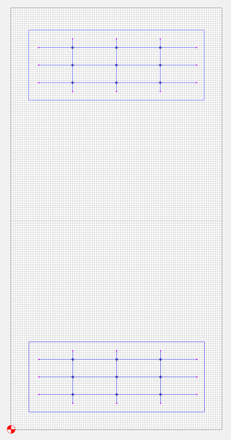

I took you and @mhotchin up on the squaring and designed the following on a 2’x4" sheet of 1/8" ply. Each 20"x8" rectangle gets cut at the extreme ends of the Y-axis on the base (full sheet + zoom in).
Result: Perfect alignment of the holes made at the perpendicular intersection of the lines. The rectangles are also perfectly overlapping each other.
One thing I did do before starting the job was to carefully manually push the gantry ALL the way to the very back of the machine (akin to the machine initialization position). Would that have affected anything in terms of fixing the issue??
It shouldn’t have affected anything, because the S5 Pro will attempt to re-square itself relative to the position of the homing switches upon initialization. On older Shapeoko’s however, pushing the gantry to one extent would actually be beneficial, assuming you built the machine relatively square.
The parellelogram-ness of the gantry would not change from front to back. So cutting two test patterns out from different locations and comparing them would not show any difference. You need to flip one of the test pieces over to see the difference. Then you’d probably see the holes not being aligned, and the outer profiles not matching up.
@mhotchin - did a full deconstruct after I measured the diagonals to be off by 1.5cm. Seems like the root cause.
Doing some meticulous squaring to make up for the blunders, will hopefully result in a fix.
