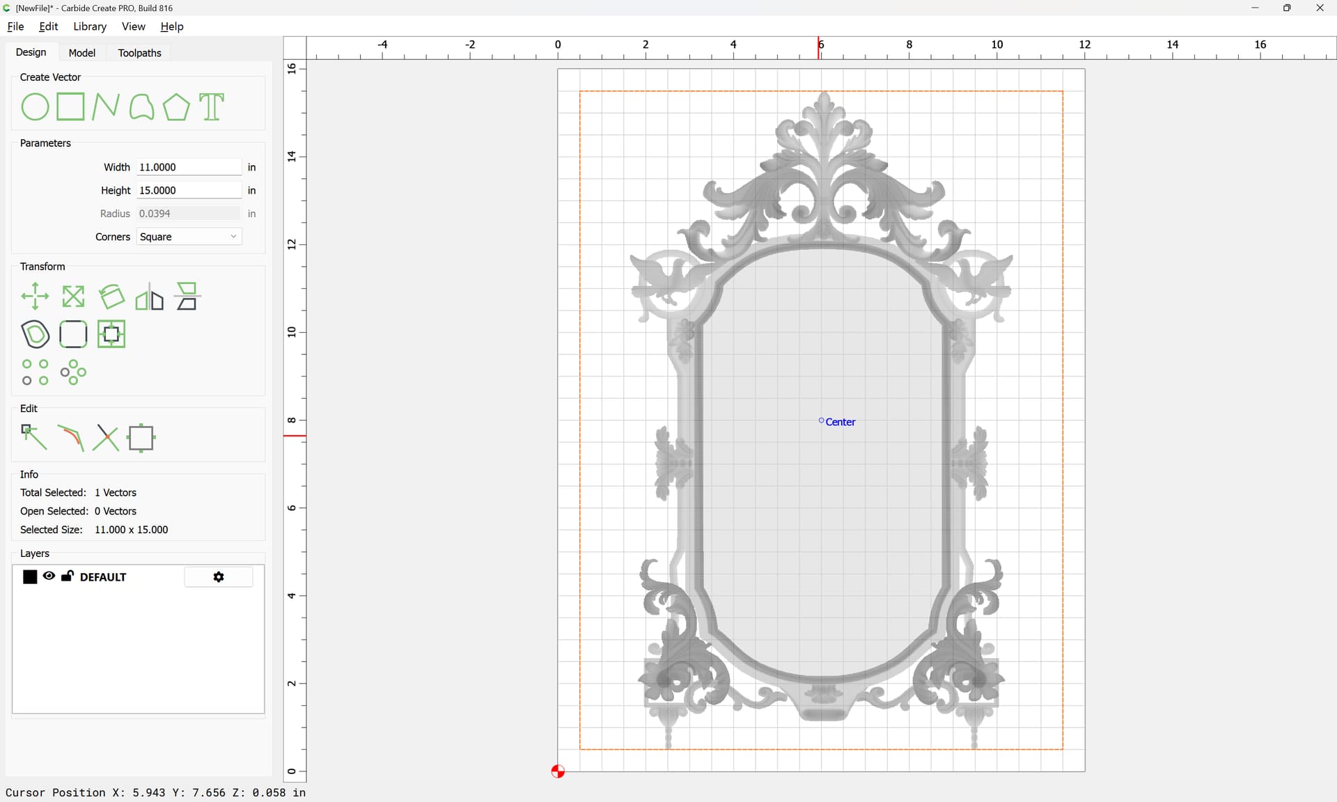

Need help with a frame stl
I have been asked by my daughter in-law to make a picture frame based on a stl about 8x10
I can import the stl and create an out line vector around the outer but can’s figure out to pt one around the inner to cut that part out.
https://www.dropbox.com/scl/fi/p0kwwoa46zsxbqrdkwkji/33.STL?rlkey=4bkqhyjcolpwd19gr2h5jg6yo&st=zjaz1ah9&dl=0https://www.dropbox.com/scl/fi/p0kwwoa46zsxbqrdkwkji/33.STL?rlkey=4bkqhyjcolpwd19gr2h5jg6yo&st=zjaz1ah9&dl=0
Any direction would be appreciated.

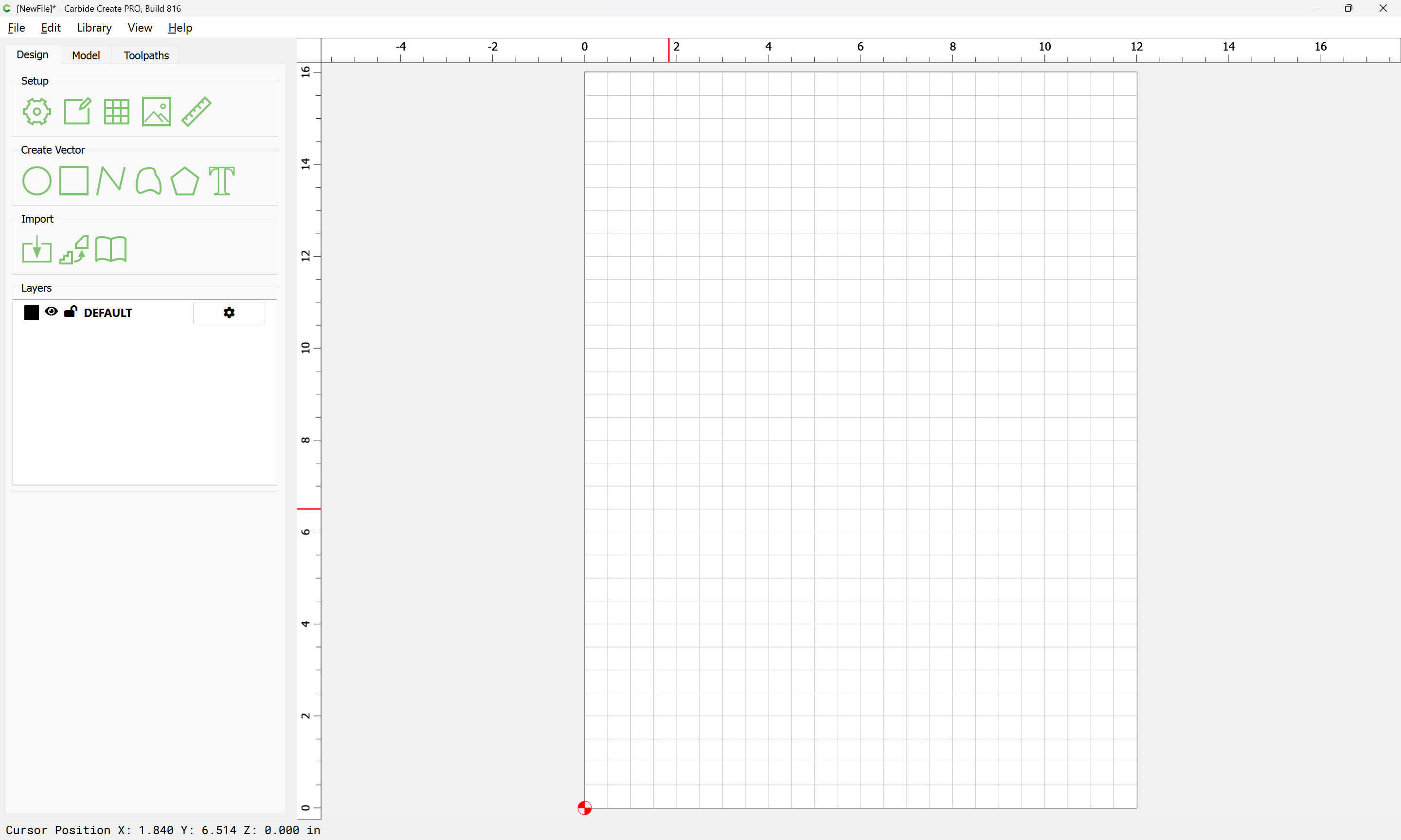

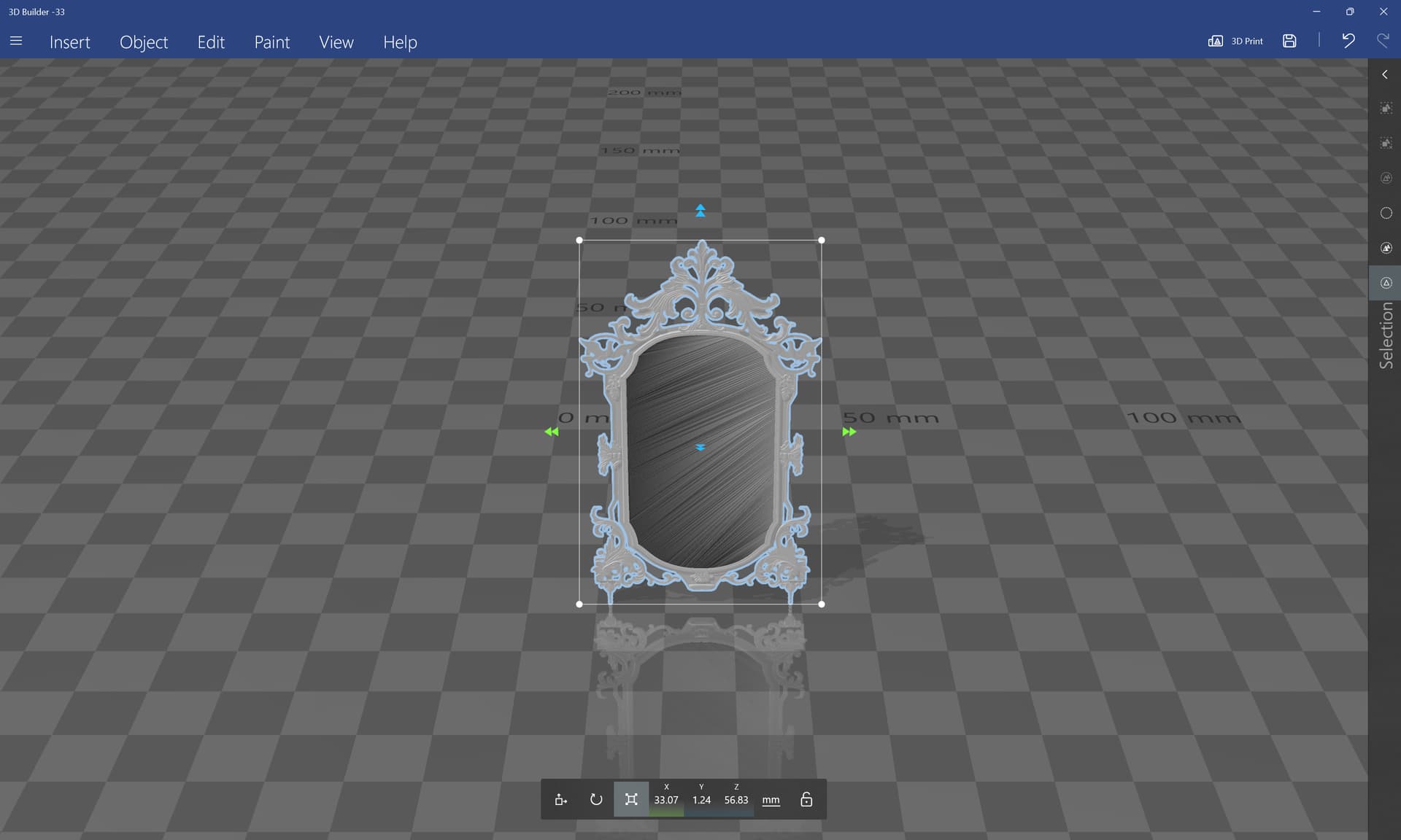

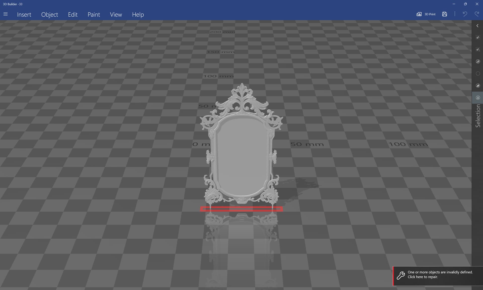

The STL seems straight-forward enough:
(except that it needs to be repaired)

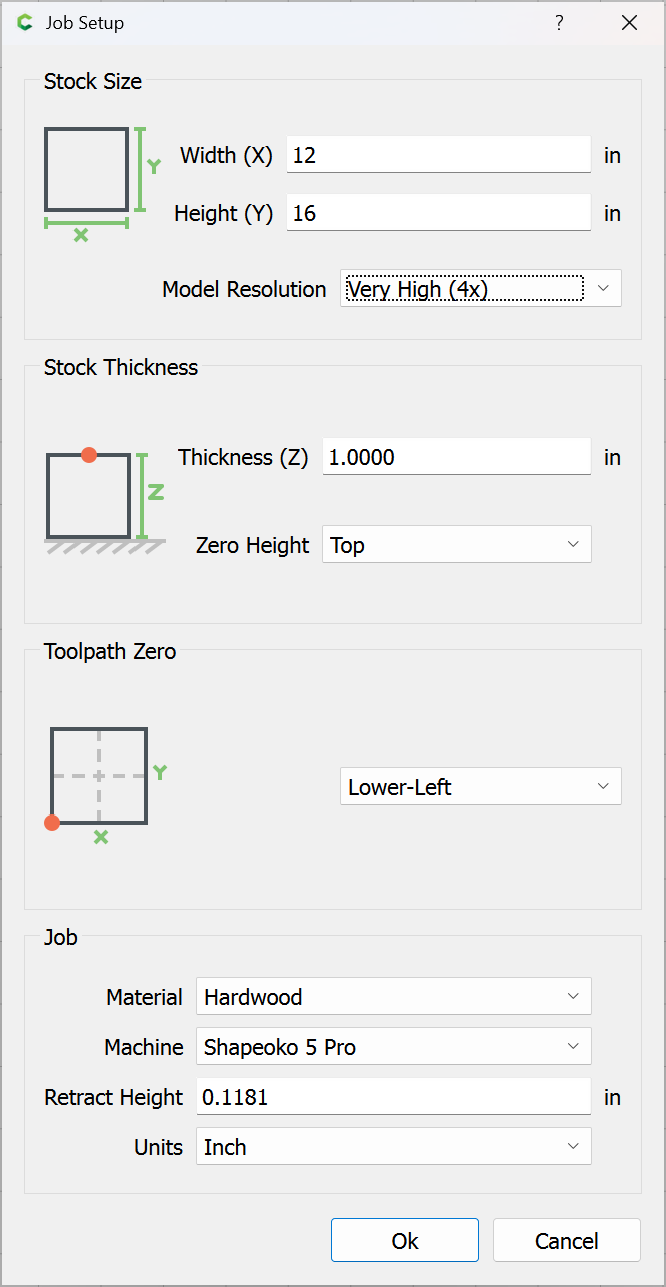

Once it is repaired, the dimensions seem a bit small:

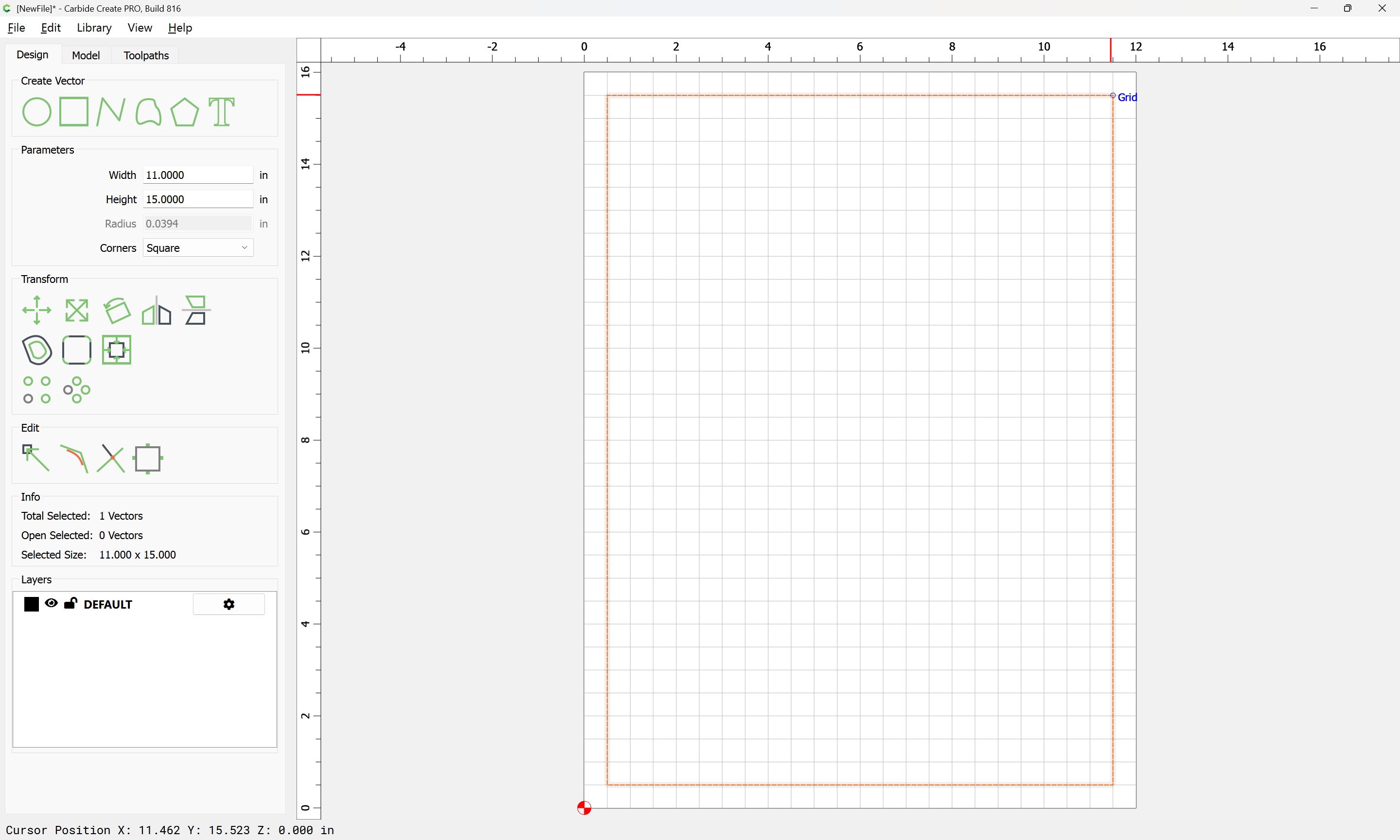

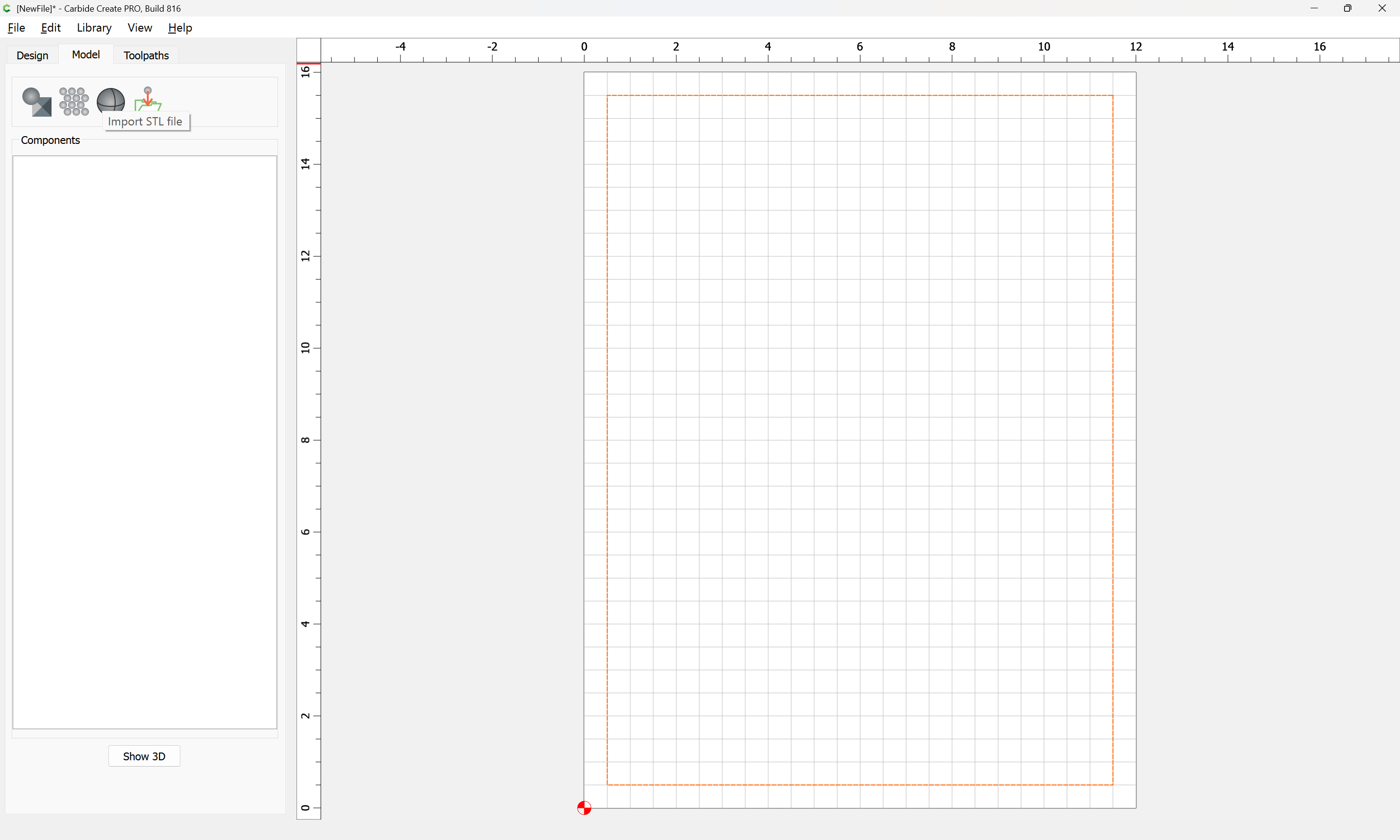

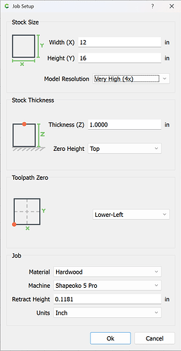

Taking a guess as to proportion/stock size we try:

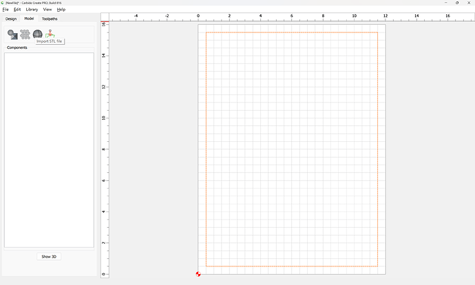

and draw a rectangle:

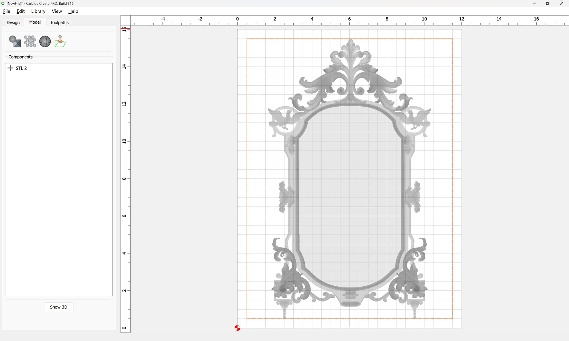

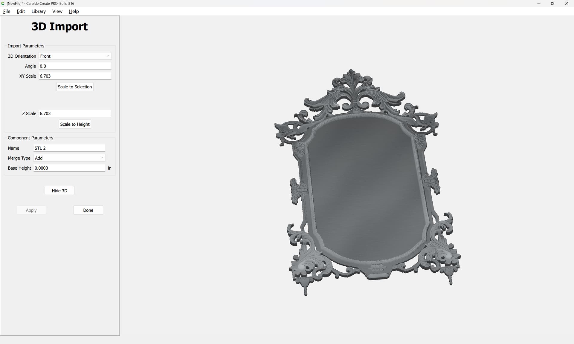

and import the STL into that:

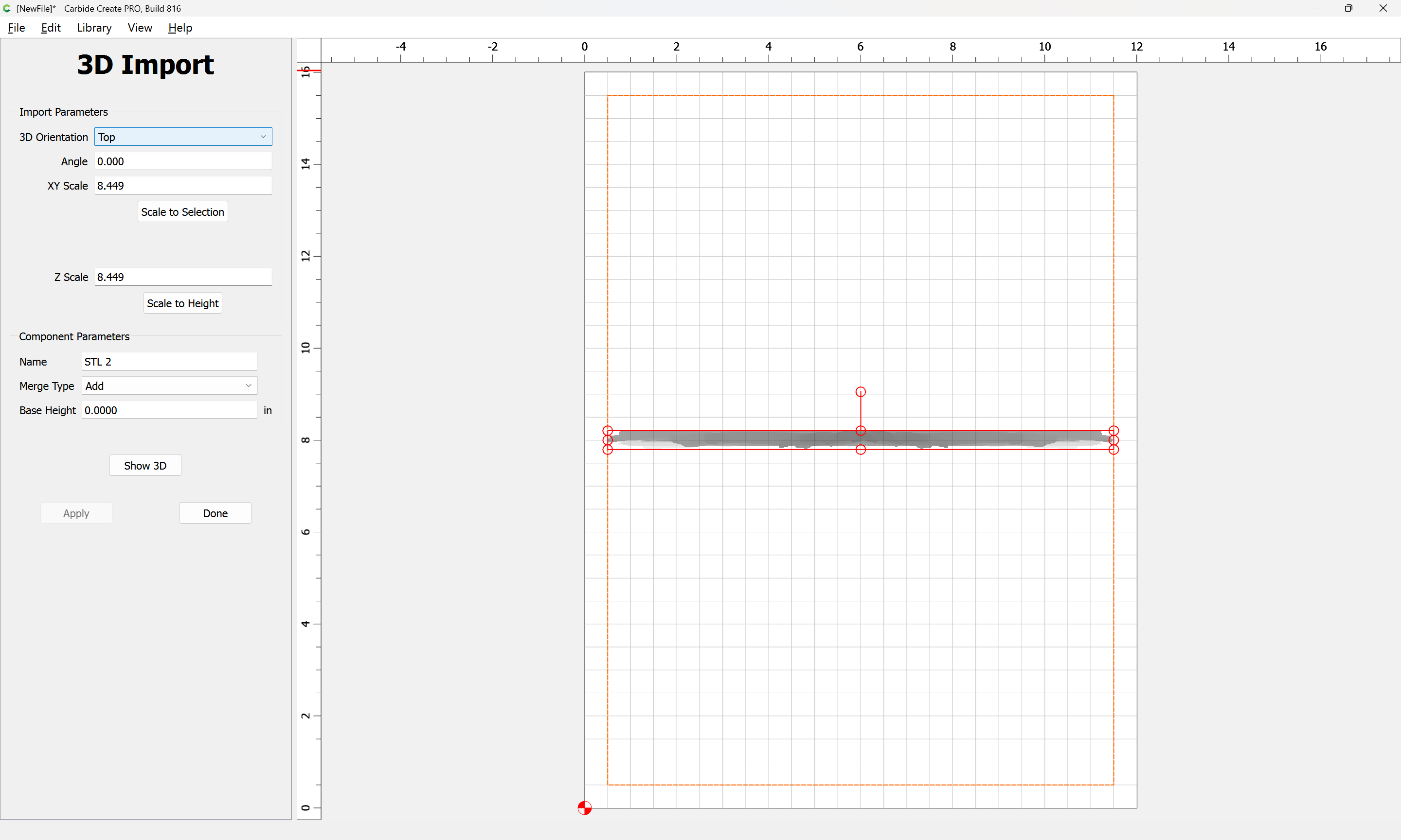

and adjust the settings of the import:
Done

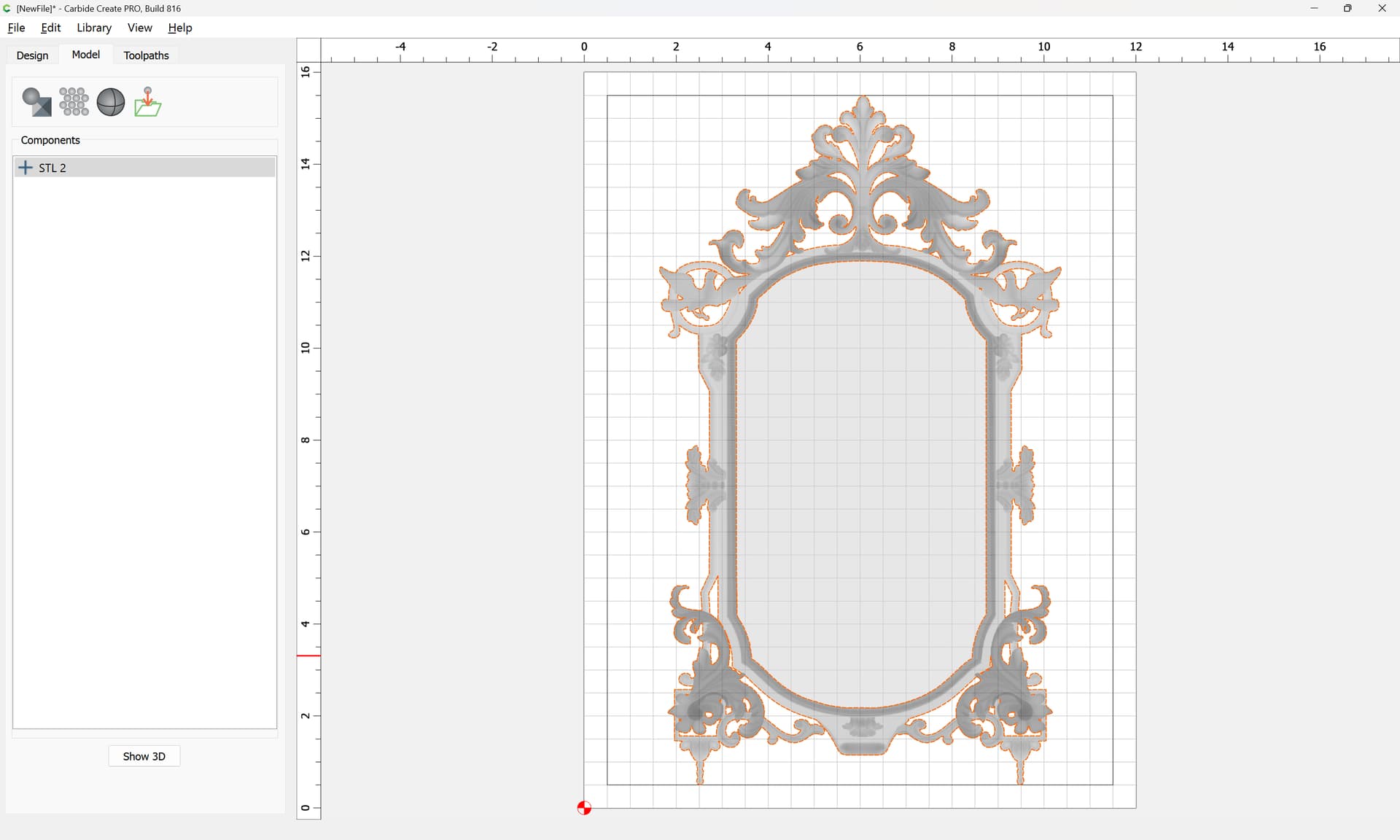

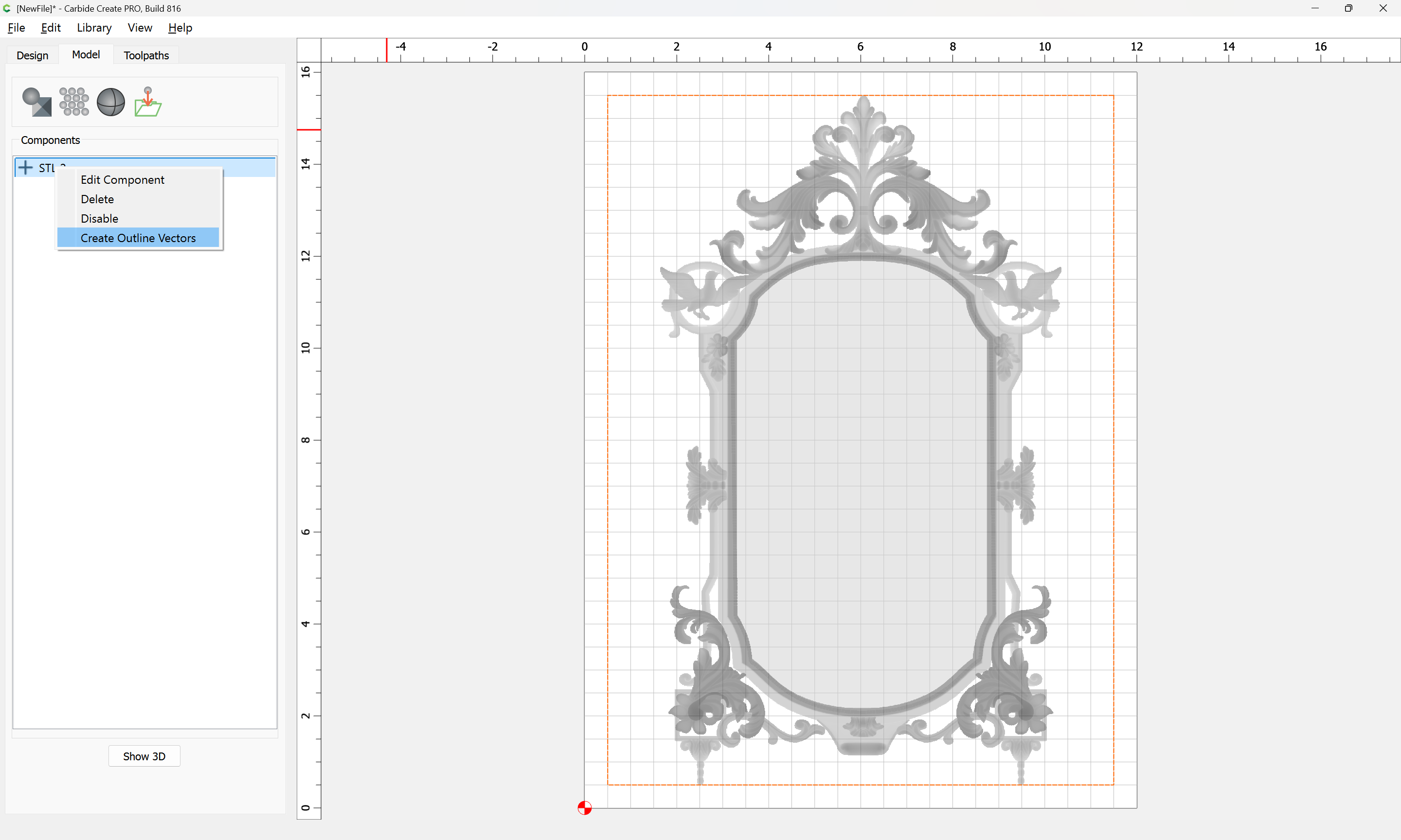

Switching back to the Design tab:

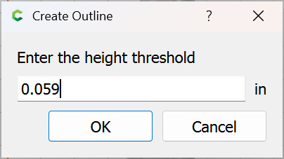

If we mouse over the central area we get a Z-axis height of 0.058 inches — making a note of that we switch back to the Model tab and right-click:
and choose “Create Outline Vectors”
and enter a value just slightly above the height noted
OK
which nets us the interior outline which is wanted if I understood aright.
Will, Thanks for the explanation. I had never noticed the cursor position on the bottom left corner of my screen.

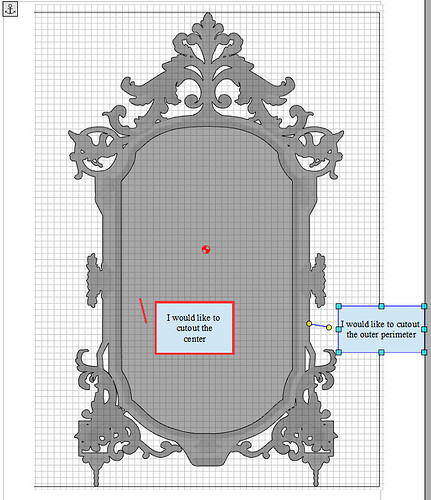

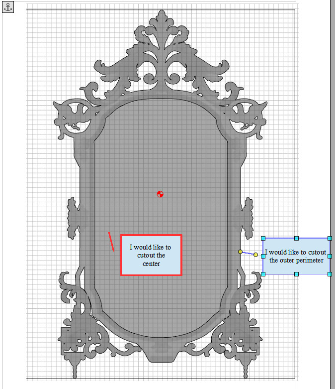

I followed your examples and was able to isolate the interior portion but can’t figure out how to cut the center out completely so I can add a picture from behind. I also cannot see how to do an outer perimeter cut out of the frame.
Is there a way to set two outline vectors? I could then remove unwanted vectors from the inner and contour cut out around that vector and cut the frame outline with the other?
I have tried and don’t know how to set a second outline vector.

I also increased the base height to thicken the frame.
Like most applications, it’s select, then affect — upload a screen grab showing the selection you are making?
