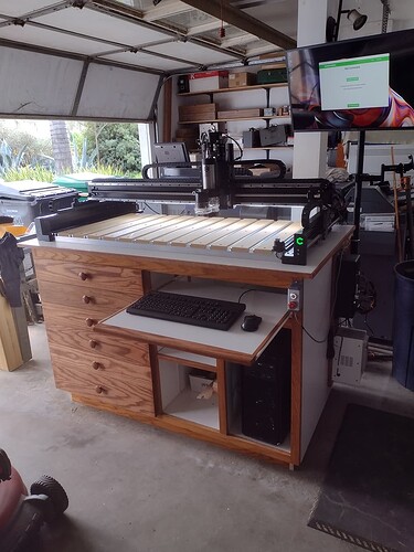

I bought a Shop Fox for the vacuum system, much quieter than a shop vac. My entire system runs on a single 20 amp circuit except for the vacuum system. 20 amps runs a computer, monitor, 1.2kw vfd and 5 Pro with no issues. Make sure the circuit is NOT GFI. Below is a photo showing placement of the controllers, which worked out perfectly. Hope this is helpful.
Thank you so much and I love the setup
