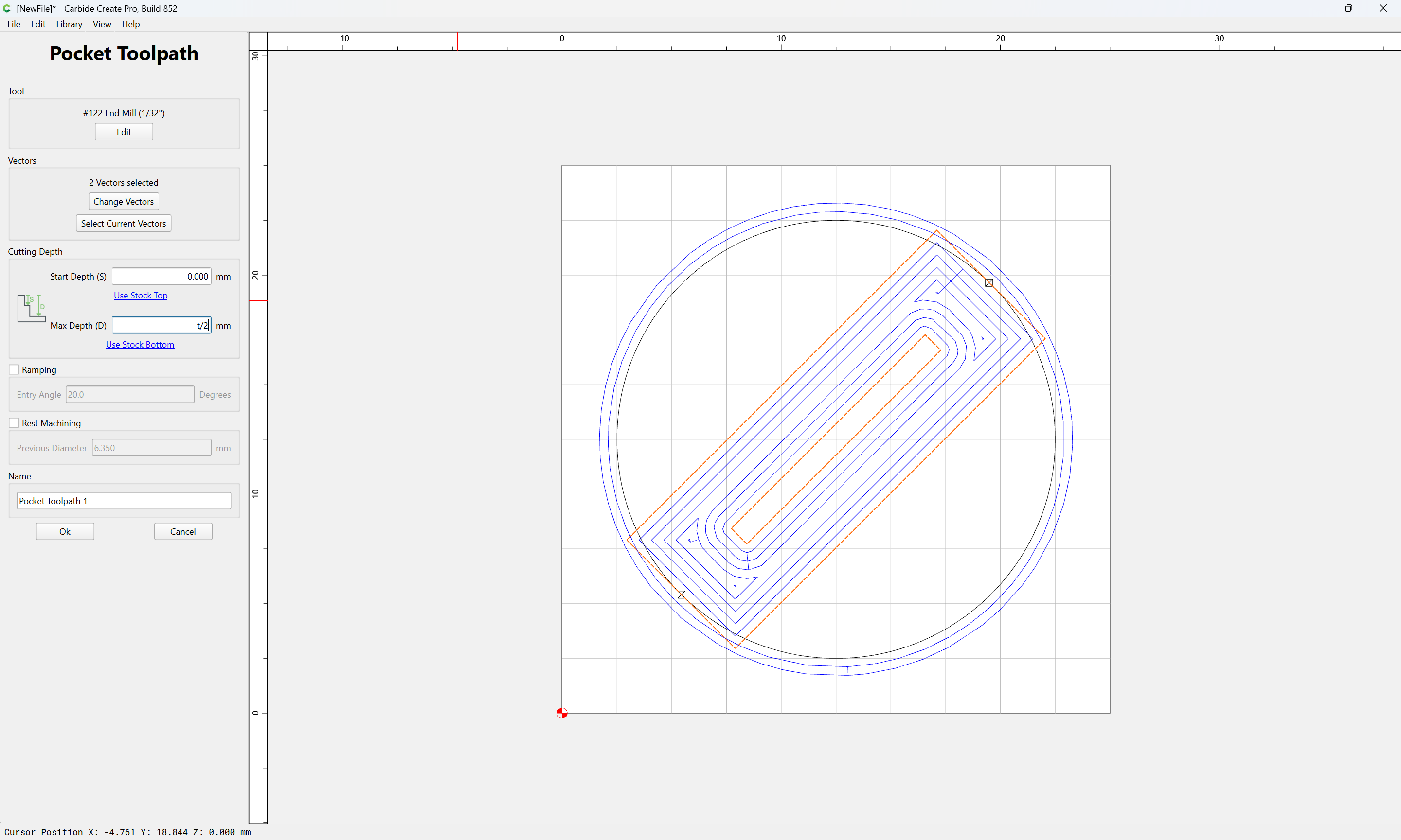

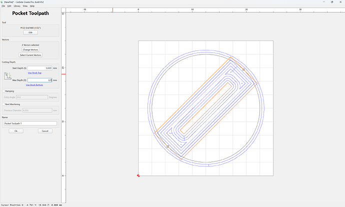

The intention of the new Cutout toolpath is to allow cutting out parts without cutting deep slots without the added steps of offsetting geometry and cutting as a pocket down to tab height.
I showed using it here:
and wrote up a bit on it at:

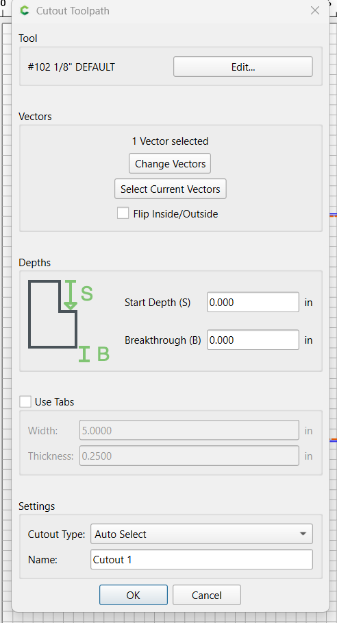

I followed @Jeffish and did find the change but no explanation about how to use cutout tool path. Most of it seems straight forward and by using it with a 1/4" endmill it cuts a contour that is wider than 1/4" to avoid deep cuts that are 1/4" wide.
What I do not fully understand is start depth and breakthrough. You are not asked about the depth of the cut out so I am guessing from the Setup it is using the material thickness to start the cutout depth. So exactly what does start depth do? Is that like doing a contour but starting below the top of the material? Then the breakthrough? I usually do not want to cut up my spoilboard and I use bottom of material. That works but what numbers do I put in for breakthrough if I am wanting to cut into my spoilboard and/or leave an onion skin?

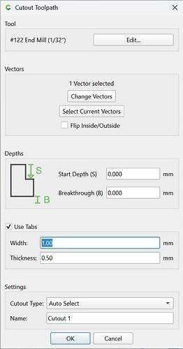

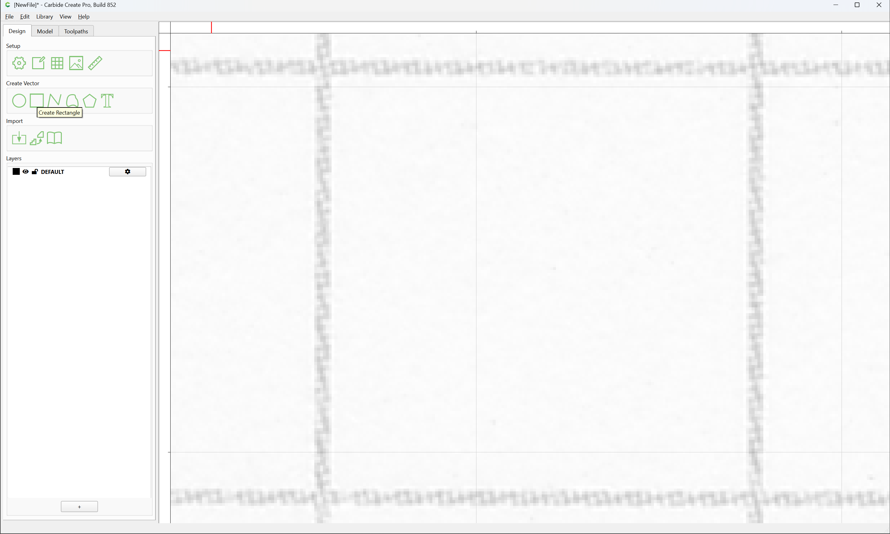

Anyone have an issue with making the tab width less than 1mm? I tried but I changed back so I just went back to contour.

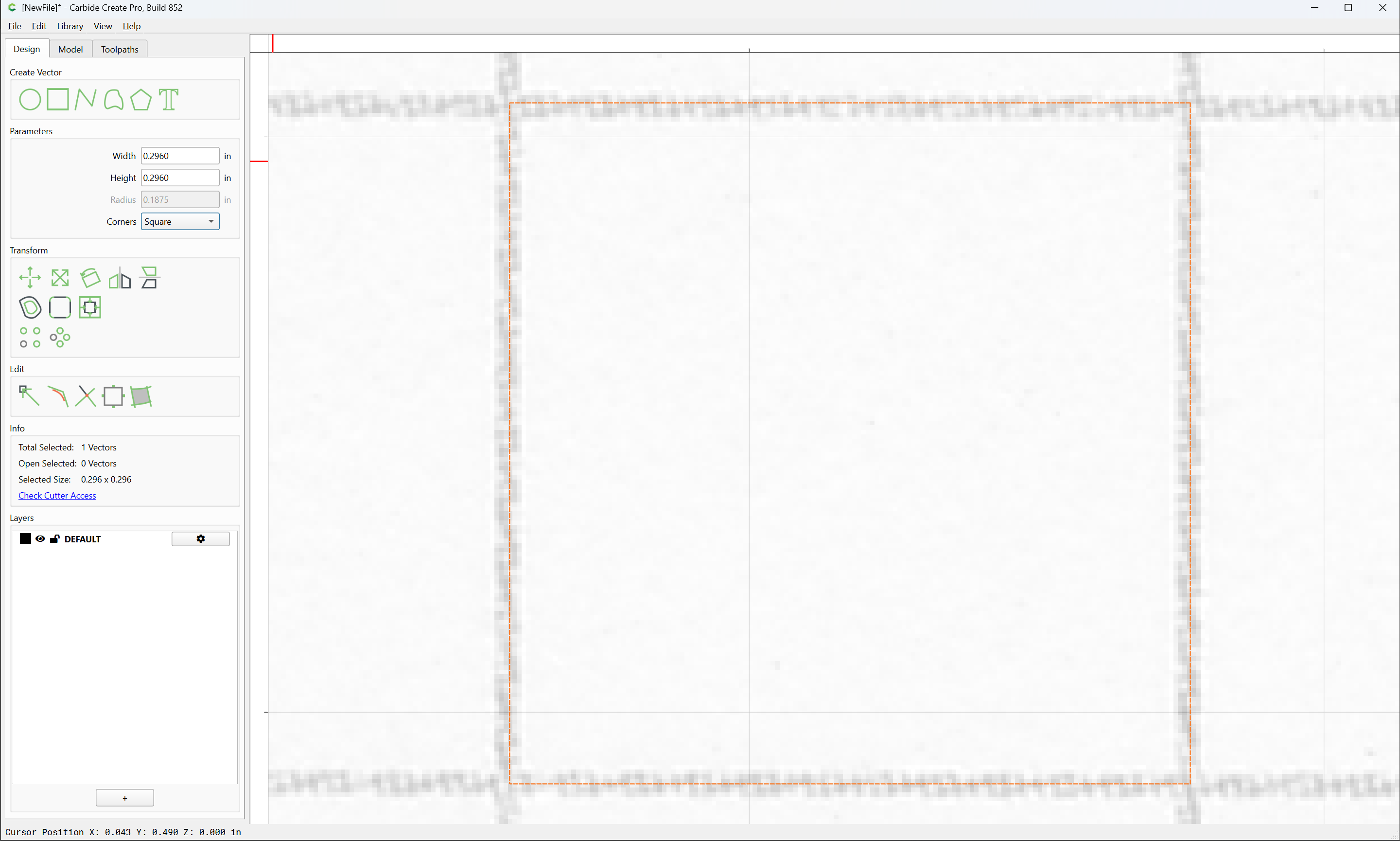

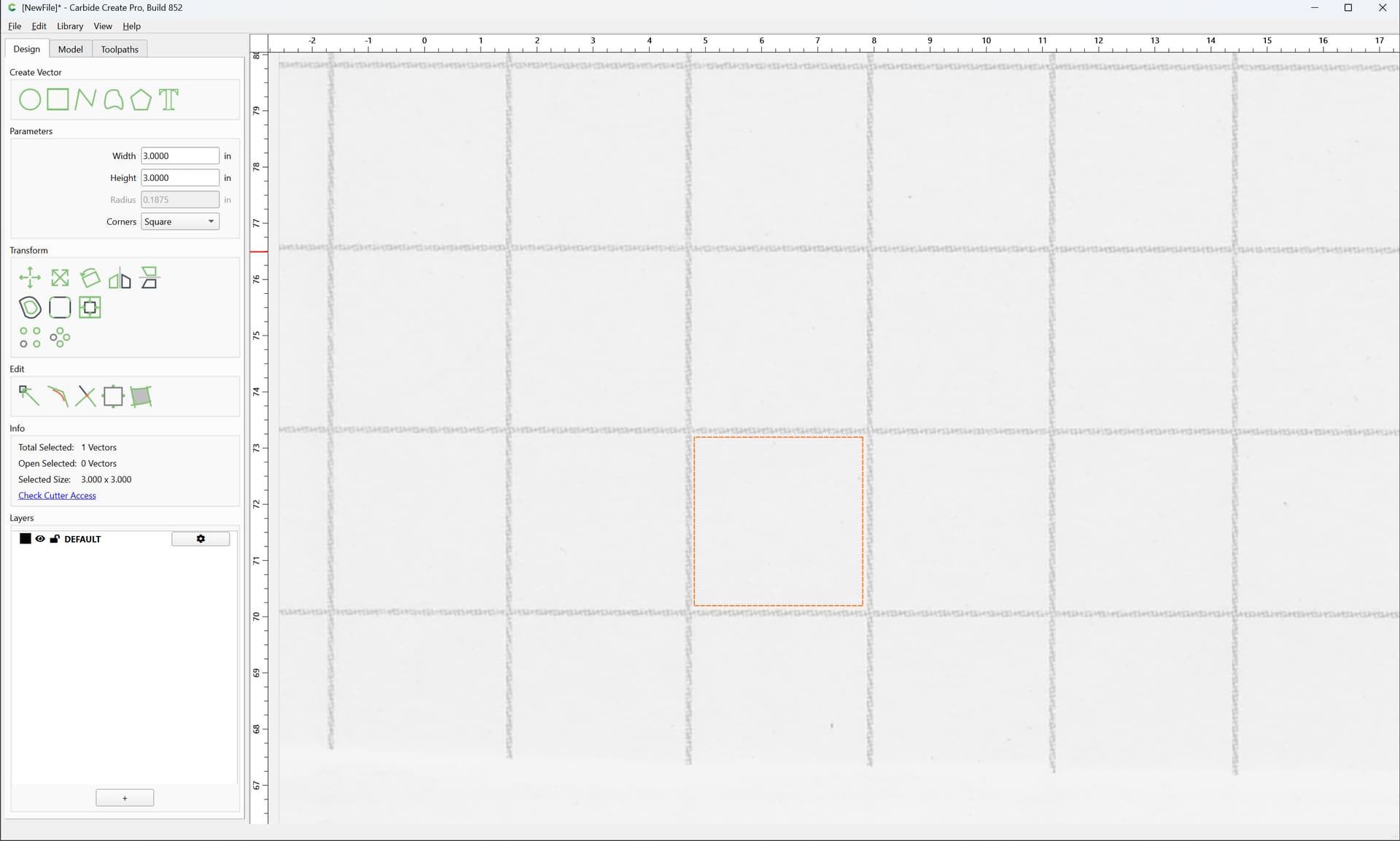

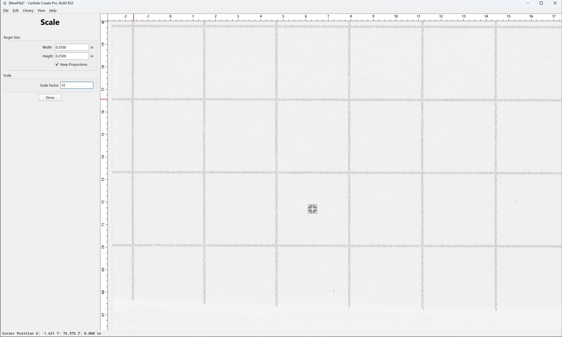

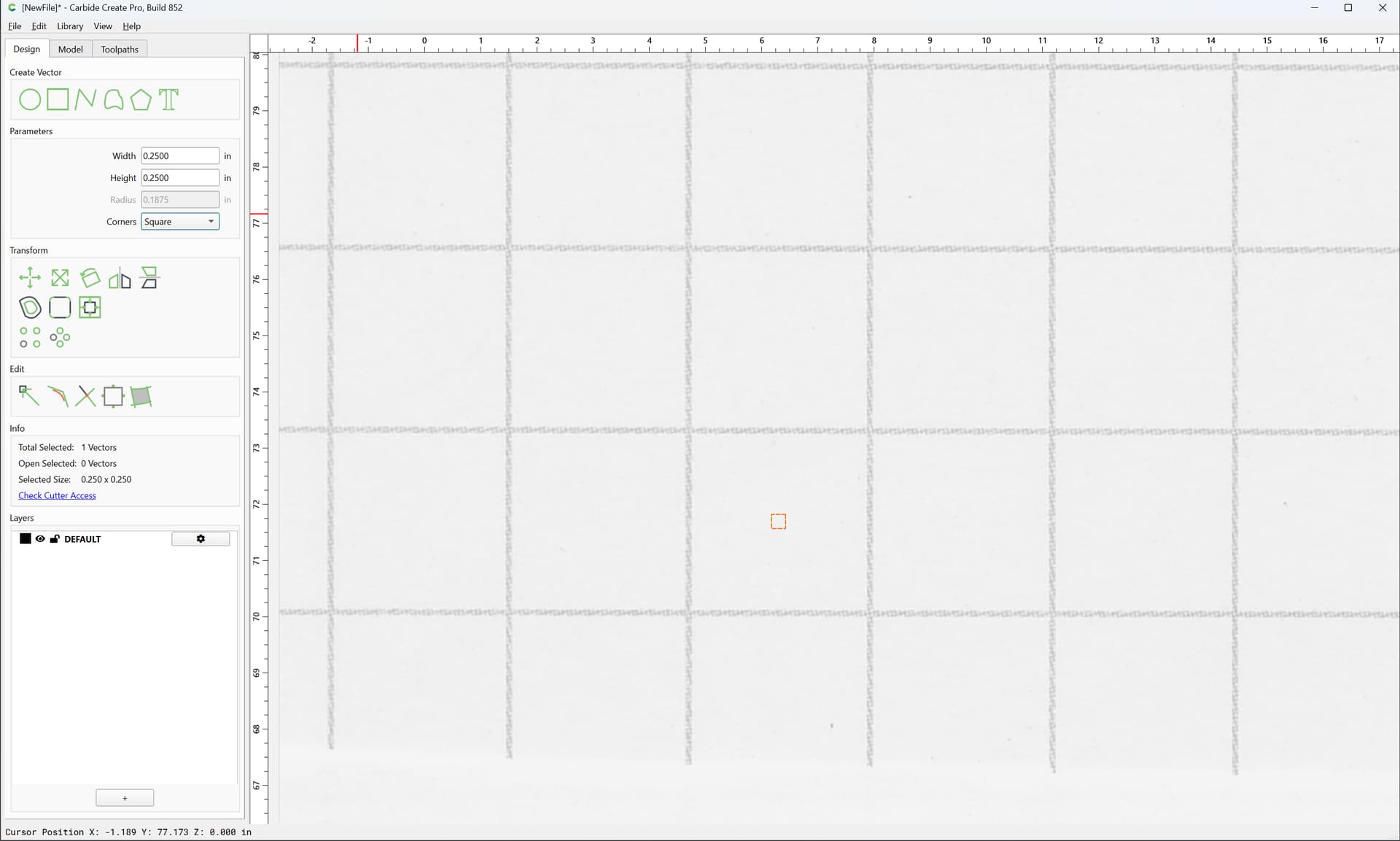

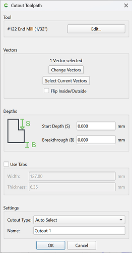

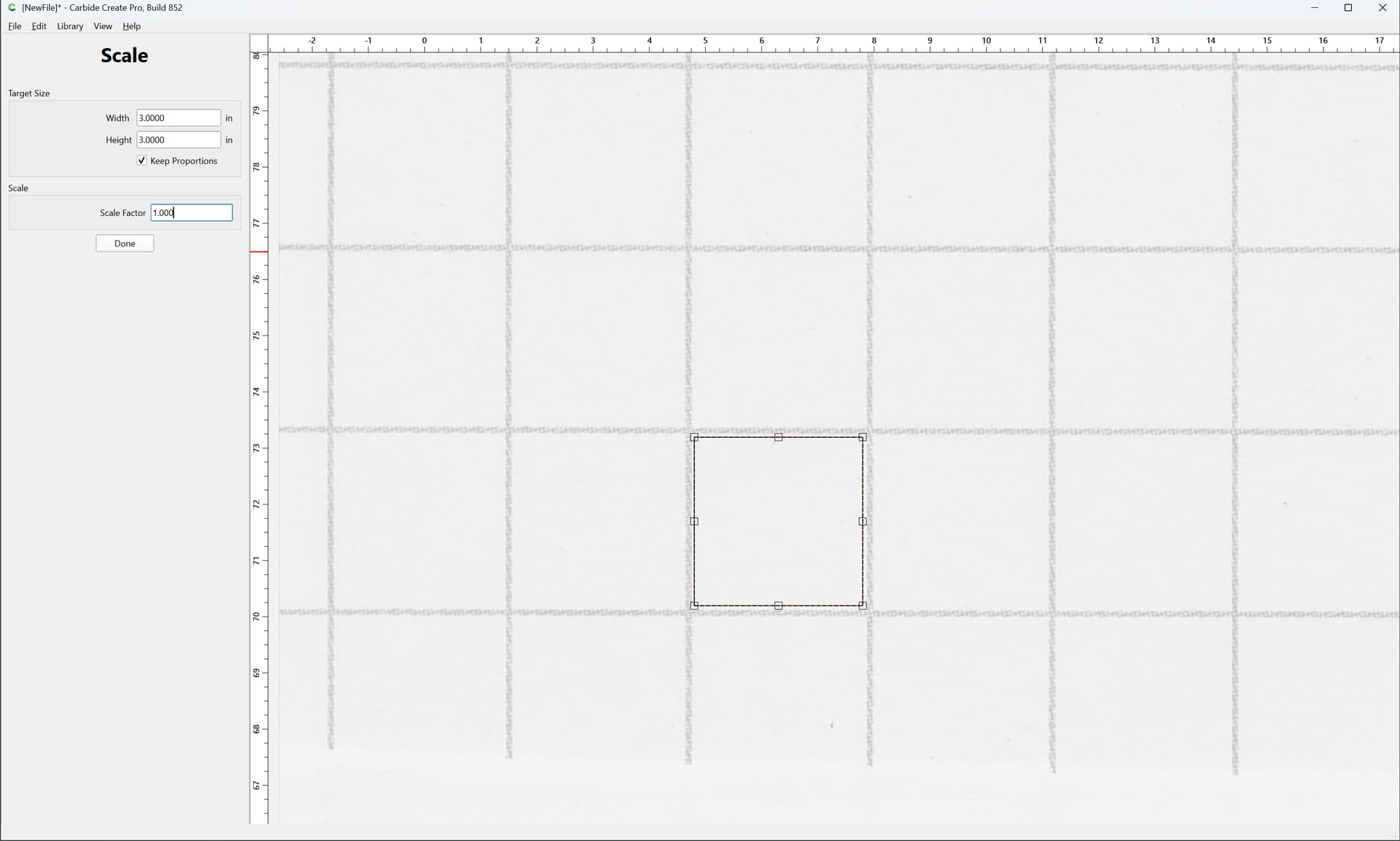

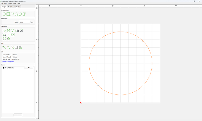

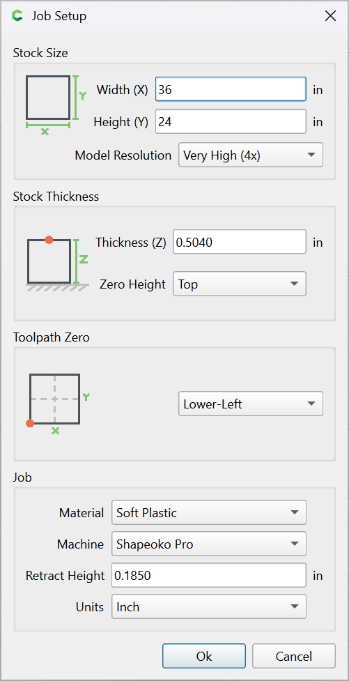

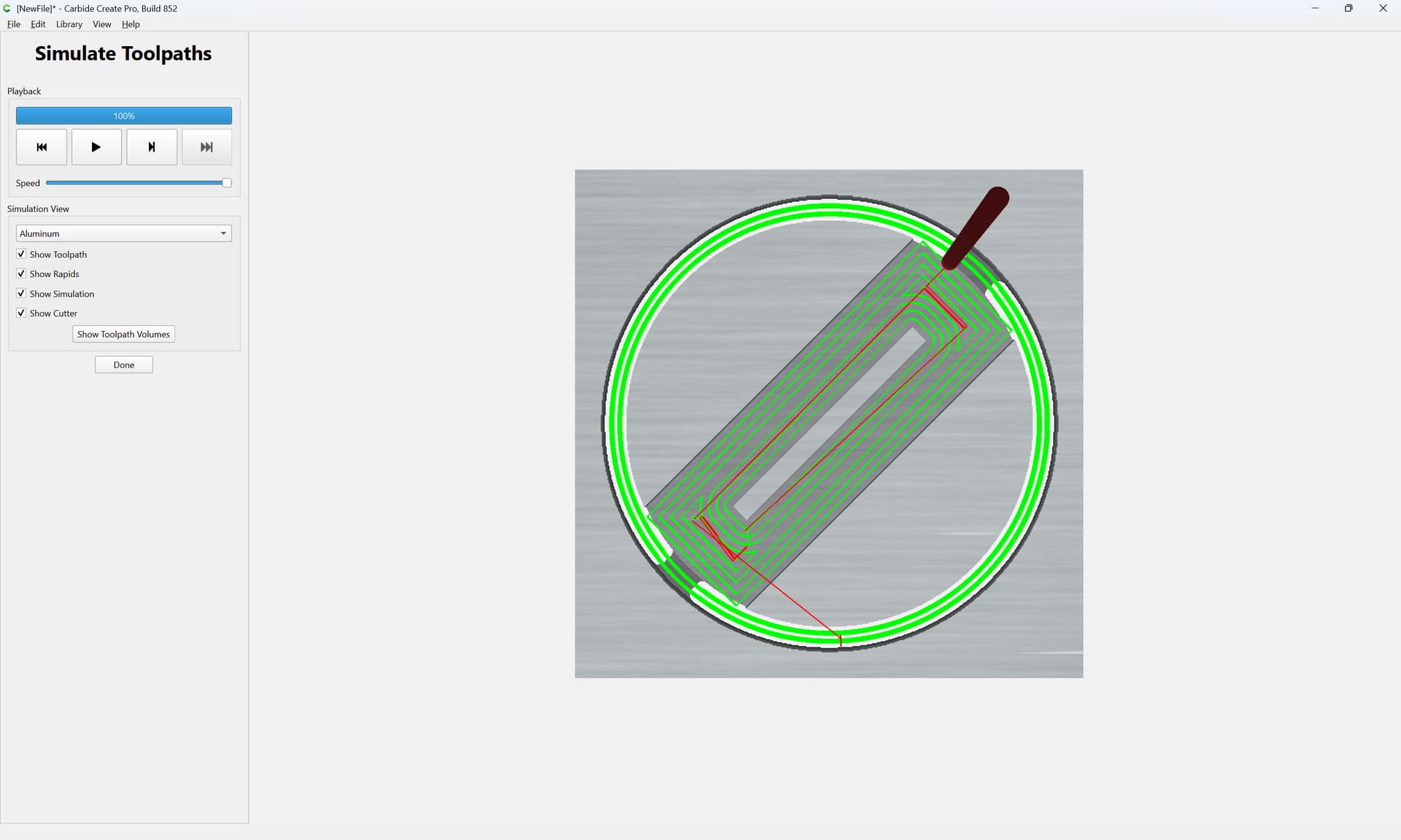

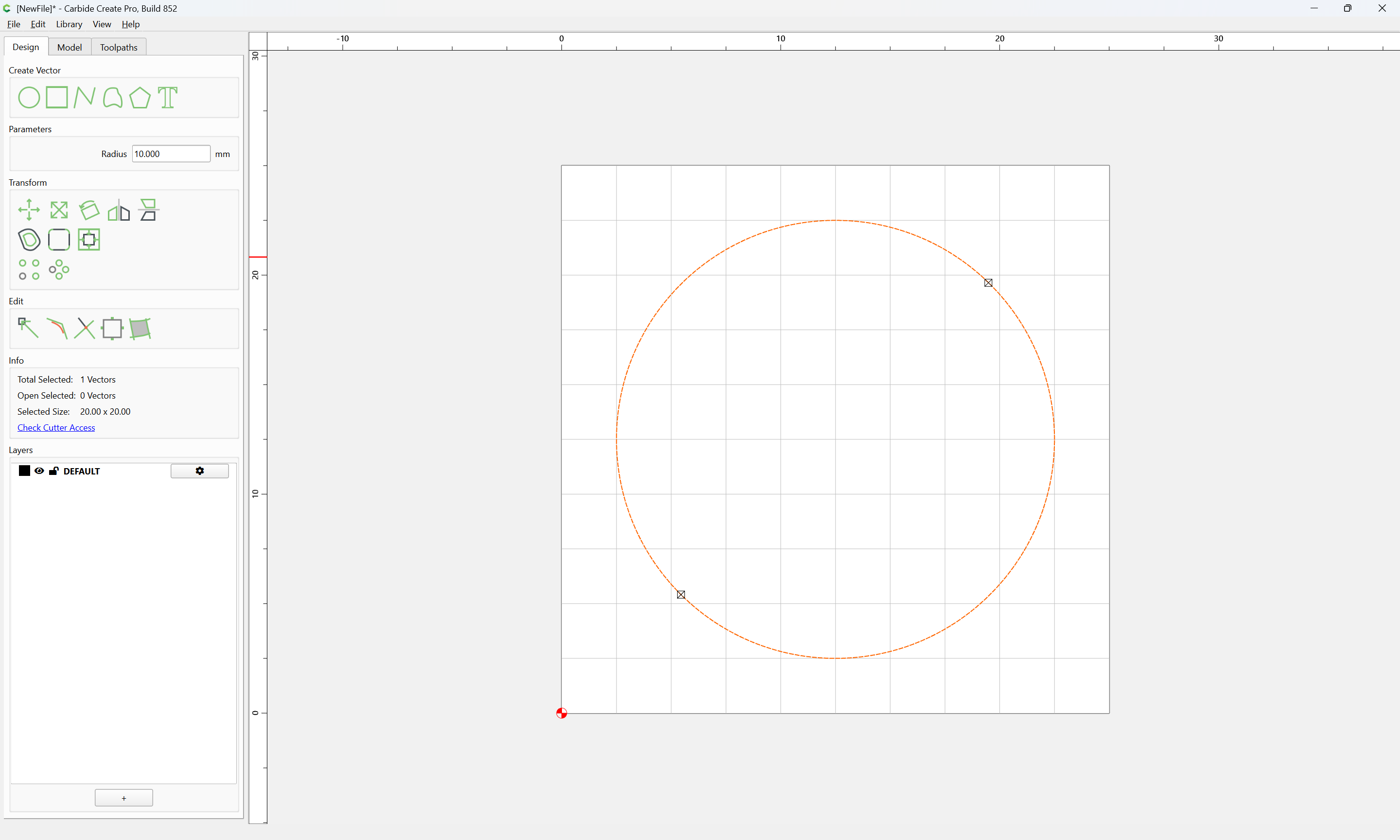

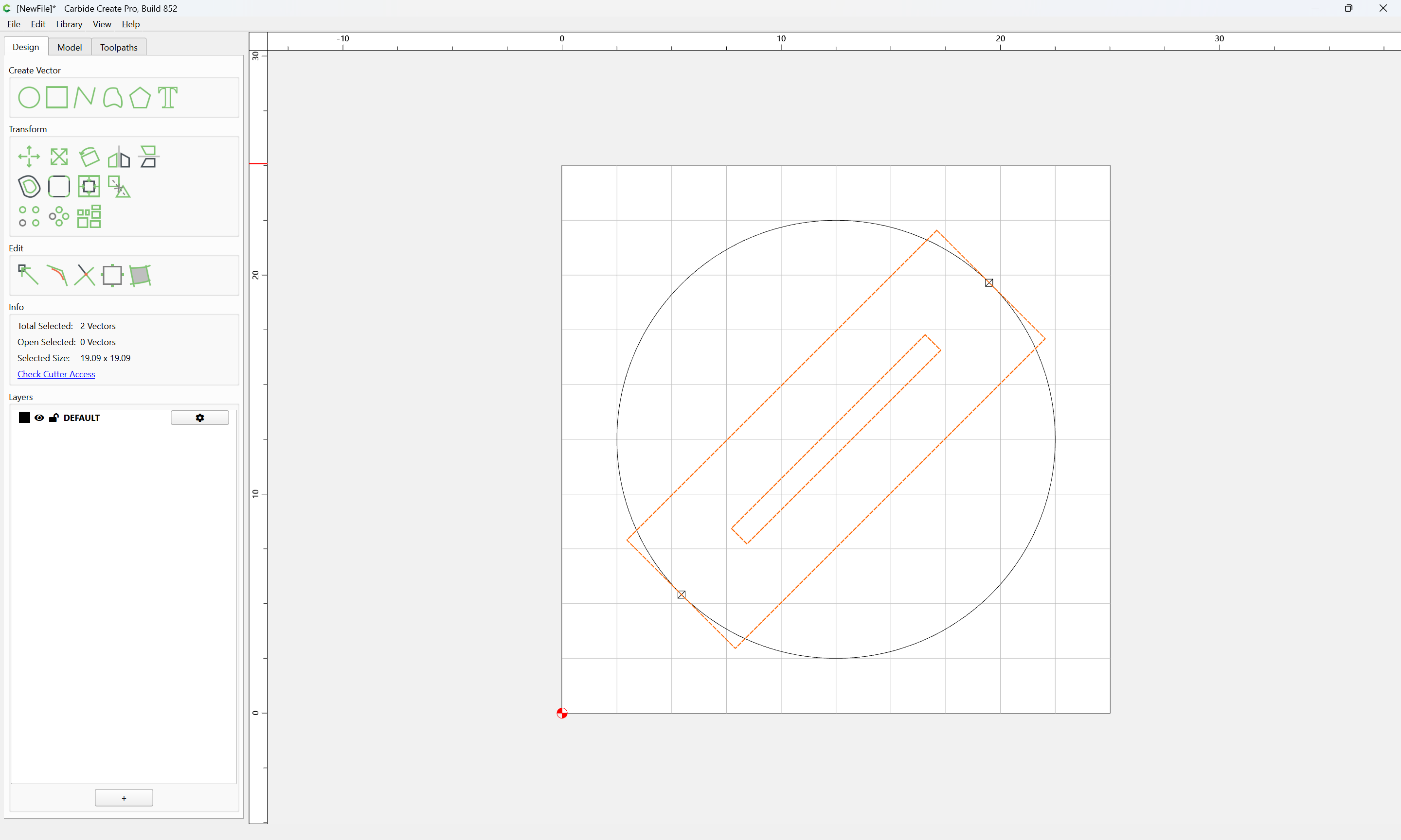

Made a small file:

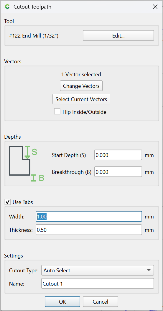

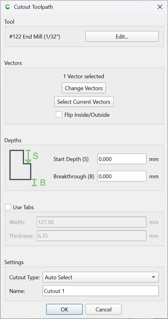

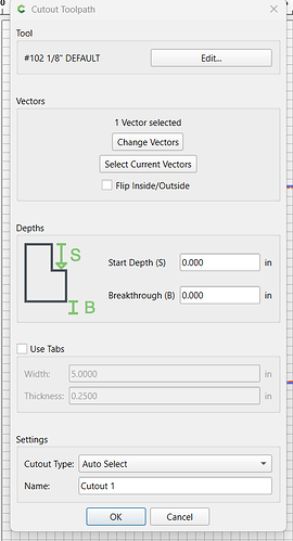

Made a Cutout toolpath with default parameters:

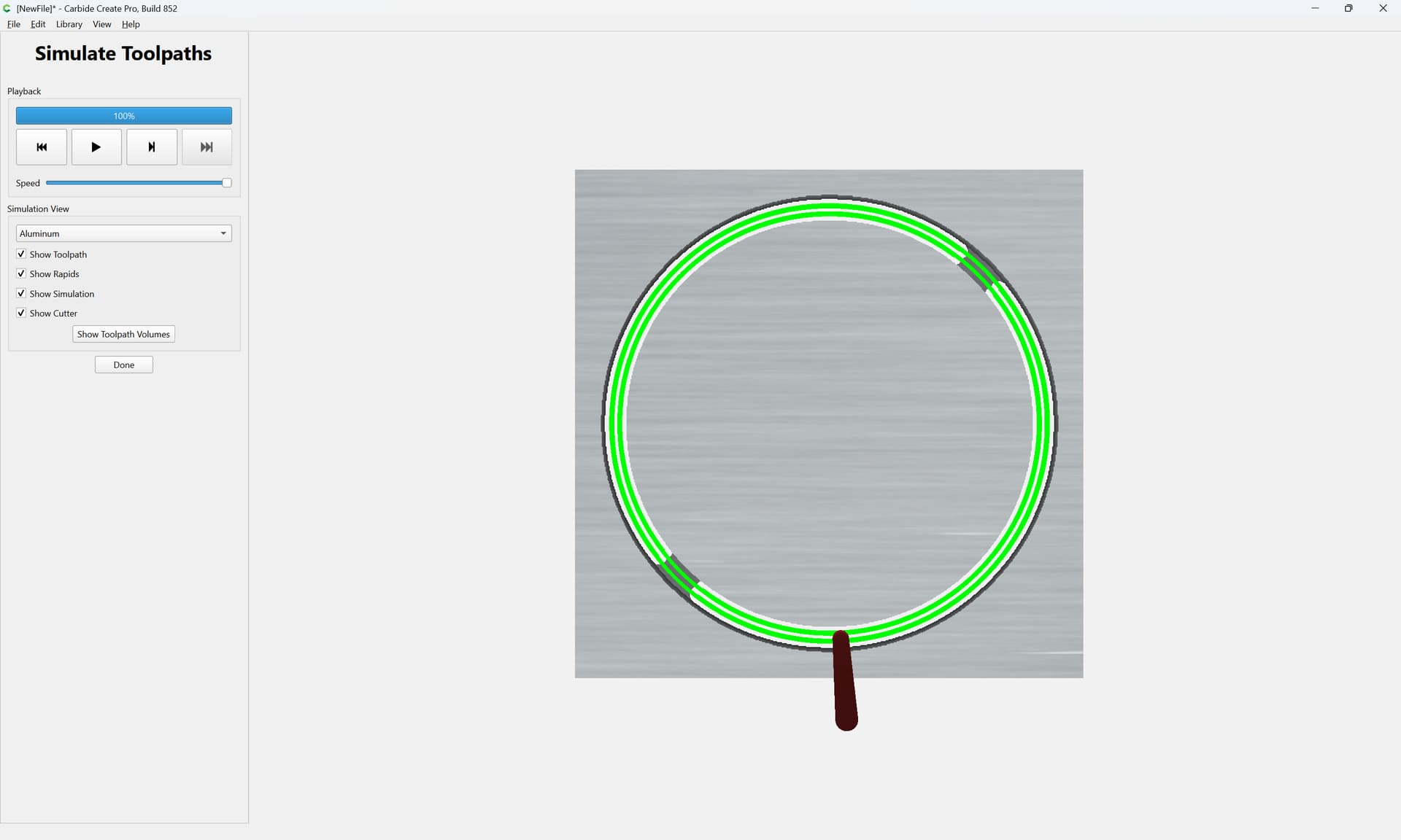

enabled tabs and set as described:

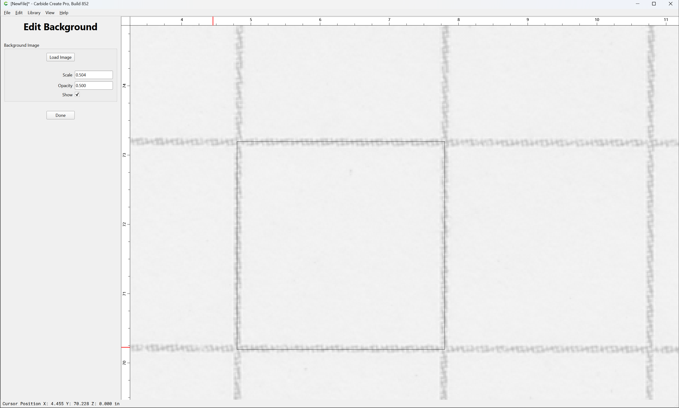

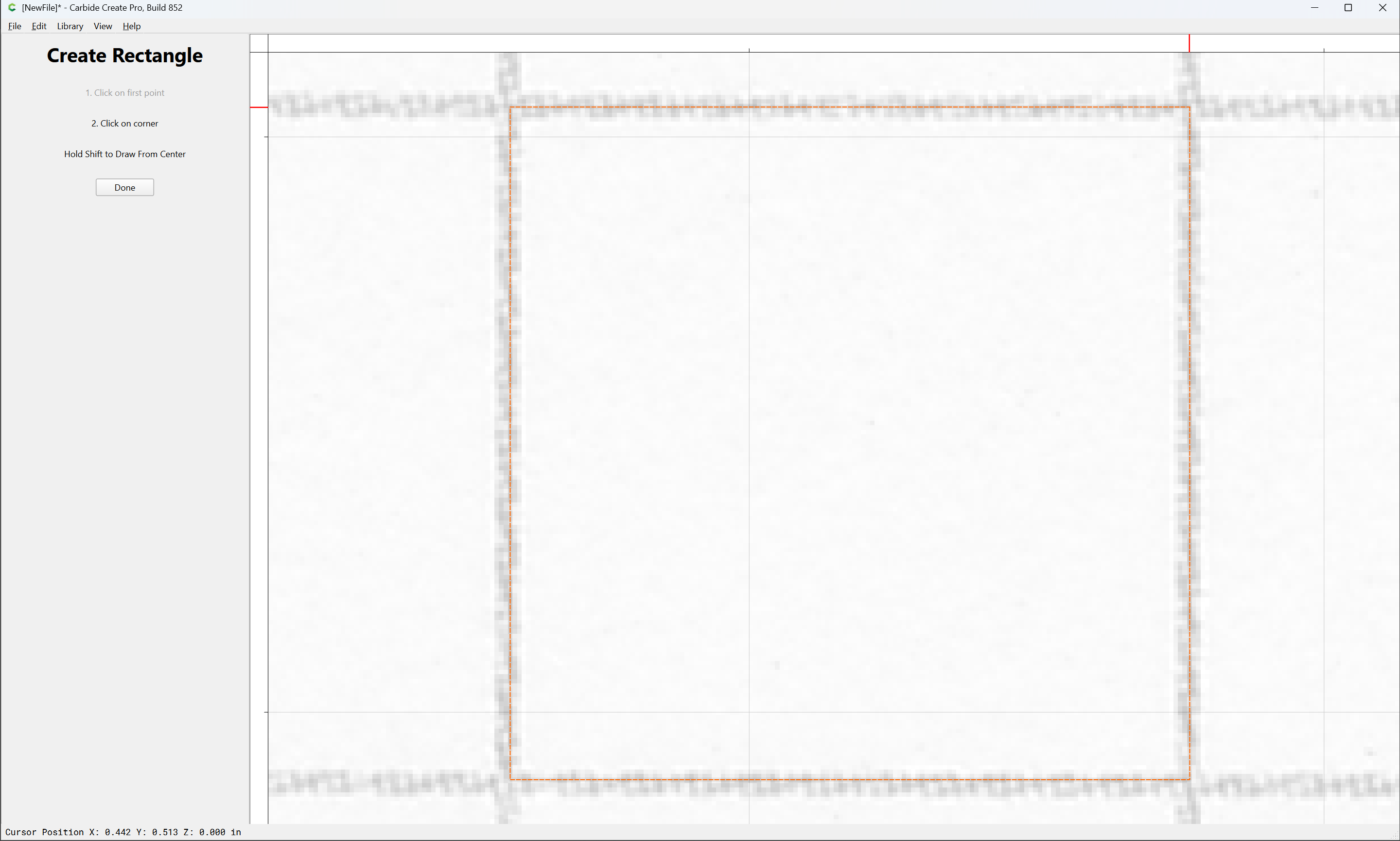

Drawing in a rectangle to check dimensions:
Looks like the min. tab width is 2mm or so.
Yea that’s what heppened me, I guess 2mm is the minimum😮‍💨
