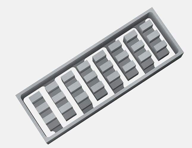

New way of doing box joints without vertical
…but with glue!! I figured the vertical holding is such a night mare that I would cut the box ends separately and glue them onto the sides. Here is the set of eight box ends.
Once dry, I will interlock the 4 sides as per usual. The workpiece is 1 inch thick and the tenons 1/2 inch long and 1/4 inch apart.
As I am using a 1/4 inch cutter, it produces these little end parts pretty quickly.
Follow this thread to see if it works!!

I am hoping to make the box joints visible rather than for strength purposes. Also, hoping to use standard 1/4 #201 end mill.

To get accurate workpiece thickness I planned to pocket the whole workpiece. In other words, I create a workpiece of 1.1 inches and then pocket away 0.1 inches. My question is whether I can specify the pocket depth referencing the bottom rather than the top? This way, if my workpiece was 1.2 inches I would still get 1 inch after the pocket is cut.

Are you now going to have to glue the long grain of those cut fingers to the end grain of the box sides? That may well be a somewhat weak joint. Looks like the pieces are small enough that differential expansion should be minimal though.

Yes correct but my feeling is that the strength won’t be an issue because the box base will be slotted in. I may be wrong!
