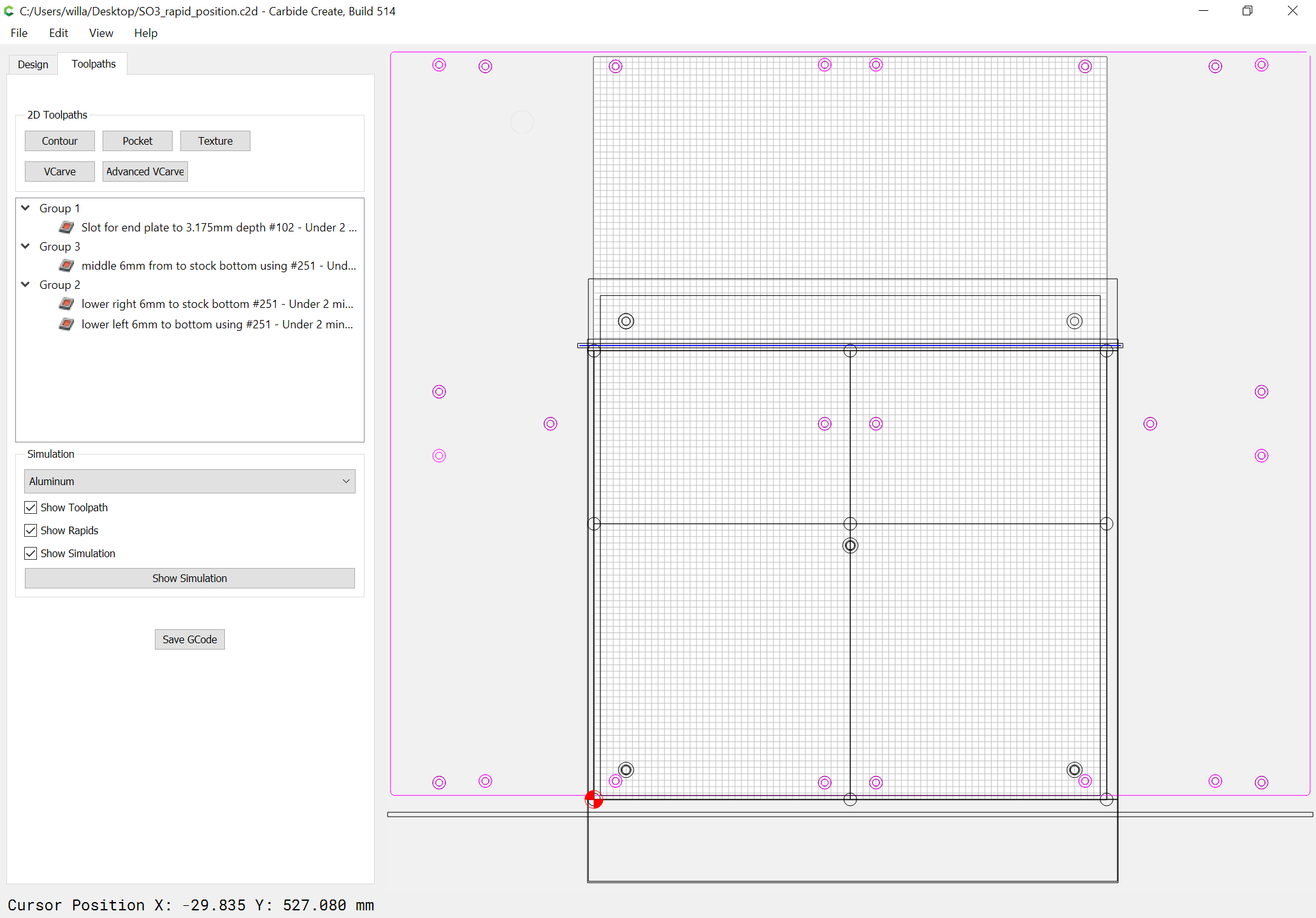

and simplify and rotate it and set the stock size to match the rapid position points:
Now we move the machine to determine the location of each MDF filler strip, and position copies of the MDF filler strip graphic appropriately — the easiest/most accurate way to do this is to put CM into machine coordinate position by clicking on “Position” which then shows the origin as being X -855, Y-780 (there are tiny decimals due to the calibration for belt stretch which we are ignoring)
We then probe for each MDF filler strip origin using a probing pin and a BitZero v1: X -811.26 Y -830.618 for the first one:
and we repeat for each and make a layer to put them on:
and make a layer for the rapid position points as well as the BitSetter:
