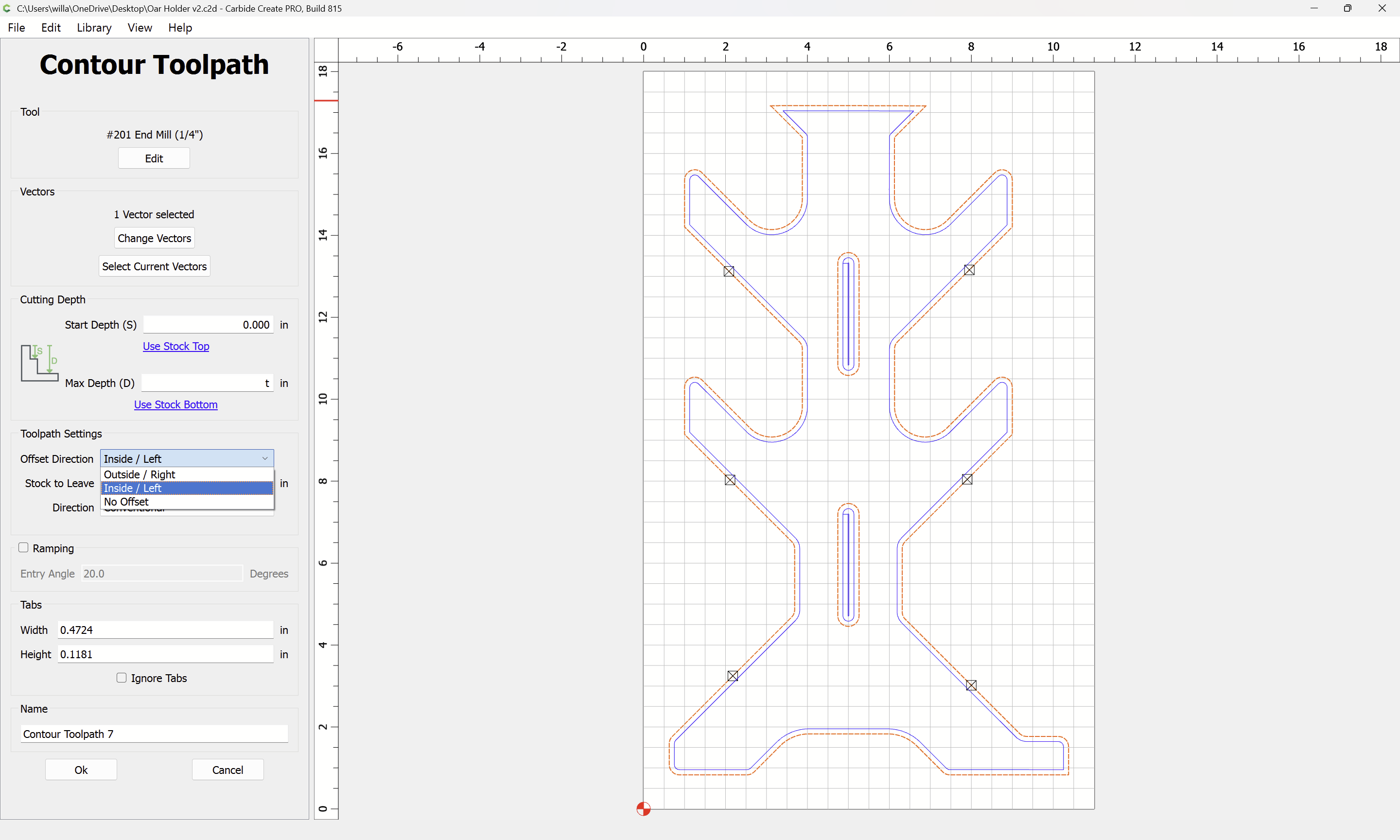

You chose “Inside/Right”.
Try “Outside/Left”
That said, also offset by tool diameter plus 10% and cut as a pocket down to tab height:
Where possible avoid slotting and add geometry and cut as a pocket
and/or
