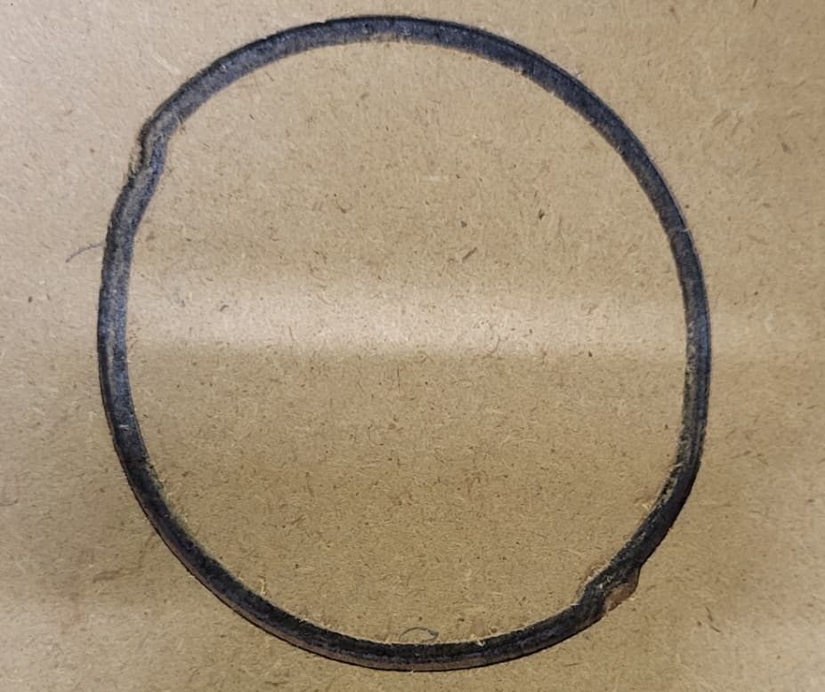

I am getting some strange results trying to cut a simple circle. I have tried everything I can think of including making a whole new file. When cutting the circle the router head is moving out at three different spots during the cut. Each slightly more or less pronounced. I have attached a pic. I have run the job a few times shrinking the circle a little but so there are two attempts show here both the with same strange bump.

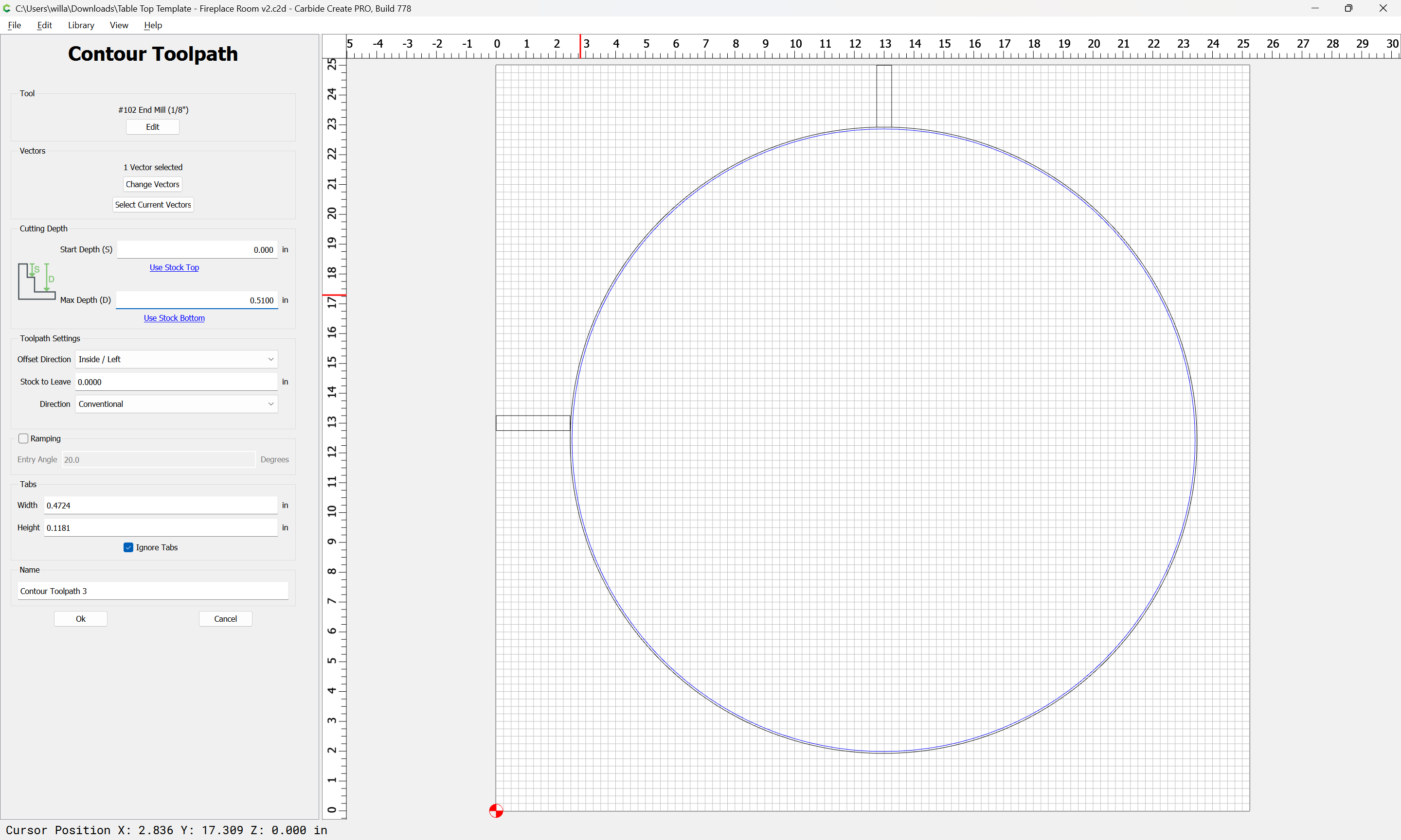

Anyone have any suggestions? I have attached the file I am currently using as a reference.
Table Top Template - Fireplace Room v2.c2d (52 KB)
You’re cutting a 1/2" deep groove with a 1/8" tool. Good chance it’s binding in the slot.
Try making a 3/16" wide slot & using a pocket path.
If I start it above the material so the bit is contacting nothing I can see the head move over. Its also doing it in 3 spots consistently so I dont think anything is binding.
With the power on and the spindle OFF, grab the nose of the spindle and try to move it around. Don’t push so hard that you over-power the stepper motors.
It should be locked in place. If it moves at all, you have mechanical problems.
Where possible avoid slotting and add geometry and cut as a pocket
and/or
With the machine on and the spindle off I cannot move anything.

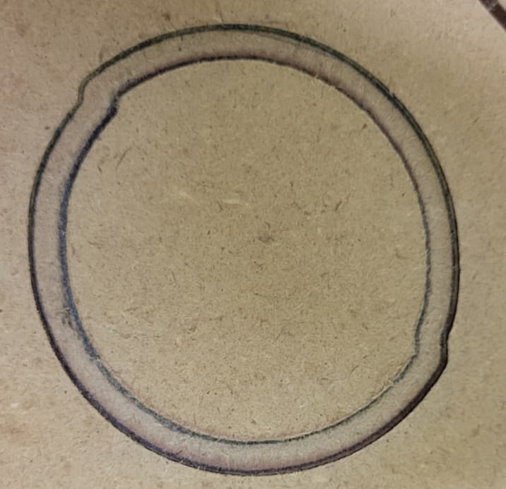

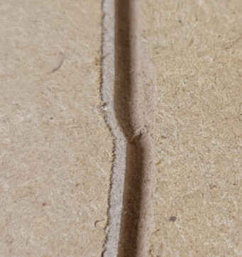

I ran a new job with a much smaller circle and the problem is much easier to see. I took a pencil and colored in the groove so it was visible on this mdf.
On this little 1.6 inch radius circle this makes the problem look more mechanical whereas on the big 20 inch circle its so consistent where the head makes a move it seems more like a software problem. I only went .1 inches deep with this one.

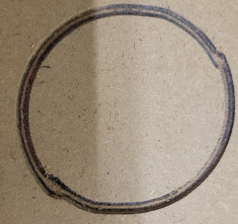

Ok, this is even more perplexing. I changed the size of the circle to 1.25 and moved to the far opposite corner of the machine. Reran it and I get basically the same shape.
I ran it again in another corner (20+ inches away each time) with a 1/4 inch bit
Same shape
Then I reran this same one but put it back to a 1/8th inch bit. It barely even altered my pencil lines and didnt change the shape of either the inner or outer portion of the ring at all. I would think if it was mechanical that the “wobble” or whatever causing it would be at a differing radius/angle with a bit 1/2 the size. I am guessing but this really seems to me like the software is not cutting a proper circle.

There is nothing wrong with your file. This is 100% a mechanical issue with the machine. Can you share more details about your machine, its age, and what parts of the machine you’ve inspected so far so we can help you narrow your search?

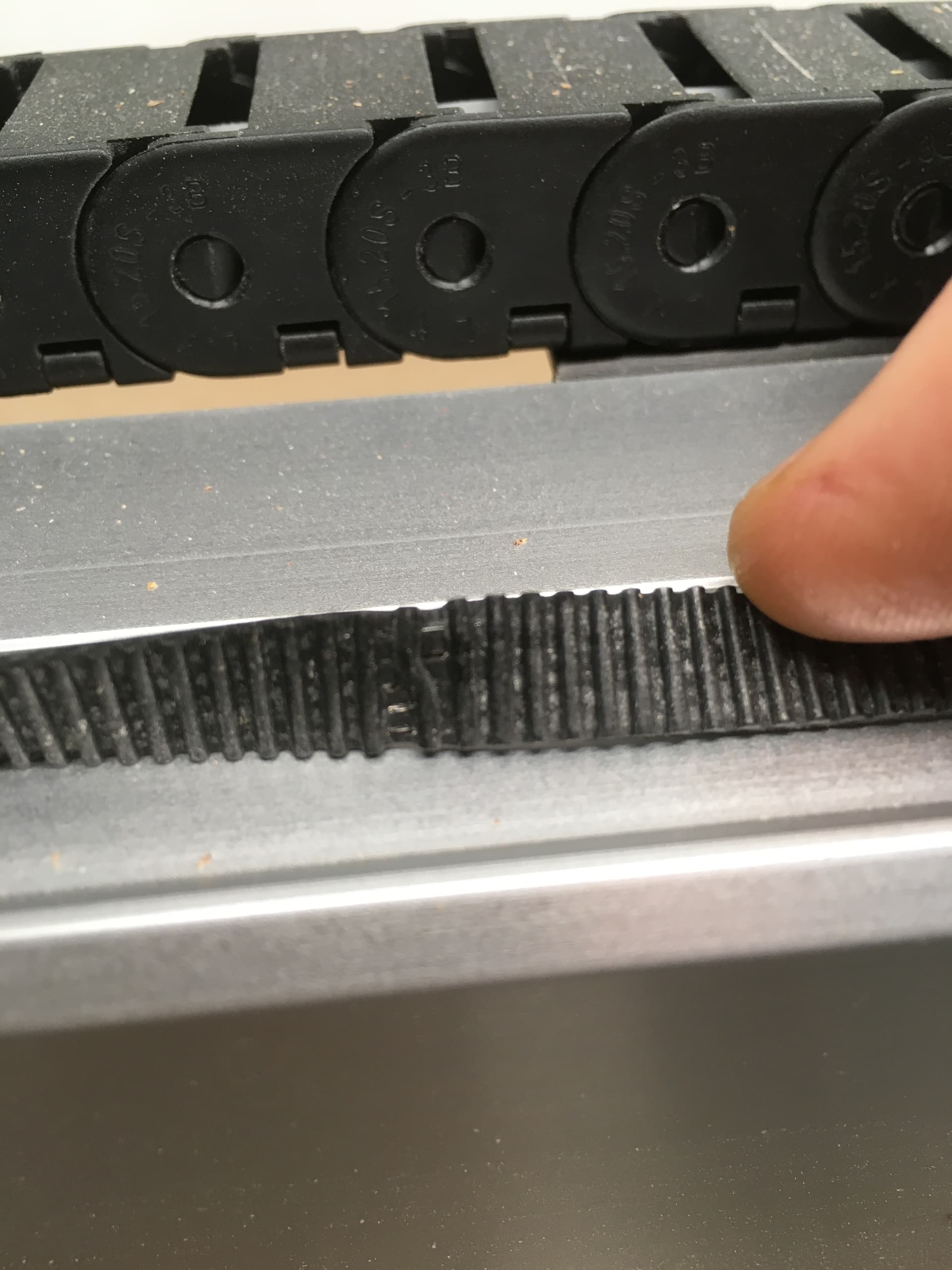

Another things to check: Flip the drive belts over. Sometimes the fiberglass reinforcement will give out over time and the belt will stretch, creating points where the teeth will skip. (This is in addition to just making sure the belts are tight…)

Just for reference, this is what belt stretch looks like…

Sorry this took a few hours because I was bouncing between work and messing with this machine but, I do seem to be at least 99% resolved. Not sure which part fixed it (probably a little of everything) but I did just about everything that was suggested in this thread. I took off cleaned and reversed my belts, cleaned and lubricated all the rails, and took the head off and lubricated the fill holes on the top and bottom bearings. I also took the gear off the end of the stepper motors and did find one of them that had this set pin misaligned from the flat of the shaft.
I say I am 99% resolved because now my circle is 1000x better but there is still a little bit of wobble in two spots. I ordered new belts which will take a few days to get here but I am feeling like they will finish fixing things. I didn’t see anything wrong with the teeth but there is a spot on both of them where it looks a little funny. I think its from when I left it sit for a couple months. There is also a few strands coming off the sides of one of the belts so its likely swapping them will mop this up.
