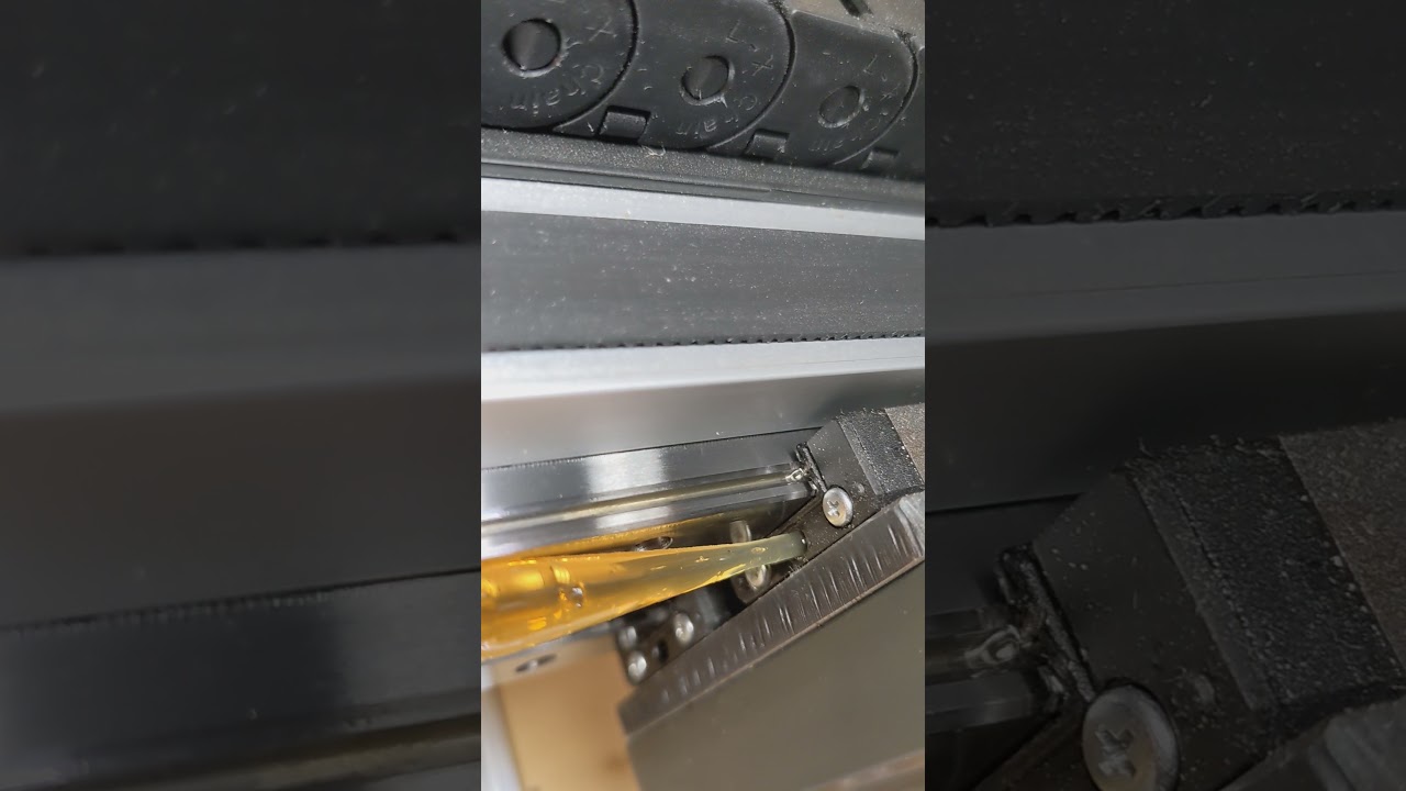

After posting I came to realize that on the X and Y axis there is no réservoir, but on mine I do have sides holes and somehow they allowed me to efficiently oil the rails and blocks, like so (I overdo it in that video)
That said, I don’t know if all machines have similar blocks, and it seems like I have been doing this naively and it’s not really intended to do this? I don’t know, but I’m a simple man, I know it works for me, I do it :slight_smile:

Interesting. Several of my linear rail blocks have those holes filled with stuff (silicon, rubber plug, random set screw, etc), which is oddly inconsistent. Some of them are wide open like yours. It is an area of concern for me as many times using the non-aggressive CC hardwood profiles I get skipped steps and/or random X or Y offsets mid-tool path. Small “Jolts” can be felt when moving the axis by hand with the stepper disconnected from the mainboard, and an occasional bind. I don’t know how to replicate/demonstrate it any better for support, so have been scrapping around 15-20% of my projects.
The linear rail blocks have a series of port options on them when manufactured, typically one is open inside and comes with the small bolt plugging it. That’s the one you want to oil through ideally.
Some of the other threaded holes, the ones with a blind end are also options for oiling but need to be opened up in order to use them.
