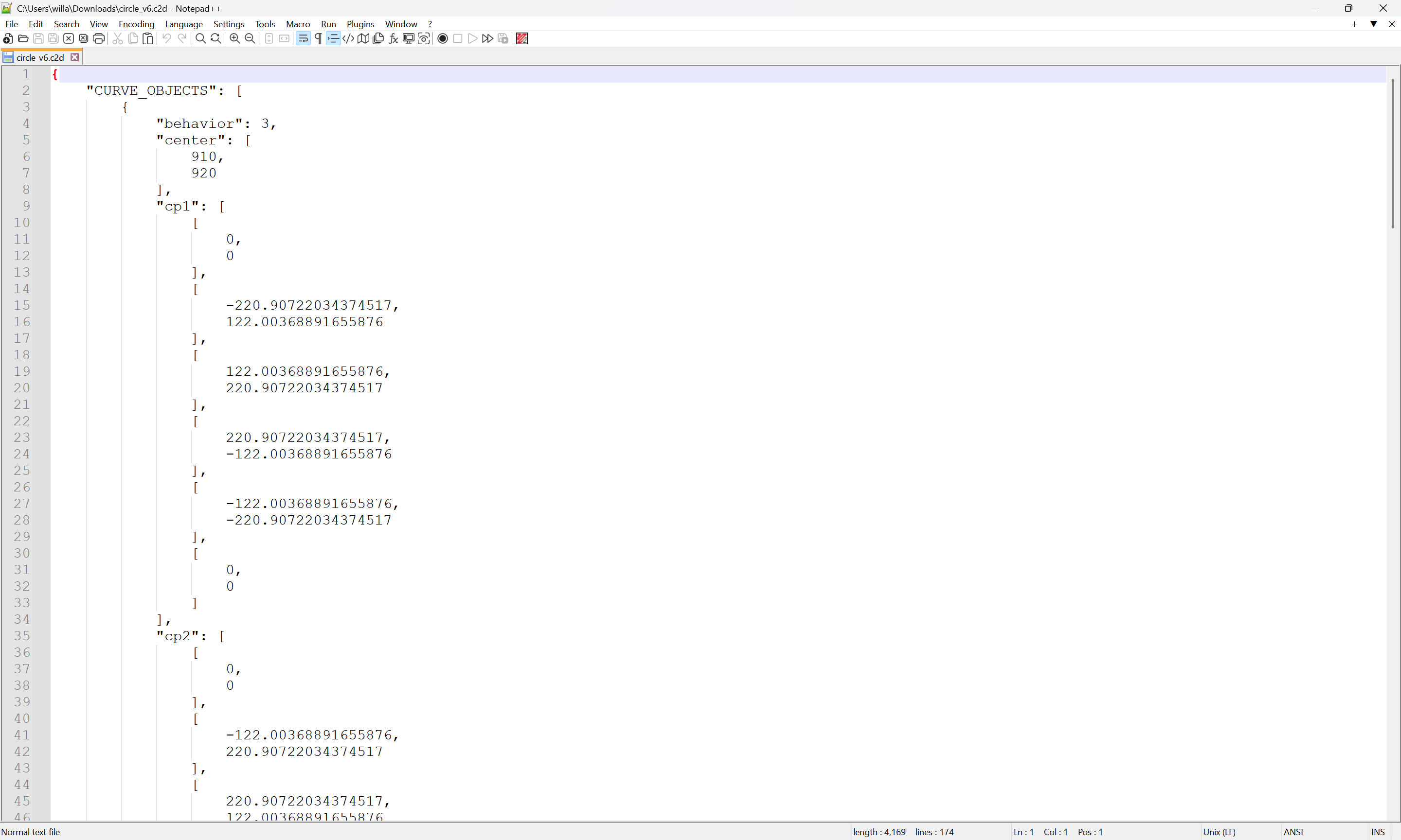

You can check them in a text editor — if they are JSON code, then they are v6.
Or, just open in v7, resave w _v7 added to the filename, then open that file in v8.

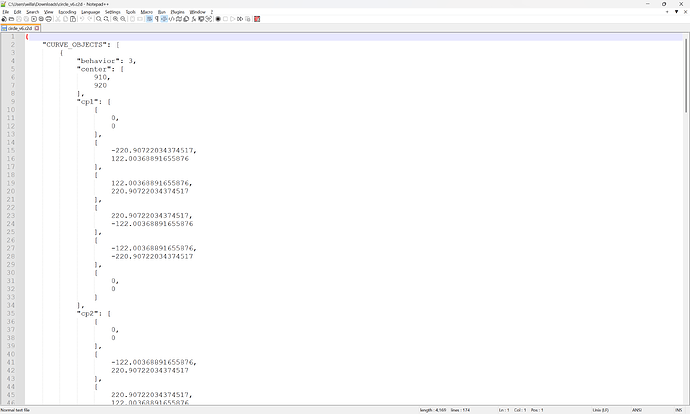

ok, I got one open in Notepad, whats a good Find/Search I could use to see the version? I already tried “version” and nothing came up
If it looks like:
it’s v6 or earlier.
The line to look for is something like to:
        "build_num": 652,
Looks like this

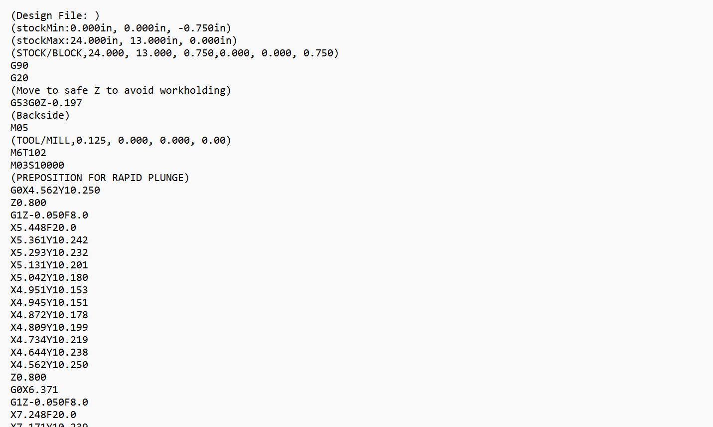

That’s a GCode file, not a CC project file.
interesting. All I did was right click on the NC file and chose to open with Notepad, so I’m not sure what’s going on, but it was definitely saves and created with CC and CM as that’s all I’ve ever had lol
Ok I found this in a file “build_num”: 464 super old huh?
