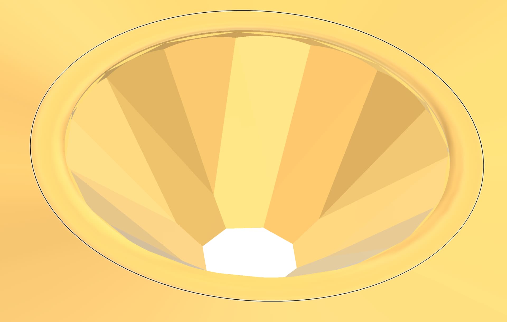

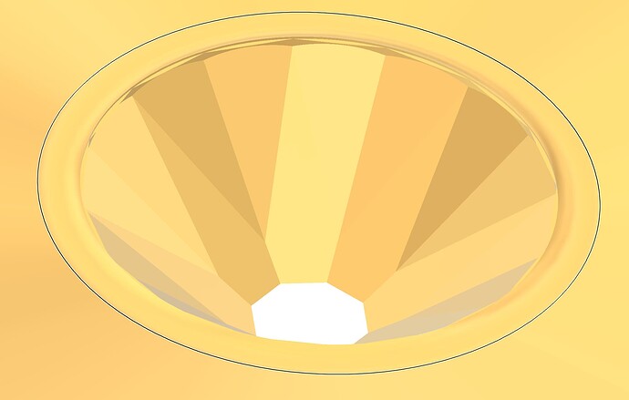

First off, the gem is a solid body model which was combined/cut from the solid token. This leaves a bunch of facets and such that will probably get annoying when it comes to generating the Toolpaths:

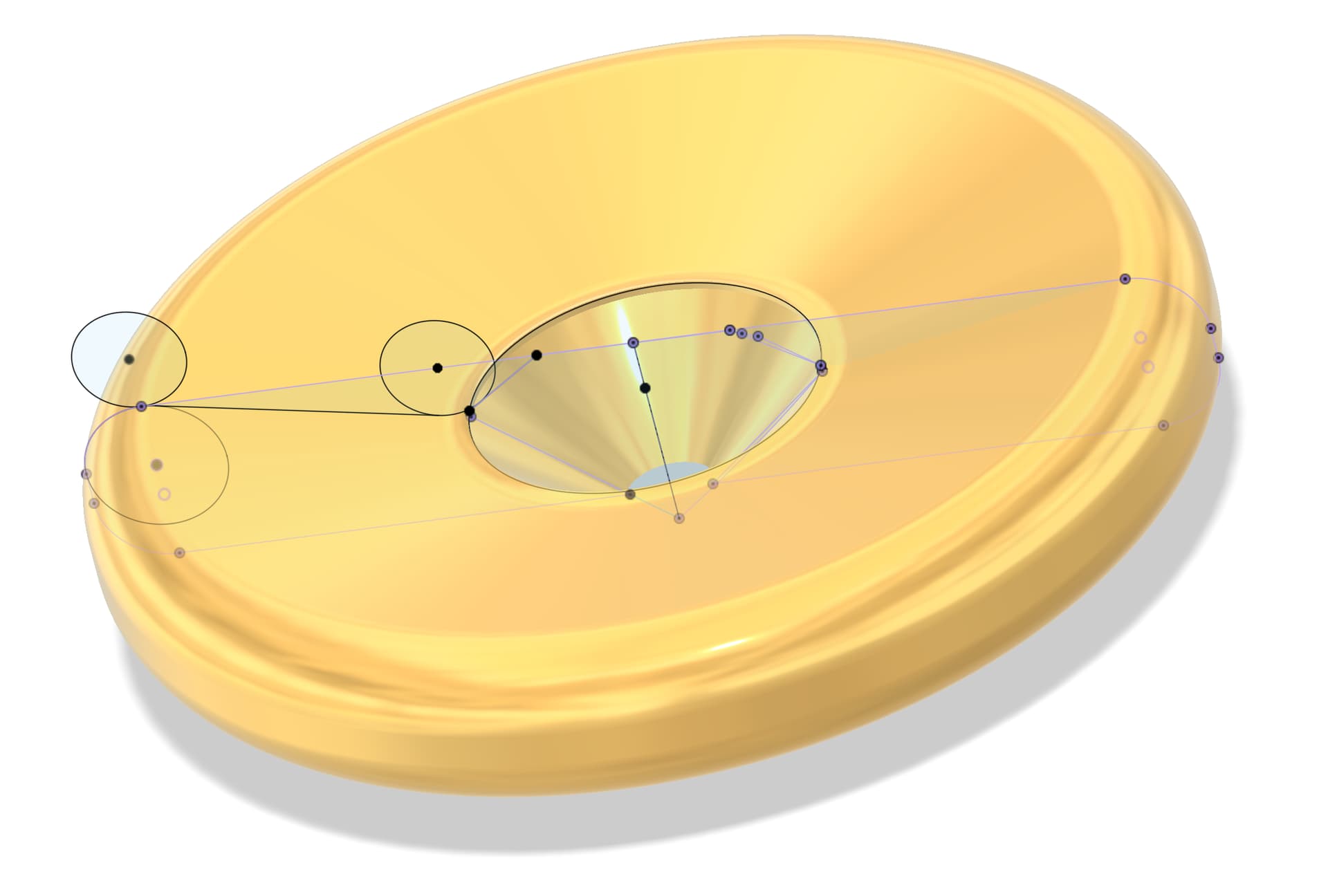

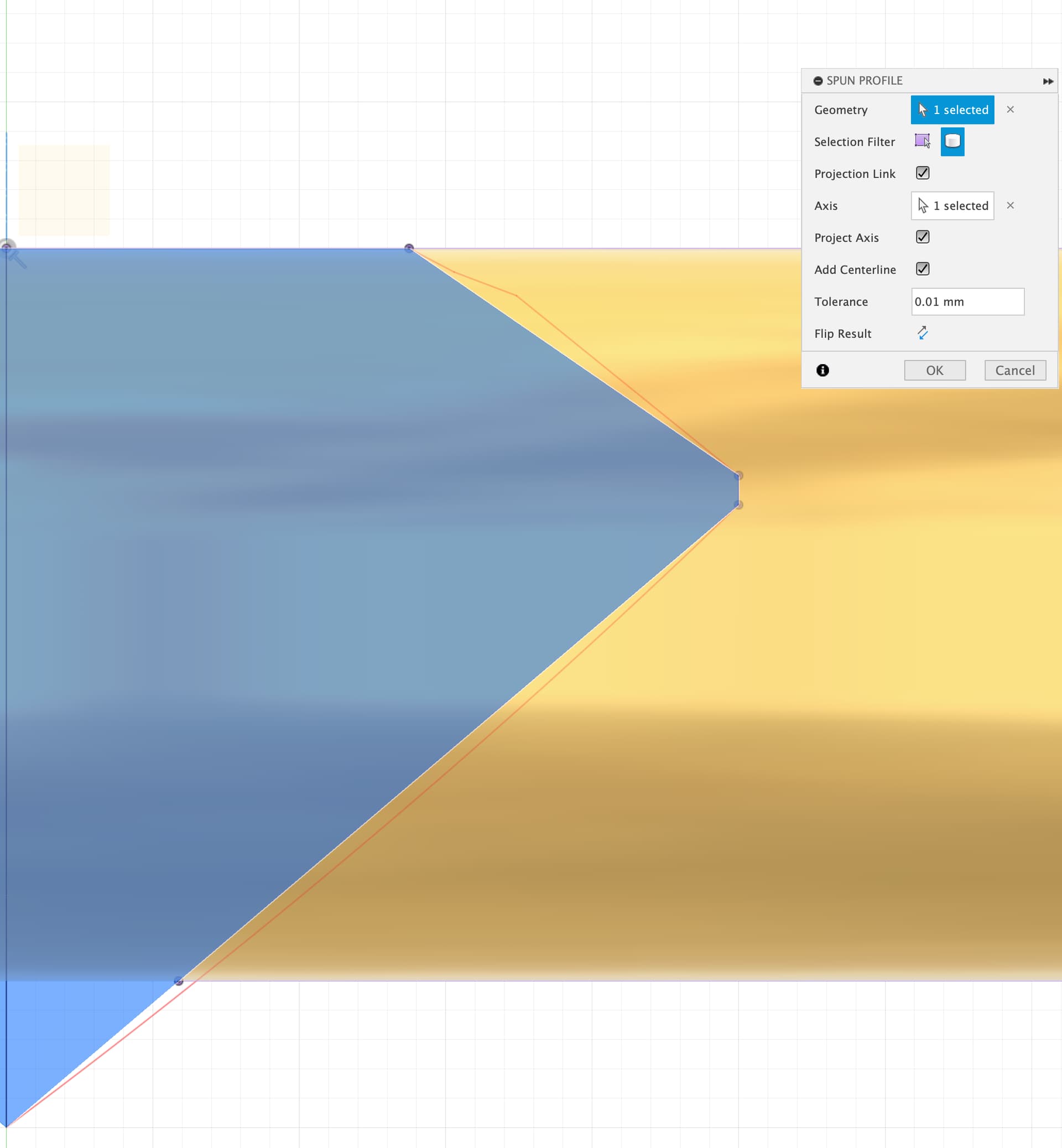

A super easy way to deal with this would be to revolve the solid body of the gem, cutting away a cone that very nearly matches the outer bounds of the gem. Toolpaths like nice smooth sides/cones much more than facetted cones…unfortunately fusion has only added solid sweeps (which is awesome for dragging a tool through a solid to see how it turns out!) but they haven’t added solid body revolves as far as I can tell.

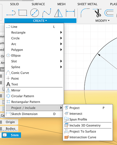

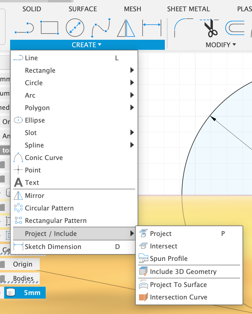

That said, they do allow a similar enough option via sketches using the “spun profile” projection:
This allows you select a body and spin it about an axis, projecting the bounds of the solid. This creates a profile we can then revolve to cut away from the token. Exactly what we’re looking to for!
Now that’s a much better looking surface and the difference of a few fractions of a mm won’t matter all that much. We’re doing an pseudo-functional aesthetic part here, not rocket science or whatever @RichCournoyer does (oh, actually that is rocket science :sweat_smile:)

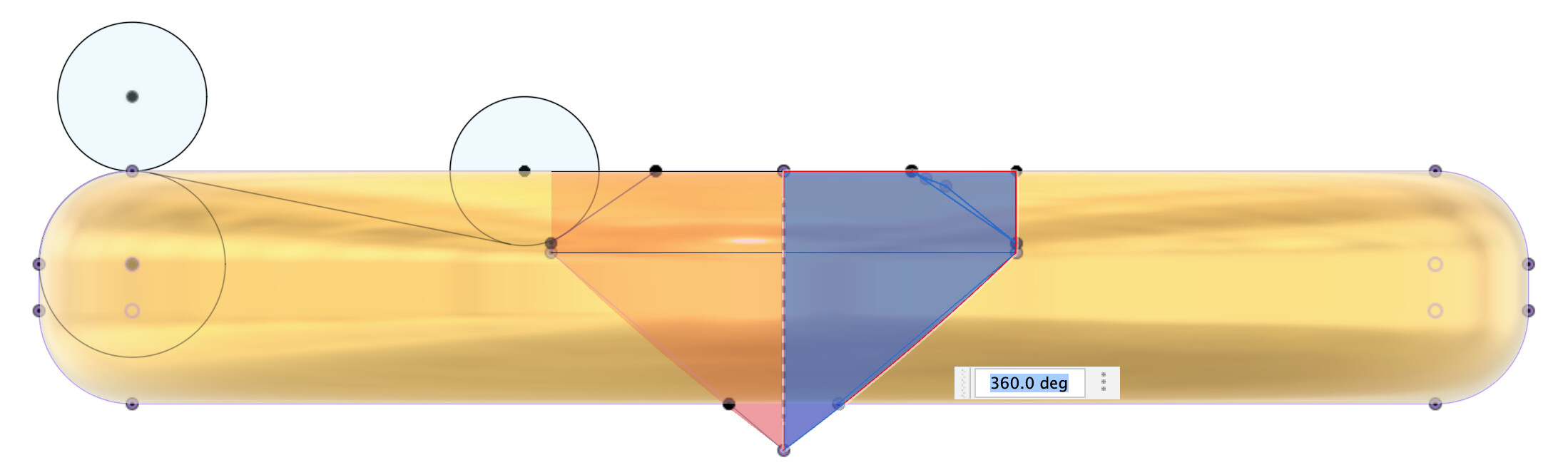

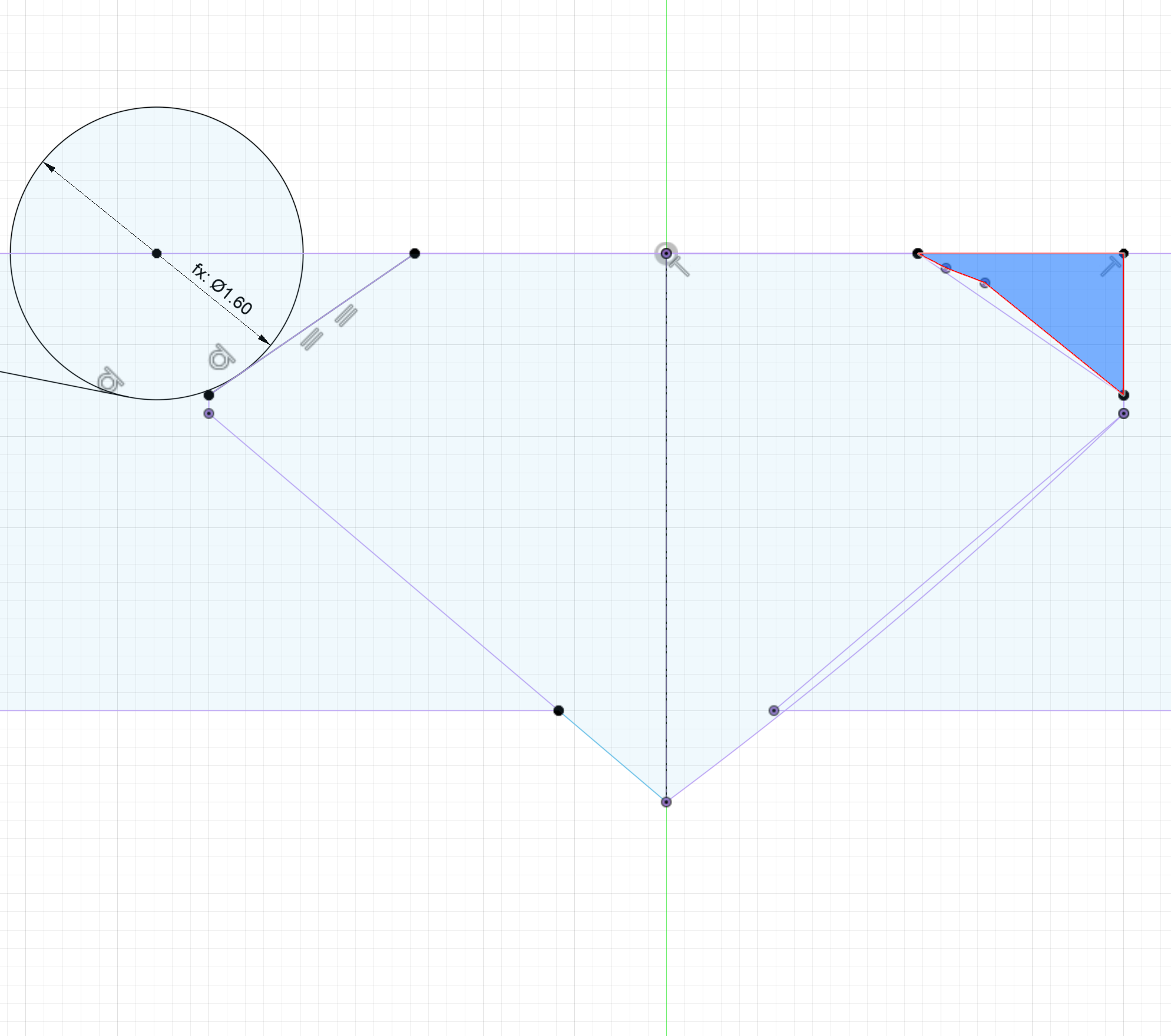

There is still the slightest bit of faceting around the top of the gem seat. Let’s hop back into the sketch and add a bit of a cheat profile we can add to the revolve to clear all of the material:
Much better:
