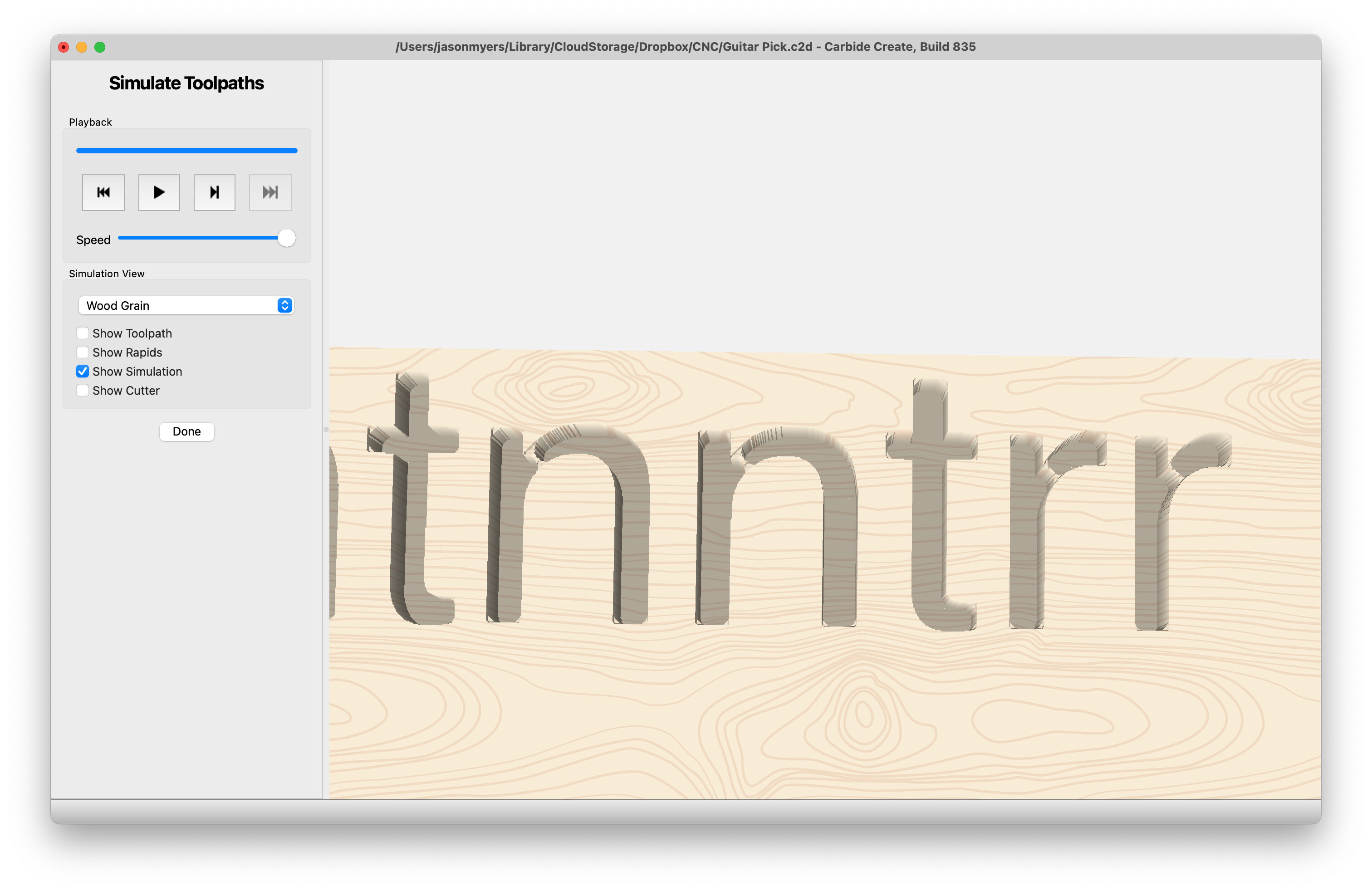

I’m curious about optimizing toolpaths. For instance, assume you want to create a pocket cut for a sans serif font. Given the size of the project you can use a 1/8" bit for most of the cut. However, there are certain letters that don’t cut cleanly.
The obvious solutions to me are:
  1. Choose a smaller bit
  2. Use two toolpath operations - the first to cut out the bulk of the pocket with a larger bit, and then a second to get the details with a smaller bit.
Option 1 has it’s drawbacks - long cut time, higher potential to wear out/break a bit
Option 2, if optimized should be more efficient, but the second toolpath ultimately goes over the area that’s already been cut, when it only needs to hit the parts, typically around the edges of the pocket, to finalize the shape. My issue is that I’m not sure how to structure option 2 for optimal cut time. One hypothesis: have toolpath 1 as a pocket cut with a larger bit, and then for toolpath 2 use a smaller bit and a contour cut with the inside offset? However, this doesn’t yield clean results.
You can see here that the “n” and “r” have material left where the curve and straight sections meet. The corners aren’t square either.

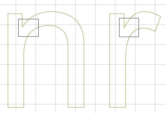

Hi Jason, I like Will’s solution as all is in one nice toolpath.
I use the following technique to create rest pocketing in carbide create as follows.
  1. Save your file as a different name so you have your original tucked away. This process will remove a lot of the text.
  2. On your renamed file look at your simulation and identify where your tool has not been able to pocket the shape. Go back to your design and draw a shape that overlaps the regions you have identified.

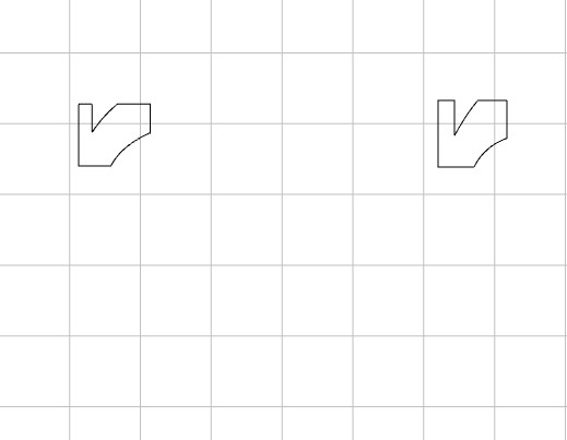

  3. Select one letter and the shape you drew .Use your Boolean tools (intersection) to remove all but the area that was not pocketed. Do the same to the other letters.
  4. Select the 2 shapes, create a pocket toolpath with the same depth as your original toolpath but with a small end mill (1mm).
  5. Run the toolpath - job done.
