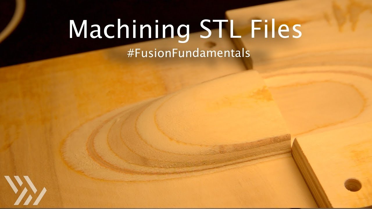

The REALLY hard part will be cutting these terrain tiles. I already have the STLs, but from my reading now I’ll need CCPro to do it? I may be looking into a hack for that now as well…

You can machine an STL with Fusion and they have a free version. See this:
It is a little older but it still applies.
Yep and being in a university you should qualify for the educational free licensing.
