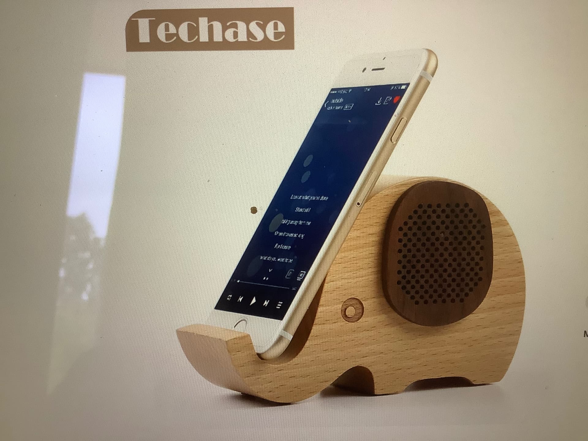

The best I could come up with is this one from the Google.The head set has a lot of advantages but the amount of shaking may make it hard for him to put it on.He is currently in Hospital having ECT treatment,not nice.

EDIT: If you like this style, but want to cut it in wood, here is the model cut in half. If you can fit a 3" tall piece of wood under your spindle, you can cut it, then cut a mirror and glue them together, maybe with a contrasting piece of wood like 3mm wide, like a racing stripe to hide the fact that it is a seam.
It is actually a STL, so just change the .ZIP to .STL. This is just to see if you can cut it, if you are interested. If you are, you can get me the dimensions of the phone and I can adjust the model.
