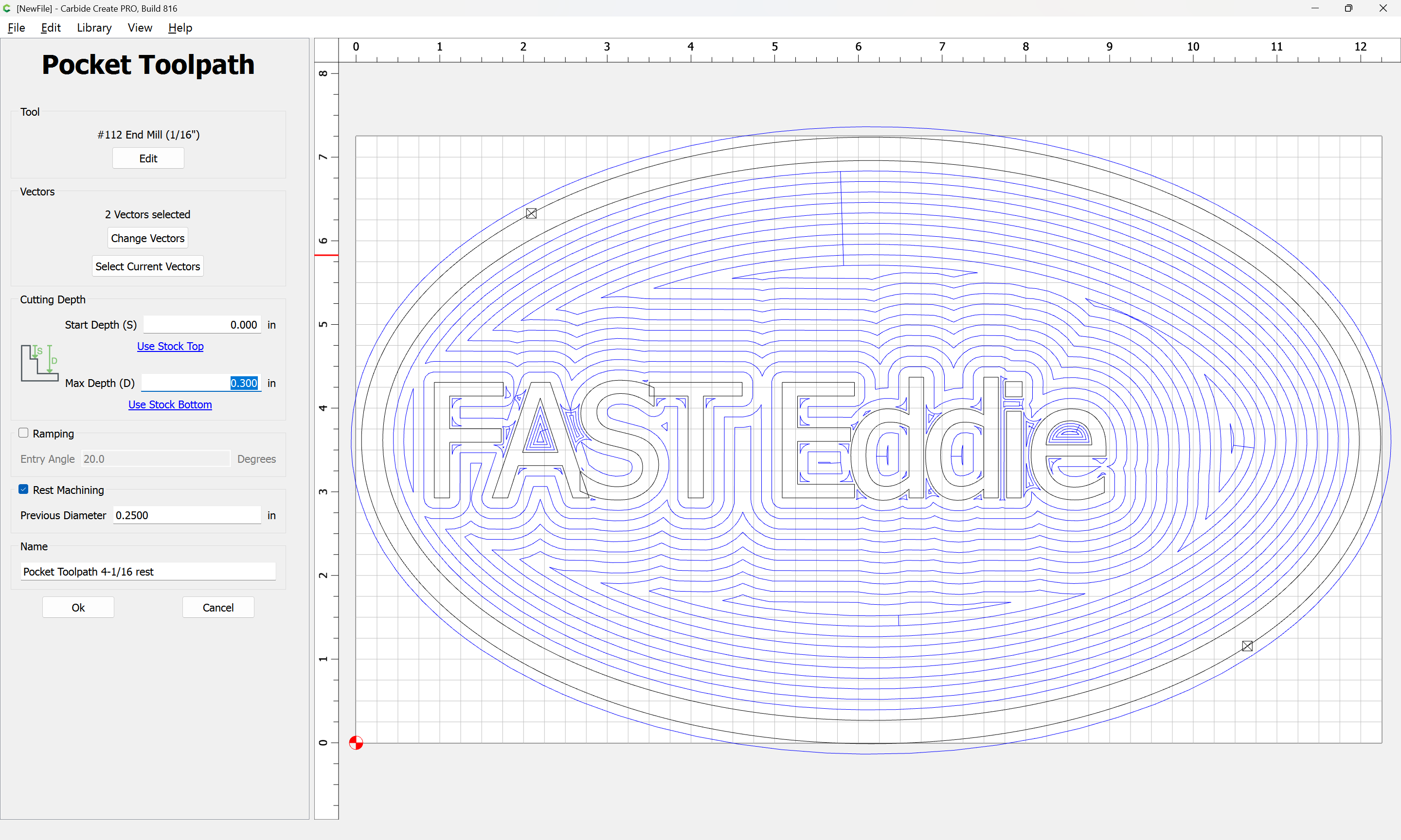

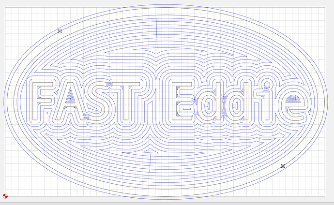

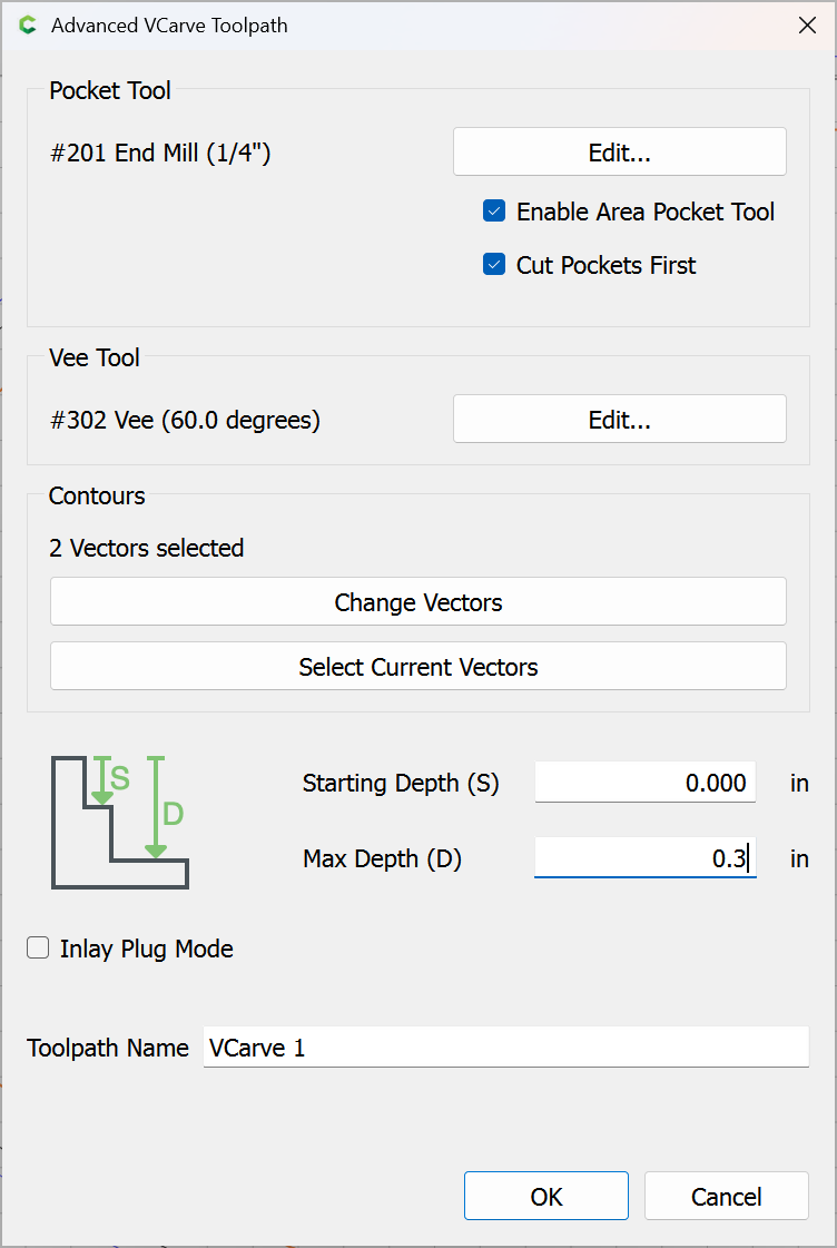

1st time posting here! I’m using Carbide create pro and doing what should be a simple sign-- two tools, rest machining but the results are not good.

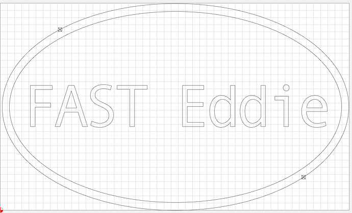

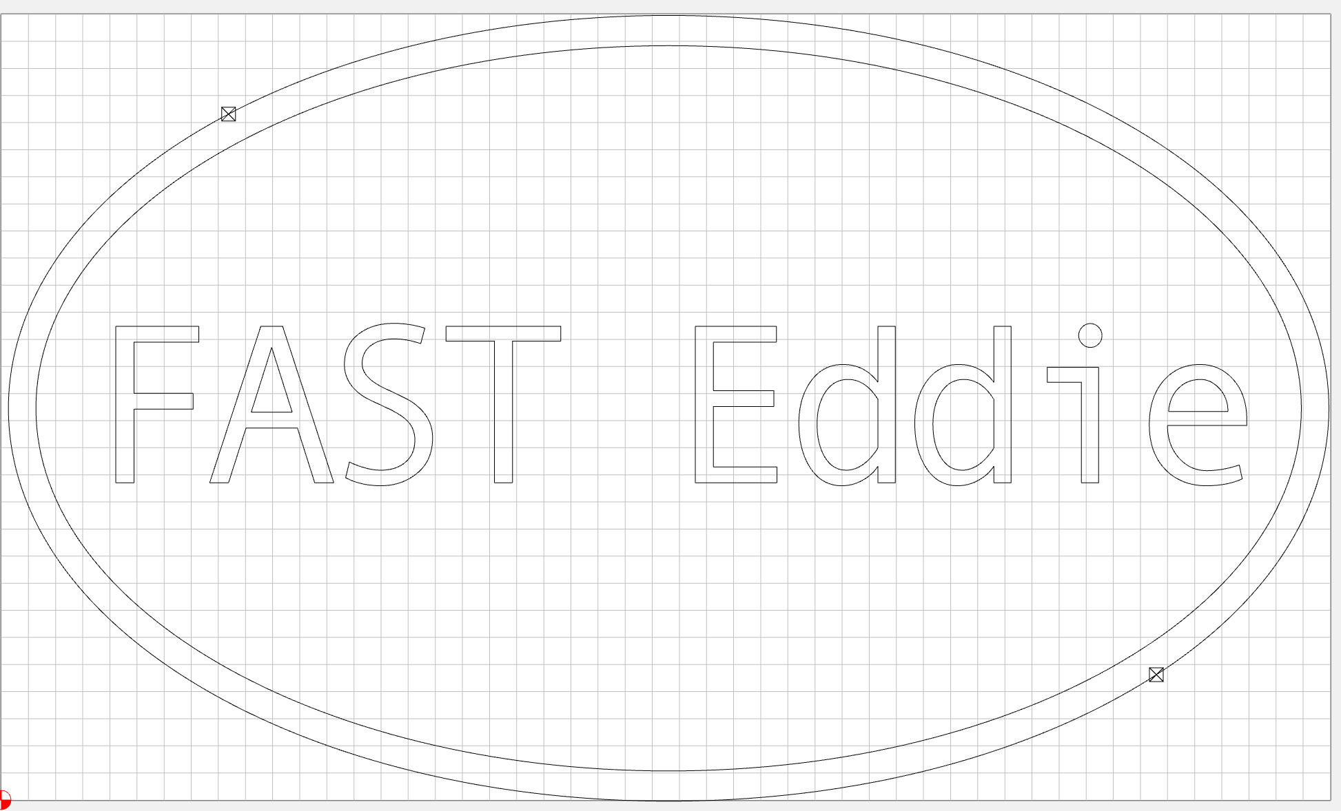

Here is the design–

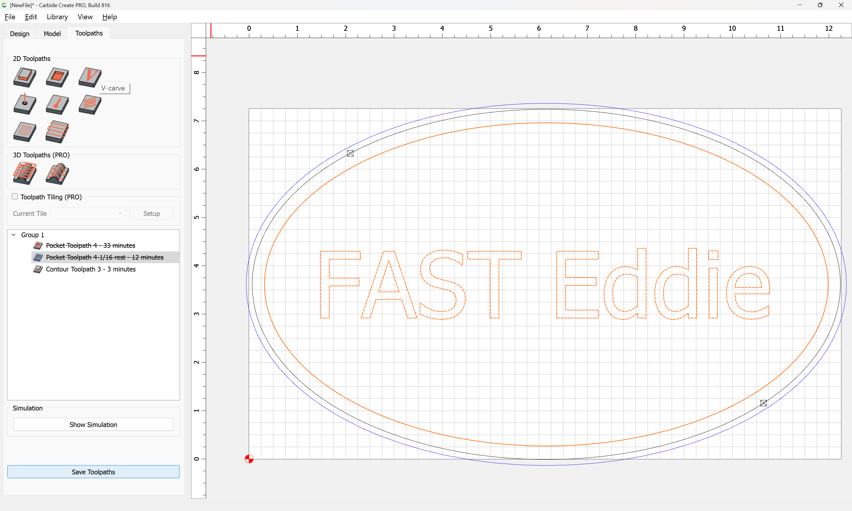

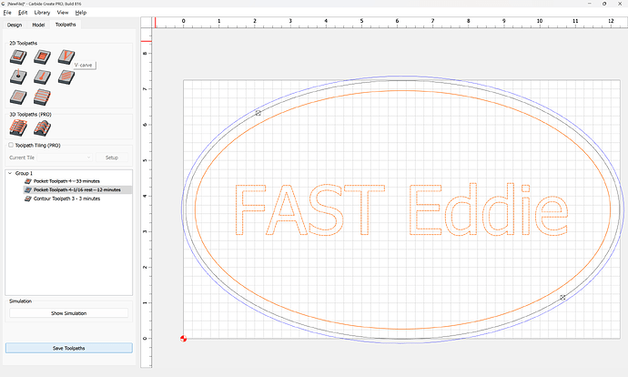

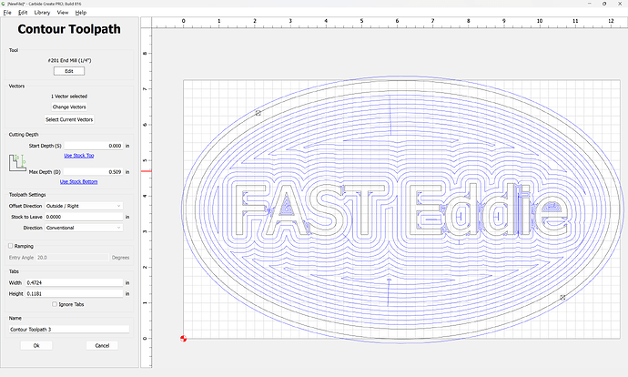

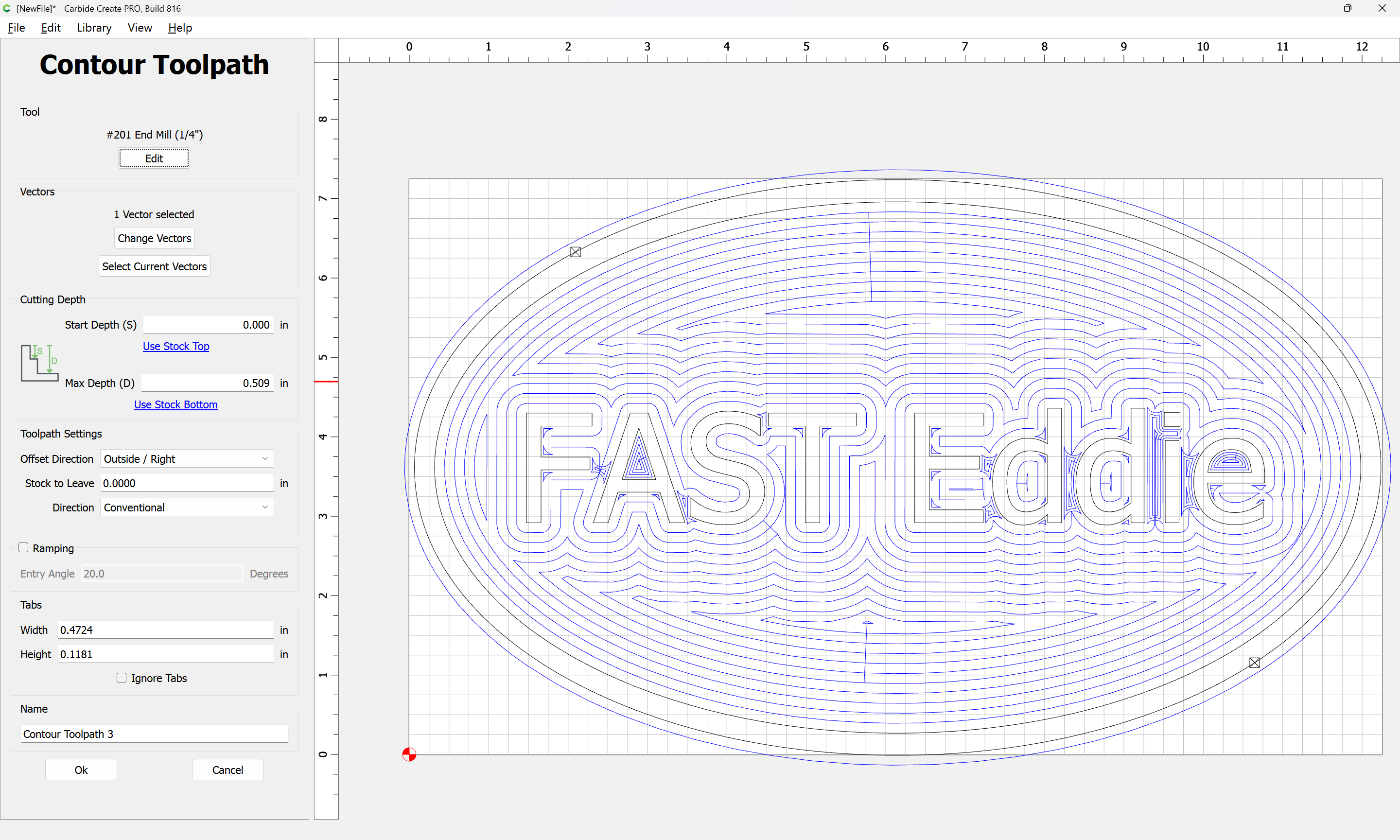

Here are the tool paths–

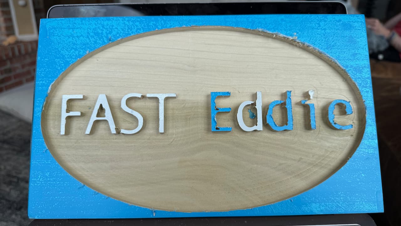

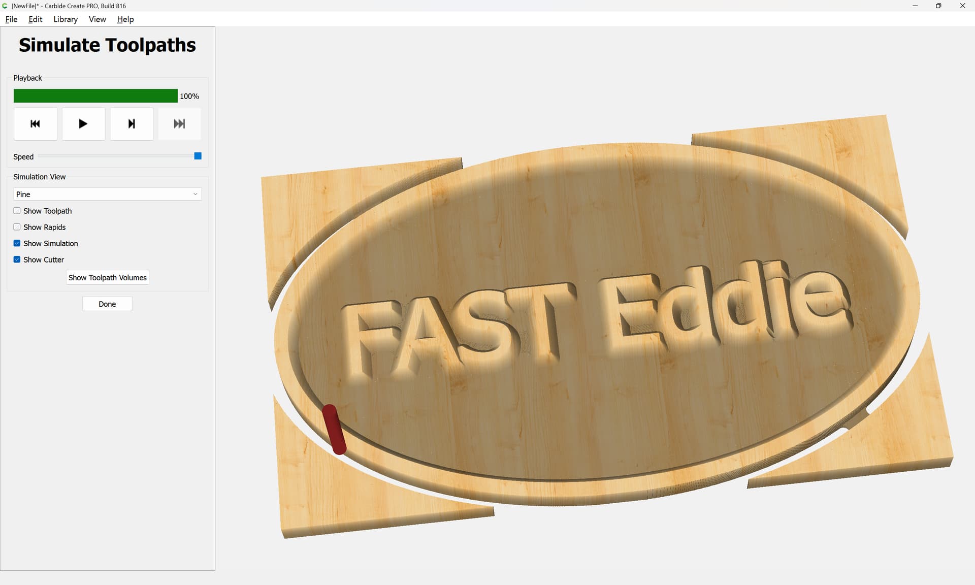

Here is the failure–

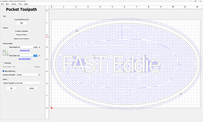

As I was watching the initial pocket cut with the #201 end mill, everything looked ok. Then I noticed when I switched to the #112 1/16 end mill, the rest machining was already pocketed out? But then, even the corners appeared to be off. In the Upper case ‘E’ the rest cuts were completely off.
The piece didn’t move a bit-- it’s solidly attached

A #112 only has a Cutting Length of 0.25".
You are cutting to a depth greater than that:
A further concern is you are planning on cutting a slot as narrow as the tool to over twice the tool diameter:
Where possible avoid slotting and add geometry and cut as a pocket

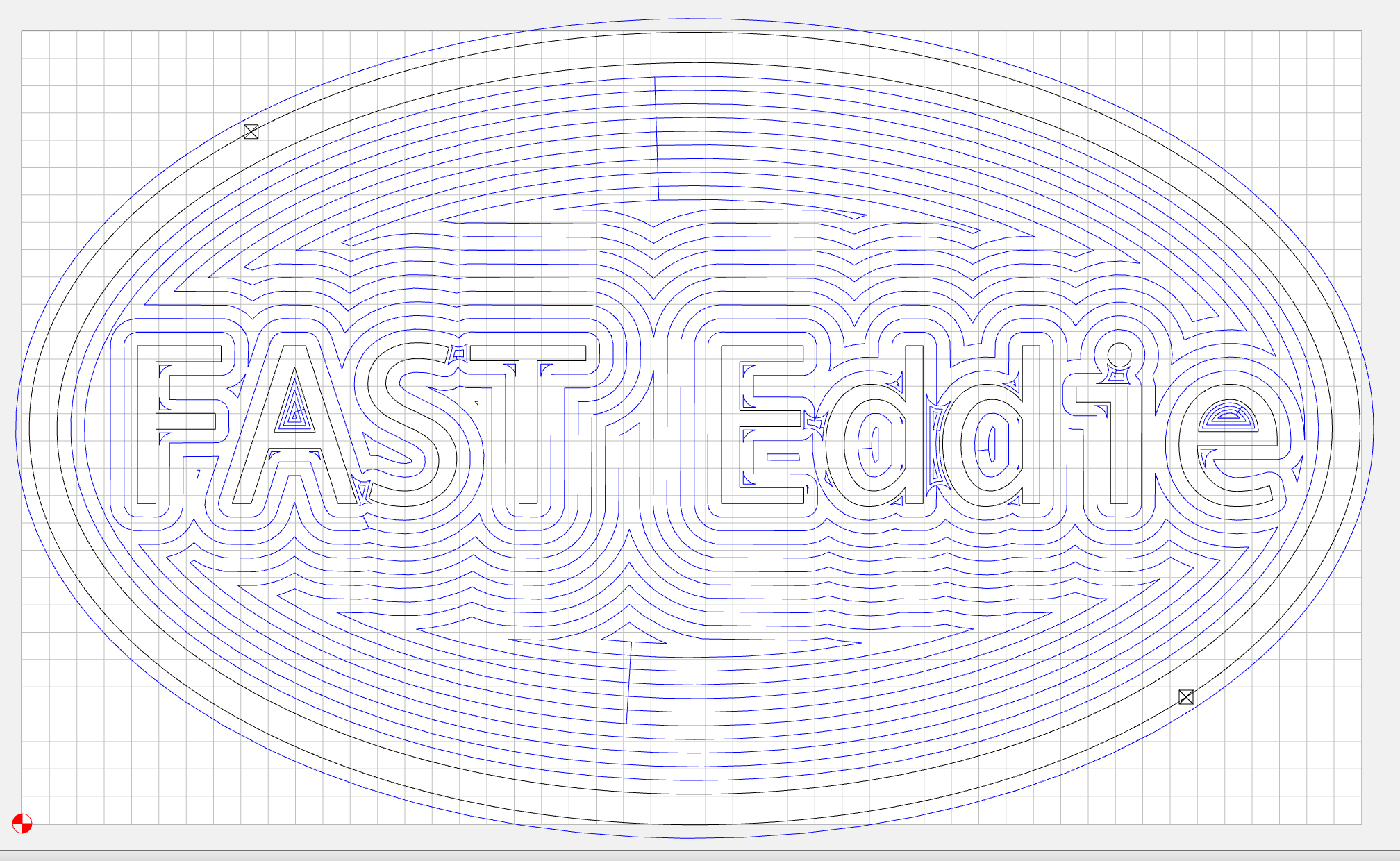

Whatever the issue was it was repeatable, look at the cuts on the 2 “d” letters.
