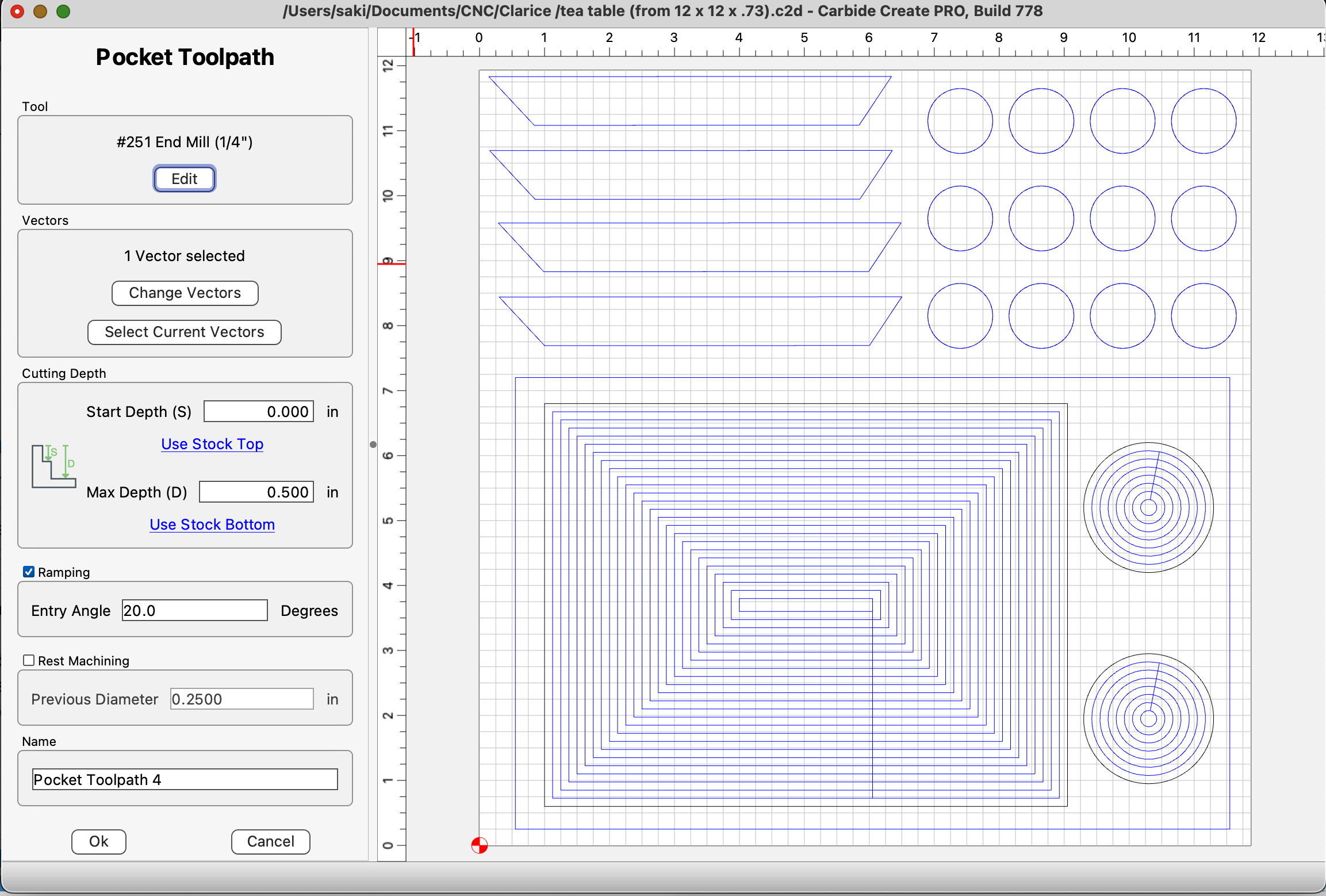

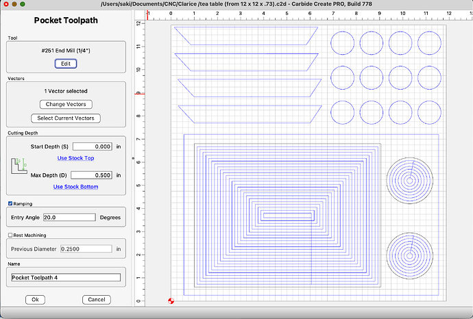

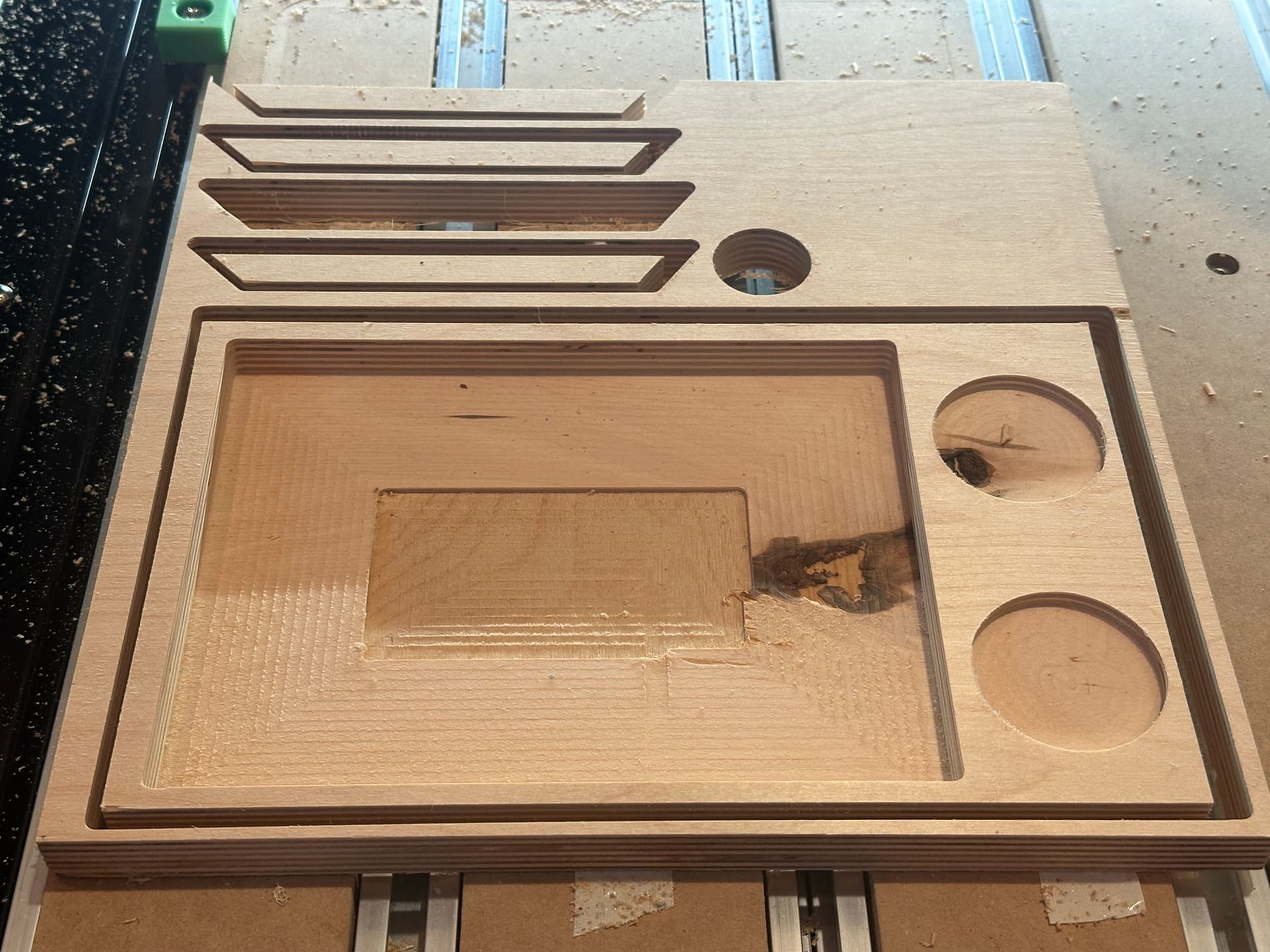

So, 2 of the pockets cut the proper depth as set (.25")…and the last one cut much deeper. I had the toolpath set to exactly .5" (half an inch) and once it got to that depth, it just kept going deeper and deeper until I hit pause before it busted threw the bottom.

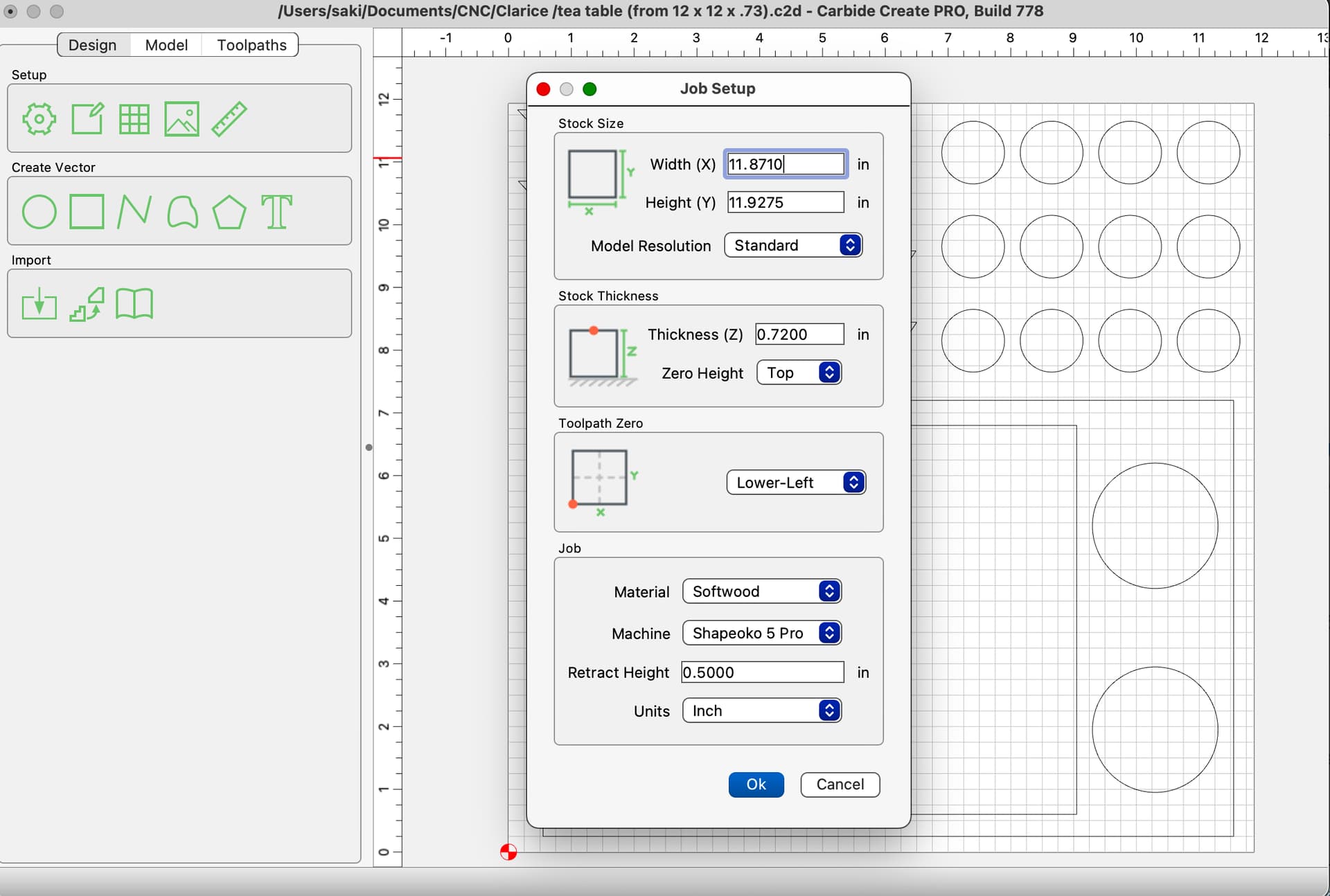

-I’m using bit zero

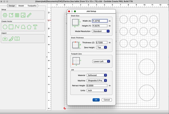

-I made sure the material thickness was set properly at .72
-I made sure the max depth of the pockets was set properly at .5
Since others worked fine, what could be the issue?
See attached.
I’m wondering if the bit was tight enough in the collet.
Possibilities:
  • misconfiguration in Grbl (that should not be possible on an SO5 Pro, since the board is identified by CM and the HDZ is the only option
  • wiring fault — usually this is accompanied by an awful noise — power up, wait a bit and feel each connector, any which are warm/hot would indicate high resistance from a loose connection, check in w/ support
  • insufficient lubrication — make sure the linear rails/blocks are well-lubricated: CNC Machine Maintenance
  • mechanical interference causing lost steps on retract
  • as @arose87tags noted, possibly the tool loose in the collet and pulling out — use a good quality pair of wrenches to fully tighten
  • high tooling engagement causing the machine to be pulled into the cut, or to lose steps on retract — where possible avoid slotting and add geometry and cut as a pocket

In Carbide Create you would need two geometries and two toolpaths:
  • a smaller/inset geometry to cut the pocket, leaving the roughing clearance
  • the actual size geometry to assign an Inside Contour Toolpath
