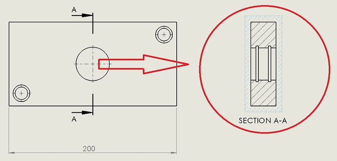

Is there a way to get a profile cut of a project?

Probably the correct term might be to get a sectional view?
like that:
Would be useful for inlay projects for me for now for me.

Are you trying to cut an o-ring groove? The way I’m interpreting your drawing seems to imply that . That is something different than an inlay. Something like autocad fusion will do that and handle toolpathing. It Outputs gcode which carbide motion accepts in addition to the carbide create file format.

As I was making breakfast I realized I am not sure I understand the request .
Is it
  1. You want to cut a groove in a hole. (Like for an o-ring)
  2. You want to visualize a cross sectional view of an inlay tool path to check depths and clearances

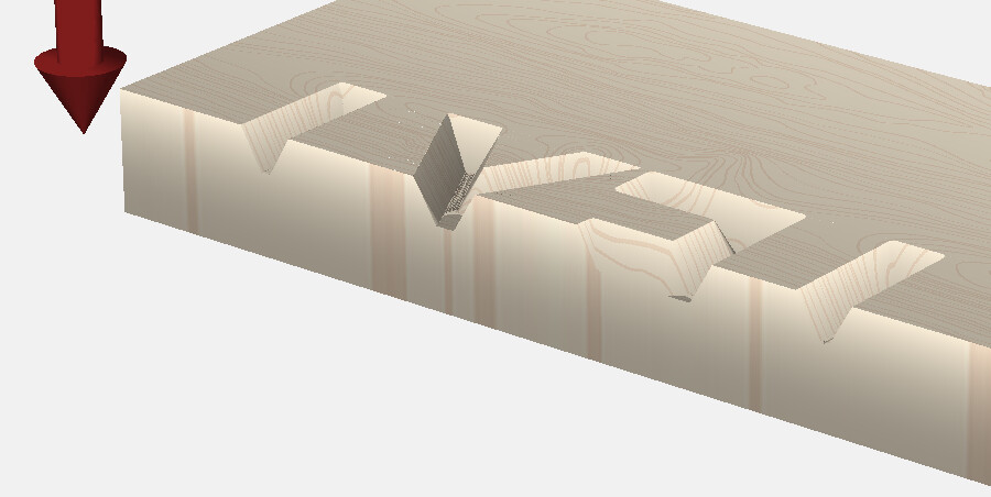

If it’s 2 a way to see the side view depths is to program a pocket toolpath that cuts off the end of the project up to the cross section you want to view and then preview. (Be sure to delete that toolpath before writing out the file to cut on the cnc :slightly_smiling_face:)

John, sorry for the confusion I caused! The image was meant just as an illustration of what kind of a view I would like to have, your #2 describes exactly what I try, I do noit need a groove in a hole (yet). And I always do as you recomend, cut a sample cut for both parts -him and her-, and cut them with the table saw. I thought there could be a software trick.

Actually what I’m suggesting is having a toolpath that pockets away half the board. Simulate all the toolpaths and you can rotate the simulated view to see the results
You can see the profile of one side of the inlay. Testing fit may be a bit difficult but you see the cut profiles

If you want to see a section of the simulation, change the workpiece size or move the vectors so the edge intersects the area you want to section.
