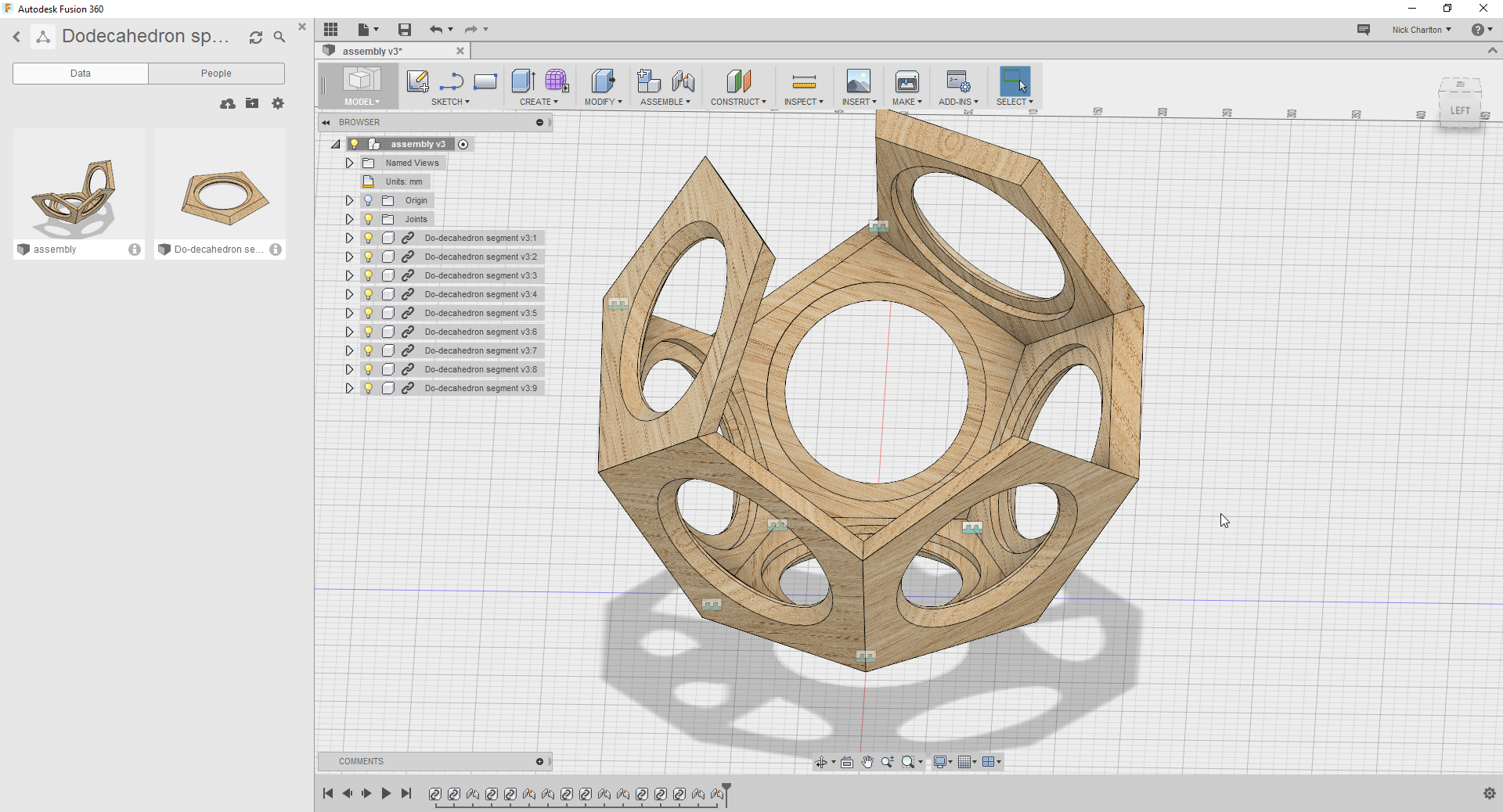

All projects start with a design and since I know that I want to make a dodecahedron I didn’t feel the need to do sketches but simply constructed the regular geometric shape in Fusion 360. I normally use Autodesk Inventor but I have heard some good things about the integration of Fusion and Autodesk Cloud Render which I use regularly so why not give it a try!
The speakers I am going to use are some fairly cheap ones from amazon which have a built in tweeter so no need to have to source them separately and organize them around the shape.
I started out with a regular pentagon in Fusion 360 and made it the thickness of my material (20mm White Oak), pocketed a central hole that is just bigger than the main part of the speaker.
Next I cut the chamfers that allow the pieces to fit seamlessly together (in theory). For a dodecahedron the dihedral angle is 116.56 degrees which means each segment must have a chamfer of around 56.28 degrees. I still haven’t decided whether I am going to 3d machine this or cut it on my compound miter saw… I also added an oak appearance to the model at this point. It looks so much better in Fusion vs Inventor!

Added some speakers cones I got from Grabcad.com. Couldn’t find a model for the ones I have but it would have taken along time to model them from scratch so this will give the general idea of the speaker and will allow me to do a nice rendering!
Here is a quick render that I did. I am not sure about the stand or what orientation the speaker will be. I envisage a polished copper tube stand with the dodecahedron sitting with a point pointing up, but i’ll cross that bridge when I come to it!

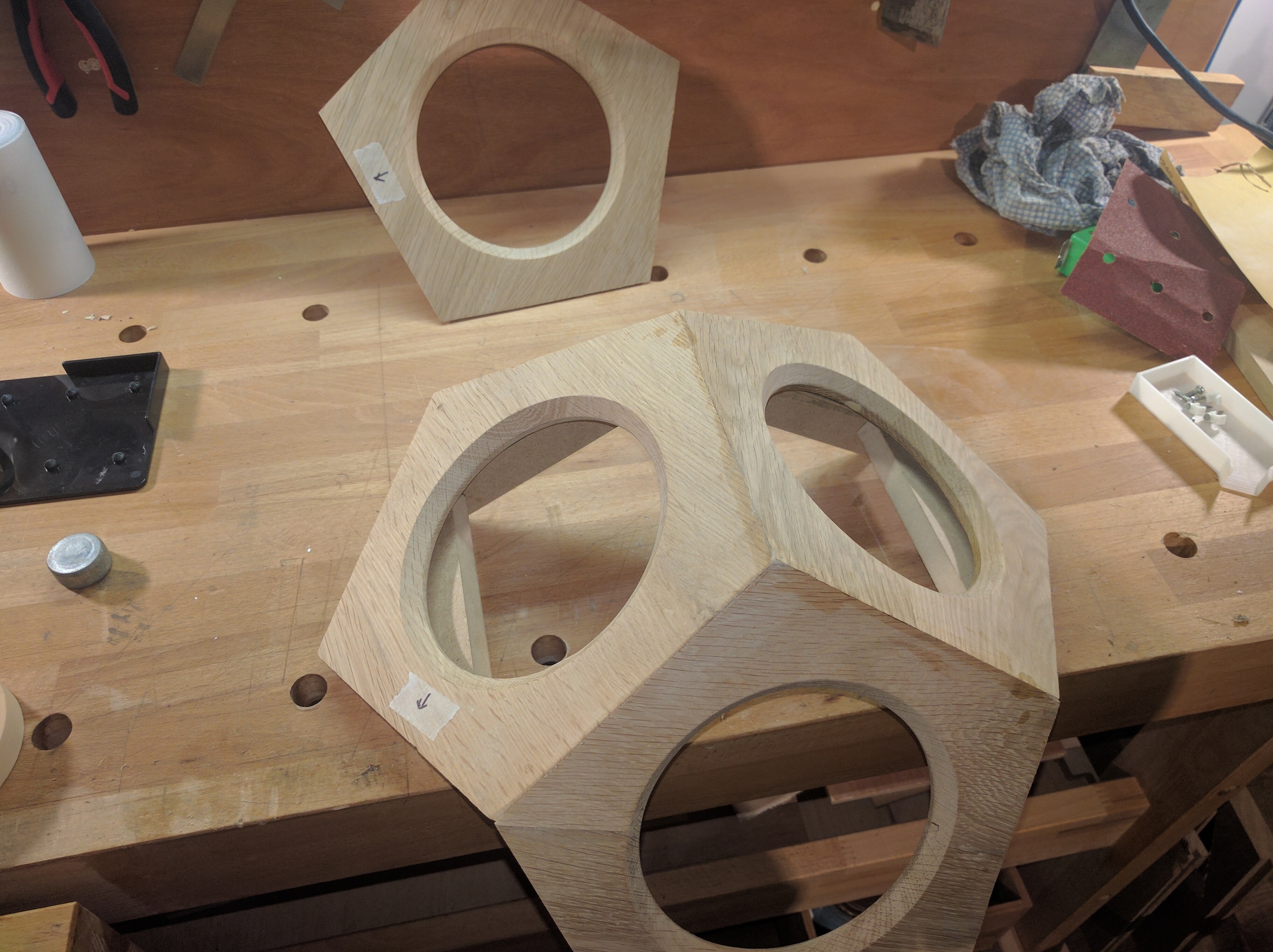

I milled a test of the hedral shape that makes up the dodecahedron out of mdf to test the fit of the speaker. It may not be very clear in the picture above but the hole cutout for the speaker was about 2mm over sized so I adjusted my CAD model accordingly.

The first of these is my glue up jig. It is essentially a sturdy MDF frame of the angle that the hedrals need to be glued to each other at. I will make two of these so that I can clamp the pieces between them whilst the glue dries.
The second jig is for my mitre saw. To cut the chamfers that allow the hedrals to fit seamlessly together I was going 3D machine it but that would take too long according to some tests I did in MechCAM. So I am going to use a compound mitre saw to cut these angles. This jig helps line the pieces up to cut the angles on all sides of the hedral fairly reliably.

Making some progress and doing the first glue ups :slight_smile:
Only just realising how big this thing is going to be when all 12 hedrals come together! (banana for scale)
Edges are going to need some filler and a lot of sanding! my mitre saw isn’t very accurate…

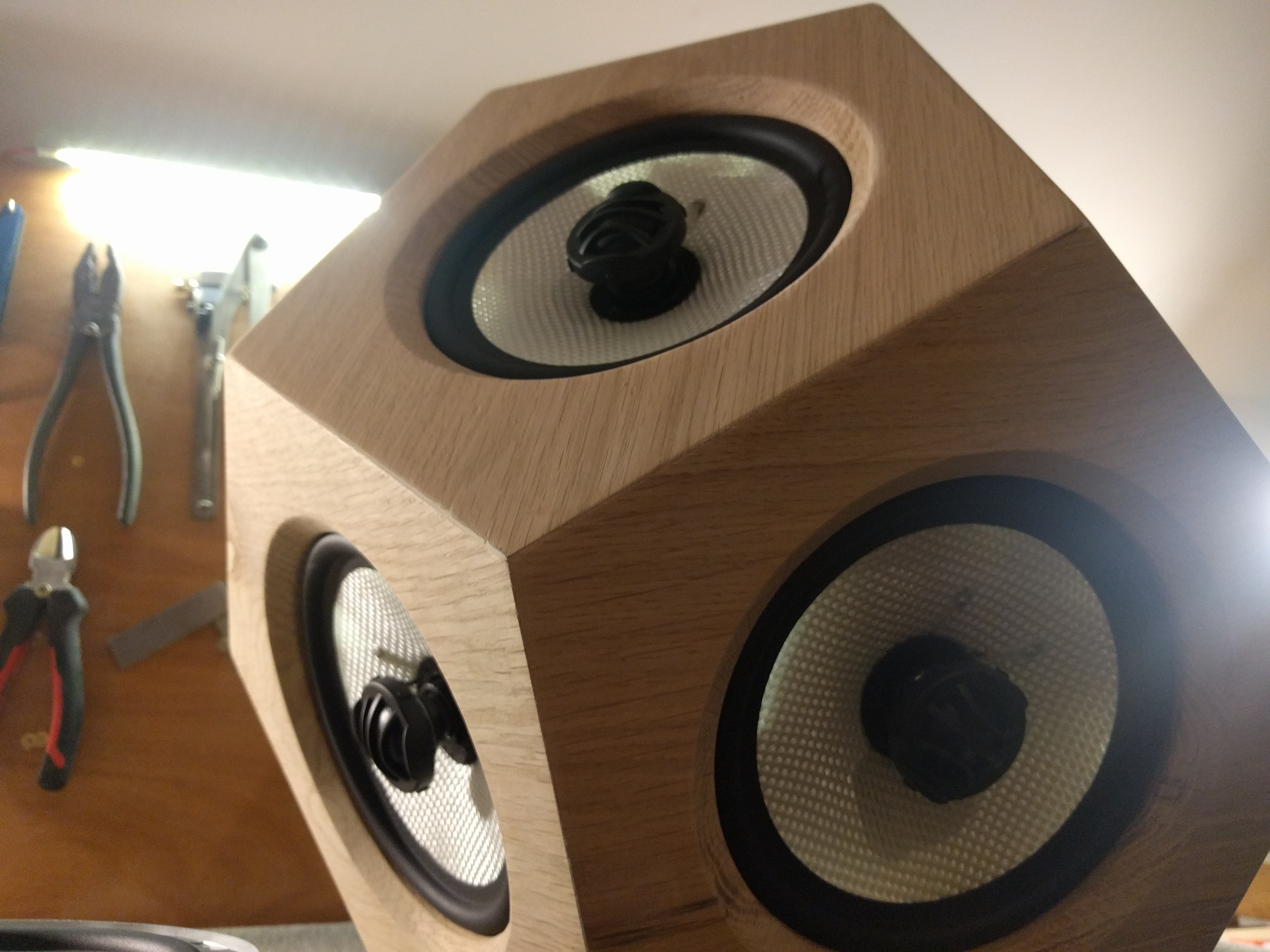

A few photos of progress as I start final assembly and finishing :slight_smile:

Final few photos of construction, hoping to get the video out this week :slight_smile:
It looks absolutely fantastic. Great job!
Now I guess the obvious question is, how good does it sound? And, are you going to stain and clear coat the wood, or just leave it au naturel?
Thanks!
I haven’t actually tested the sound quality yet but I don’t think it will be amazing, the drivers aren’t great quality!
Just going to use a wipe on light stain to bring the grain out :slight_smile:
