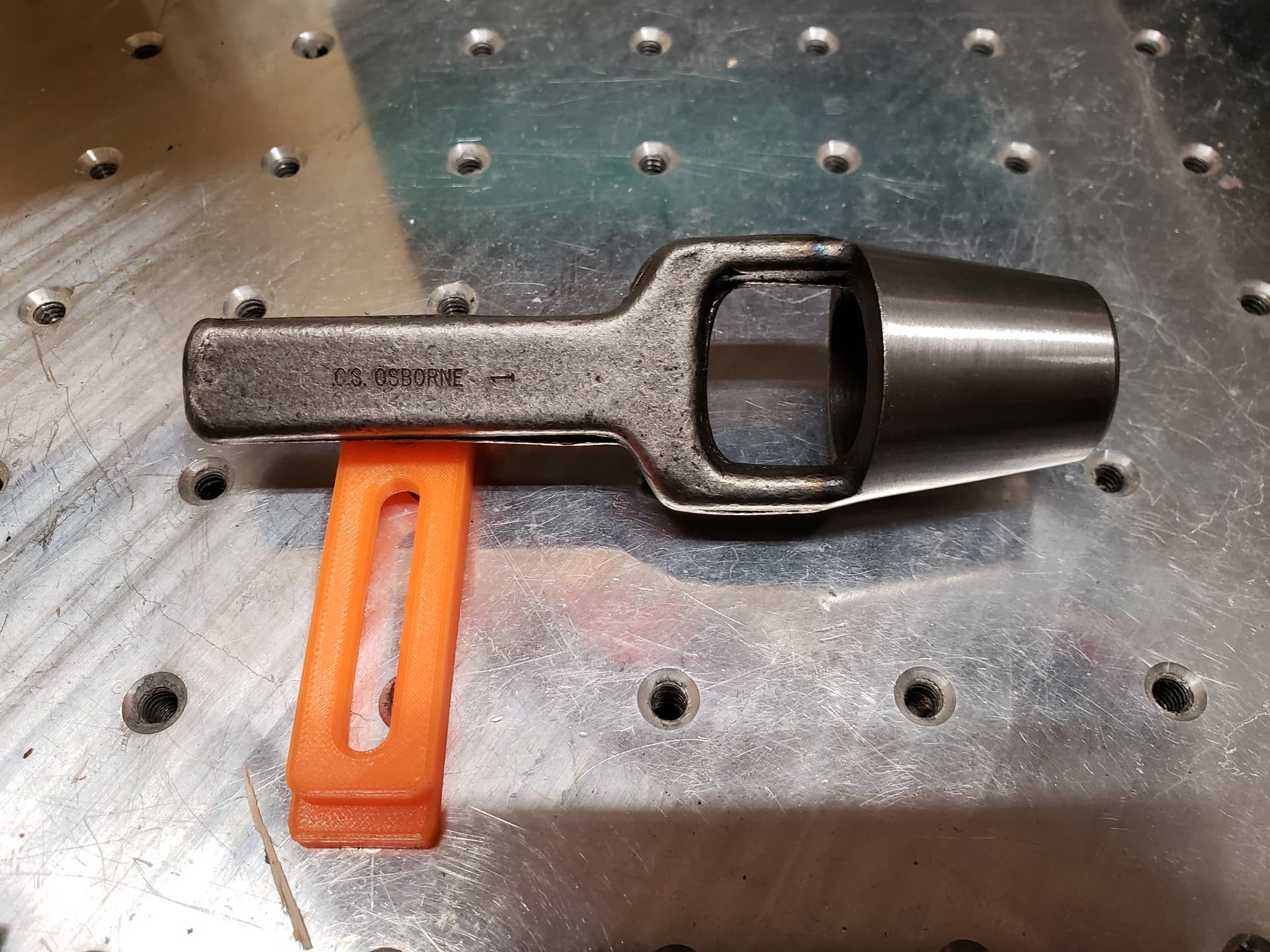

I bought a gasket punch (or arch punch) and use a scrap piece of UHMW plastic for the backing surface to punch out 1" circles.
Do not buy the “General” brand punch. I bought it first and it broke within 100 strikes or so. I then bought a C. S. Osborne punch, and hundreds of strikes later it is still just fine.

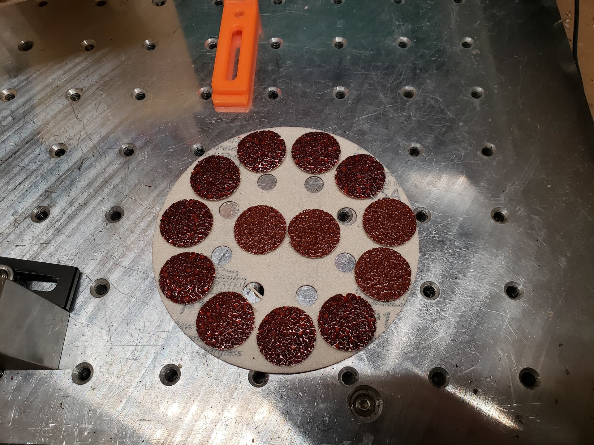

I can get 13 - 1" discs from a 5" sanding disc.

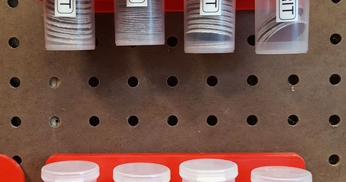

I designed and printed a holder for the plastic containers that hold the 1" discs.
