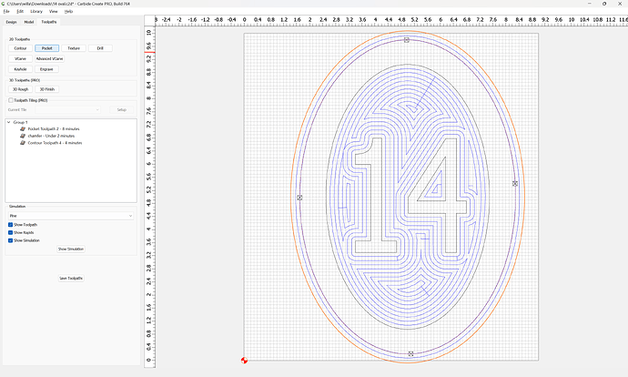

The 3D preview seems fine:
My recommendation would be to select the outer geometry:
and offset it to the outside by endmill diameter plus 10%:
Apply:
Select the offset and original:
and then cut as a Pocket down to tab height:
Moving it up above the contour:
Also, if you start w/ the #301 you can maybe save a toolchange:
(toolpaths are re-arranged by click-hold-dragging)
which then previews as:
An optional improvement would be to offset the pocket twice, once a very small distance so as to leave a roughing clearance. Where possible avoid slotting and add geometry and cut as a pocket
