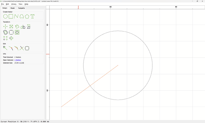

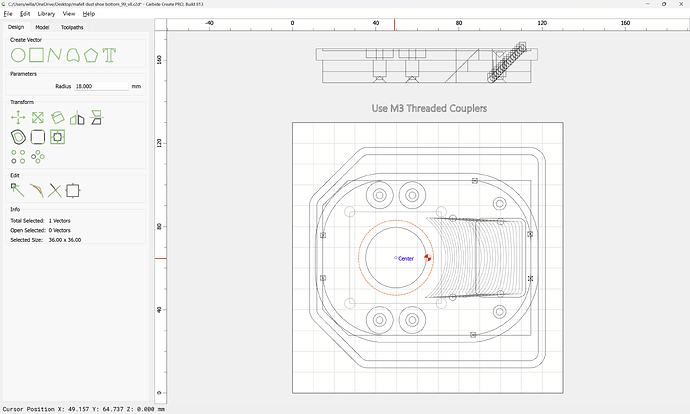

Snap to center: Yes, the center can be identified while the circle is selected, but I see no way to snap a point onto it, particularly if the center doesn’t sit on a grid point. An example would be drawing a radial line from the center of a circle. That should be a simple operation.
Ramping: I have pro. Ramping is not available in 3D roughing operations. For 2D, as far as I can see, selecting an entry angle isn’t enough flexibility to be sure a particular surfacing bit won’t bottom out. Specifying the spiral radius would enable this.
It should work to snap the beginning or end (or any point in-between) to the center of a circle, even if not on a grid intersection when drawing a new Polyline:

From what I’m seeing, it’s inconsistent. For a simple example, see if you can find the center of any of the concentric circles in this file. It never shows up for me. Because of this issue I’m not really sure these are even concentric.
DCDwHogback.c2d (316 KB)
Center is only found with circles which are created as circles in Carbide Create and which have not been subsequently edited in some fashion to change that status.
Polylines which approximate circles, or curves which approximate circles do not have their center calculated/recognized by Carbide Create.
EDIT: for more on this please see:
One of your 4 circles is still a circle. Select them individually & see which one still has a Radius parameter. If you want to make them concentric, select the other 3 then select the circle, and align them to center. image
Okay. An offset to a circle isn’t a circle. Weird but understood.
