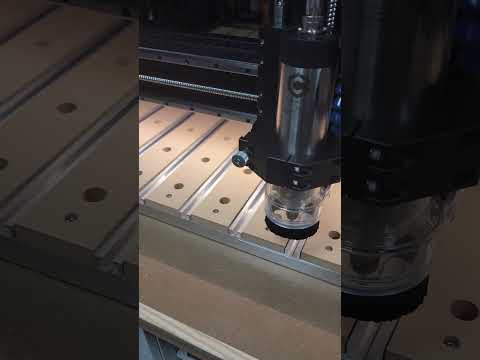

Is anyone experiencing resonance/chatter on diagonal moves? It seems to be fine when it moves parallel to X or Y, and almost none on circles, but diagonal movements sound horrible and produce chatter.
SO5 Test.dxf (7.3 KB)
I created this pattern for testing and even in mid air with no material the diagonal moves produce the grinding sound which would lead to chatter.
Do have a video of resonance/chatter your are experiencing withe diagonal moves. Residence can be difficult to troubleshoot at times. A video may help forum members diagnose the issue.
Here is a link to the video. The machine runs square, diamond then circle to show the difference. Speed 200 IPM.

It is my opinion that this is not a lubrication issue, as it travels fine left to right and front to back. Sounds to me like some steppers are fighting each other or something is loose and vibrating badly.
When you move the gantry all the way to the front does it touch both sides equally?
Not an expert and I am sure support will diagnose it asap.
Power supply maybe? When more than one axis of motion is commanded, maybe it’s drawing more amps than what is being supplied? Are you using a long extension cord?
One thing to check is the non-stepper end of the ballscrew. I don’t know if this is the case here, but sometimes the ballscrew can hit a frequency/resonance and vibrate in the far end.
Ballscrew design is both an art and science. There is no such thing as a ballscrew that is perfectly straight, and especially over a 48" span. So you have to allow the ballscrew to float a little axially both at the stepper and the opposite end…or allow the ballscrew nut to float slightly axially in the carriage. If you don’t there will be at least one place that it binds. You can’t have a system that is fully captured.
In the design C3D uses there are couplers at the steppers, the far ends float, and there is a rigid nut in the carriages. The ballscrew is slightly constrained in a bracket at the end. On my SO5 if I am doing fast movements at the max of feedrate, the far end of the X ballscrew will sometimes hit a resonance and vibrate in the bracket that semi-constrains it at the far end. This is often referred to as whipping and is just going to happen with a ballscrew that length at certain frequencies. this happens on my SO5 Pro 4x4, but hasn’t shown in the cut.
I went thru every screw on the machine and everything is nice and tight, when I move the machine to the front yes its equal distance on both sides, I made sure the machine was square.
