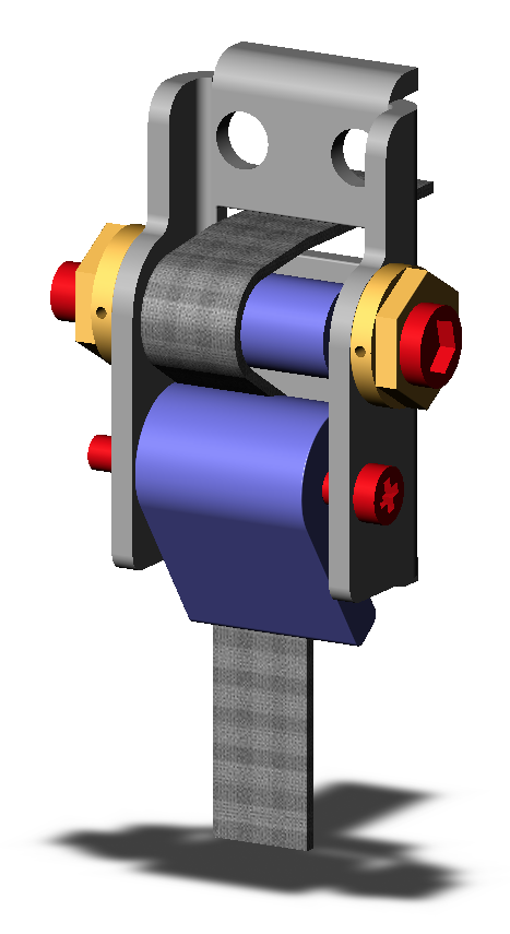

Shapeoko Belt Tensioner

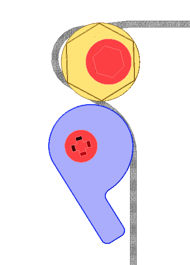

Nice idea - a laser cut slot pattern 1mm x 15mm x 7 or 8 slots would be neat and save a component. Punching this pattern would give any toolmaker palpitations - just too fine a geometry to be realistic.
Is your “snail-cam” designed to tighten CW or CCW? Hmmmm …
It’s organised so that the belt ‘pulling back’ tightens the cam. Also so that the cam cannot be forced so hard as to either break it, or damage the belt - it won’t ‘crush’ the belt more than 50% of thickness before the cam action flattens out to constant radius.
Screenshot 2020-11-13 at 15.23.25
Carve the base frame out of aluminum or 3d print it and test it out! If the design has the belt at 15mm the current design will be hanging over the inside of the frame, might want to offset it 6mm toward the center of the rails, or adjust for the 9mm belts everyone is using so it will fit. Just make the base thicker to stand over the frame bolt. Also occurred to me if you put one on the front and back you will double the adjust-ability. I never considered a cam for tightening, I chose two 1/4-20 bolts for my clamp. I am interested to see how it reacts to vibration.
Based on my current prototype belt clips and the GT2 belt tooth profile;
belt profile drawing
The teeth are quite curved so the slots, if square edged, should be wider than the teeth to allow the belt to sit fully into the slot. In mine the slots are wider than the tooth and I fillet the edge slightly but I’m machining not laser cutting.
You don’t need to match the tooth width because the job is to pre-tension the belt, it is consistently pulled one way so there’s no need to worry about backlash, just retention against a force pulling out.
The belts don’t compress much across the 0.6mm of the main belt (the bit that isn’t teeth) and it’s not friction holding the belt anyway, it’s tooth engagement so the cam only needs to compress down to, say 0.4-0.5mm and stay there to position the belt teeth in the slots to do the job they’re designed for.
The cam doesn’t have to hold against pulling force on the belt, the teeth are doing this job so the normal friction lock cam concerns probably don’t apply.
@neilferreri 's Awesome design uses a relatively small surface of 3D printed teeth that are reported to work very well so that says a lot about the force needed to do the job.

Left and right mount idea added, also ‘almost’ deals with the extrusion bolt head interference. Were this to be tool-punched, I have added a pair of ‘feet’ that would be easy to incorporate (not so easy for CNC machining). Also kept the Philips Head screw as it seems to be pleasing so many :wink:
Nice! Now the only other issue I can see is how the center bolt will behave when you attempt to tighten one side then the other, or maybe use 2 wrenches at the same time?
