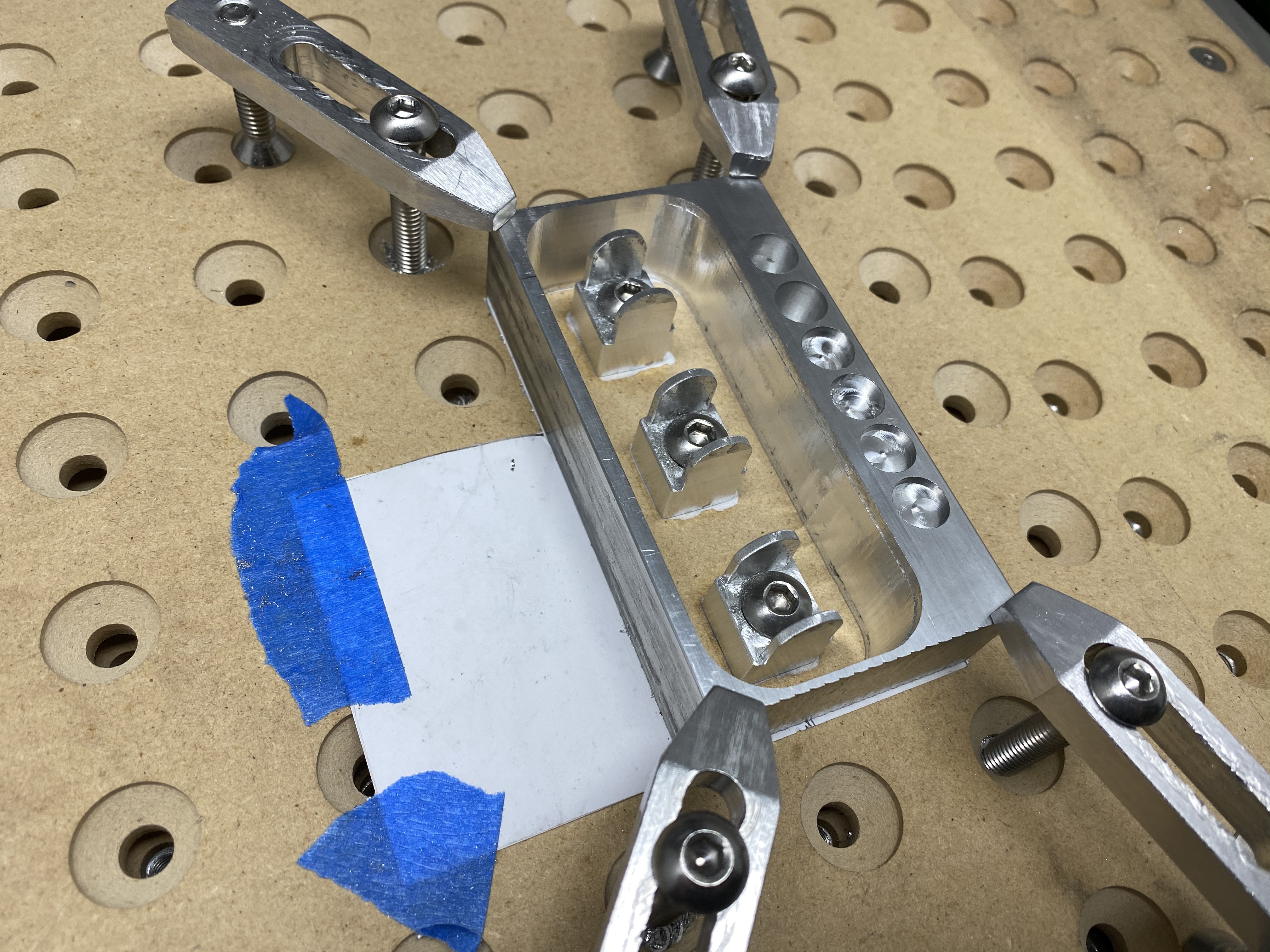

Shapeoko Belt Tensioner
The GT2 tooth profile fits into a 1.2mm 60-vee groove almost exactly, which was a nice discovery.
How often do you guys tension your belts?
I snapped the Z belt after only 50 or so hours on the machine, so replaced the Y belts and plan to update the X belt when installing the HDZ - no more science to my reasoning than one failed…
That aside, I am just curious over ā€˜correct tension’ and the various discussions around that. So tinkering with tension is the issue, and coming up with a funky clamp the challenge.

I left the sharpie marks on my extrusions and just stick two old blunt 1/4" cutter shanks under each belt in turn, listen to the twang and if they all sound about the same pitch, it’s fine, if one of them sounds off, then I need to get the app out and actually check things.
Did you mill that whole thing out of billet or was it sheet that you bent in a press brake?
It was an extruded u-section. An odd alloy that proved difficult to cut - feeds down as low as 300 mm/min and 0.5mm cut depths. The lack of stiffness from the shape didn’t help, nor that my standard Z seems to have developed some movement - the HDZ is here and waiting it’s turn to be fitted

Finished my pulley levers today, no need for any finish work, polished on the machine with my original 201 I have had forever… .025 edge fillets so no sharp edges… Tapped for 1/2-20 bolt threads.
You really have to pay attention to chip removal when you start going so deep, it is very easy to be running your own chips over and leaving melt on the end mill. I had to babysit the end of the carve and use a tiny wire brush and Dremel to remove the build up off the back of the 1.25" single flute a few times.
