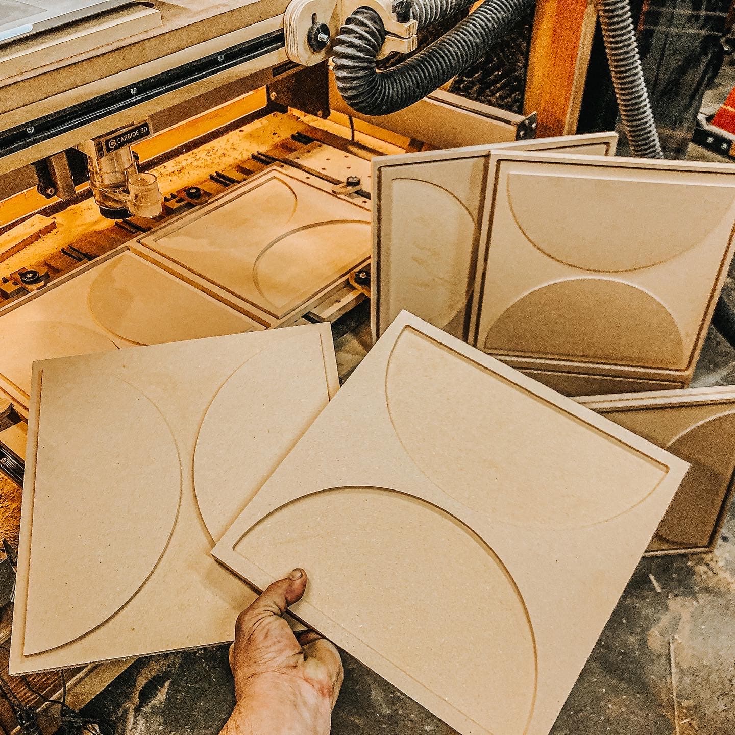

Weird issue. I’m currently in the process of making about 100 wall tiles for a feature wall:
I’ve created 5 different gcode files for the different patterns I’m cutting out. I turn everything on, initialize the machine, probe for xyz zero and it starts running like it should. My plan was to run the project and when it’s done I’d just load the next board in the same spot (no need to re-zero everything) and start again…and just keep going like that.

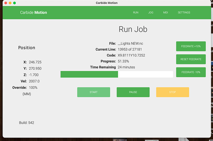

What I’m running into however, is that I might be able to get through 1 complete cut, maybe 2, and then the machine will just freeze. The router stays running but Carbide Motion is unresponsive. I can’t pause, stop, jog, etc. and I have to power off everything and start over. I’m currently running Carbide Motion Build 542.
On the current gcode file, it froze just a few minutes into the project. So for kicks I tweaked some of the feeds and speeds just slightly to see if by chance that would resolve anything. It didn’t. I’m currently on my 4th attempt trying to cut out this one particular tile.
I’ll attach the gcode file here. Also, thi stime when it froze I took a screen grab of the carbide motion screen in case the line/code info on there is of any help.
