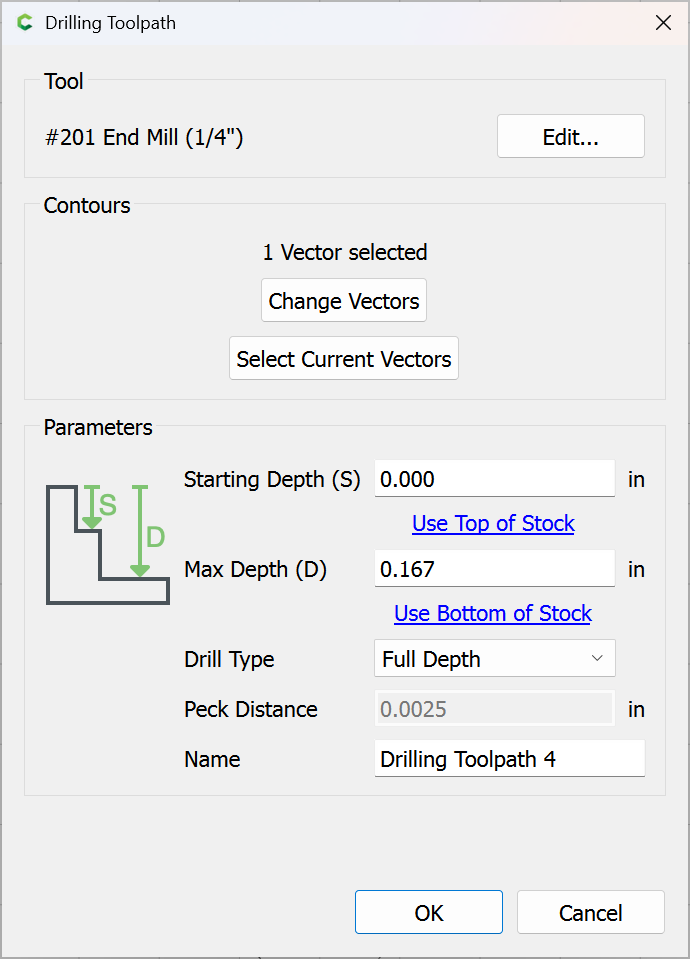

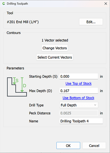

I am trying to drill holes for a board game. I set the size. Want in carbide connect but with I run the tool paths the size of the holes do not change as put in carbide connect. What am I missing?

Are you using a Drill toolpath?
Using what tool? At what feeds and speeds? In what material?
How are you measuring the bore?
Is using a smaller tool and cutting as a pocket, leaving a roughing clearance and taking a finishing pass an option?
Photo showing how the stock was secured and how the cut turned out?
Upload your file?

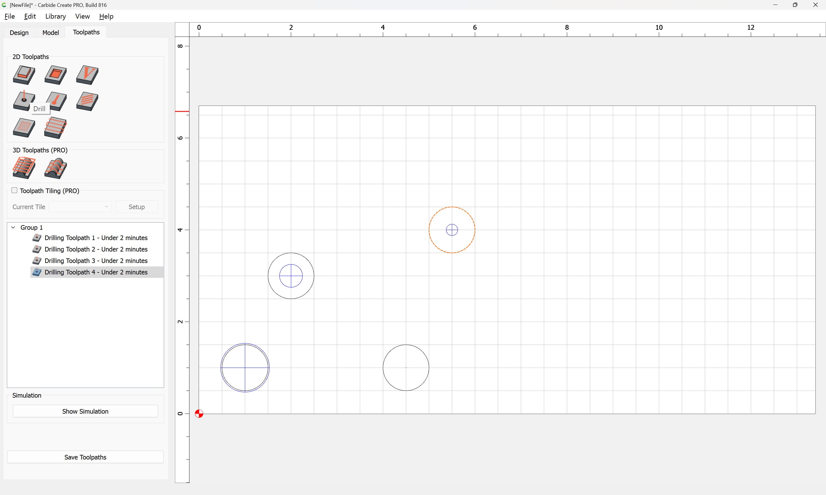

I was but after doing more reading I switched to a pocket cut. That works better but I don’t get round circles. The are slightly oblong

In that case, leave a roughing clearance larger than the defect you are seeing and then cut to the finished size using a finishing pass.

I drill some holes with a pocket. You have to use a bit that is smaller than hole. So for a 1/4" hole I use a 1/8" bit. The #102 is rather short so I use a Grizzly 1/8" longer bit that has a 1/4" shank.
As far as your holes being oblong you may need to run a calibration with circles and squares to make sure your machine is mechanically sound. The oblong holes may just be the bit deflecting. But you should run a calibration to make sure your squares are square and your round circles are actually round. If the calibration is good then it will be about F&S.
