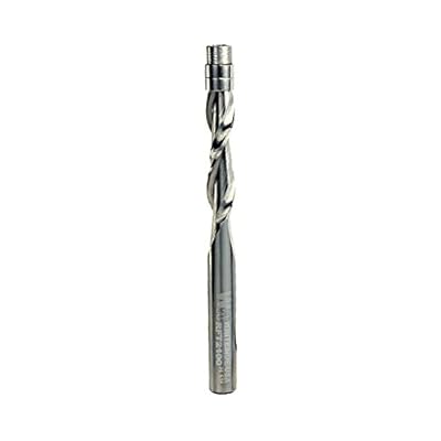

I do a lot of my work similar to what Phil mentioned above. I come back and use a trim router with this whiteside 1/4” pattern bit. I love it because it has a 1/4” diameter bearing and can follow most corners I make on the Cnc router.
I have one of those RFT2100 bits, too. I haven’t used it a ton, I was always worried it would be pretty delicate and didn’t want to push it too much, preferring to keep it on-hand should a need arise.
You find them to be pretty tough? Anything you can share about its use?
The first one I had did eventually wear out but I was very rough on it. I started out by cutting five cherry built cabinets (8’ tall) worth of saw tooth standards using this bit. I used the shapeoko to make a Baltic birch template, then used this but to follow that template on 40 pieces that made up each of the four corners of the cabinets (above and below a fixed shelf). I’ll admit, I think I dulled that bit up quite a bit on that project, but I used it for another few months before I started using a new one. I’ve used the new one for about a year and have had no issues. I almost always cut away most of the waste on my bandsaw first, which is something I did not do on that first bit. That has prolonged the bit for sure. I’m surprised it has done as well as it has, but I’m sold on it as I’ve probably abused it quite a bit…that and the Bosch colt that I dedicate to the bit. I’ve accidentally tripped on the cord a few times and brought the whole thing down…I honestly can’t believe neither the bit nor the router has had an issue based on that alone!
