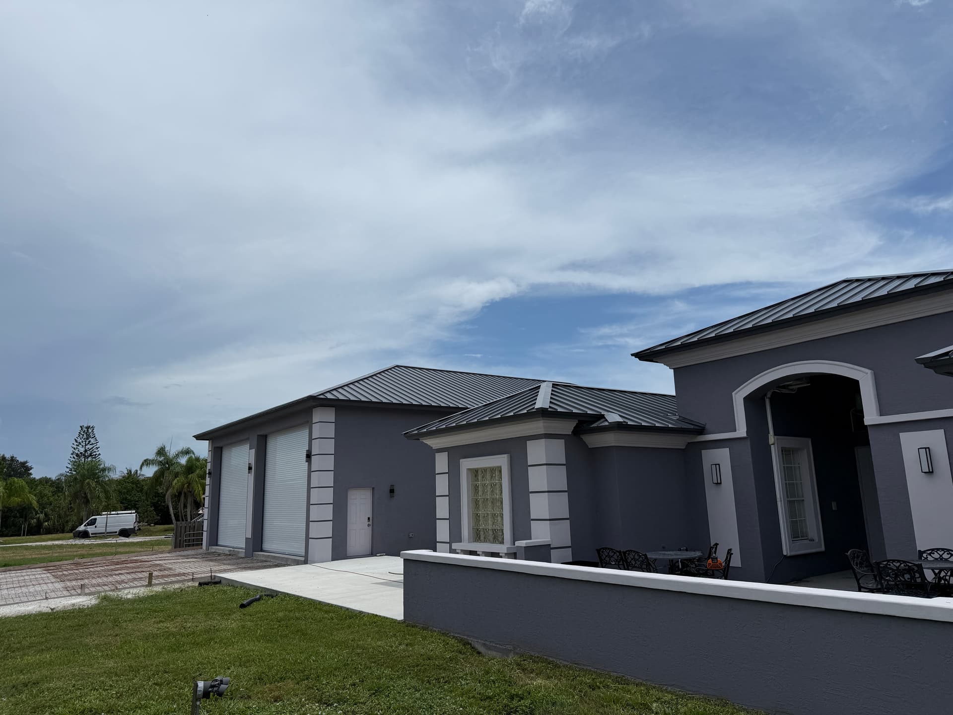

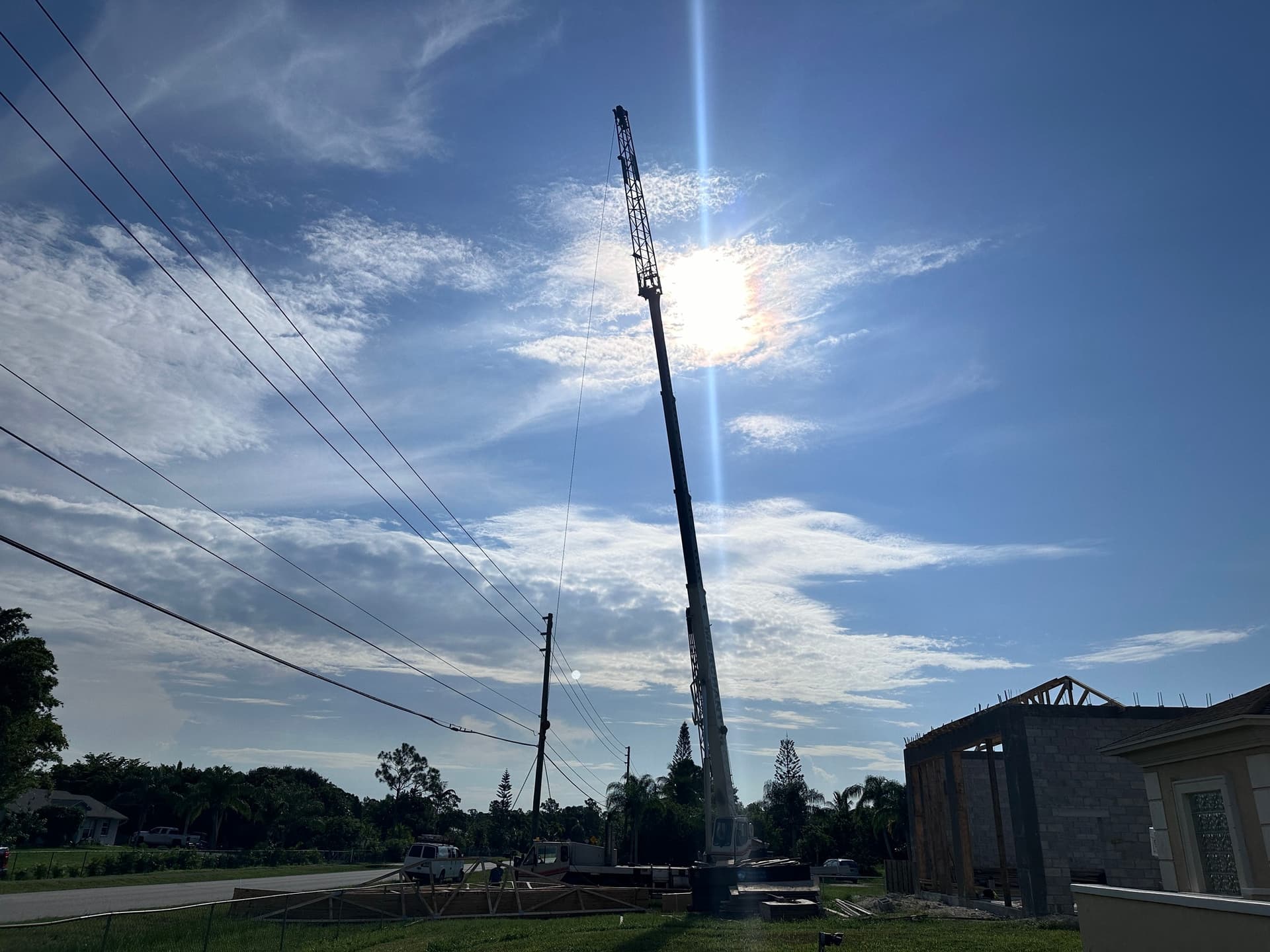

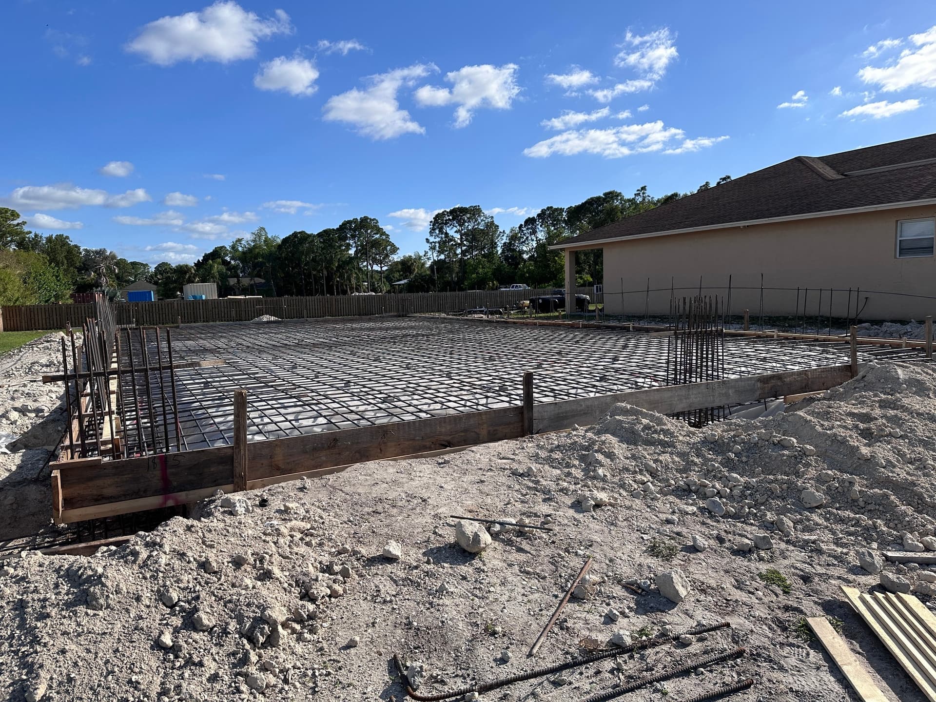

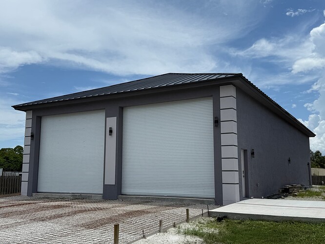

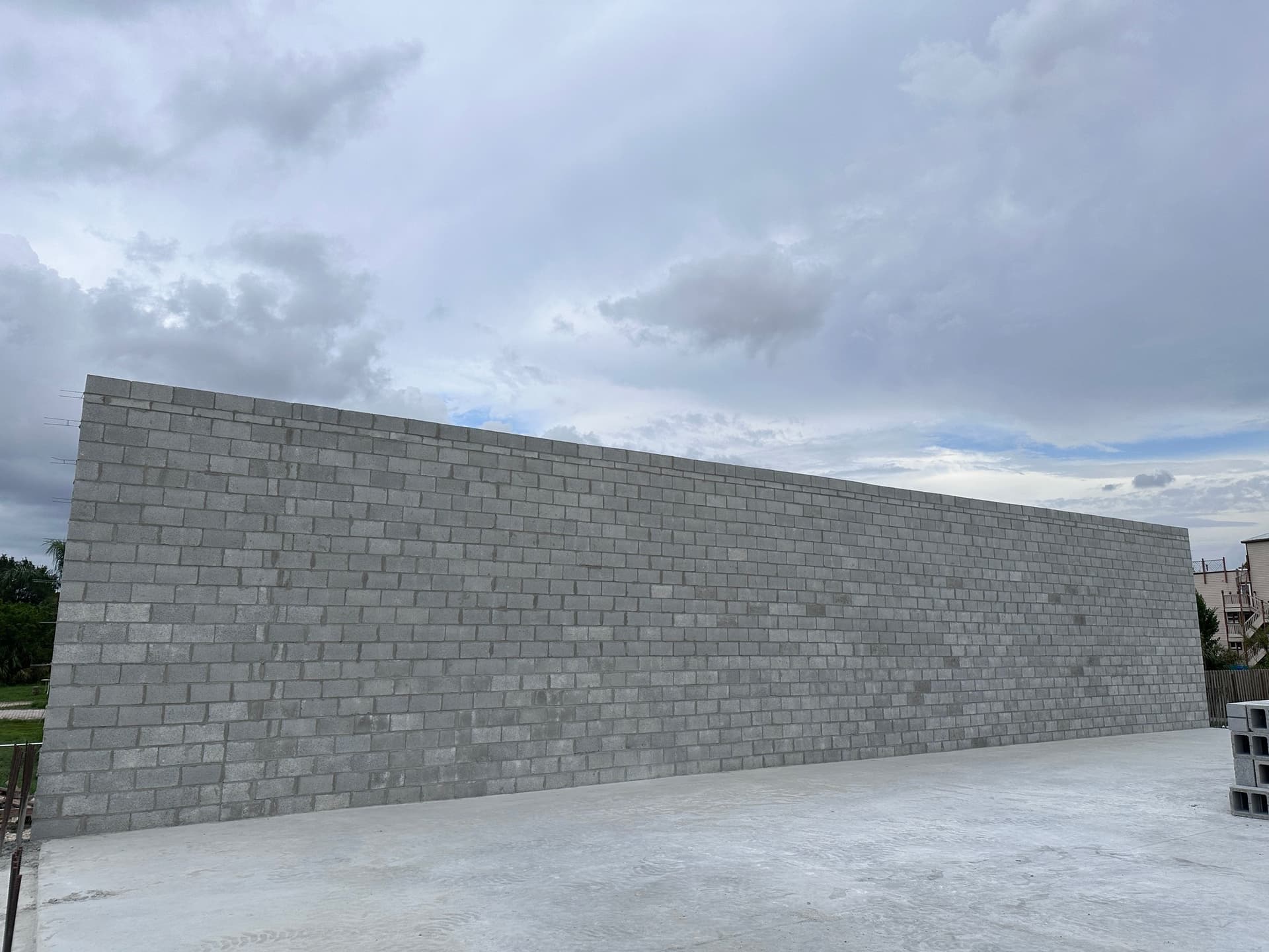

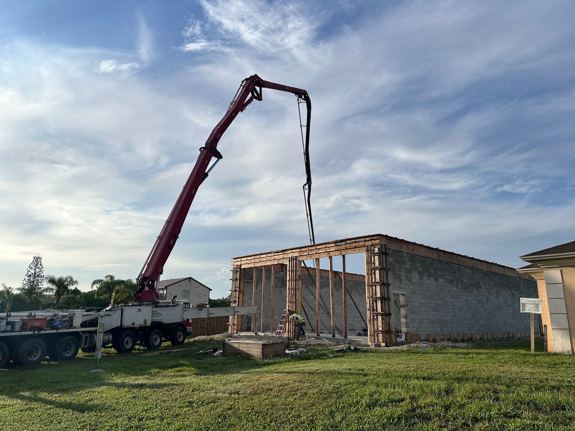

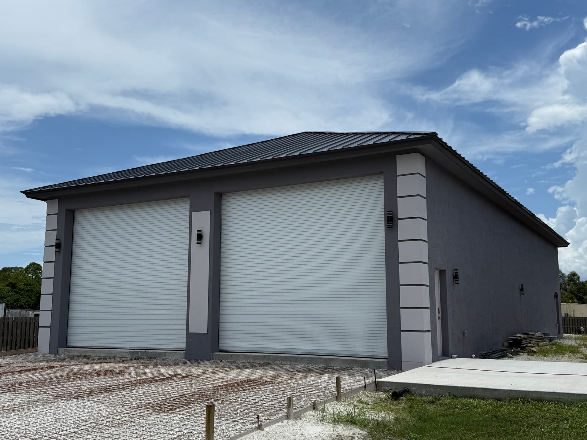

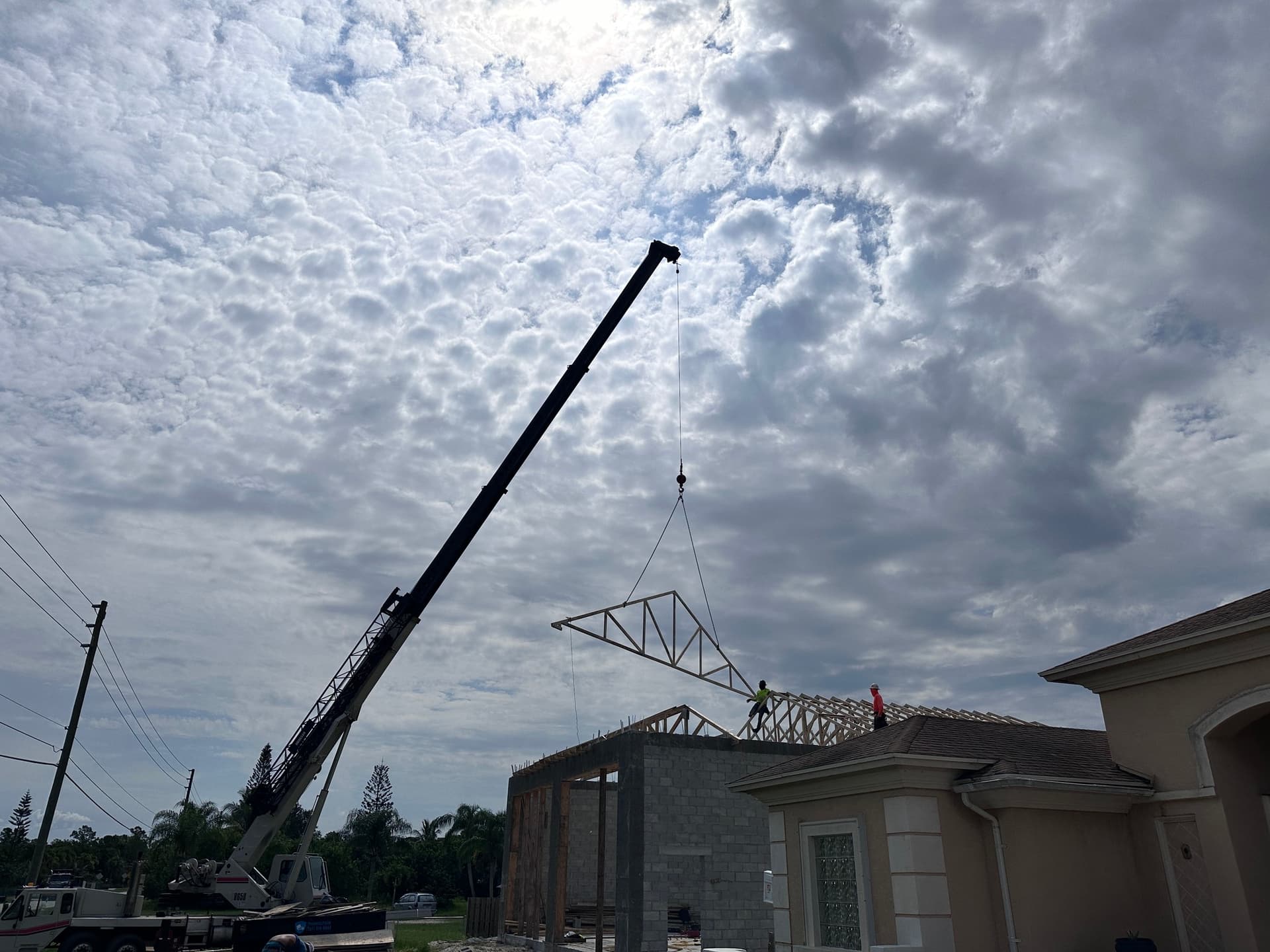

Bought my property in unincorporated Palm Beach County 2017 with the express purpose of building a shop. Was very slow to make progress, needed to excavate and bring in 120 dump trucks of #1 construction grade dirt, had to dig down to the waterline and layer up from there. Endless list of things to do before even starting construction and post pandemic prices are so high…
My shop is 3040 sqf 180 mph wind rated, 16 foot high, 40x76 CBS with pull throughs, four 14 foot tall doors 16 feet wide. Metal roof, finished interior with stucco inside and out, 400 amp service.
Just got my power turned on this past Monday, making major progress! Wont be long before I can start setting it up…

This right here is part of the reason I love this community :rofl: :joy: :sweat_smile:
Can I come live in your shop…pretty please :face_holding_back_tears:
Congratulations, that’s going to be a dream to work in.
If it is for a business it is very impressive, if it is for a hobby shop it is a paradise, in either case I am interested to see what will be installed, I am sure it will be very nice, remembering some of your CNC installation.

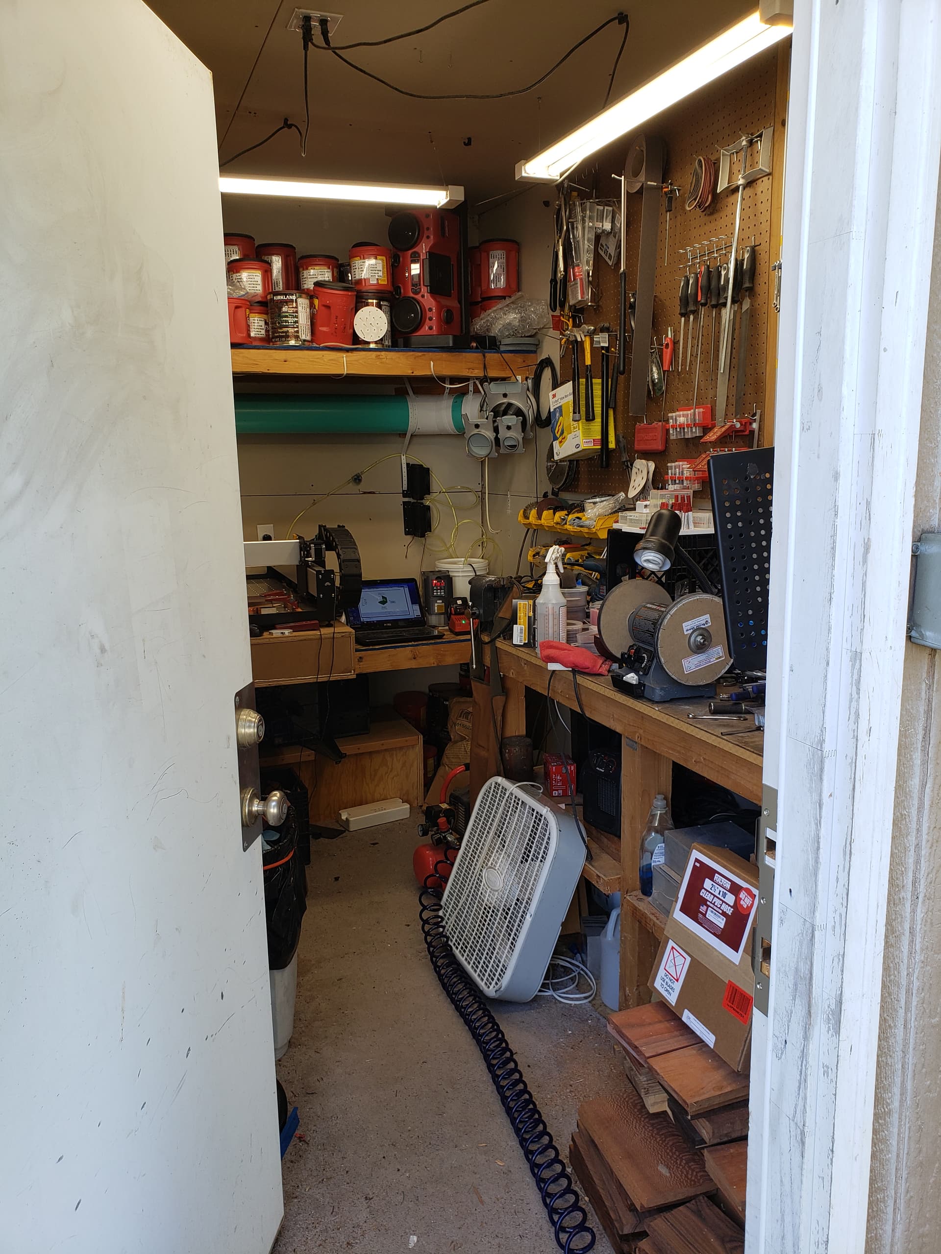

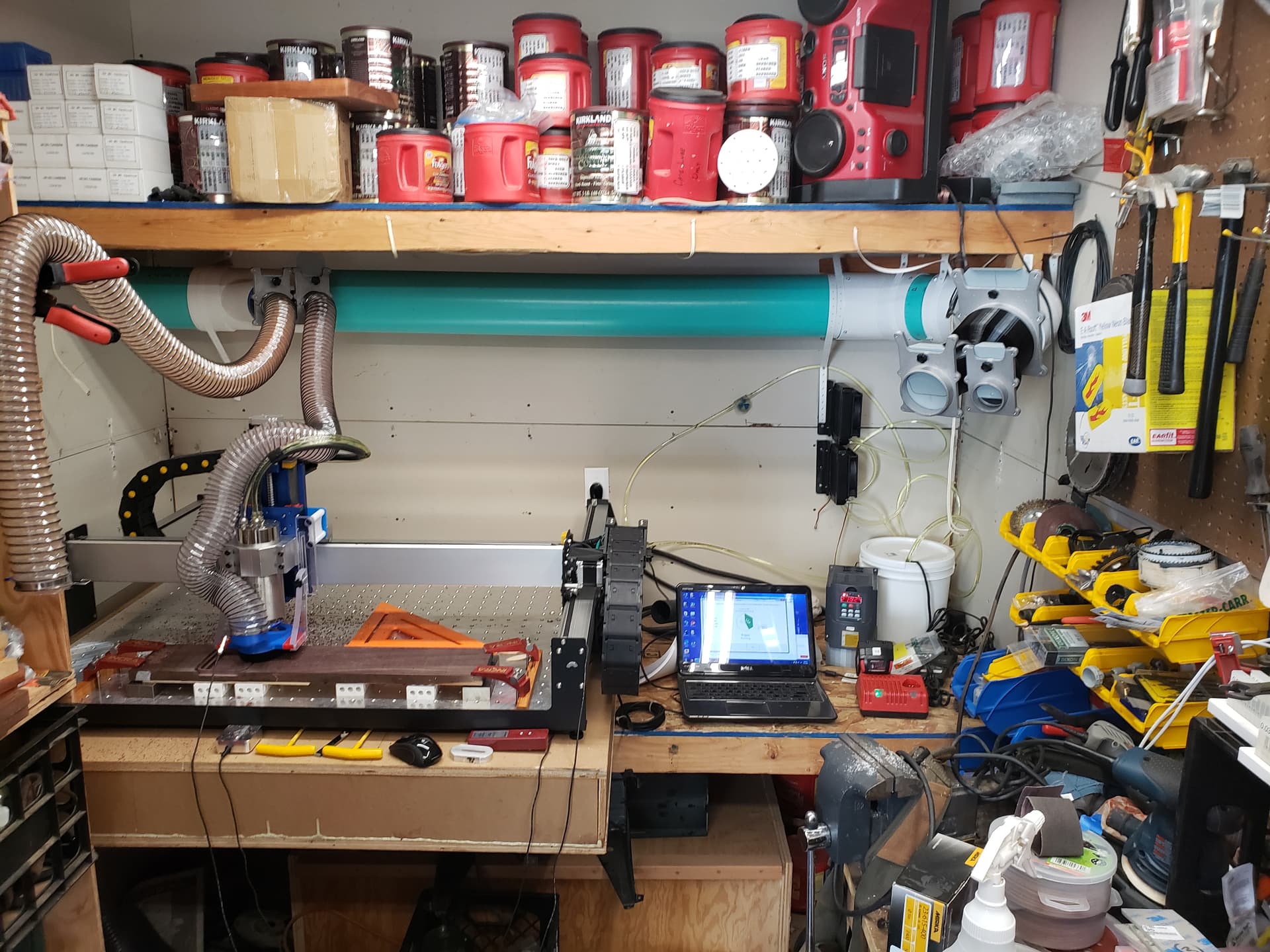

Well, current shed is an 8 x 12 foot shed. Bench on one side, shelving on the other. About 5 foot x 8 foot strip up the middle where I can walk. I can stand at the front right corner of my SO3 XXL, and that is about it.

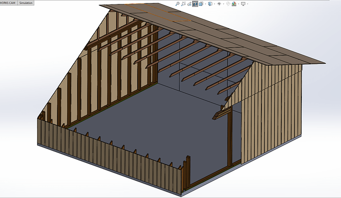

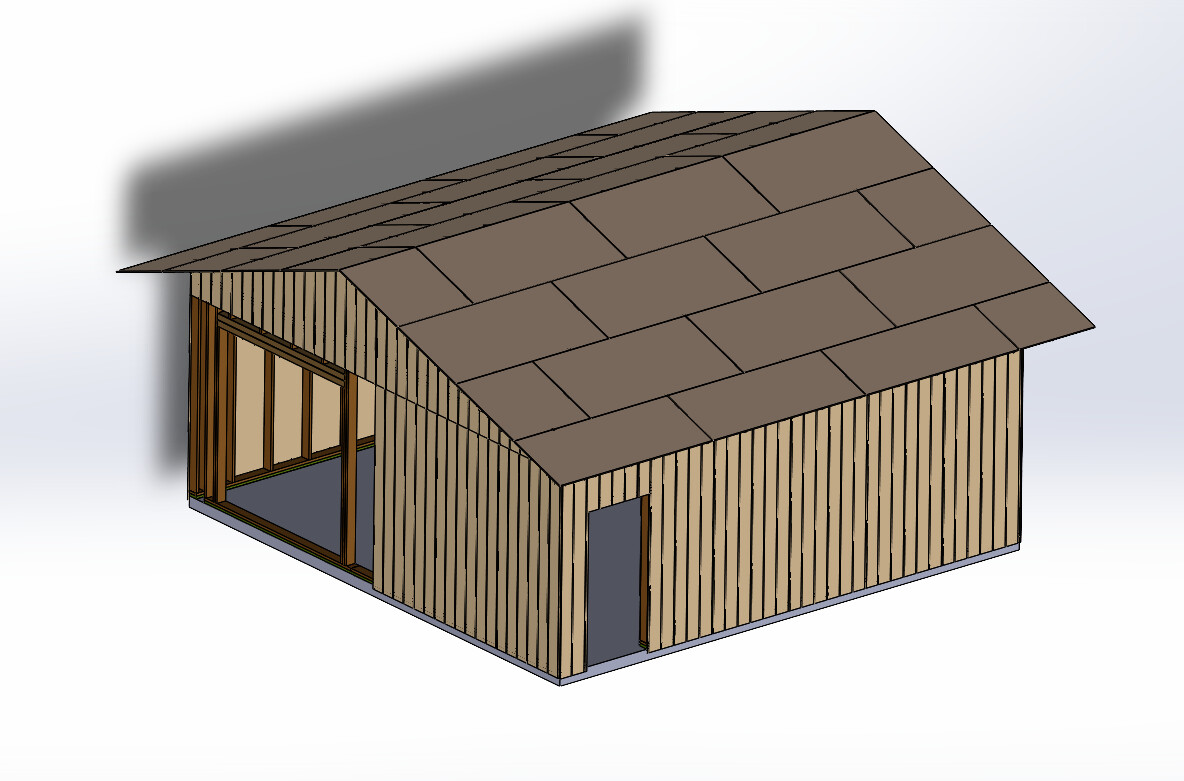

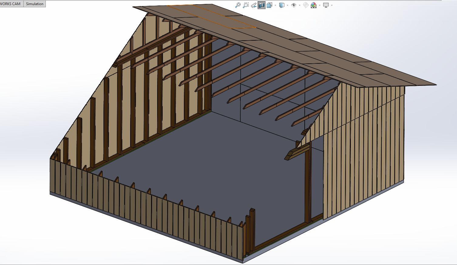

My new shed - so far a concrete pad - will NOT be a 3040 sqf 180 mph wind rated, 16 foot high, 40x76 CBS with pull throughs, four 14 foot tall doors 16 feet wide :sweat_smile: (not laughing at your shop, just a bit jealous) but a 24 x 24 foot shop with 2 x 6 insulated walls 10ft high. One 36 in wide pedestrian door, and (most likely) an 8 x 8 foot roll up door. Not sure of the dimensions yet. 8 x 8 foot seems big enough for anything I can imagine as of now.
Still working on the design, but here is a couple of views of what I have so far. I originally was going to just kind of rough it up to get an idea of materials and cost, but I just keep on working on it here and there while I procrastinate drilling holes in my slab for the mud sill anchor bolts. The trusses are just there, but not designed since I just needed the angle and lengths right for now to get the shape for the roofing material. A truss company is going to design and make them using the codes appropriate for my area.
Shortly - once the last two walls are designed, I am going to start dropping in my work bench and dust collector and other tools I have or plan on getting for the shop. Just about everything will be on the heavy duty wheeled bases so I can move things around as needed, since even though I will have ~6x the work area of my current shop, it’ll get crowded fast if things are mounted to the floor. Then I can play “interior designer” and see where things can go - outlets, dust collector and run of DC pipe around the shop, bench, shelving, shaper. . .
Go with a 10x10 roll up door, the 8x8 sounds big enough until it’s not! It allows you to back in a pickup easily load or unload “stuff”. One of the best decisions I made with the shop.

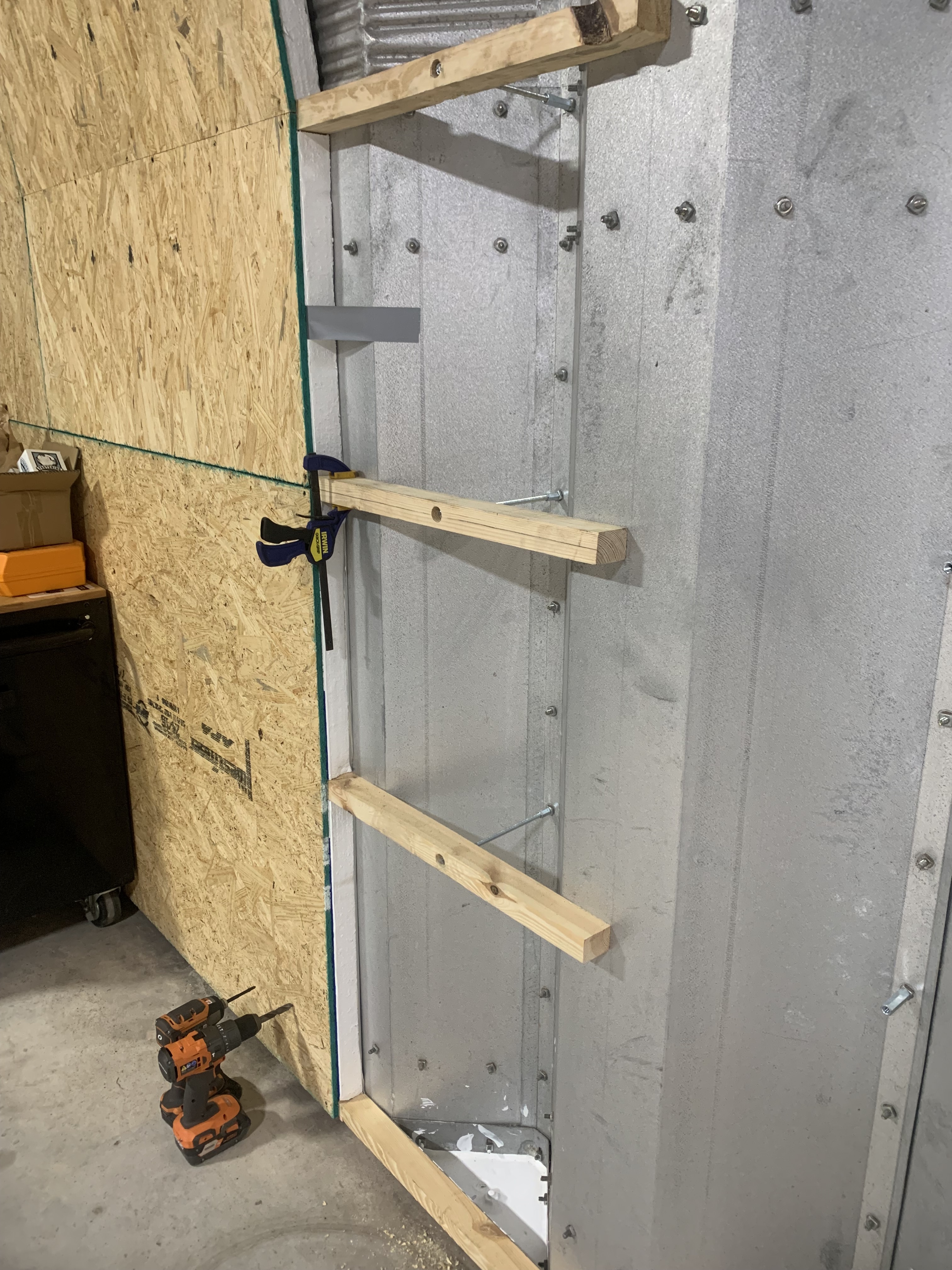

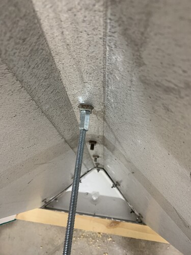

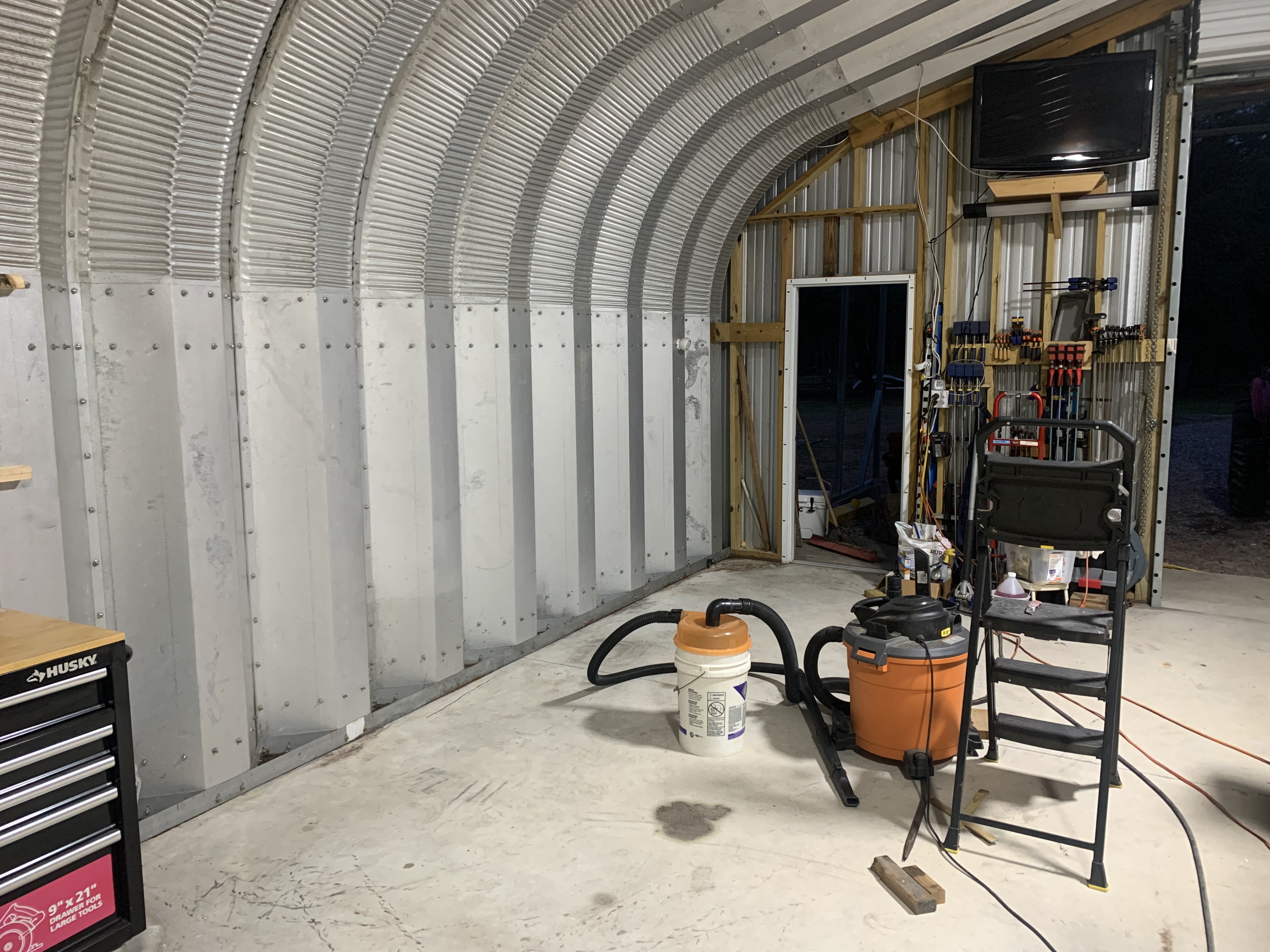

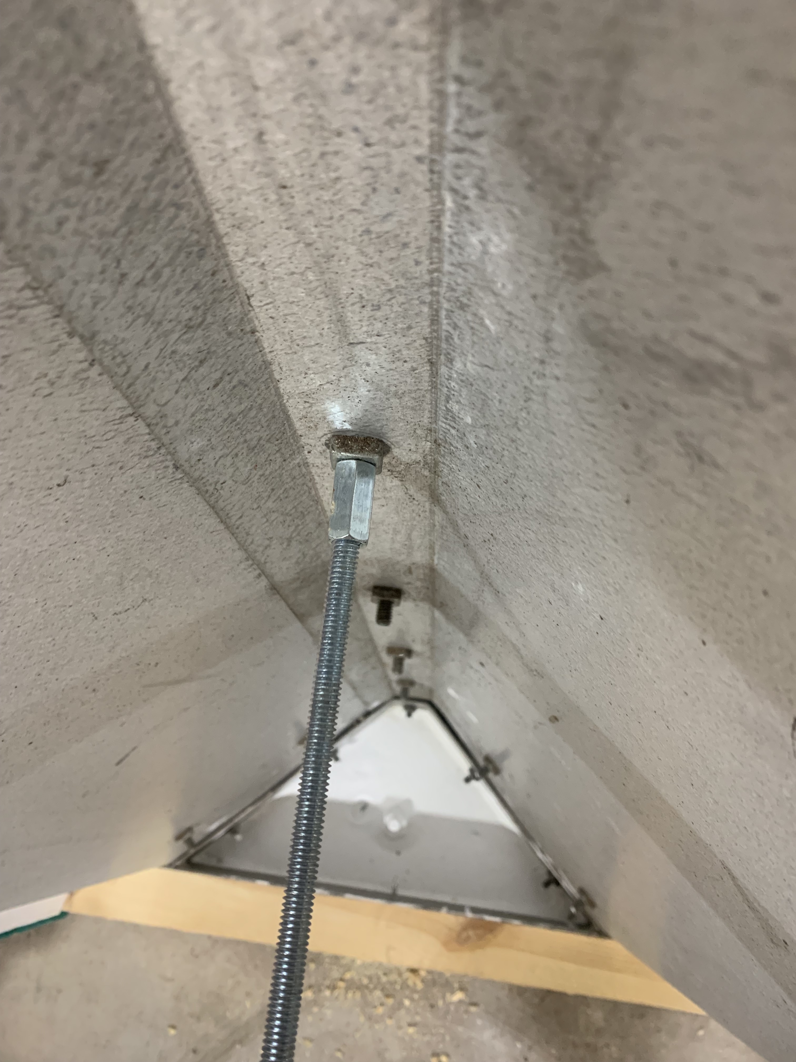

Here is my version, I skipped the spray in foam due to being cost prohibitive in my area. Ridiculous what the quote was from several different companies, thats another story…. Especially for the final R value it provided.

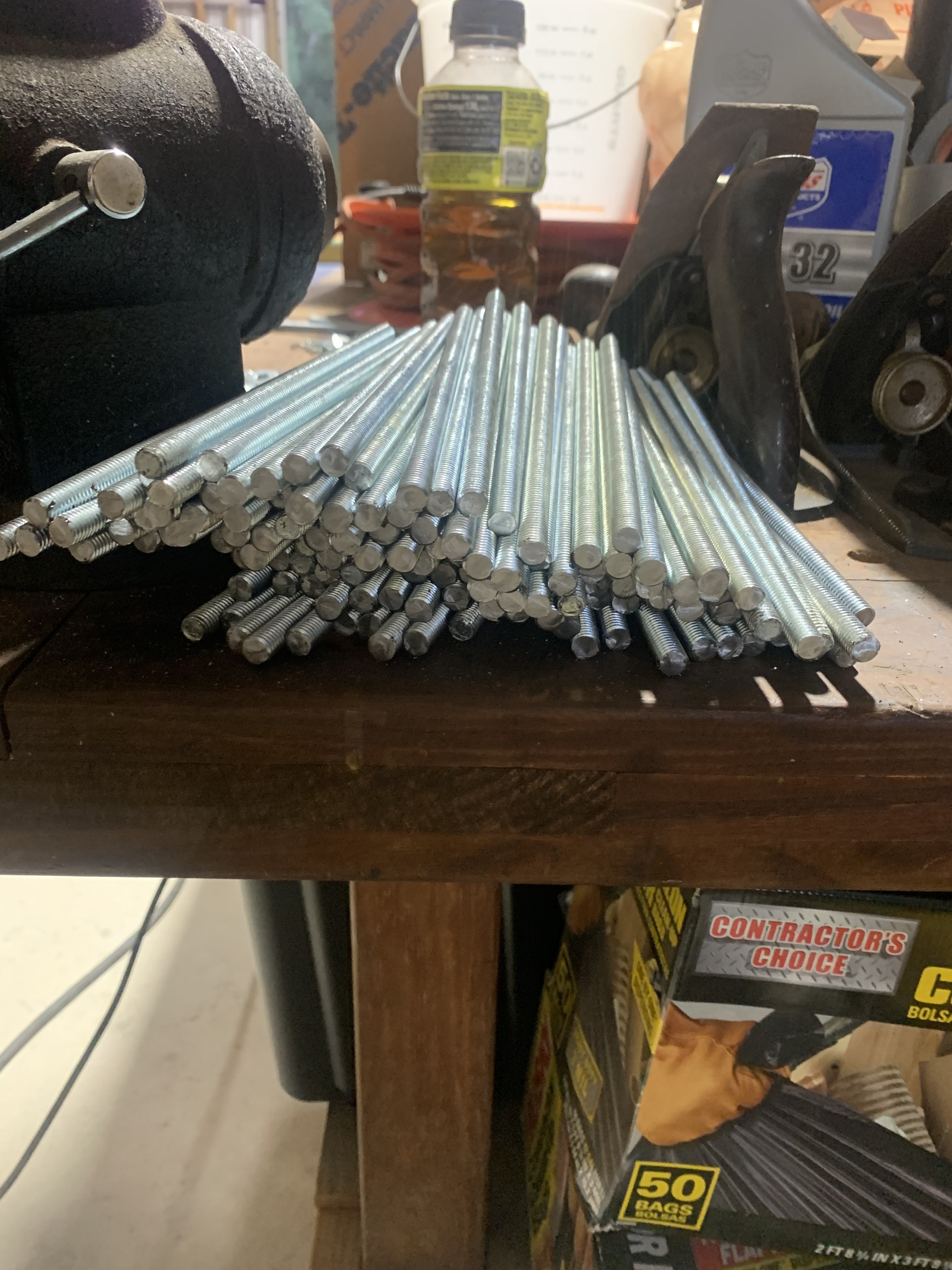

I went another route, took longer but once I worked out the work flow it was manageable with just 2 people. 5/16th coupling nuts and 6’ lengths of 5/16th all thread cut to size worked very well.
That looks exactly like the same metal building I used. One advantage of the spray foam was that it helped seal up any leaks that were due to poorly tightening some of the 3 trillion bolts. That was 25 years ago. I probably couldn’t afford it now :blush:

I like the way you braced the strips across the metal. I put my coupling nuts on the portion of the metal closer to the inside and attached 2x4s to them to support the OSB. In your way there is probably more structural support.

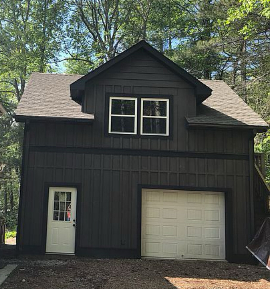

So…I started that way too. Same size and everything. But I said to myself why not just go up and get some more space. Eventually, I went crazy and added a dormer in the front and a shed roof out back. There’s days that I wish I had left it as a shop like you are planning. Time money and effort involved in that upstairs part is more than what I really want to take on to finish out.
I will tell you the is was the final method chosen to install insulation. This allowed me to use the walls for hanging cabinets, shelves or racks of sorts for storage and organization. This very sturdy, I cut down 2x6’s at 2” width. This left me the 1.5” in height to attach the OSB with 3/4” between sheets os OSB to fasten with and the 2” width was for the 2” insulation. Worked very well. Now I just need to finish the other half of the building, had to stop for several projects. And now its a tad toasty for working the the day on this.

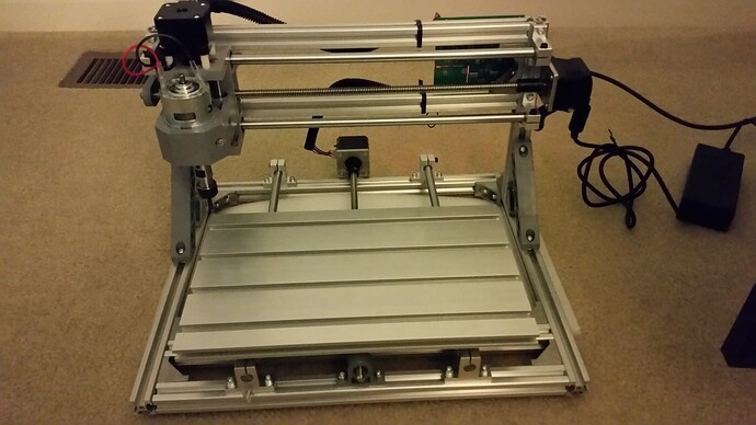

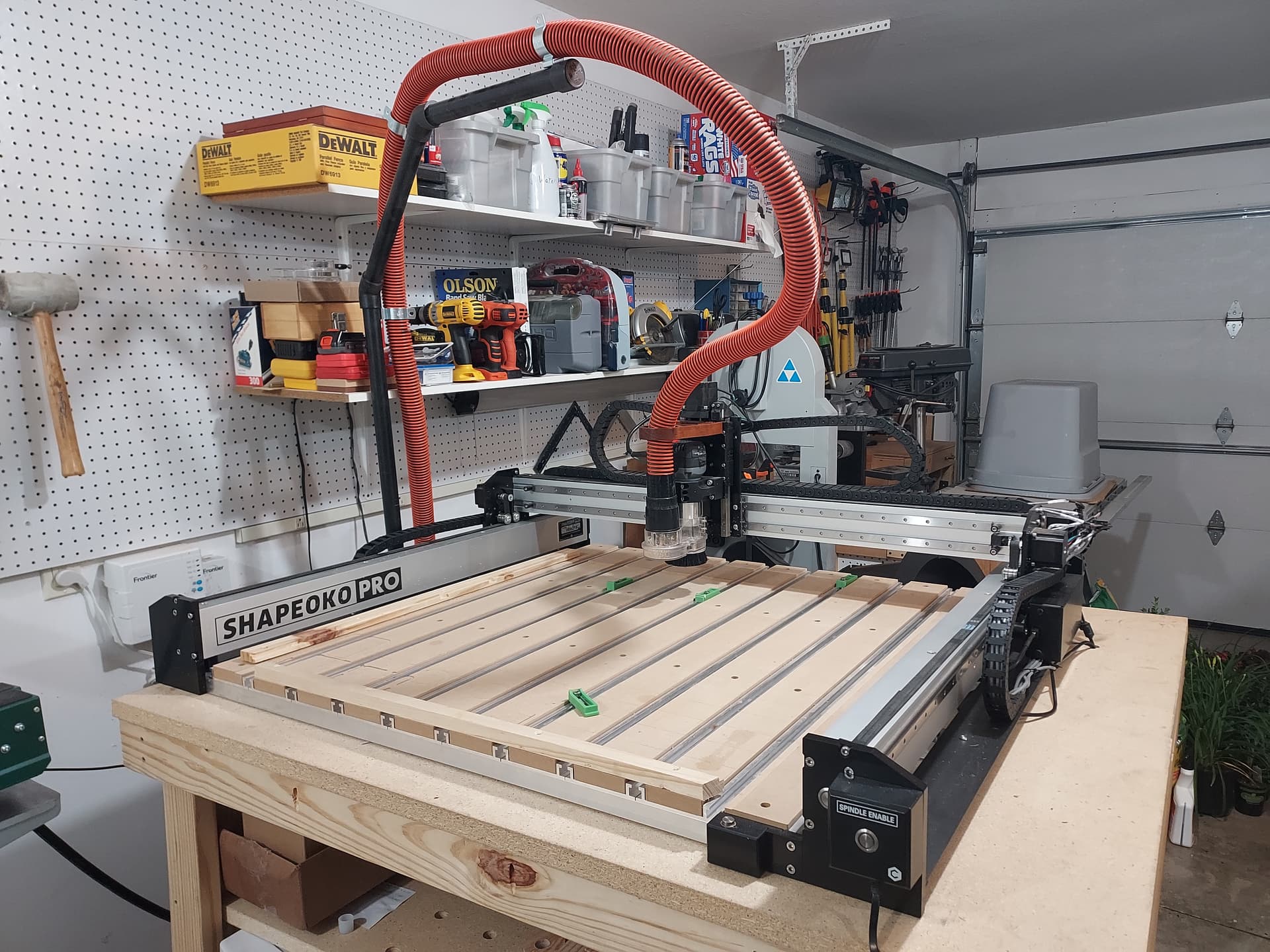

I am jealous of the space most of you have.
This was the start of my CNC journey. Before this I only had power tools.
Now I have one side / wall of a two-car garage.
Along that one wall is a sander, planner, band saw, table saw, drill press, laser, cnc, jointer, tenon press plus a few other power tool items on flip carts I don’t remember at this time.
Fun, fun, fun!

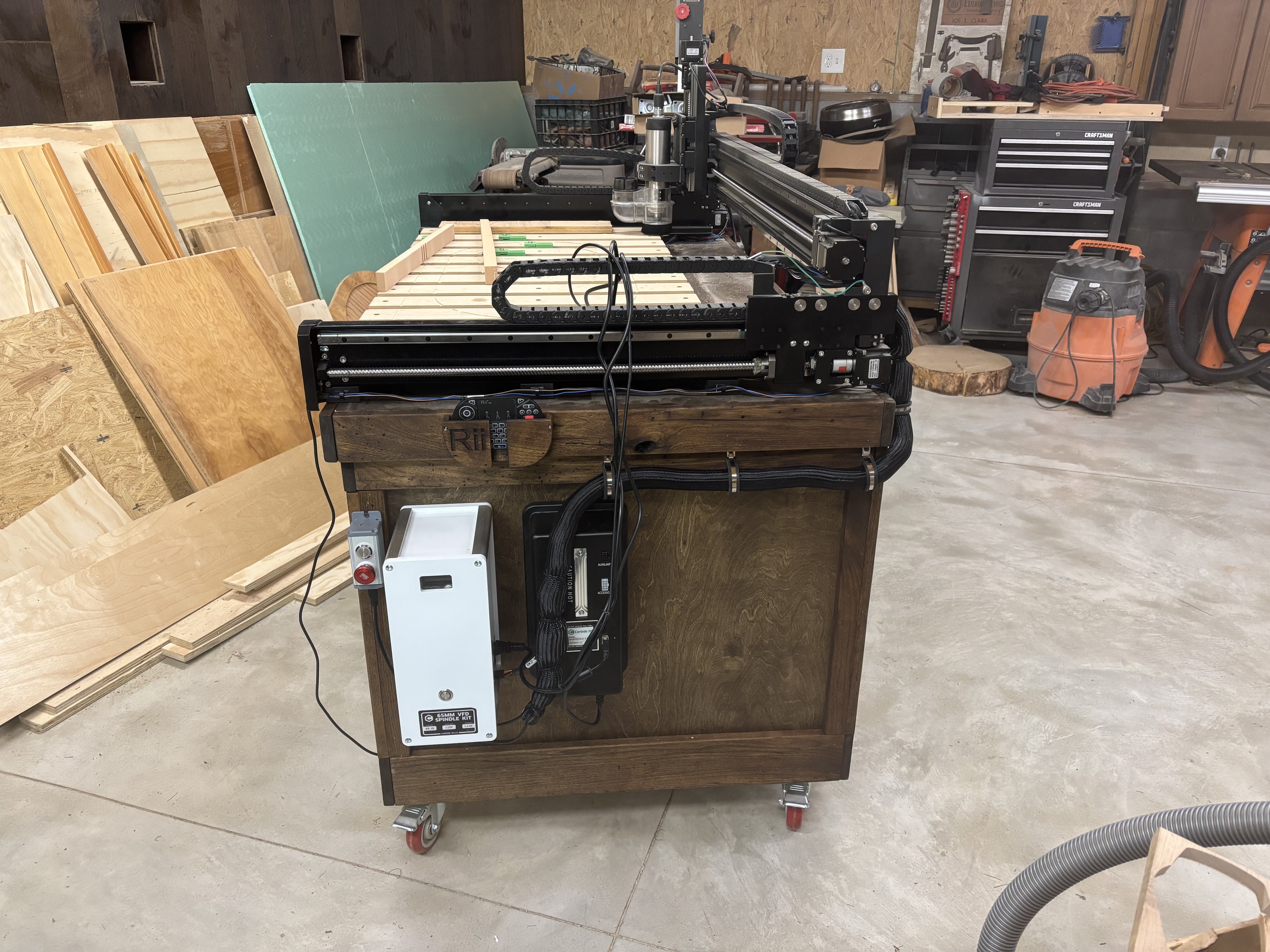

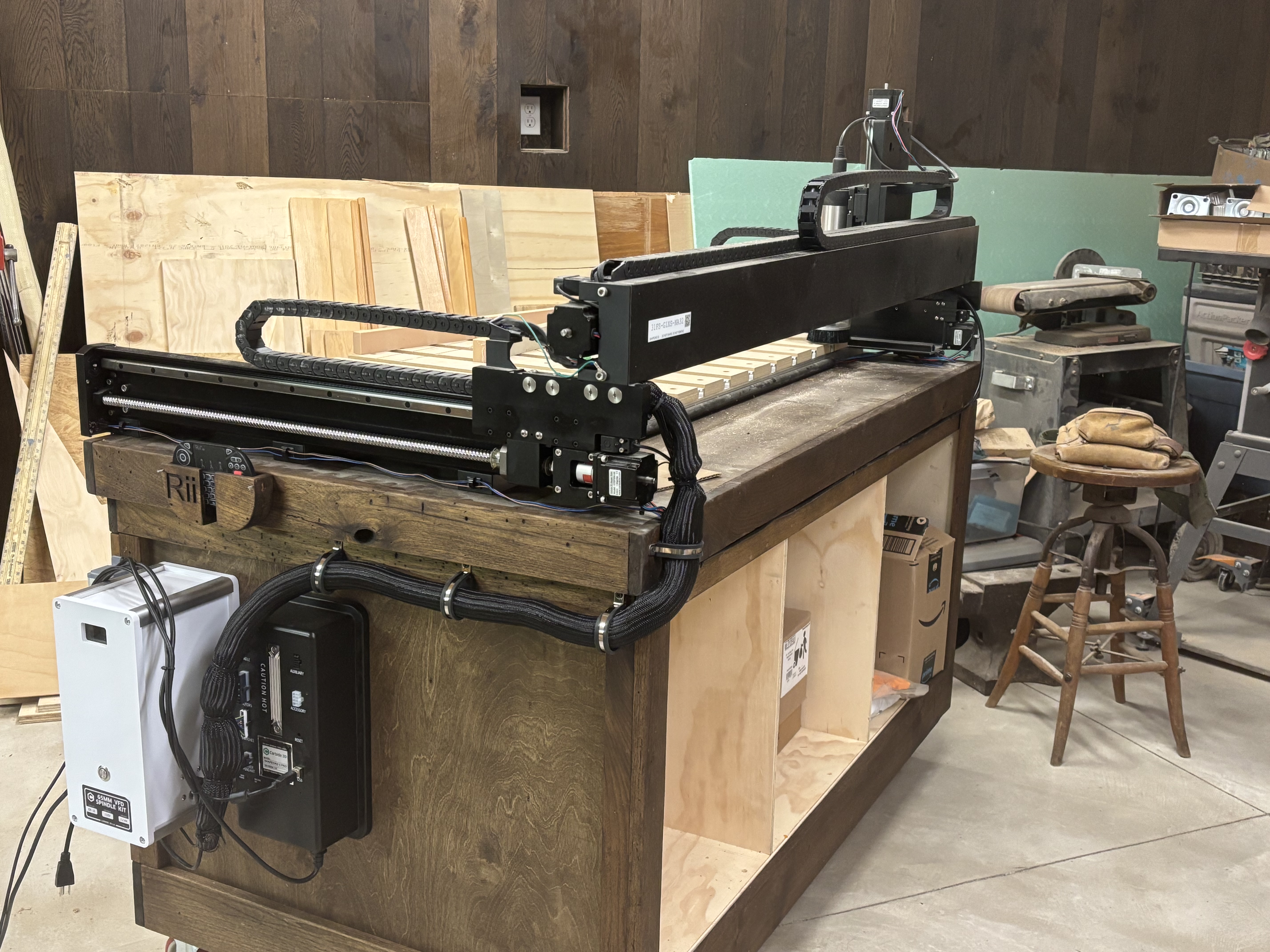

I couldn’t stand the wires just sprawling around my CNC anymore! So I cleaned it up.
Looks much cleaner for sure!
