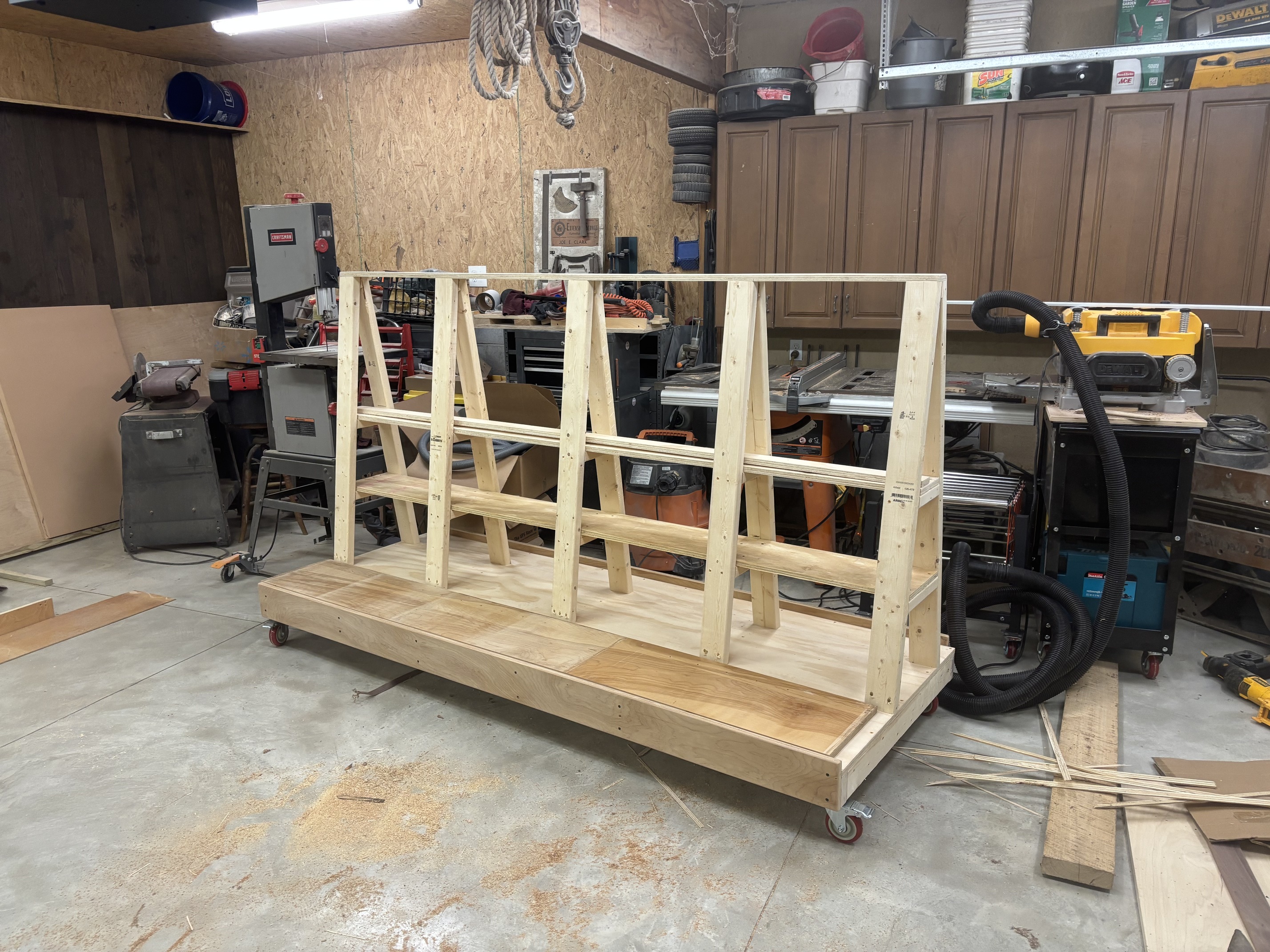

Finally pulled the trigger on a rolling sheet material cart. Just got sick of have plywood and HDU stacked against one whole wall and up against my garage door. This will consolidate it all and I can roll it wherever I want to quickly get it out of the way as needed. Already have future upgrades to this in the back of my mind. Note: I made one side narrow to hold up to three full sheets of 1 1/2" HDU and the other side is for everything else. AND I’ll be able to put long boards in the center.

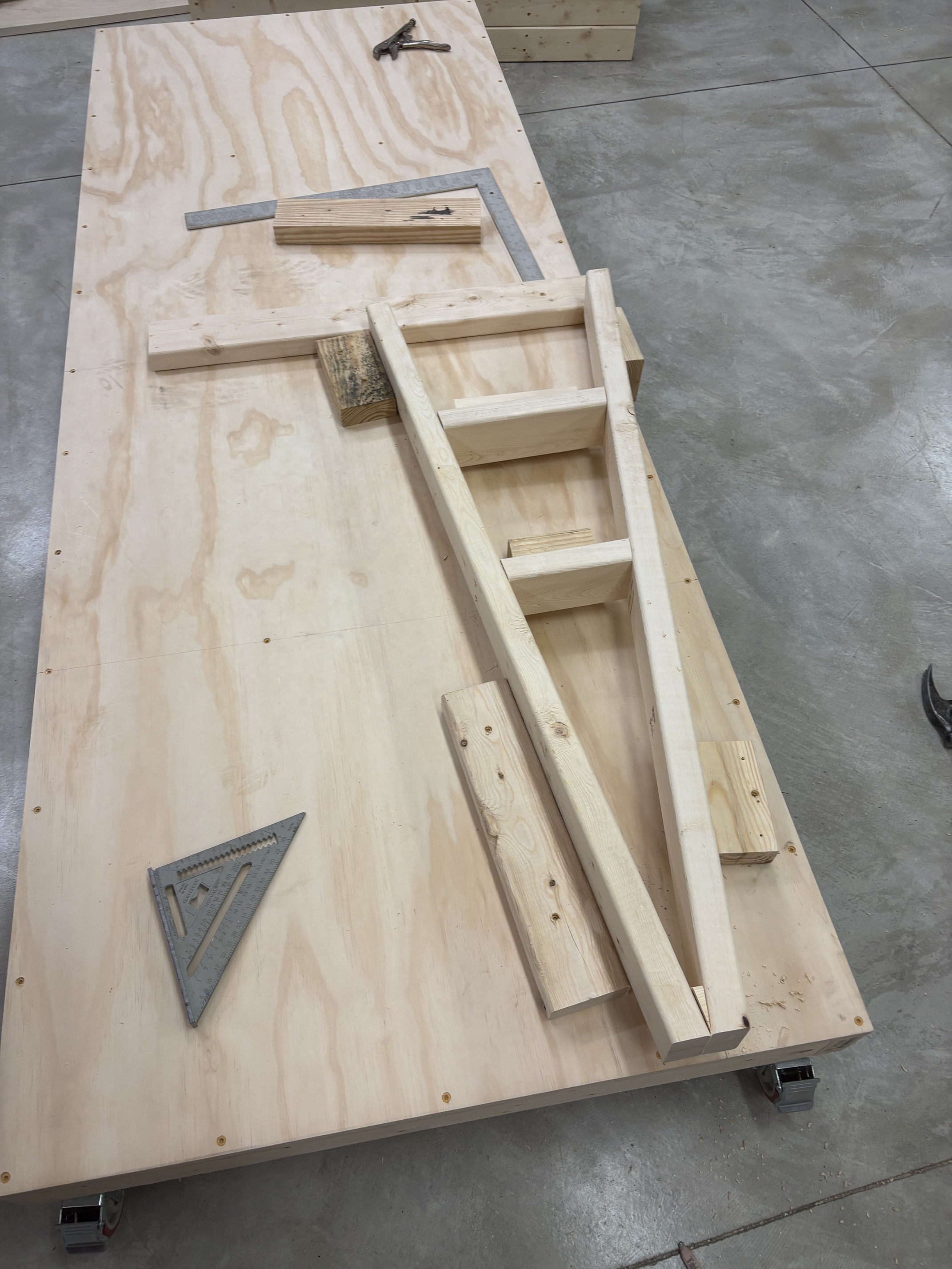

I built the rolling platform first then created a jig on the platform to make all the uprights exactly the same. And they WERE exactly the same! Yesss.
32"x96" base
Uprights on a 7° angle
Here’s the casters I have used on EVERYTHING! 4 are rated as 2200 lbs.

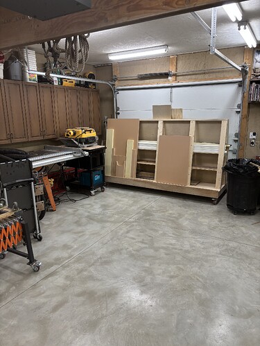

Good day in the shop today. Loaded up my new sheet material holder and general “clean up”.
[grid]

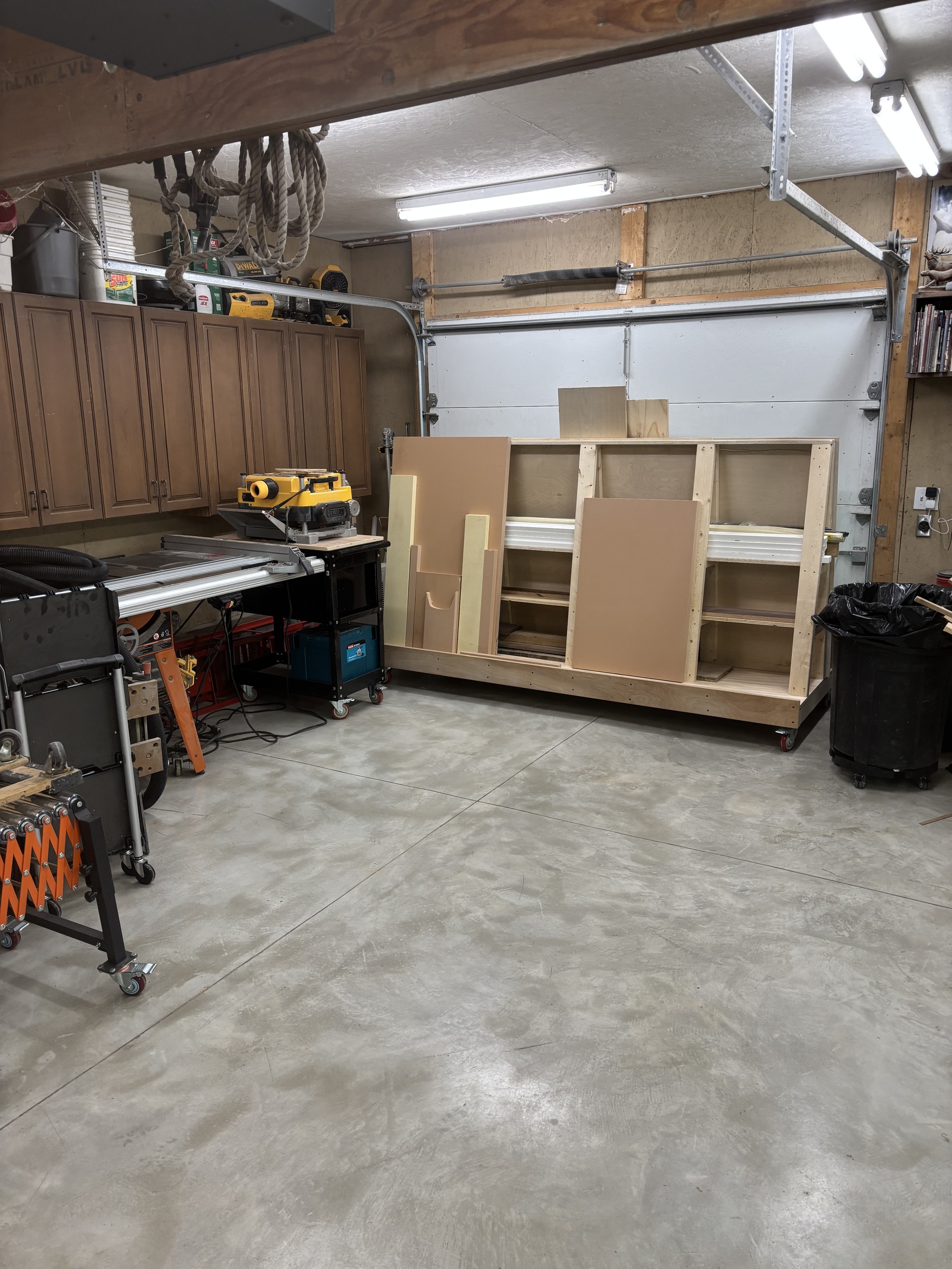

Here you can see why I desperately needed it. Look at that pile of stuff against the back wall.
And here it is without! Glorious space!
Next? I’m thinking French Cleats.

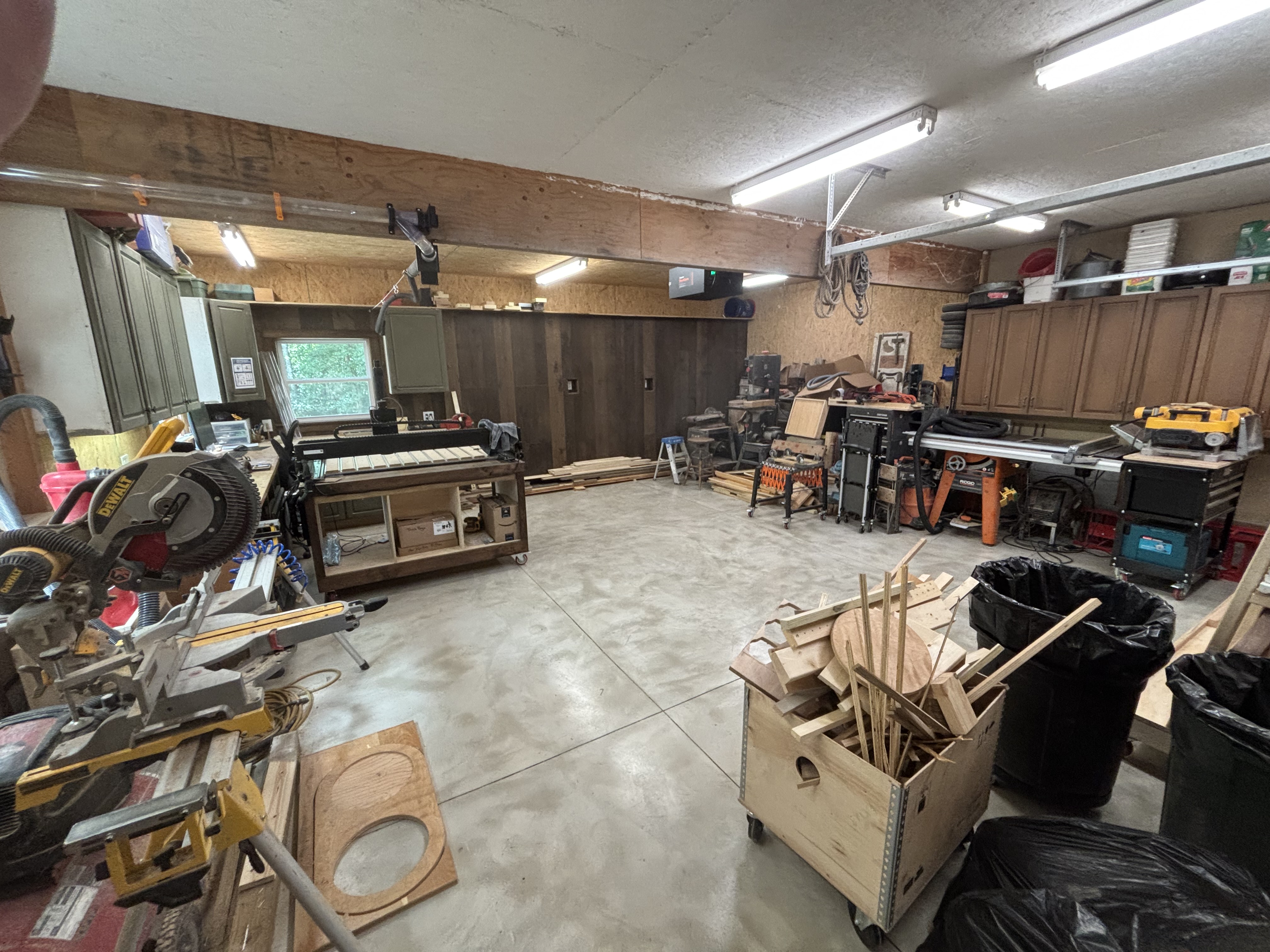

Not sure why this post got opened up again, but since it did, here are a few upgrades I was able to add during a recent 2 week vacation.
Finally got the French Cleat wall going.

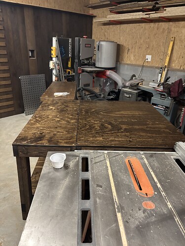

Built 3 outfeed tables, one of which has a dog hole system incorporated into it. Used this video. He made it easy! https://youtu.be/MwGb4NK42O4?si=AONEDcuuO-DVv6pL
