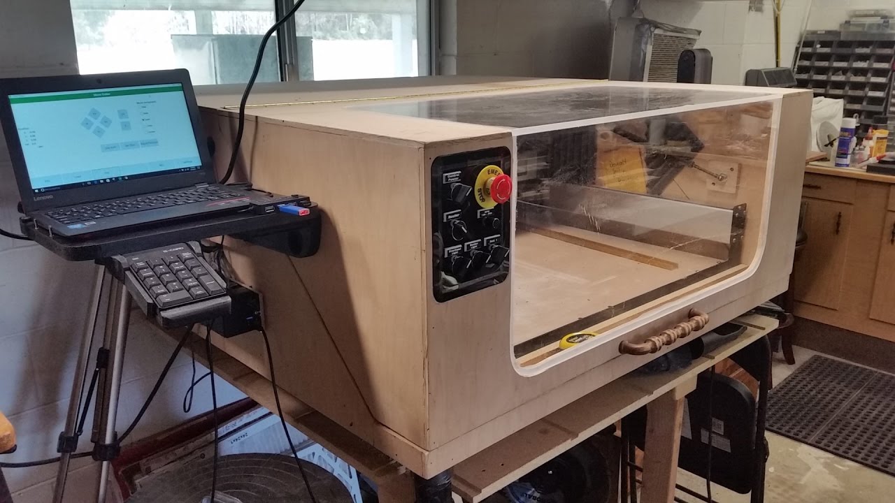

Noise testing results…
More effective at lower to mid speed router settings which is what I use for 99% of my work.
If I remember correctly, these numbers were with the router running but not cutting. The video I posted above demos the sound attenuation with it cutting.
I wouldn’t want to work in my shop with an unenclosed router now that I’ve gotten used to this. It’s a night and say difference.
