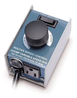

Add a router speed controller to you vac so you can run it at lower power. Mine can do a good job with the vac turned down to around 60% power which is much quieter than full power. It will make your vac last longer too.
Hmmm… a router speed controller? Are those also called ā€œPWMā€?

I too built an enclosure out of MDF for my shopvac. Inside the box is a stand it sits on top of with a series of channels for the air to leave the box, it breaks up the exhaust. Even with the shopvac at full speed I can hardly hear it but when turned down with the router speed control I can barely hear it with my head a foot away. This is the speed control I bought: https://goo.gl/RKqC5R
Actually, I mainly made my enclosure out of good plywood. It is the fine dust from CNCing MDF that is unhealthy to breath, which is why I built the enclosure.
They do use PWM to control power.

You -do not- want a cheap ā€œrouter speed controllerā€ - they look like dimmers (run <$35 or so - and are seriously overpriced). #1 they won’t work with the dewalt (which has an internal speed controller), and #2, I have yet to see one that is UL listed…they’re pretty sketchy. SuperPID - Expensive, requires mods to the router, I hear it works really well, and can be hooked up directly to the GRBL controller for PWM speed control via commands.
Stay away from this general type:
I think that one of those might work with my vacuum, to lower the noise and control the amount of suction. I wouldn’t use it for controlling the router. That is a job for a SuperPID.
