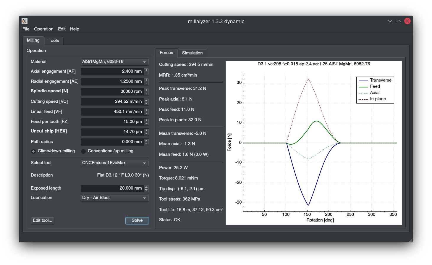

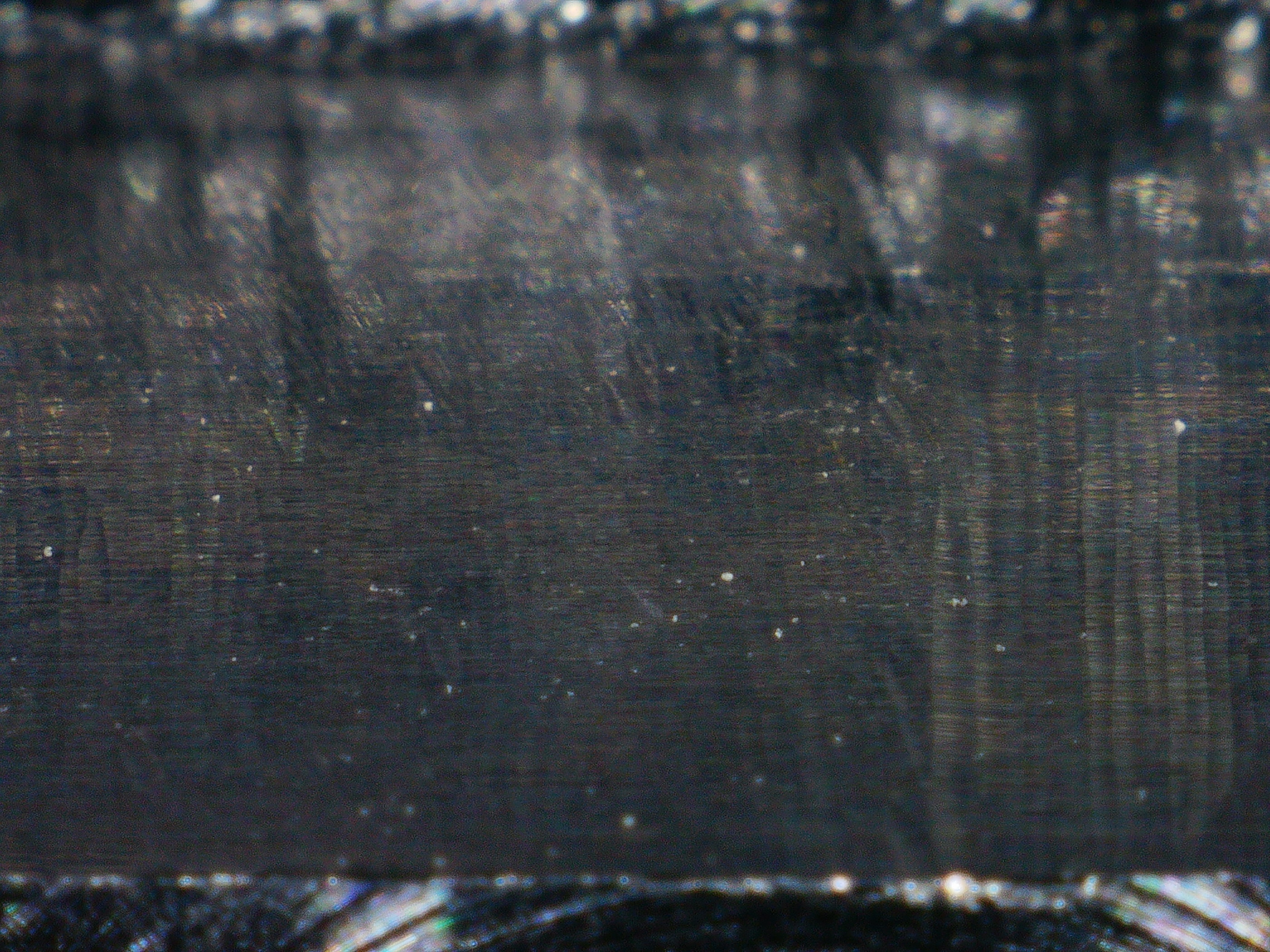

I did a couple of test runs with 1/8" endmills using an adaptive toolpath at 30kRPM, 1.25mm axial, 2.4mm optimal load and 0.015mm chipload (450mm/min).

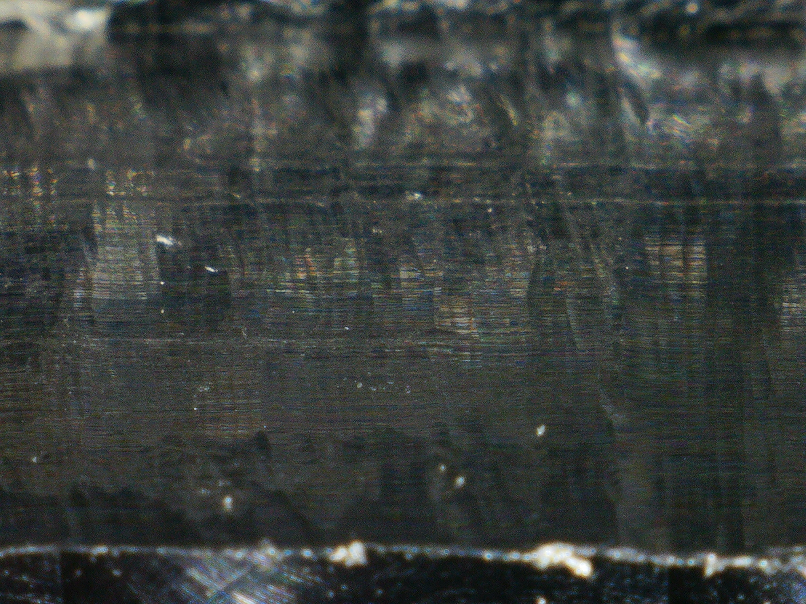

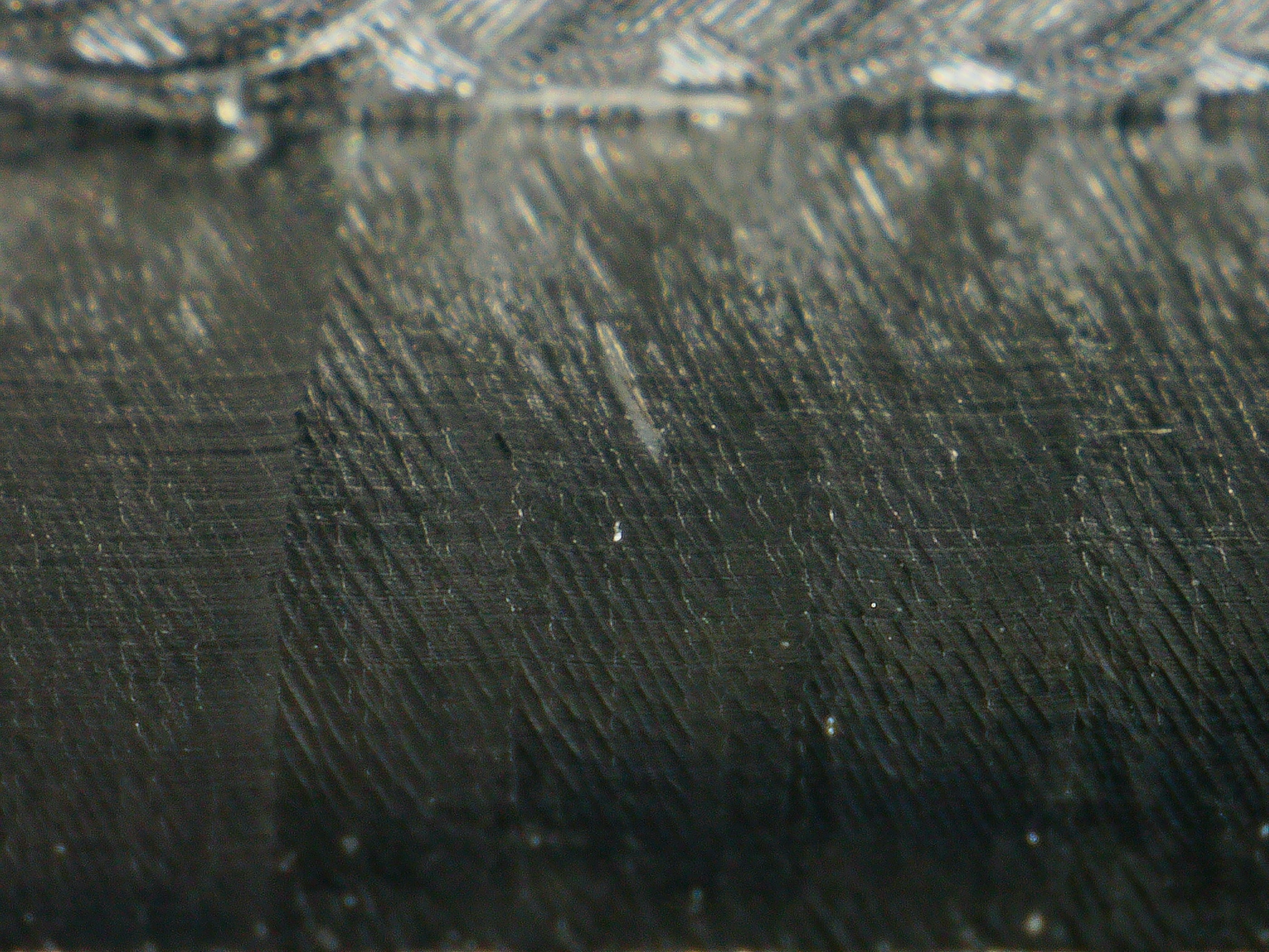

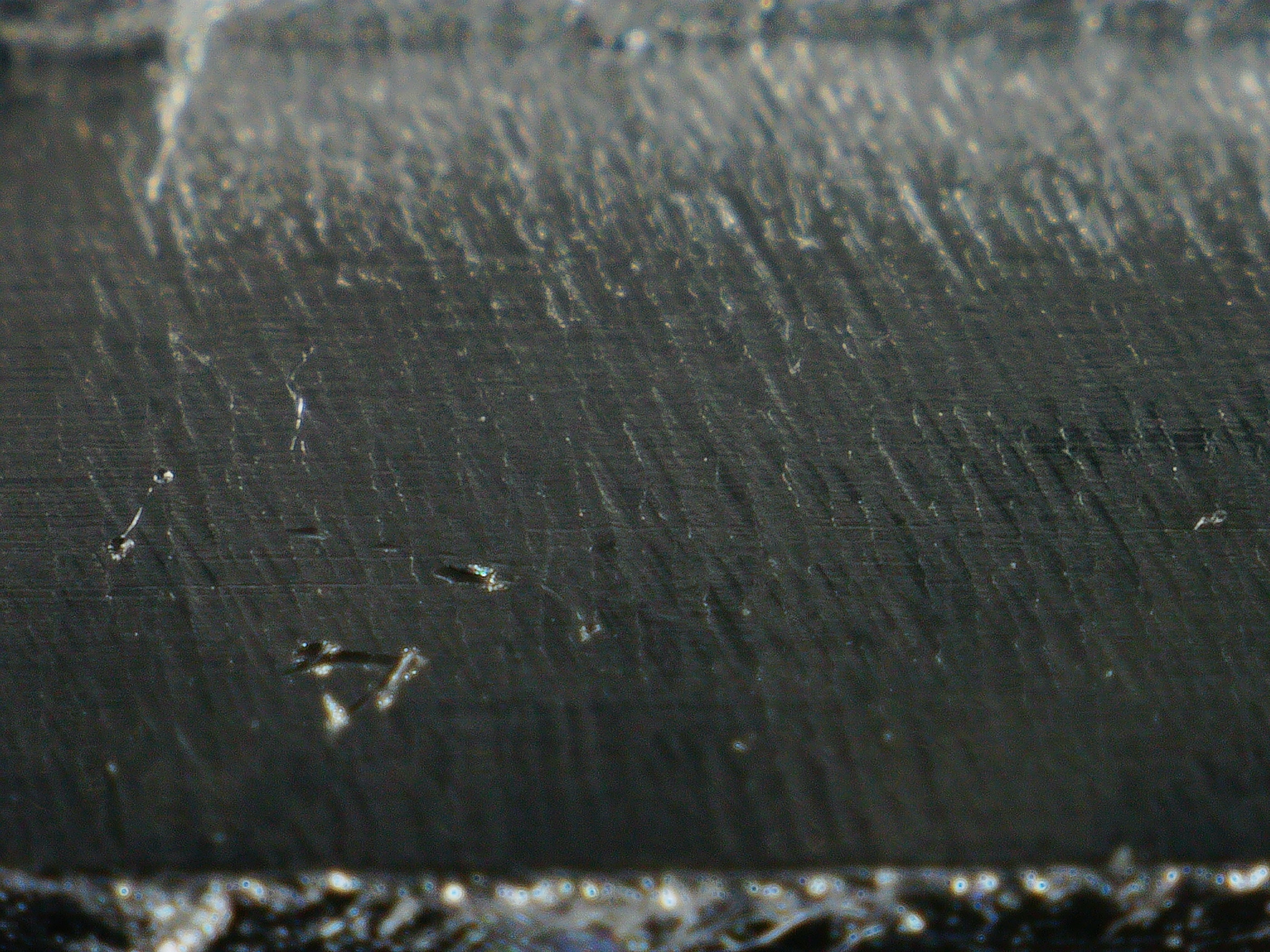

Unfortunately after I finished, I found out that I had no vibration data but at least I got to play with my new microscope. I bought a cheapish Chinese digital microscope and used it to inspect the endmills and the milled surfaces.
Millalyzer:

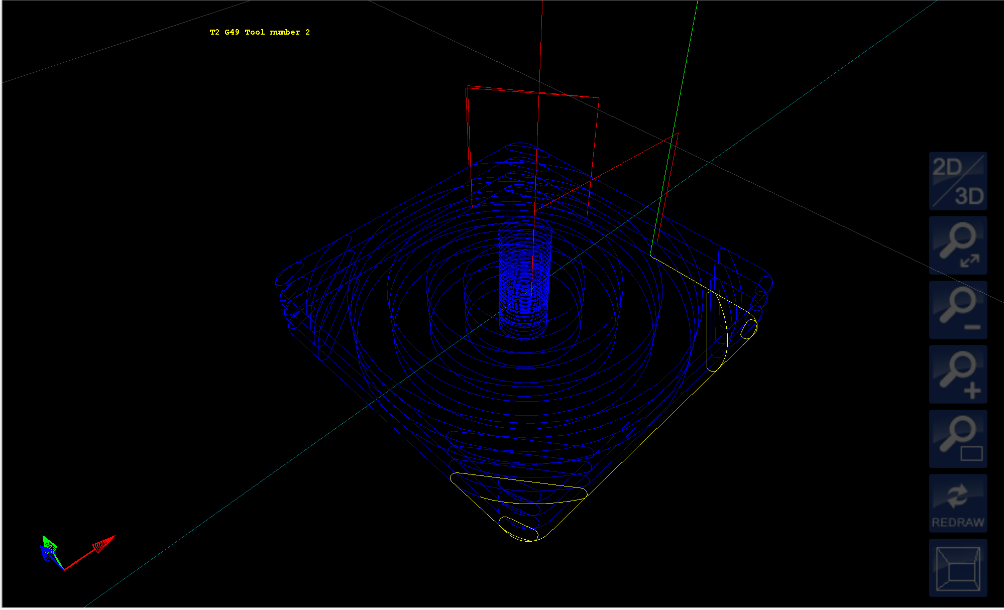

Toolpath:

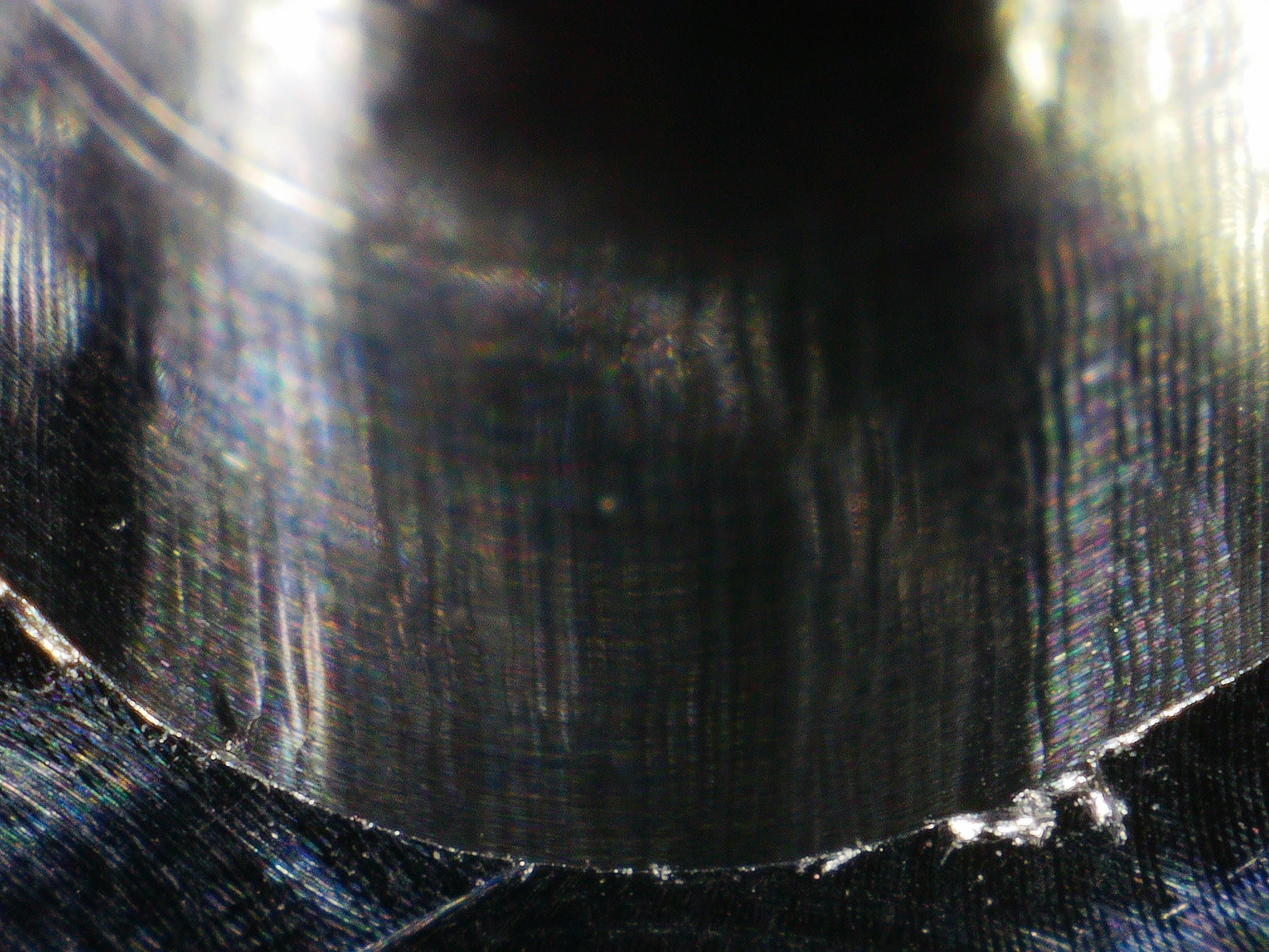

Result images:
I don’t think it really shows in the microscope images but one really interesting thing was that the pocket for the EVO MAX endmill was visibly more reflective than for the other one.

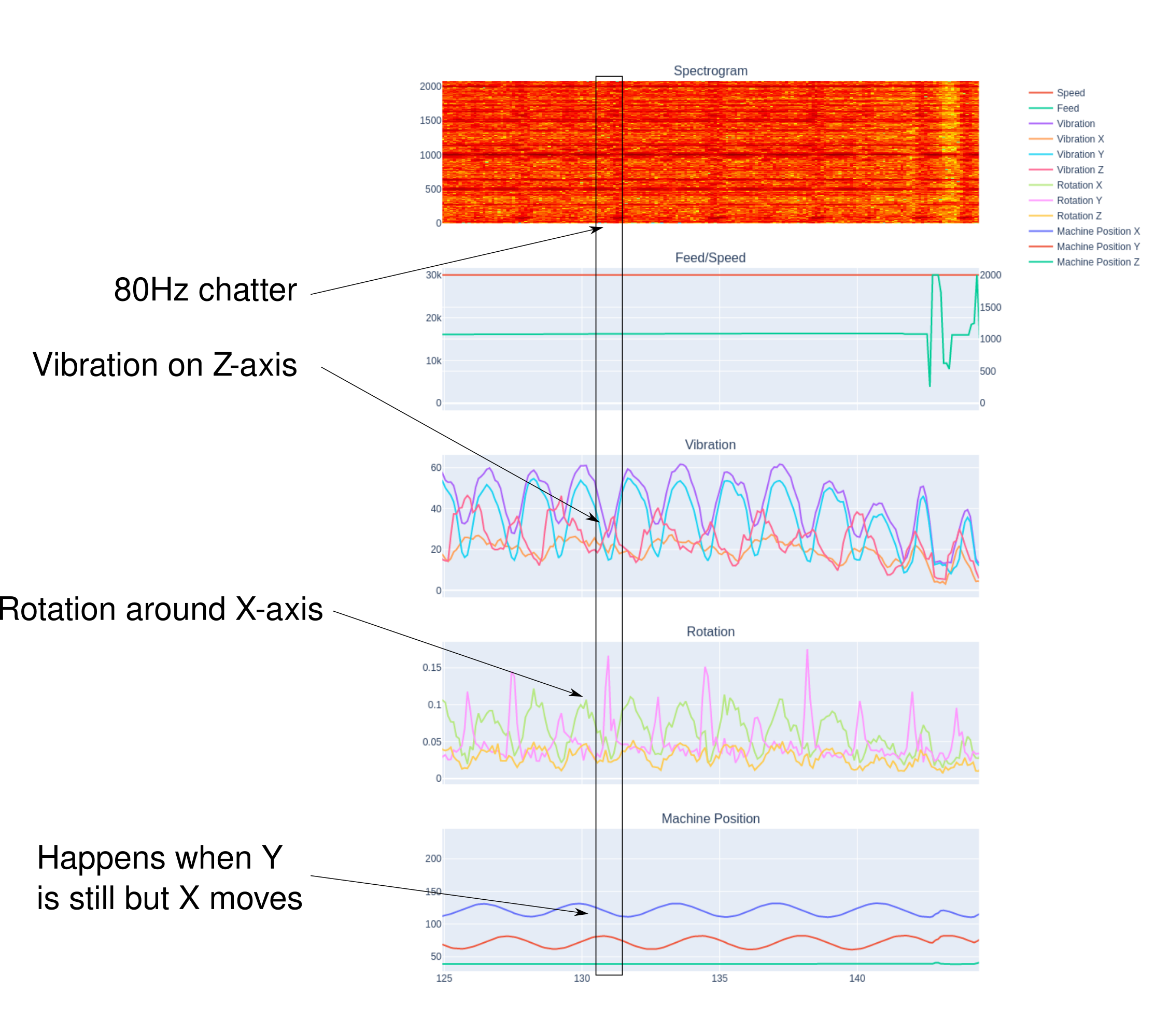

I got my accelerometer data collection working again and was looking at DATRON feeds and speeds for some reason and decided to try a high-ap, low-ae cut again.
This is just moving from right to left along X, as usual, 8mm ap, 0.3mm ae: Readings
It sounds really unpleasant when that vibration around 80Hz starts but the chips are so nice and the MRR is twice as high as that cut above…

These toolpaths are both very similar to the one above. The only major differences are the parameters and the fact that I generated it with Solidworks VoluMill instead of HSMWorks 2D Adaptive.
@LiamN’s point about the spiral turned out to be pretty spot-on, it revealed that there’s a pretty narrow angle in which I see issues, aside from that the cut was reasonably smooth:

Have you tried varying the spindle speed to see if it’s possible to avoid the resonance mode that the spindle gets into?
Not yet. The weird thing is that it happens around 80Hz, which is nowhere near the spindle frequency (500Hz) or Millalyzer’s predictions:
I might try it at 20k RPM though and see what happens.
It’s not at about 83Hz is it by any chance?
Could be, the FFT resolution isn’t high enough to say for sure. Why?
A little reading suggests that it’s more usual in a mechanical system to excite the resonance with a subharmonic (I was thinking acoustic resonances which like the multiples).
Anyway, because 83Hz is 1/6 of 500Hz, in a high-Q resonance it’s possible that you’re exciting it with the spindle frequency as the interaction between the cutter and the workpiece builds up. It was pointed out to me (by spargeltarzan I believe) that the size of the chip on the next rotation depends on the deflection in this rotation so you can create subharmonics of the spindle frequency. Once the resonance has started it will just keep on going.
It’s worth a try moving off to a tooth frequency that is not a even harmonic of the main resonance, might not work but it’s an easy experiment. I have found my Shapeoko responds strongly to this.
Hmm, do you have a concrete proposal? For a second I thought maybe ‘500-(83/2)’ but if the harmonic is at 1/6 and I decrease the frequency, won’t the harmonic just move with it, to 76Hz?
450Hz ? That would be 27kRPM for the spindle I think. If it still resonates there then I’m talking rubbish as that would be about 5.4 times the 80-83Hz resonance.
Looking back up at your previous data it seems there was a strong resonance mode at 24k when testing the spindle nuts which would be about 400Hz so best stay away from there.

Still, I did take photos with the microscope and that’s still interesting (open these in a new tab to see full-size).

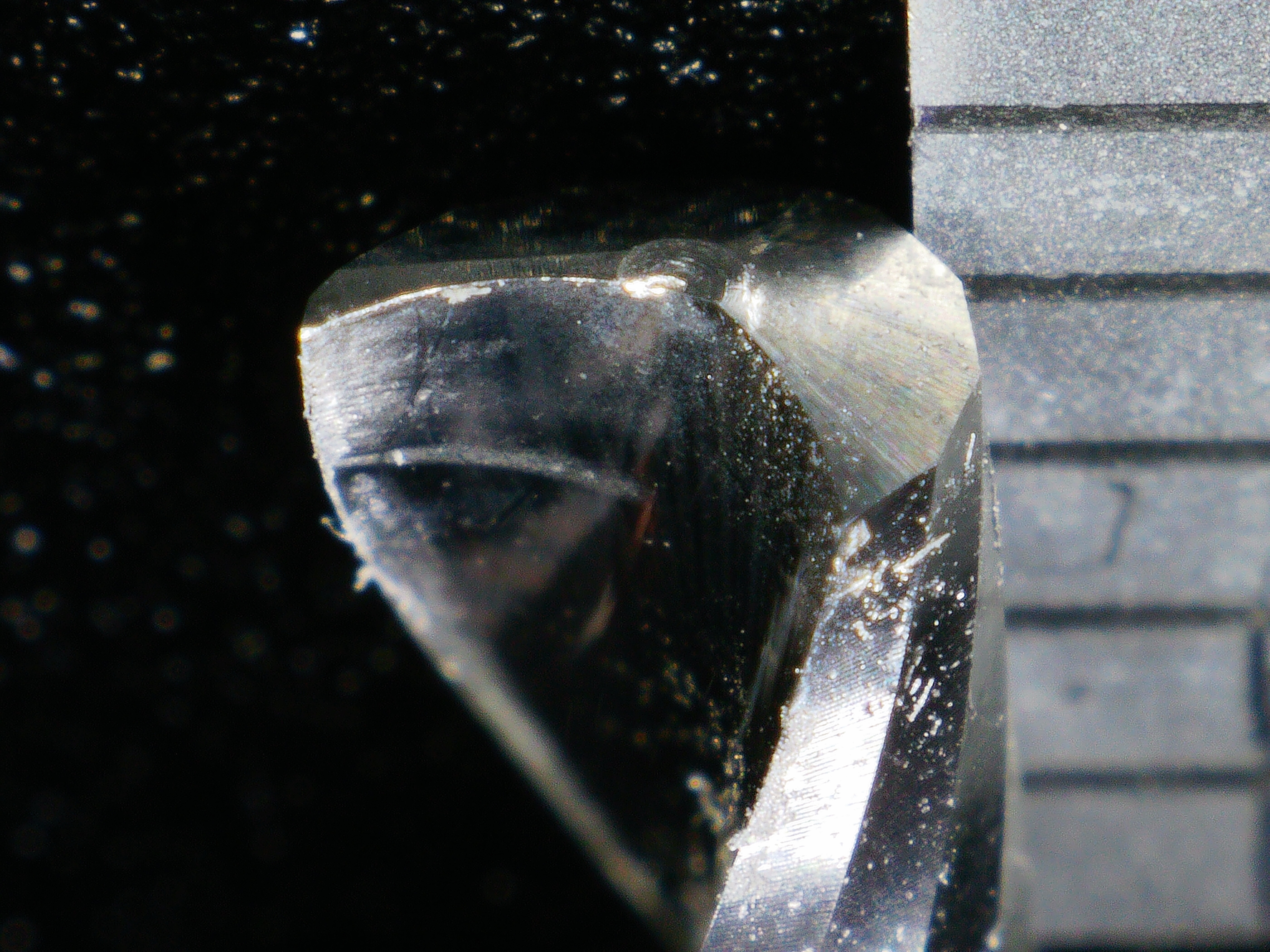

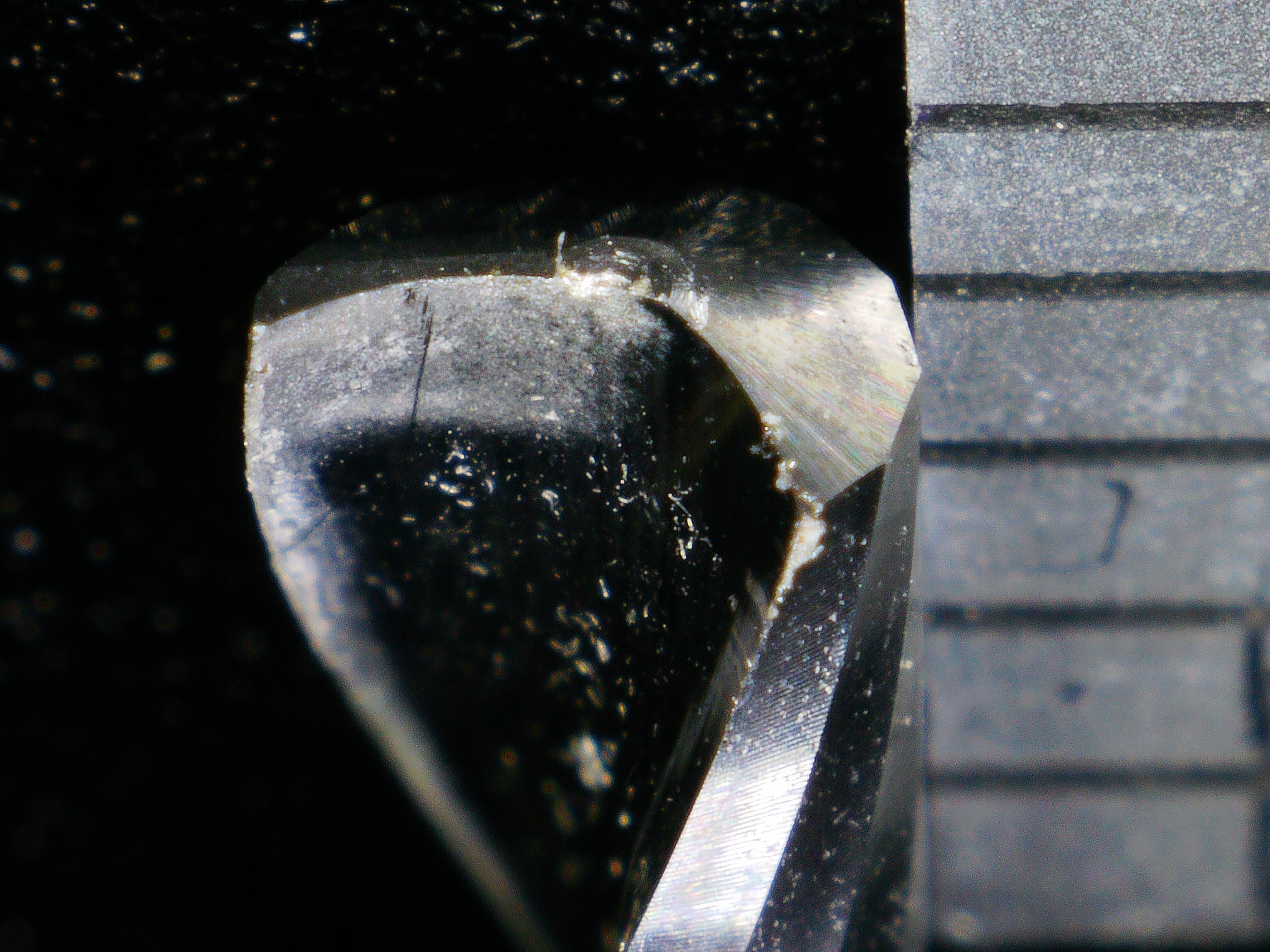

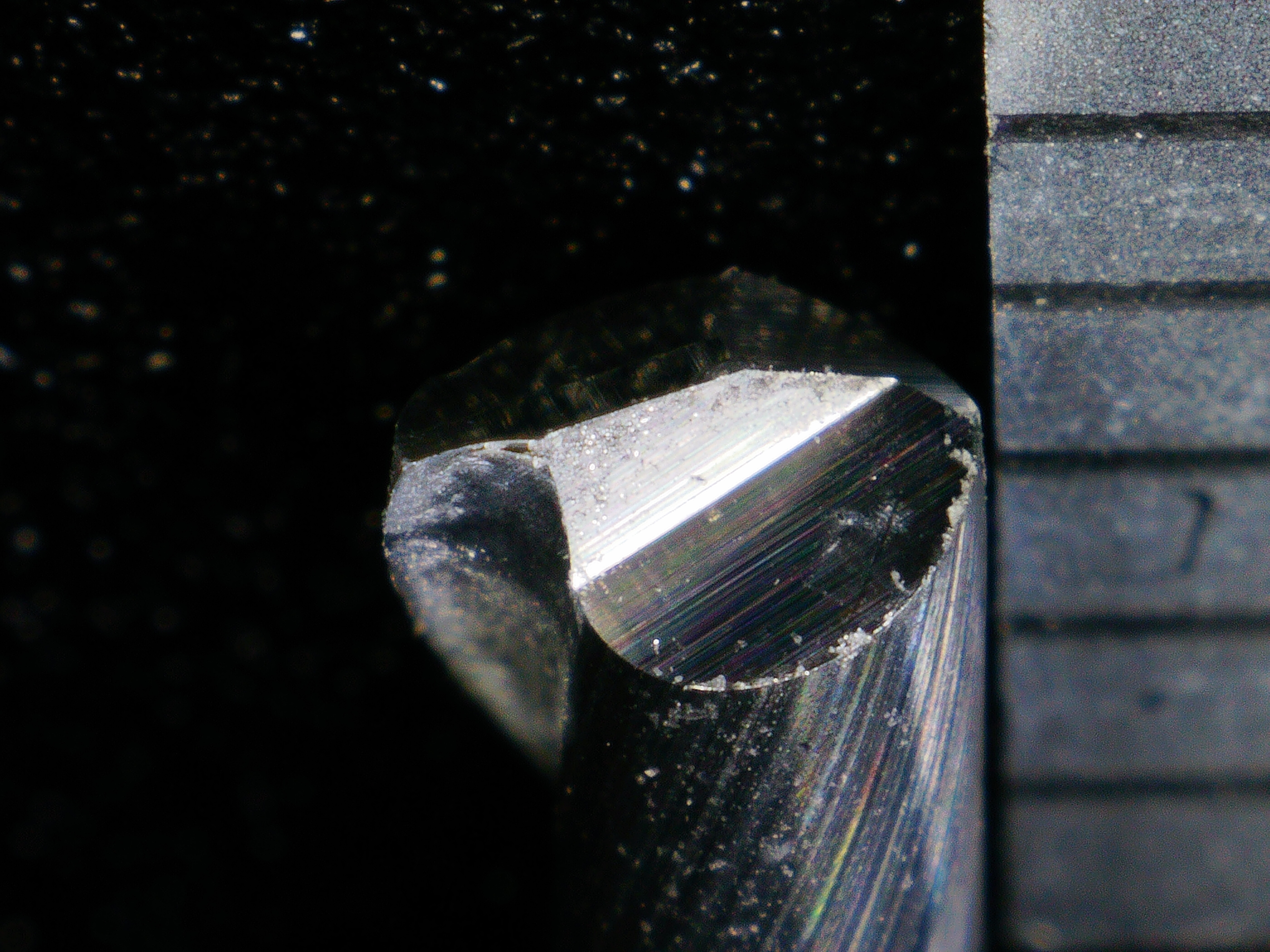

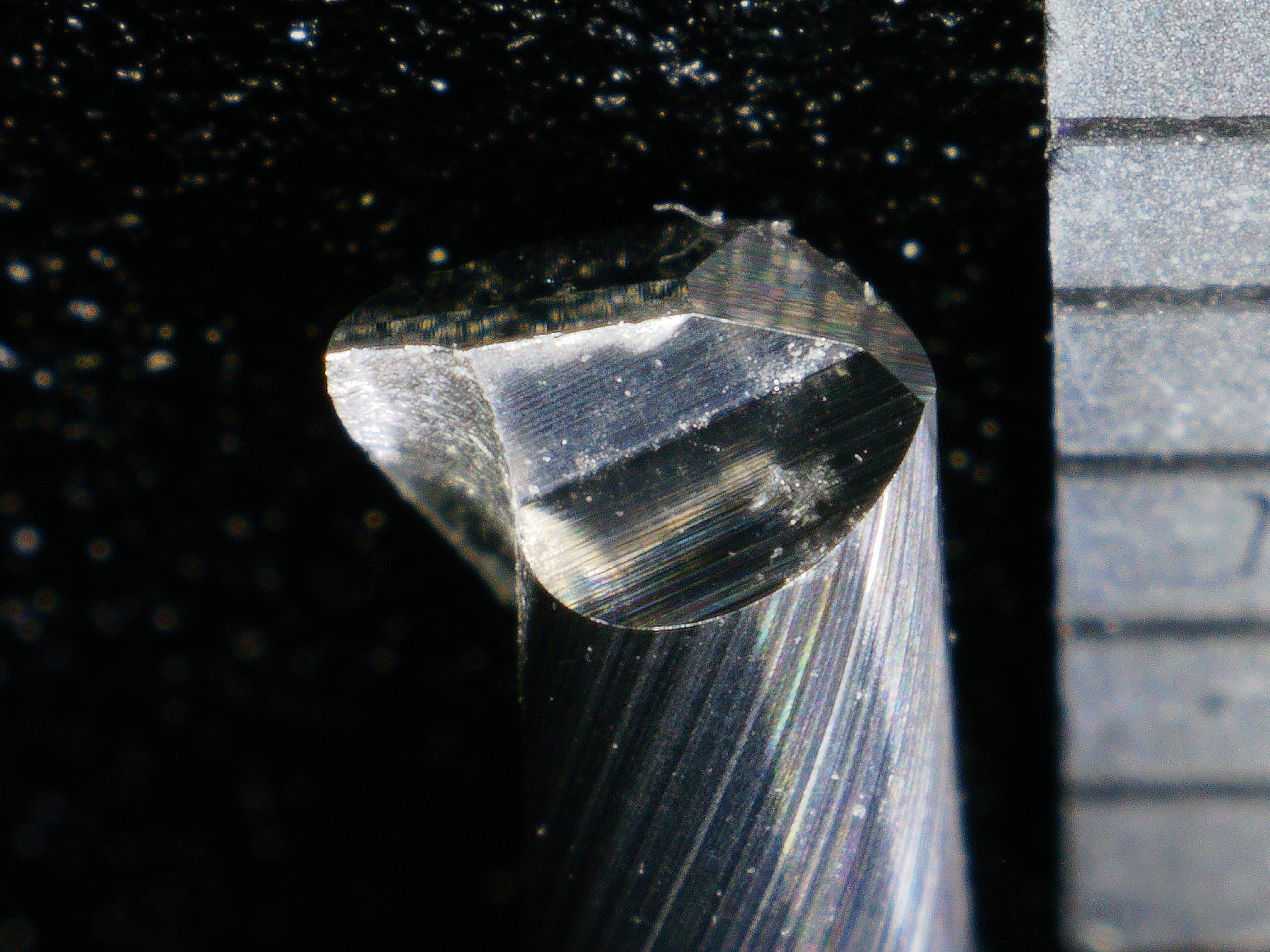

I’ll have to re-test most of these except of course the Carbide 3D endmill, which is the only one that broke. Here are some more shots of the broken endmill:
The only conclusions I feel I can make right now are:
  • The CNCFraises, DIXI, Sorotec Alu and Sorotec ProAlu endmills all left pretty decent surface finishes as-is
  • The CNCPlus 102-30, Sorotec Alu-B, Janpo 1MEM all left pretty meh surface finishes
To save on time, I might only bother with the first set of endmills when I re-test.
Great pictures and interesting results.
The loss of the accelerometer data might not be so tragic. It might have been hard to tell if any differences were a cause of wear or an effect of wear.
