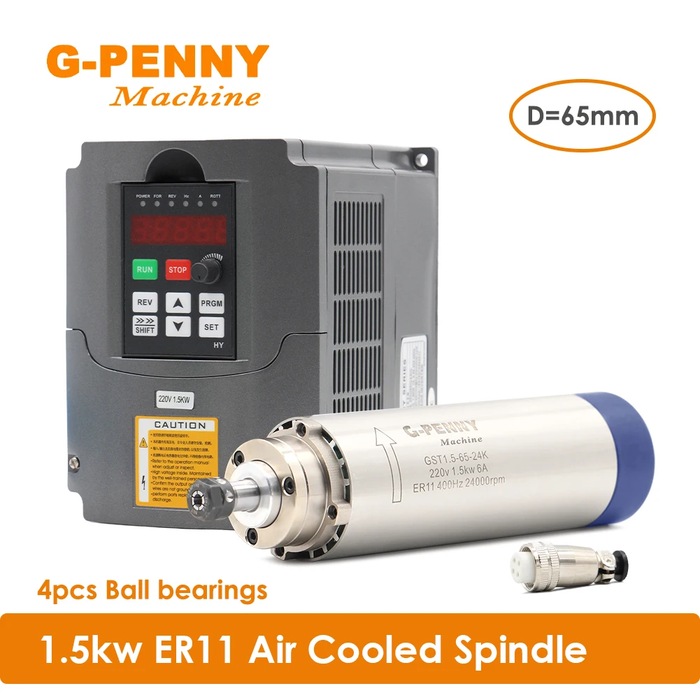

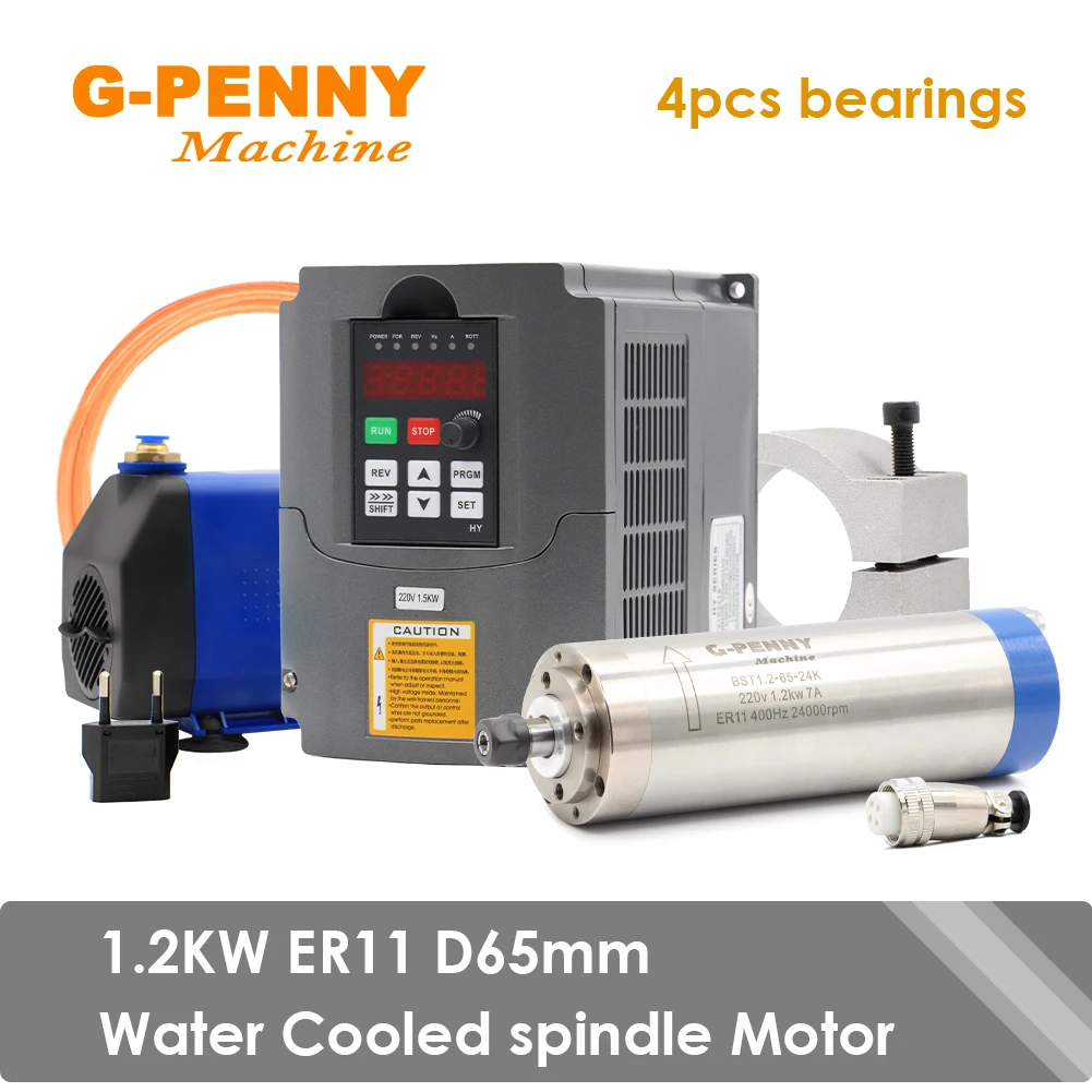

The GPenny spindles appear to be of consistent quality, the CW3000 clone chillers are popular for cooling them. I’d order from GPenny direct on AliExpress for price.
You can get GPenny in 65mm 800W water cooled, apparently a new 1.2kW water cooled
and 1,500W air cooled
But I don’t think power is the constraint on a Shapeoko machine.
It’s worth bearing in mind that you need to wire these things up yourself, they are not your regular trim router. If you want something that just plugs in and goes, wait for the Carbide spindle kit, use a trim router or buy the Kress / Mafell and put up with the noise.
