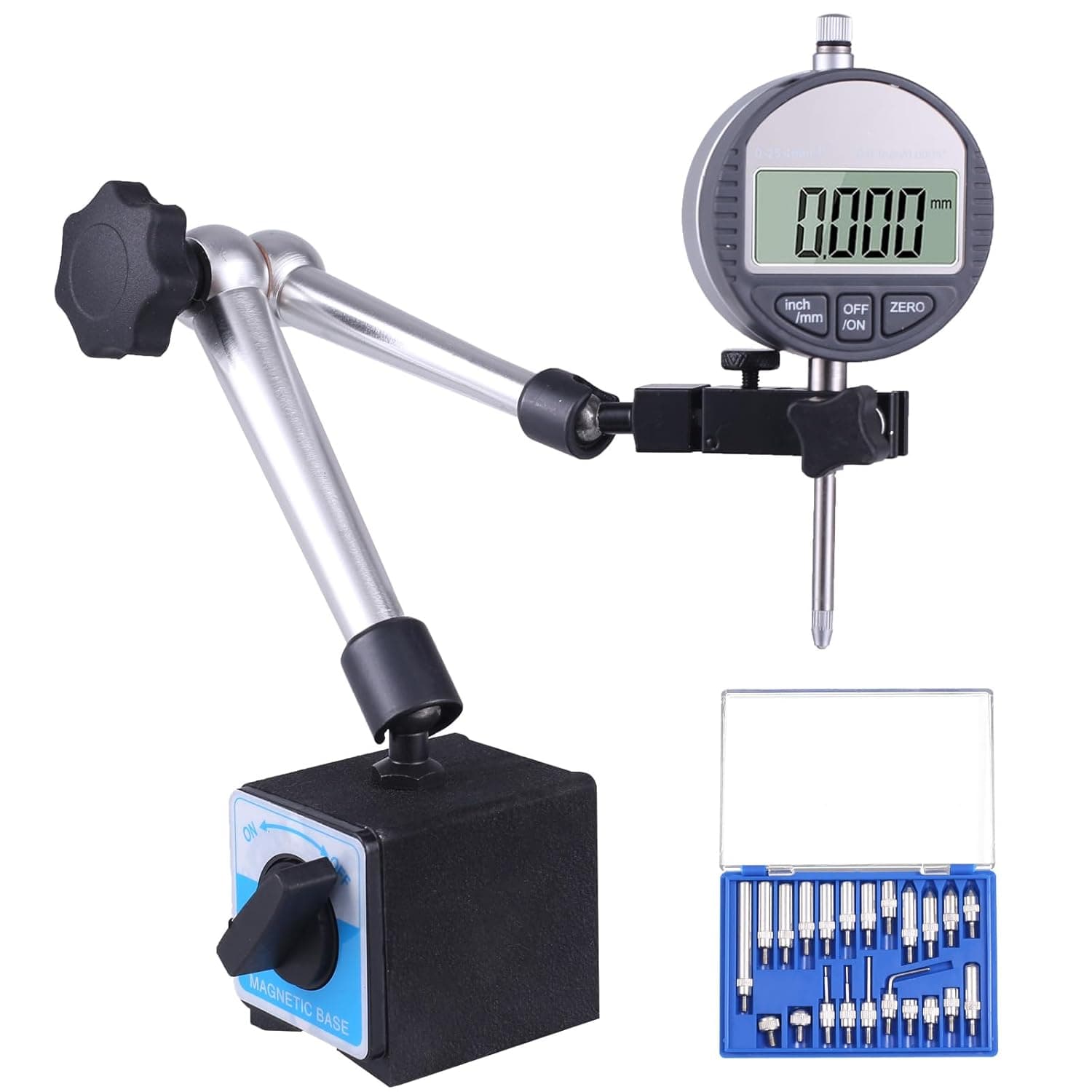

Hi, I am wondering what is the best way to square a vice to the gantry on my Shapeoko HDM. I have looked into using a dial test indicator mounted in the spindle, but it seems like it would rotate and wouldn’t be very accurate. Any other suggestions
Is there anything on the z that you could attach a magnetic dial test stand to :thinking:
Its all aluminum parts except for the rails and maybe the spindle, but I wouldn’t attach it to either.
I just noticed on the side on the spindle mount there are 2 M5 threaded holes, so maybe a custom mount could be made for them.

I use the set up pictured below on not only my vice but other work where I need to be square with X and Y. It also comes in handy for seeing how flat of a surface your working with. Basically a dial indicator clamped onto the spindle mount. The tool set is this one, but 40 years newer than the one I have.
I use a magnet to hold the spindle shaft still on my HDM
But I can get it within about 0.001 by eye with a dowel/drill blank in the spindle. I go left, right, back to left to verify. If it’s hard to see the dowel touch off, put a light behind it :wink:

I did a bunch of pictures awhile back on this. Sorry, I don’t have the pictures anymore. Look at buying a small dial indicator arm. Yes, you won’t be able to magnetize it to the spindle mount, but you can use a simple bar clamp to hold its magnetic base to the spindle mount.
