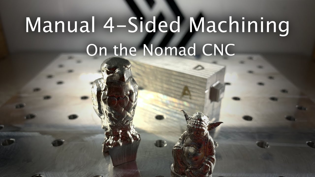

I will say some geometries with carving can make things complicated. I’ve done a bunch of 2 sided machining, and have worked on a jig to do 4 sided machining, but this requires different setups in fusion and can be a bit complex. Though there is a video where Winston goes through the process:

btw for this level of detail, I would strongly recommend getting a “tapered ball nose endmill” instead of a simple ballnose… you’ll get much better results at less cutting time.
(only gotcha is that those often advertise Radius not Diameter… so need a mental “x2” in there)
