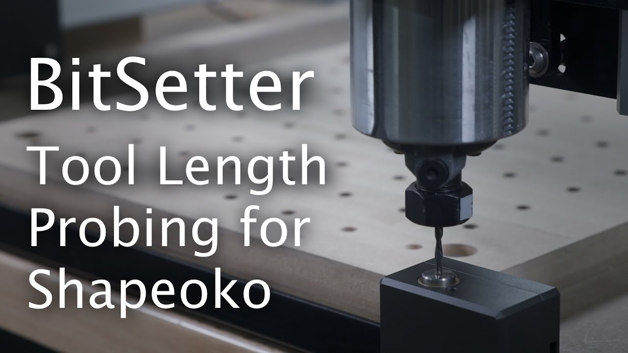

Yes I zero my bit manually by jogging it over to the bottom left corner and just barely touching the tip of the bit to my stock, I click on run program, it then instructs me to install whatever bit that it starts with for advanced vcarve, (usually I already have the correct bit installed from getting everything zeroed) I install the bit and it brings it over to my BitSetter to get the correct height. I then turn the router on and it starts the cutting
I don’t have bitsetter, but maybe review this thread and see if you are using bitsetter correctly:
To me the pertinent question is after the machine probes bitsetter, is the z-axis zero still correct. Since it was working before and now it isn’t and you recently got bit-setter, it seems that is the most likely culprit. I think I saw in another thread that they always press change bit before zeroing to prevent errors. Otherwise I am stumped.

I think the issue is either machine configured incorrectly for z axis or bit setter issue. Looking at the picture the end mill and vcarve sections seem to line up and look correct. With a bit slipping you would see differences between sections and between bits.
Bit setter:
Whenever changing bits you need to use change bit button even if you are not in middle of program. Easiest way around this is get in habit of pressing change bit before ever setting zero.
Incorrect Z-axis:
The different z-axis types move a different amount per pulse from the stepper motors. If you have the belt drive z-axis but incorrectly selected Z-plus your z movement will be incorrect.
To verify bit setter, check the Z zero location after running the program.
Sorry all that is confusing… I agree a bit isn’t slipping, it’s too clean and I would definitely notice that… But I don’t see a change bit button, whenever carbide is done with the first bit it automatically brings it to the front to instruct me to change bits… And my Z axis isn’t driven by a belt but I am not sure if I have z-plus selected or not.
And how do I go about checking a Z zero location once the program is finished?
